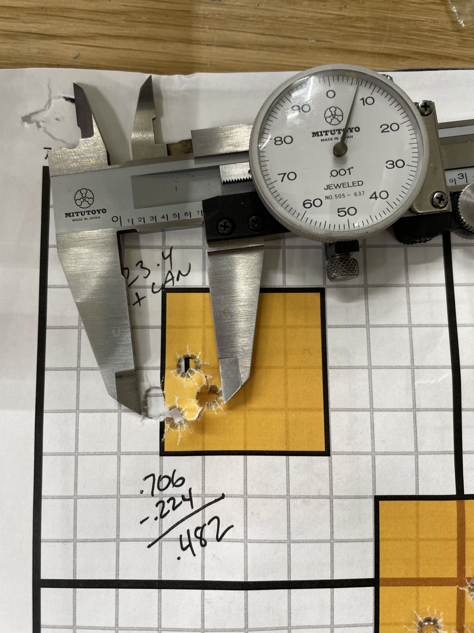

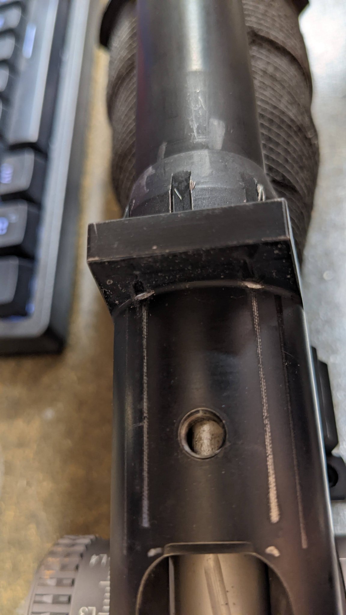

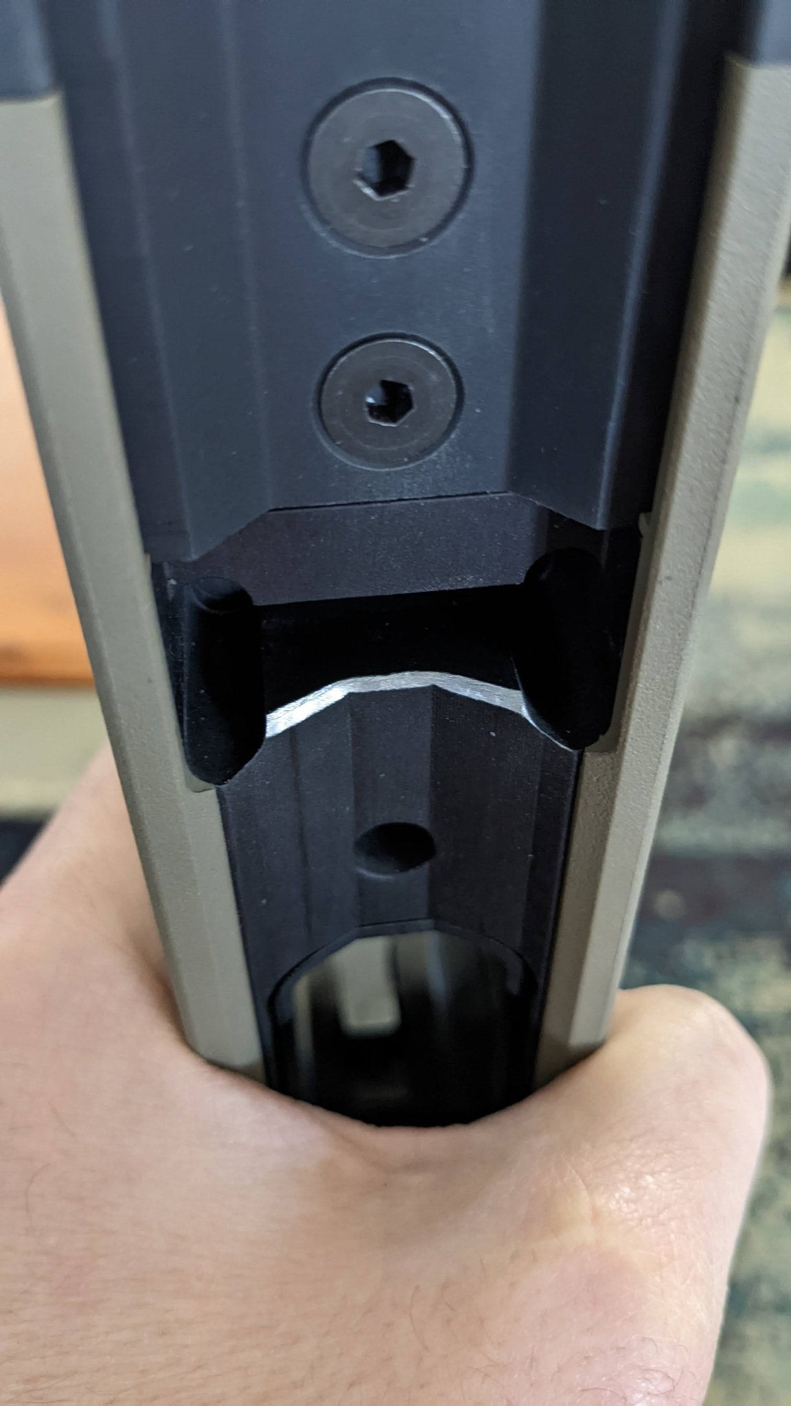

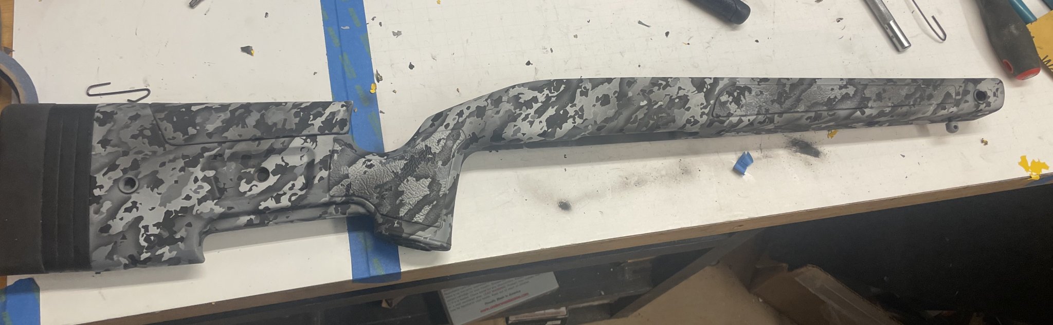

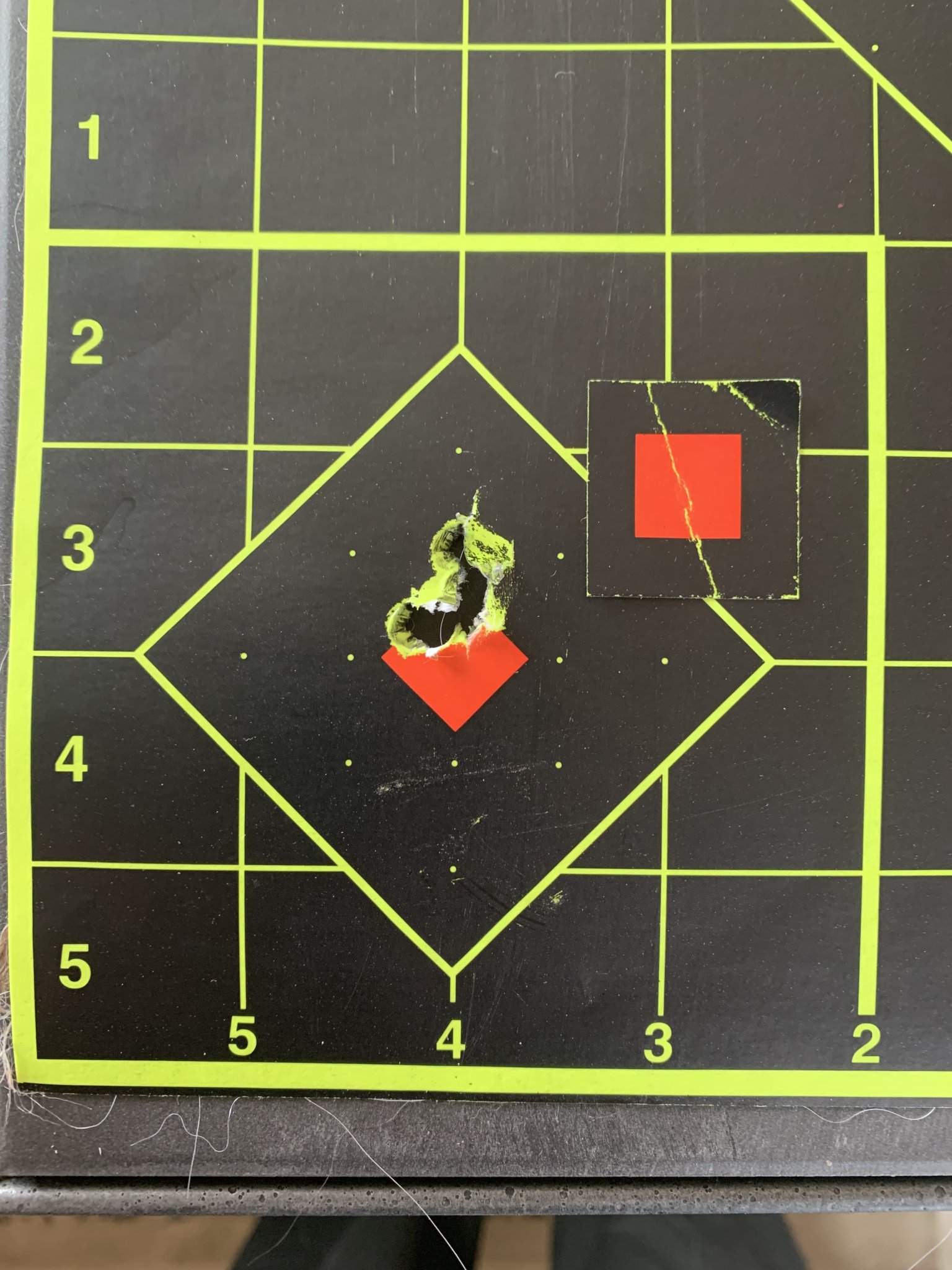

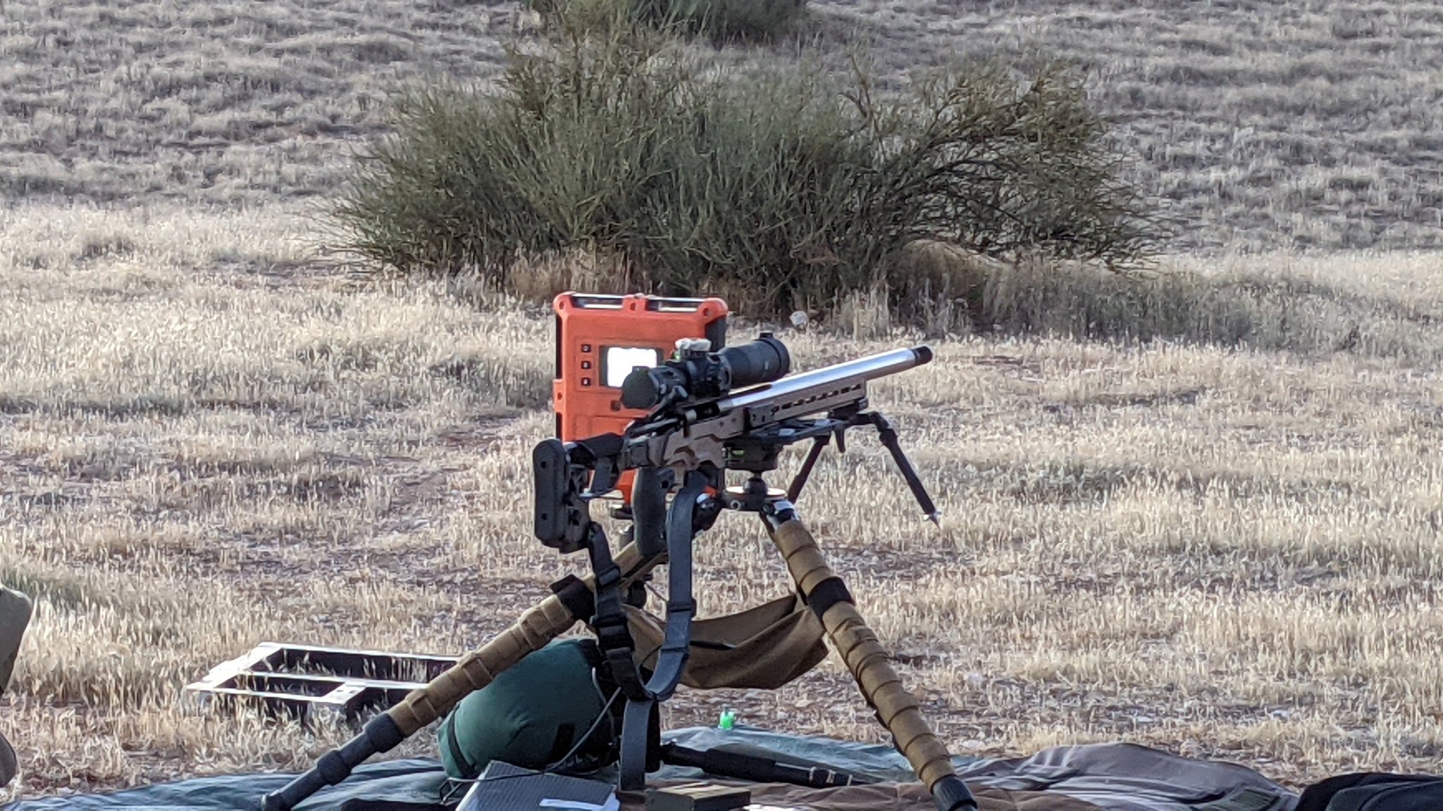

Bought this TL3 when they first came out. I think this is the 3rd? maybe forth chassis/stock. Magpul 700 Pro. had to bevel the end of the action/recoil edge since it was machined sharp 90 degrees. Didn't notice this at first but sure noticed it with a vertical spread at 500yds that I wasn't expecting. Lower and far left bullet hole was already there. Forgot staples so used existing targets.
You can see on the bottom of the action where the contact mark was thinner toward the lug as it wasn't sitting flat because of the radius between action and lug.

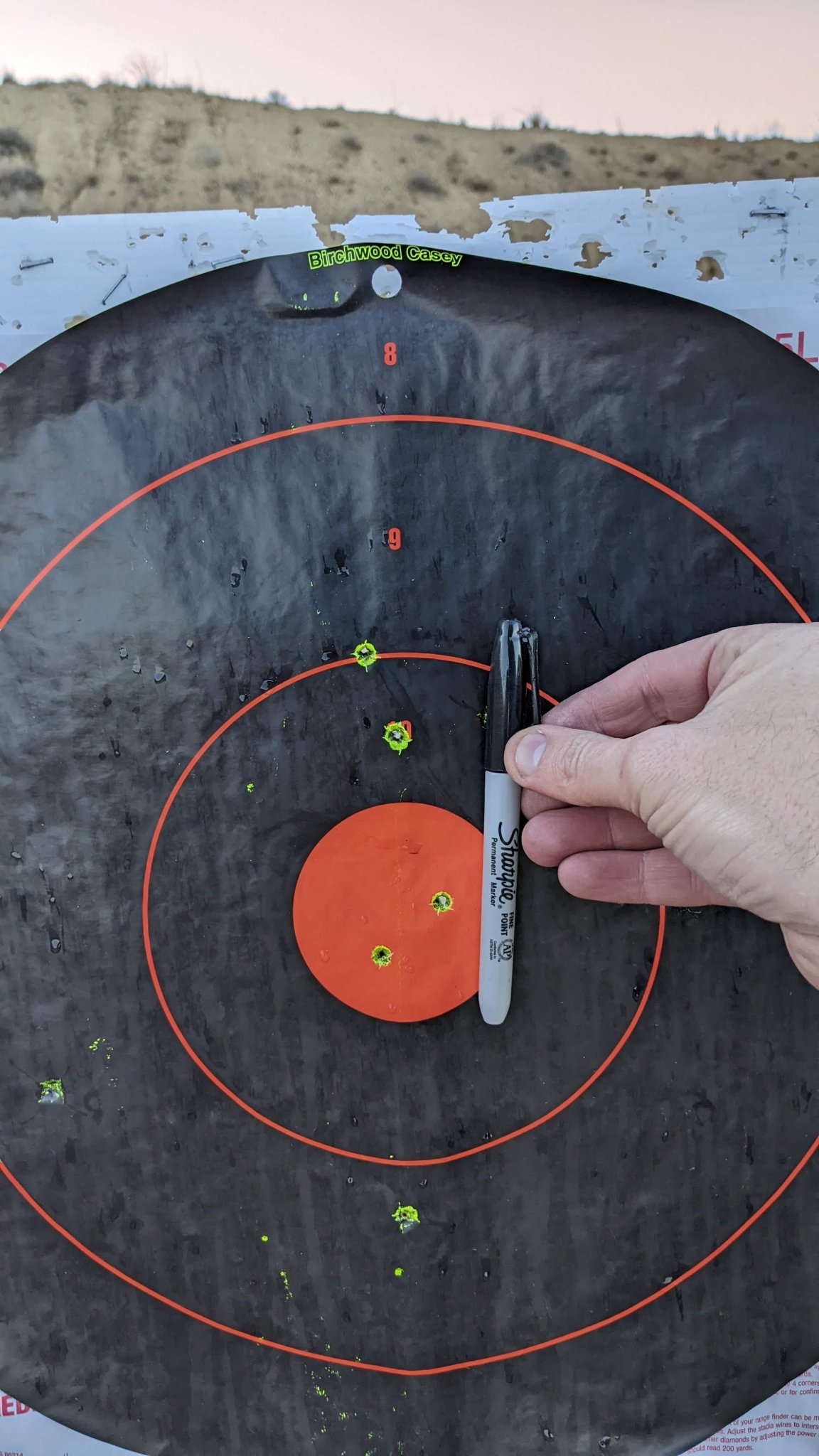

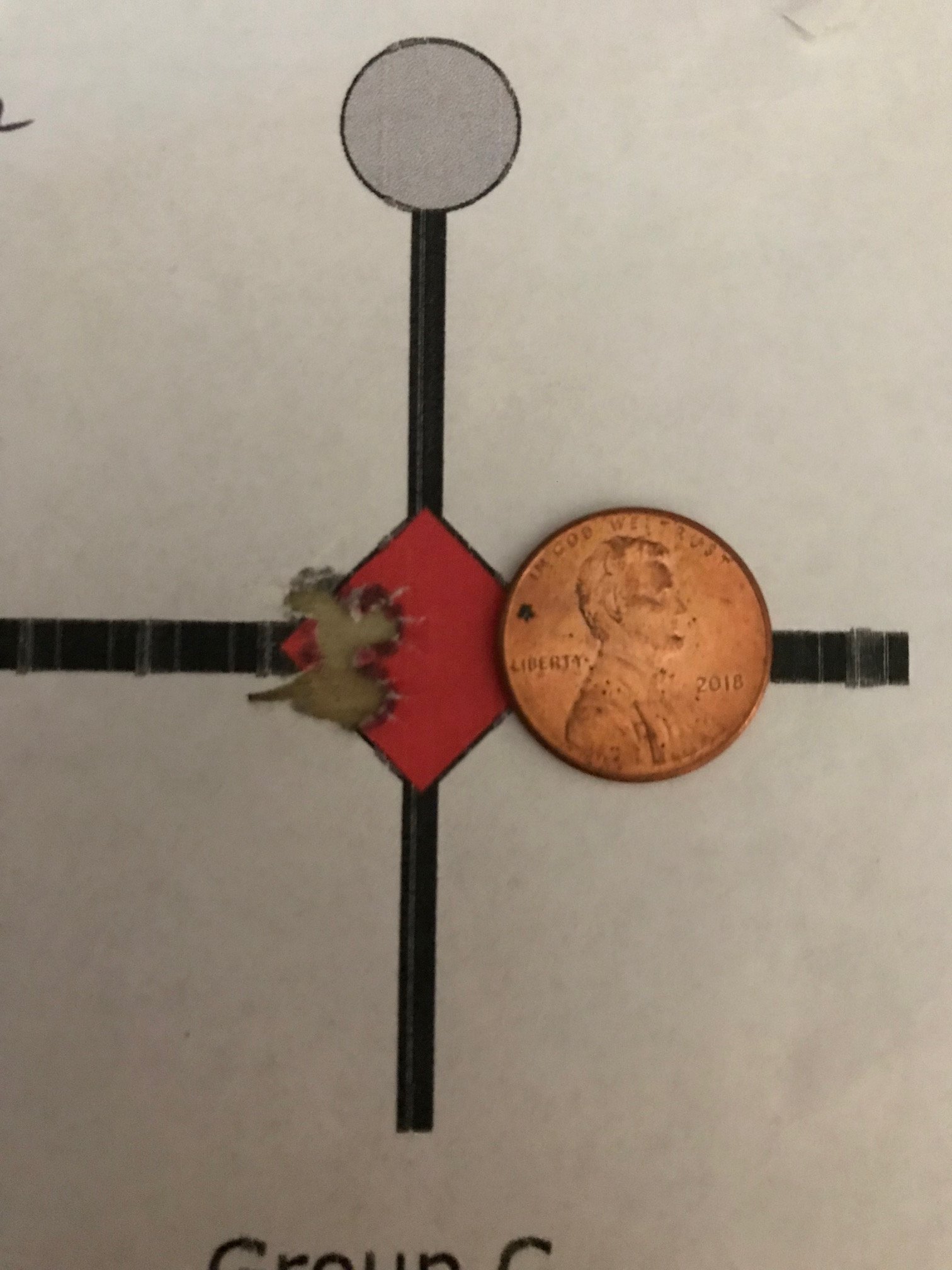

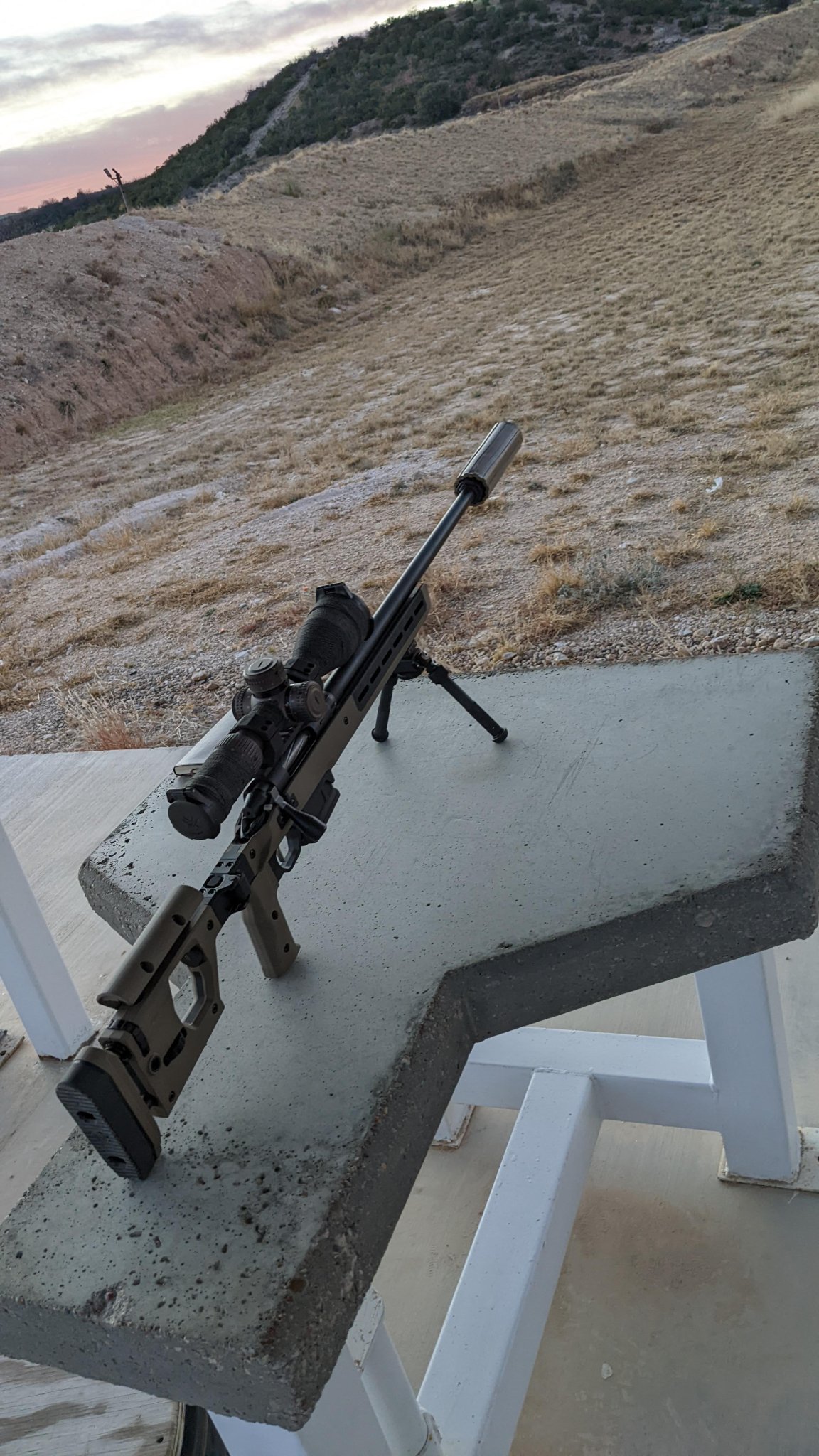

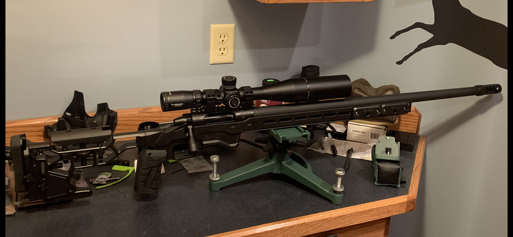

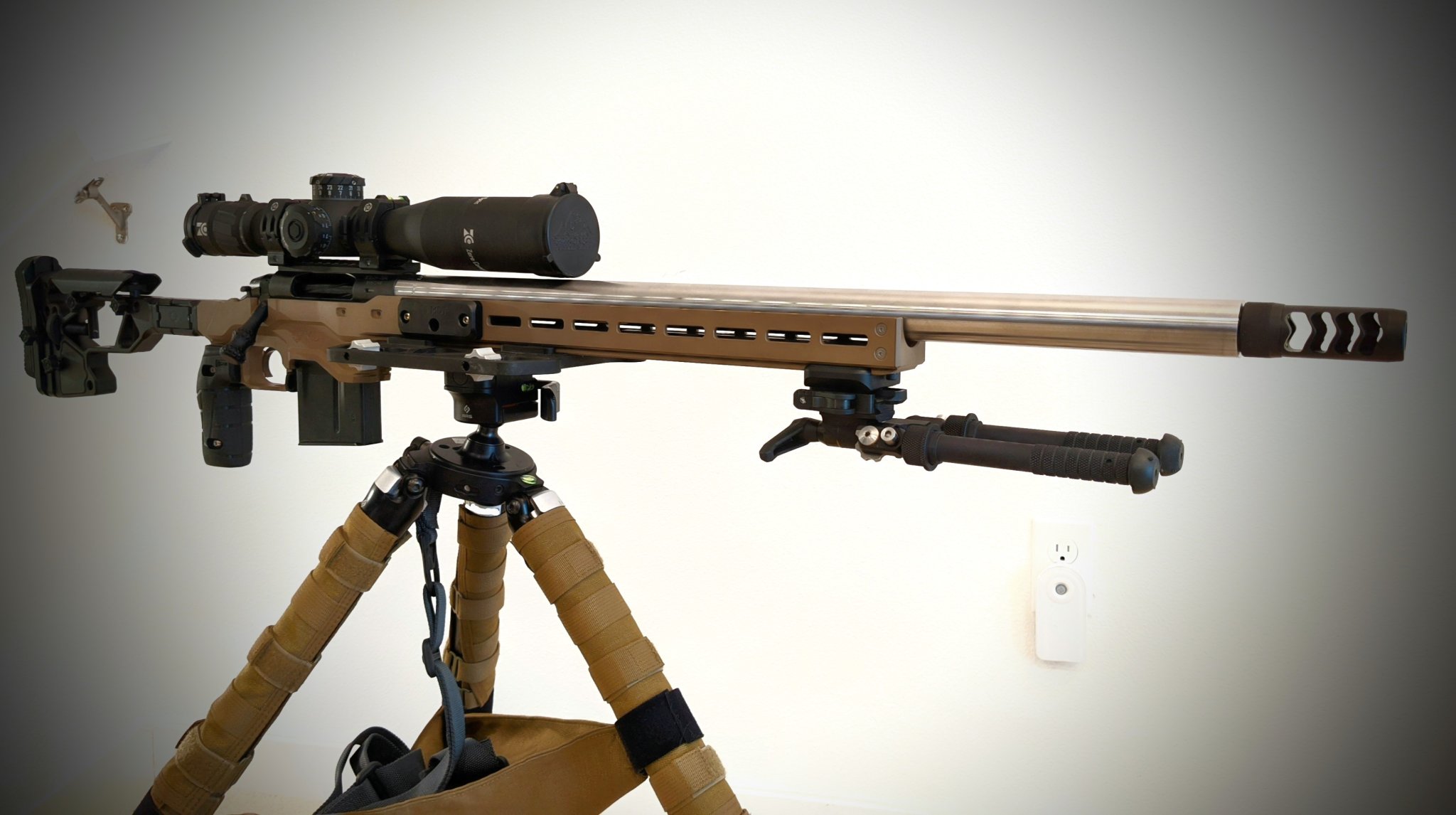

New girl! 2 shots to sight in and then this 4 shot group. 108 eldm
Tl3 action
27.5” bartlien 6mm creedmoor. Barrel work done by radix precision out of Omaha NE
MDT ACC chassis
Area 419 Hellfire match break
Athlon ares btr gen ll 4.5-27x50
Buttstock weight and steel bag rider with full internal weights and 2 exterior. 22lbs as is but may add more.

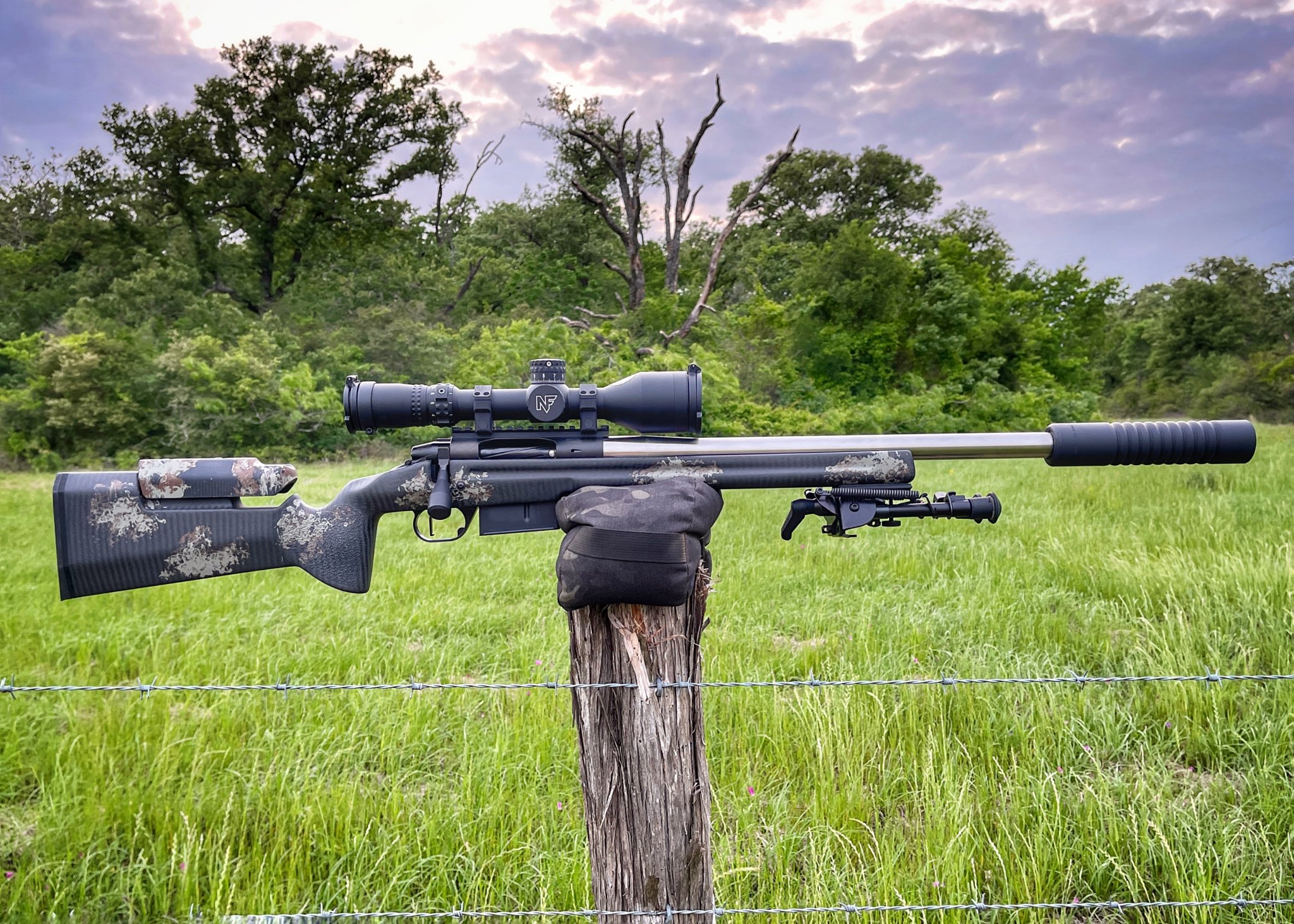

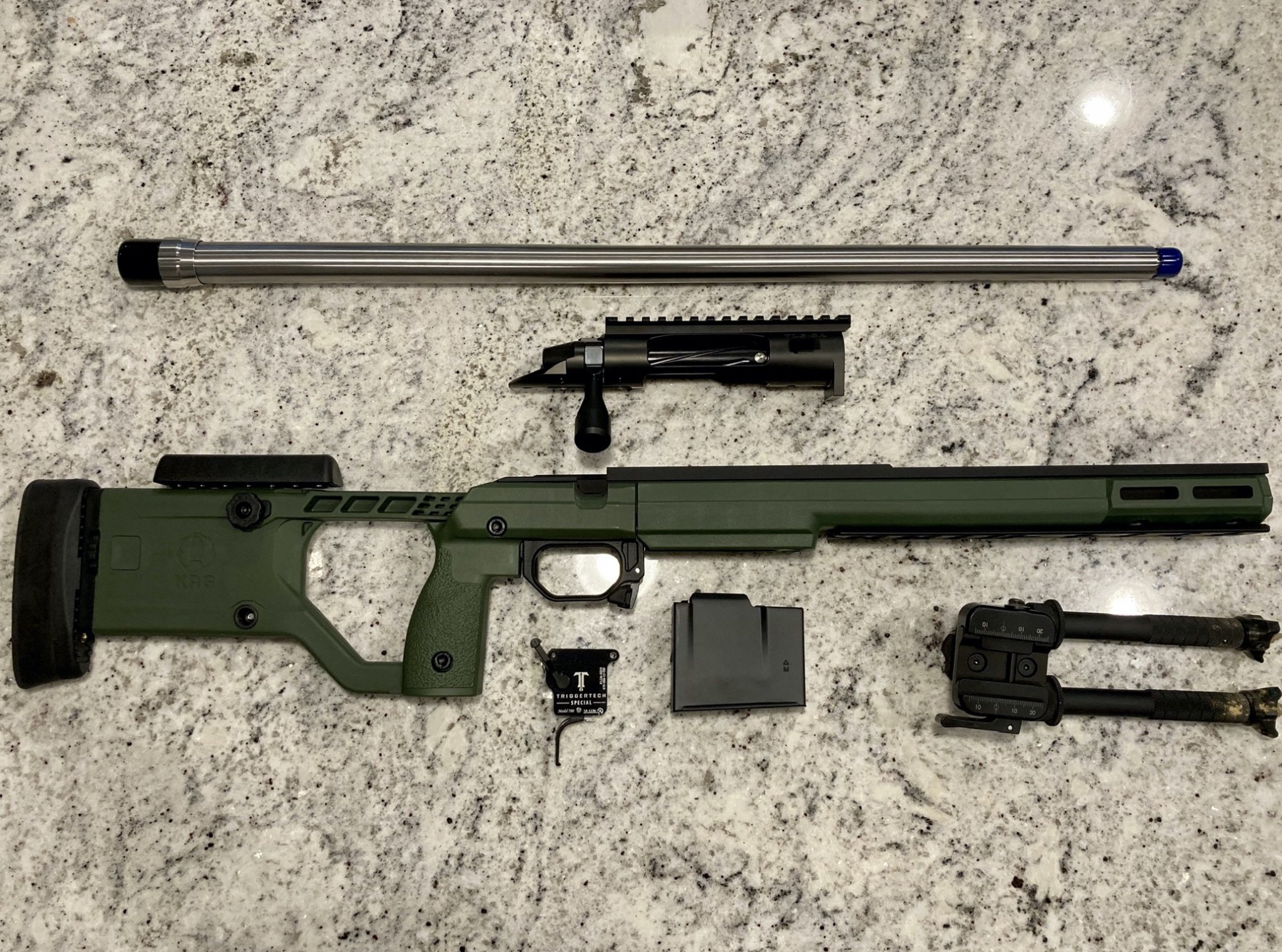

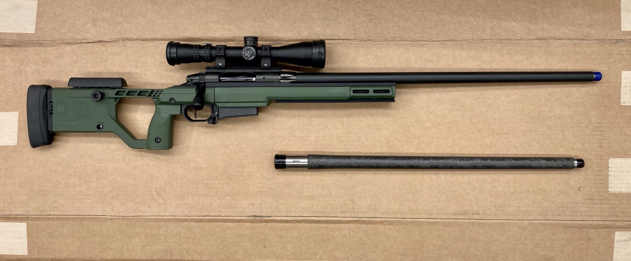

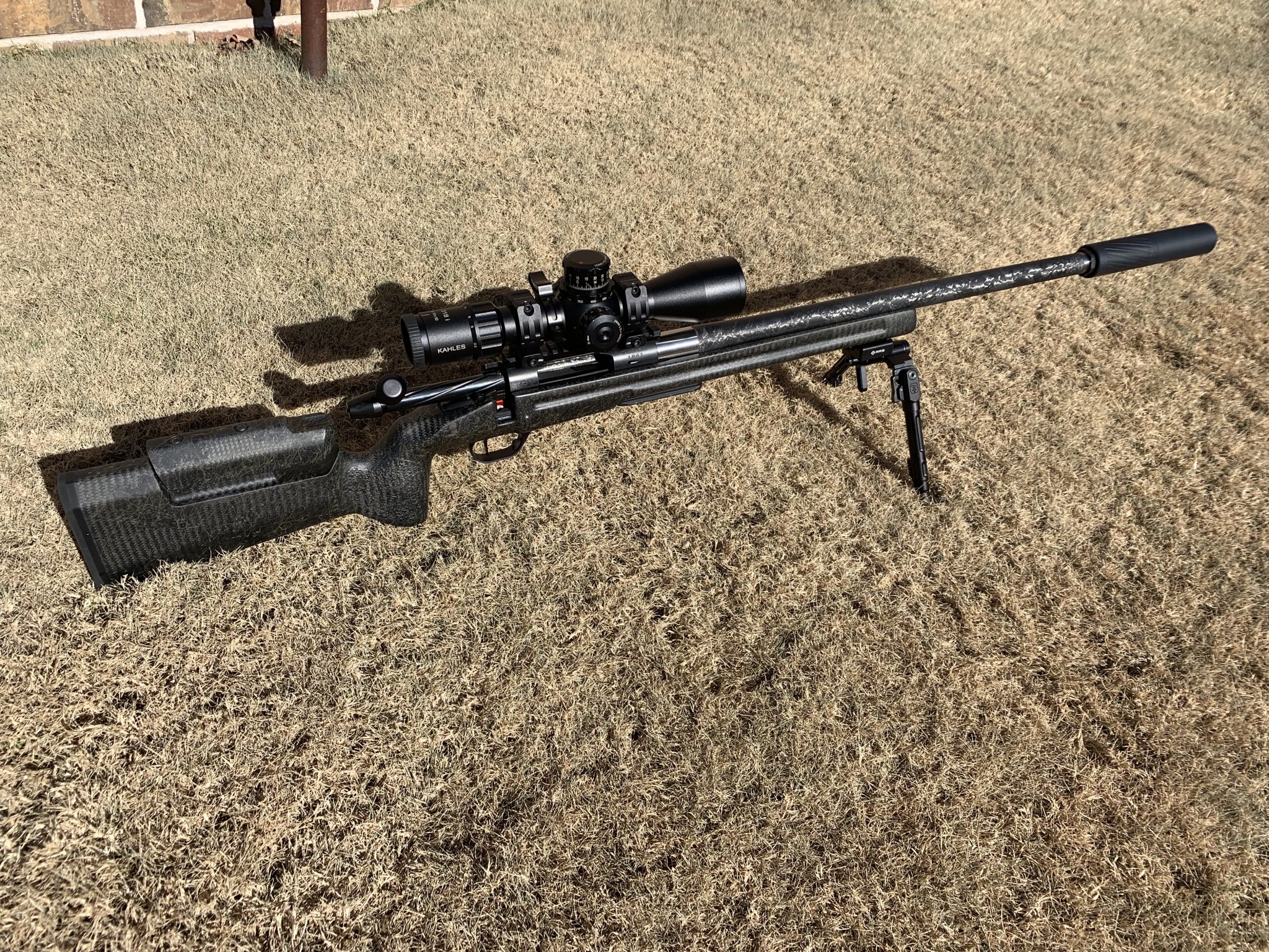

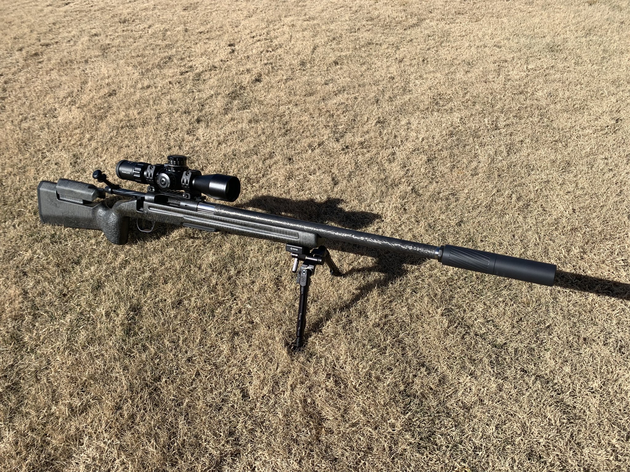

Put this together a year ago and just got around to shooting it. Wanted a 12-14 lb 223 trainer with option to get weight under 10 lbs w/carbon barrel for hunting. 223 is 12.2 lbs and with the proof is about 9.5 lbs.
All I had loaded in 223 was some blasting loads for my AR (mixed LC, XBR, 75 BTHP, 2.26 coal). Not bad considering. Going to fireform some Lapua with ELDs and see what she can do.
Bad news is I like it more than my custom M70 and SRS so will probably be picking up a 7 SAUM barrel for it soon and maybe a LA for a 300 PRC fml it never ends.
Reactions: Rob01

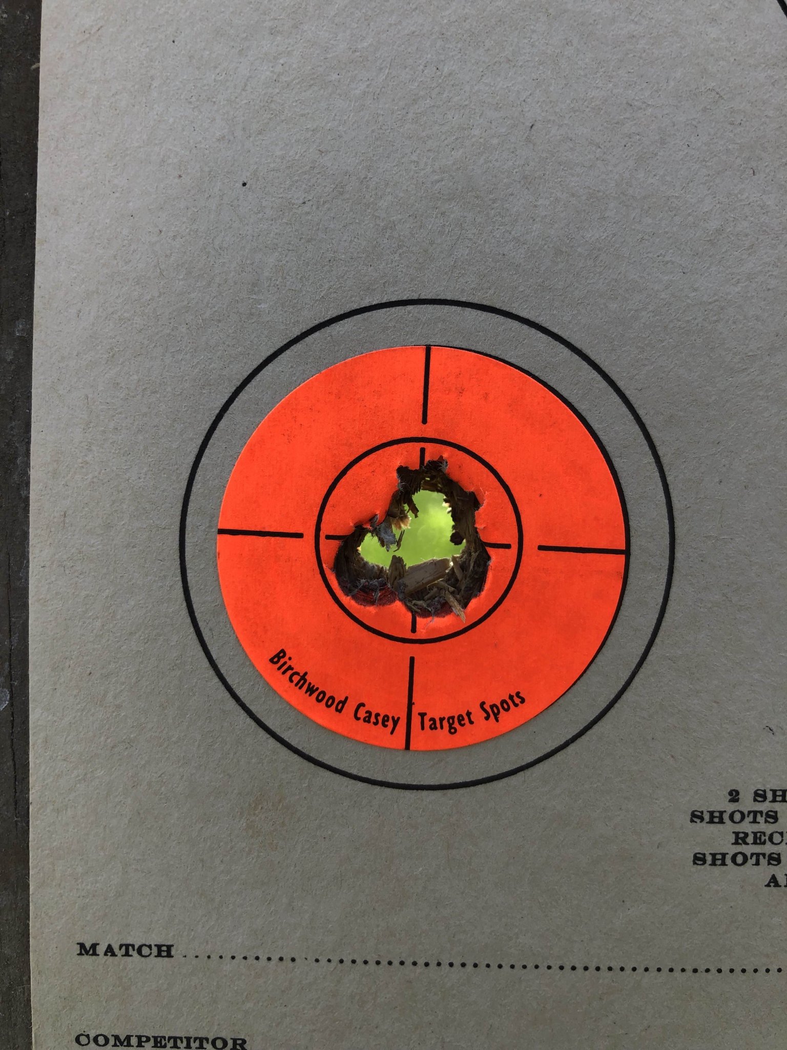

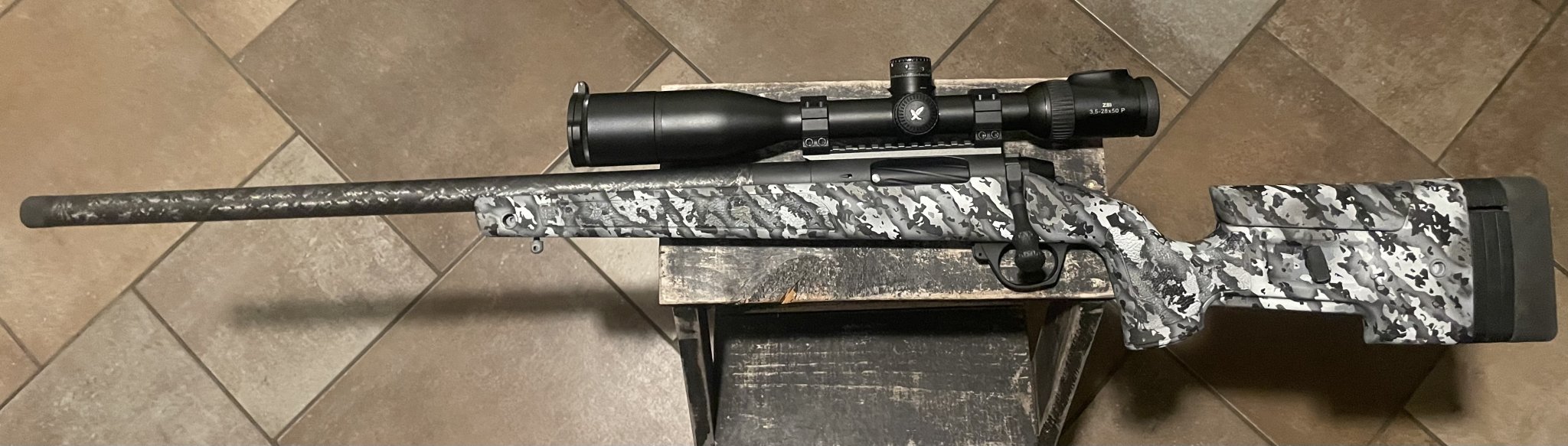

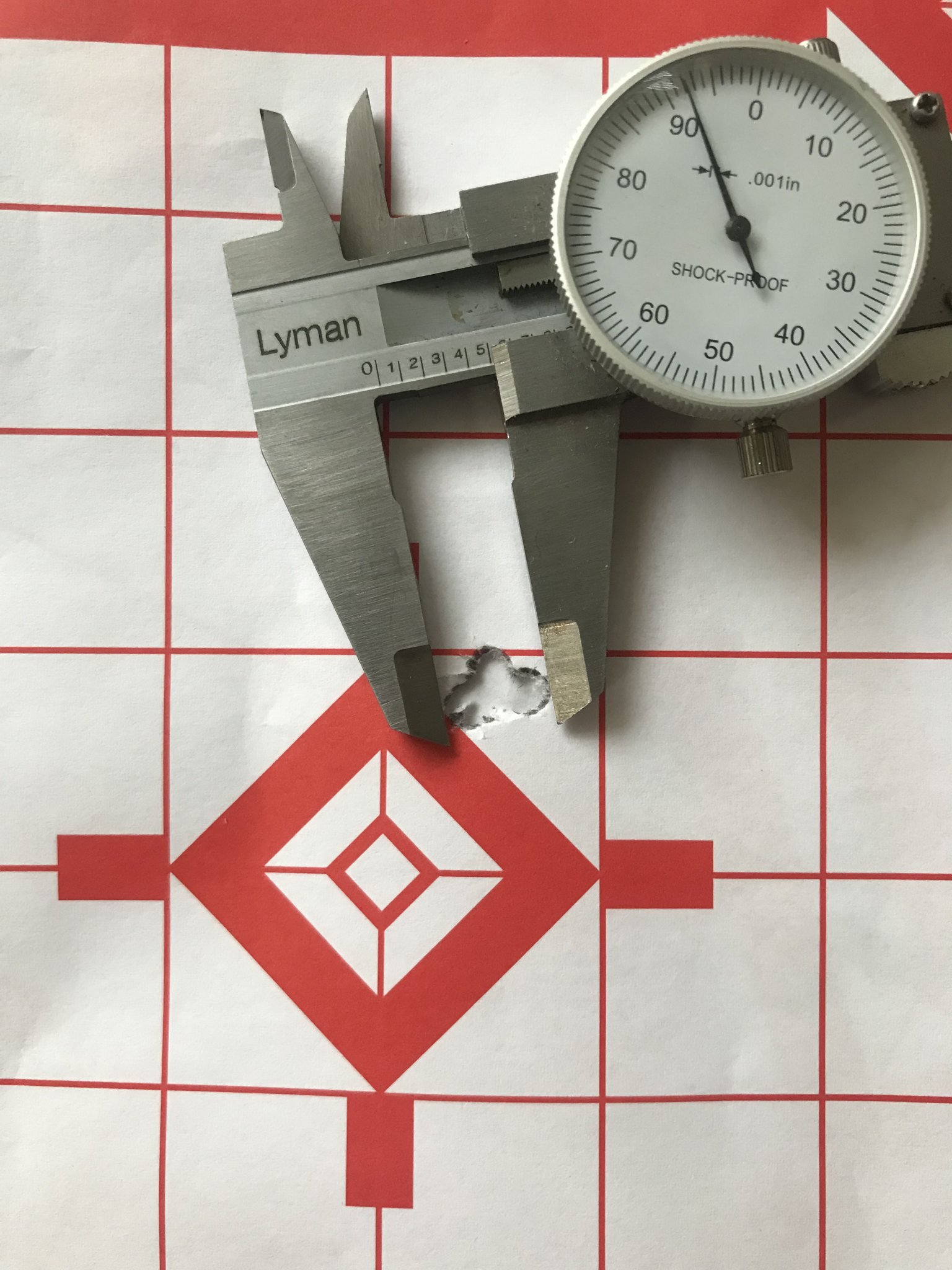

In Hornady brass with 75 ELD-Ms at .020" off lands in .223 Wylde with 24.5grns of XBR 8208. In my TL3 with Proof 7 twist prefit done by PVA. Rifle is so fun to shoot. 5 shots at 100. Have shot it to 1150 yards.

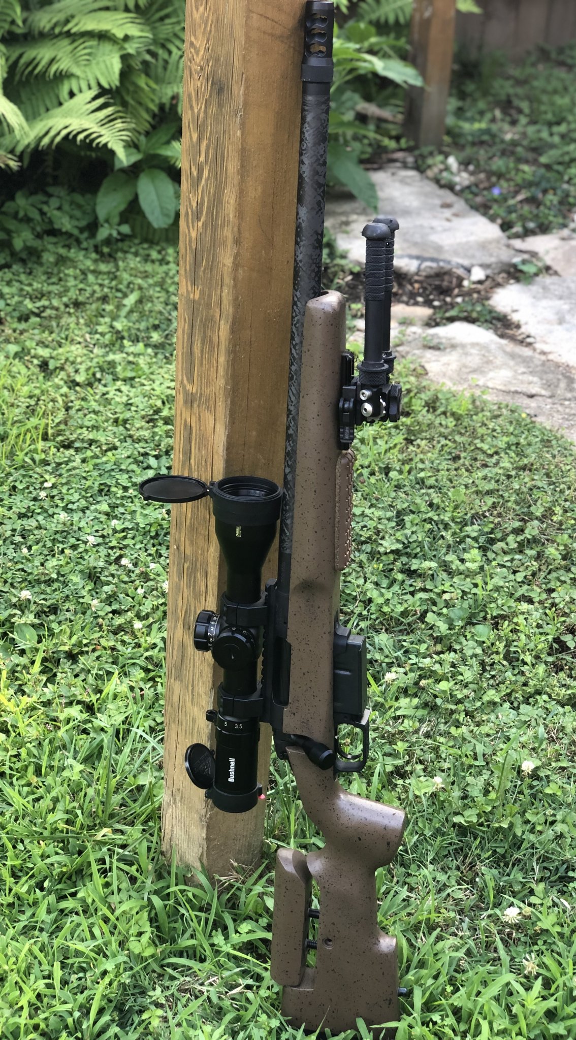

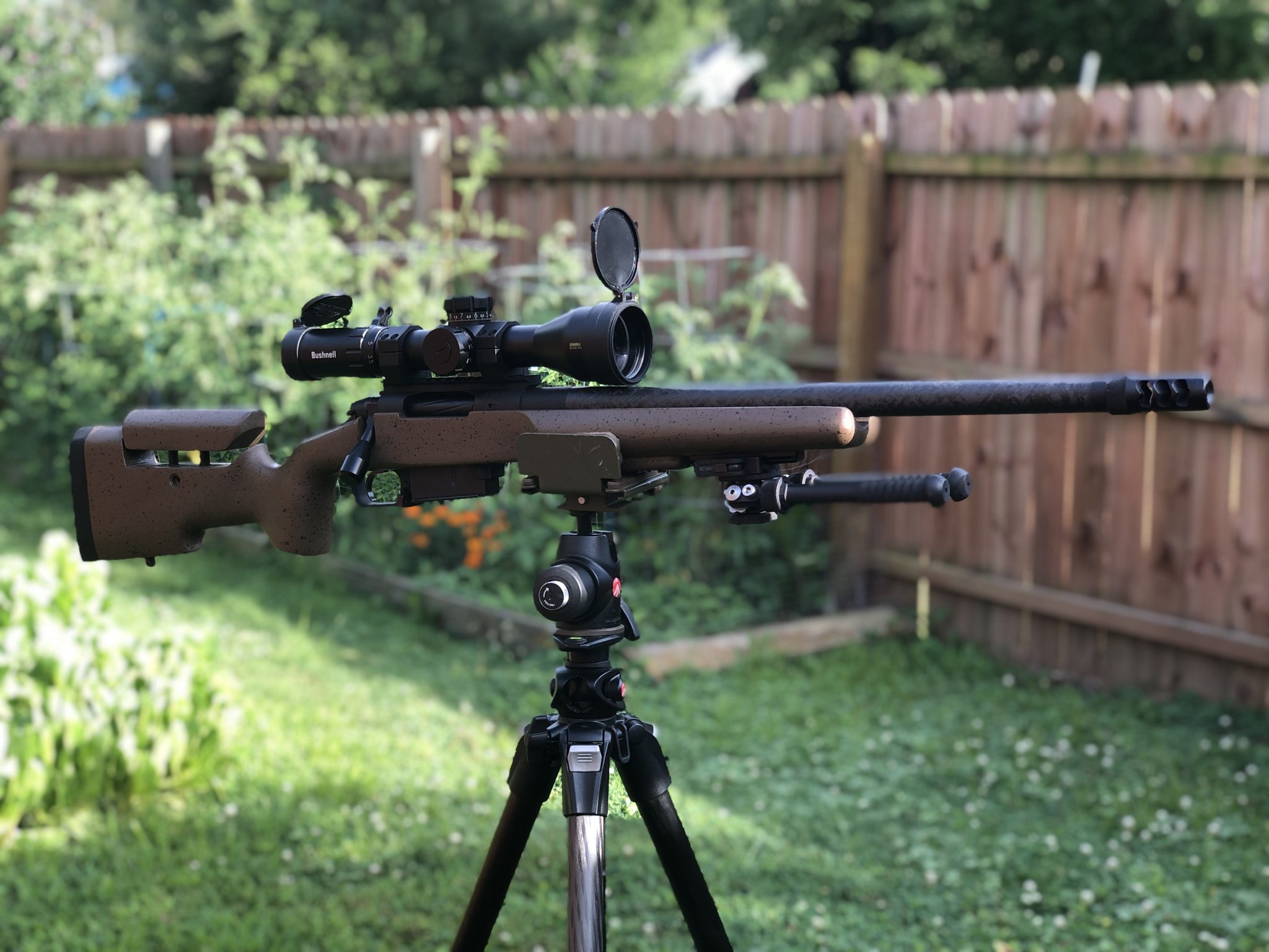

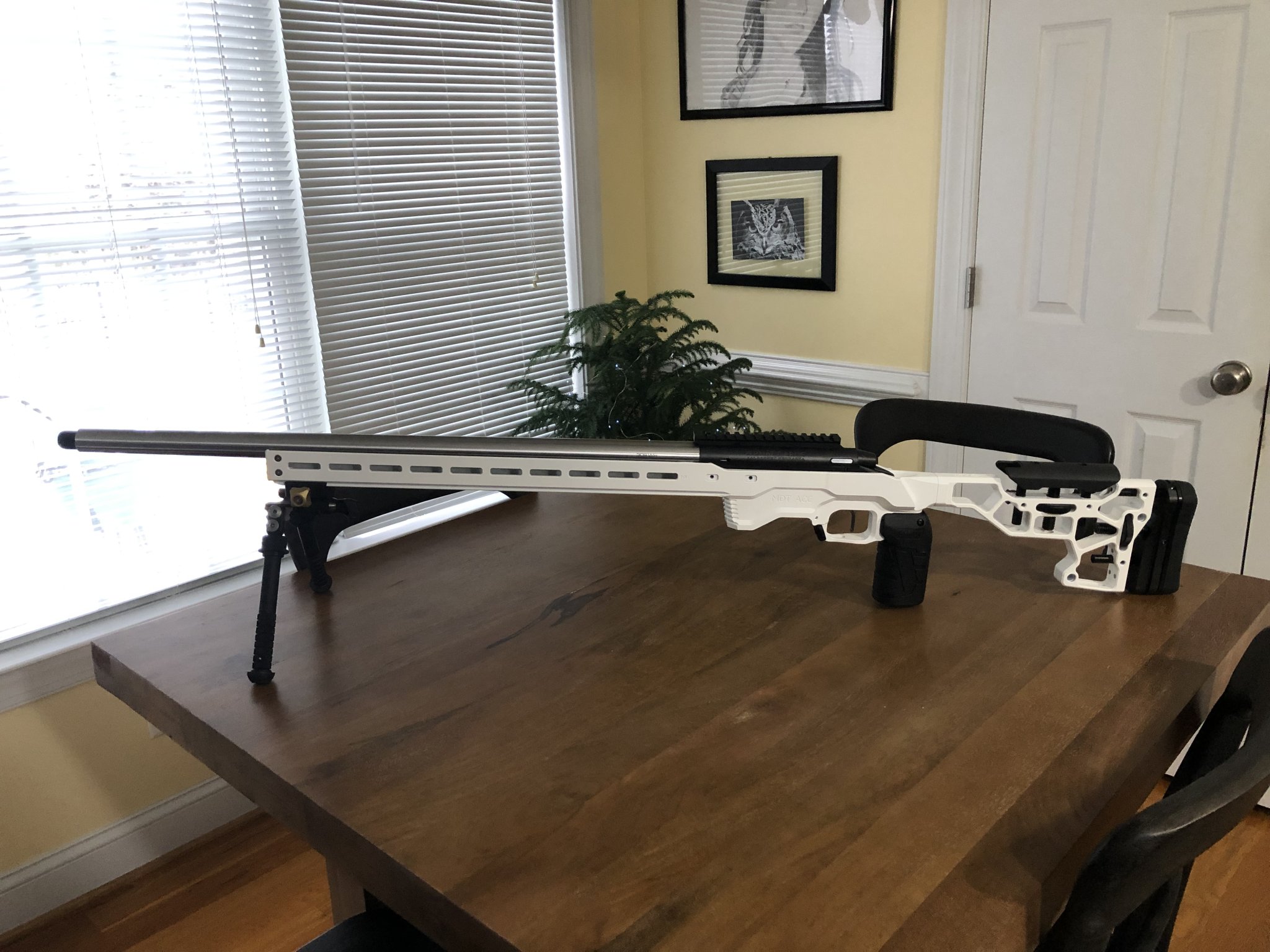

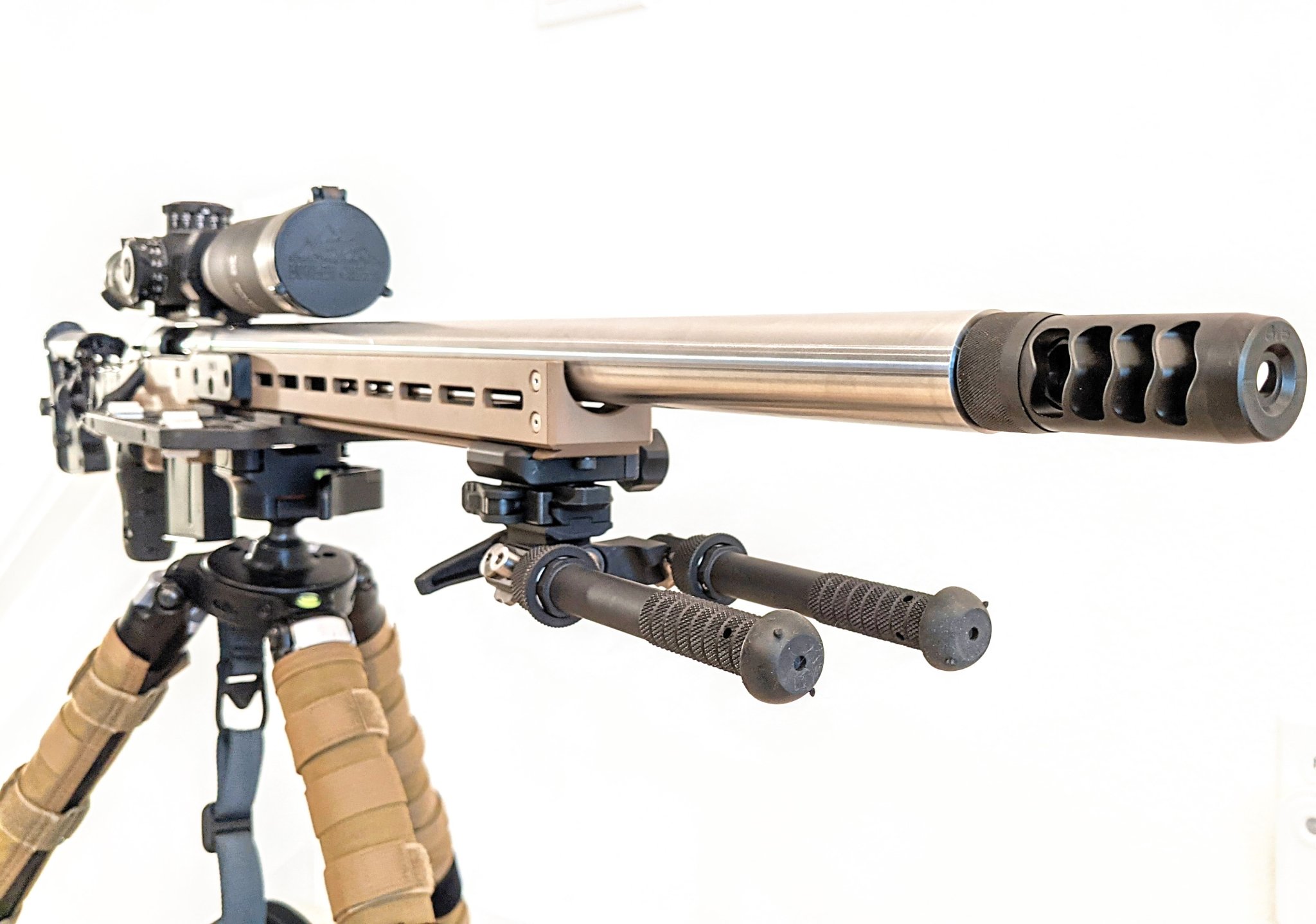

Here's mine! Phoenix Custom Rifles Bighorn TL3 .308 with a 22" .308 1:10 twist Proof Research Carbon Fiber. Area 419 Hellfire, Grayboe Renegade, Triggertech Diamond, Atlas PSR, Bushnell DMR 2 Pro, Seekins 34mm .92 rings, custom brown and black speckled Cerakote. It shoots 5 shot groups of 175SMKS with 43gr of Varget in the .2's if I do my part!

I’ve always liked that pig skid pad on simple builds

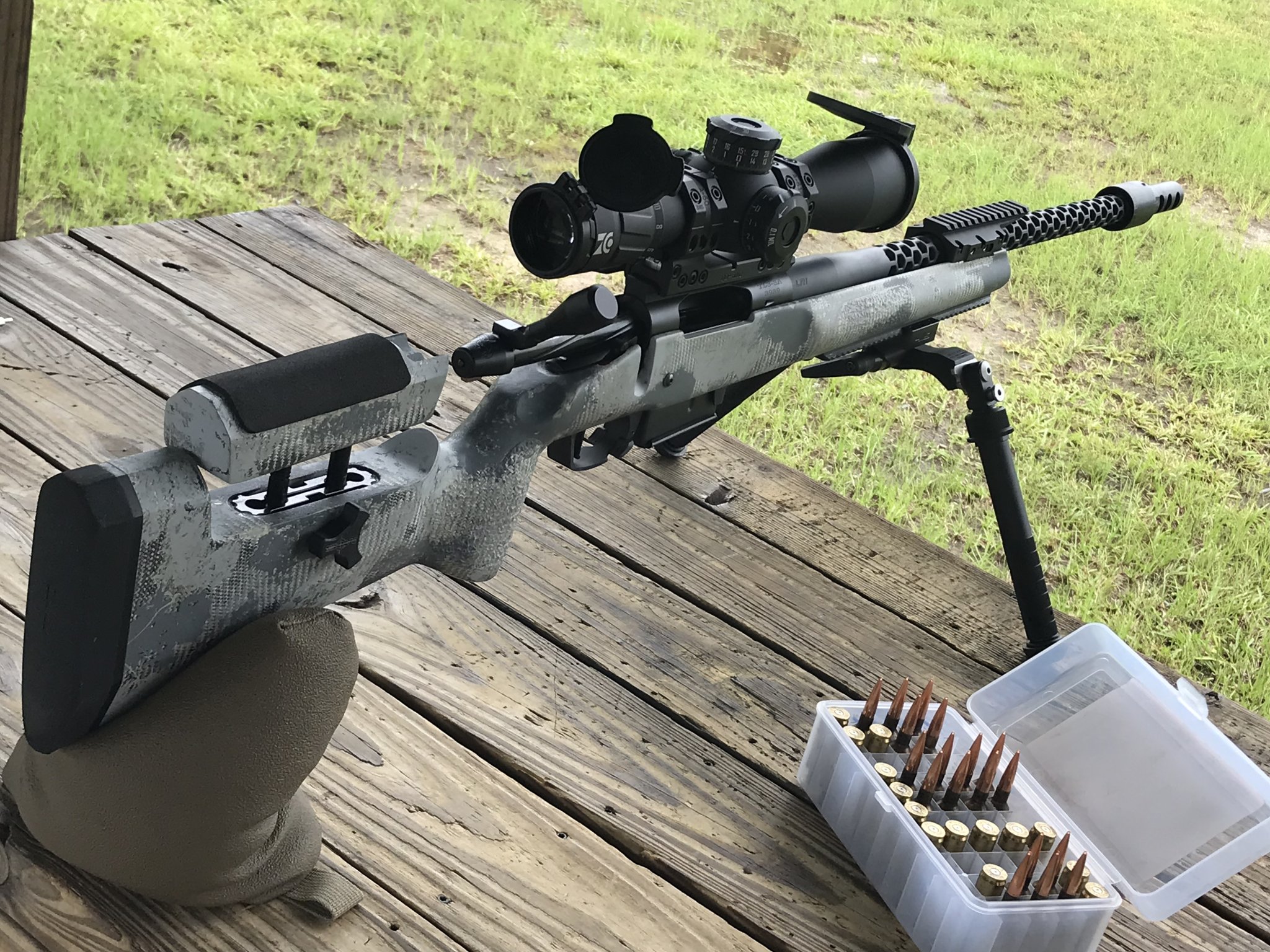

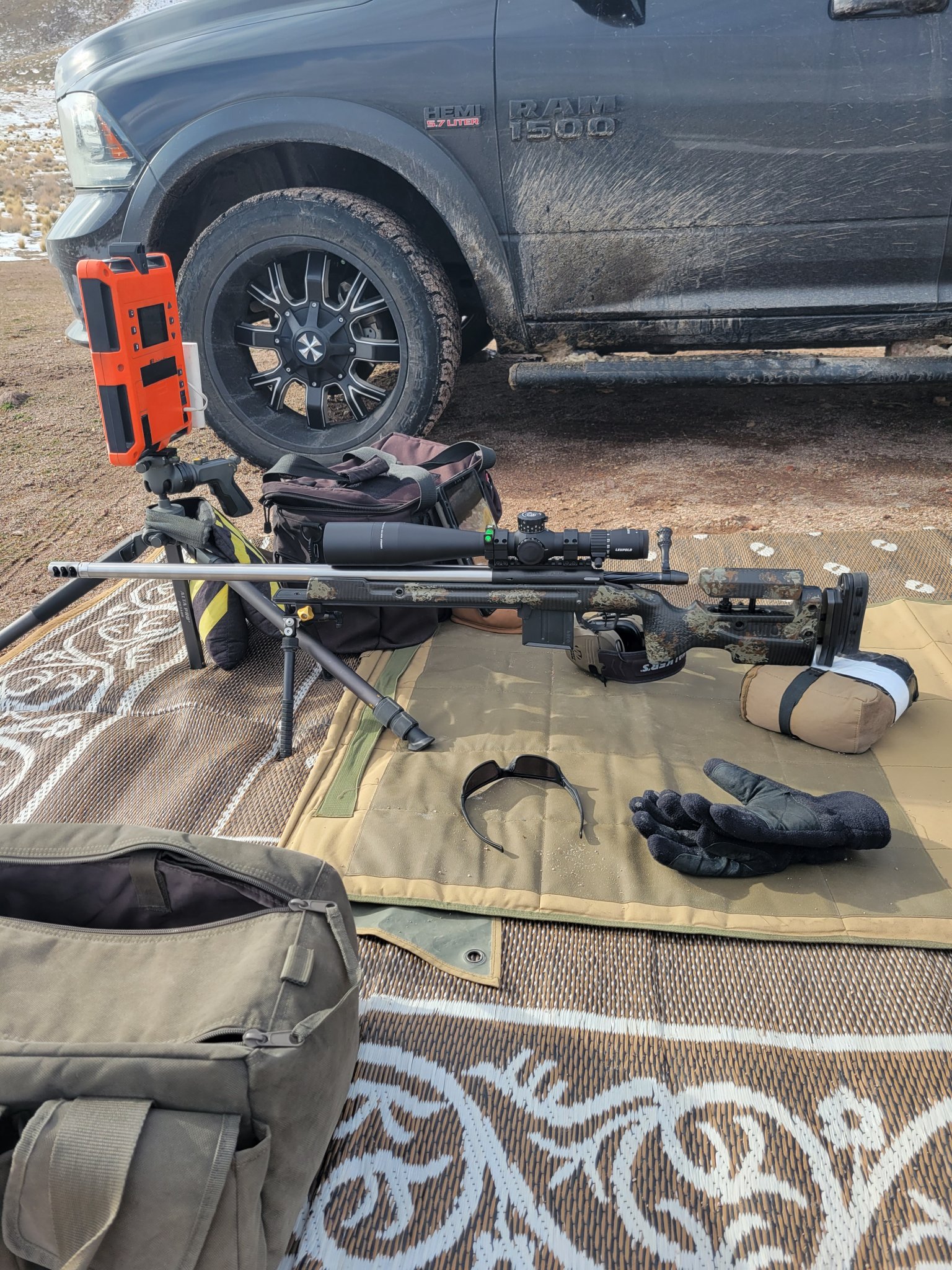

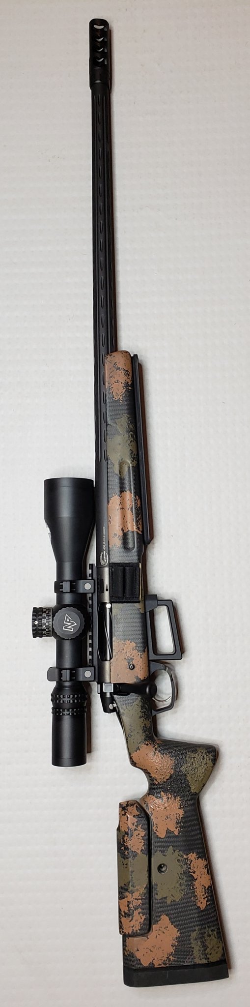

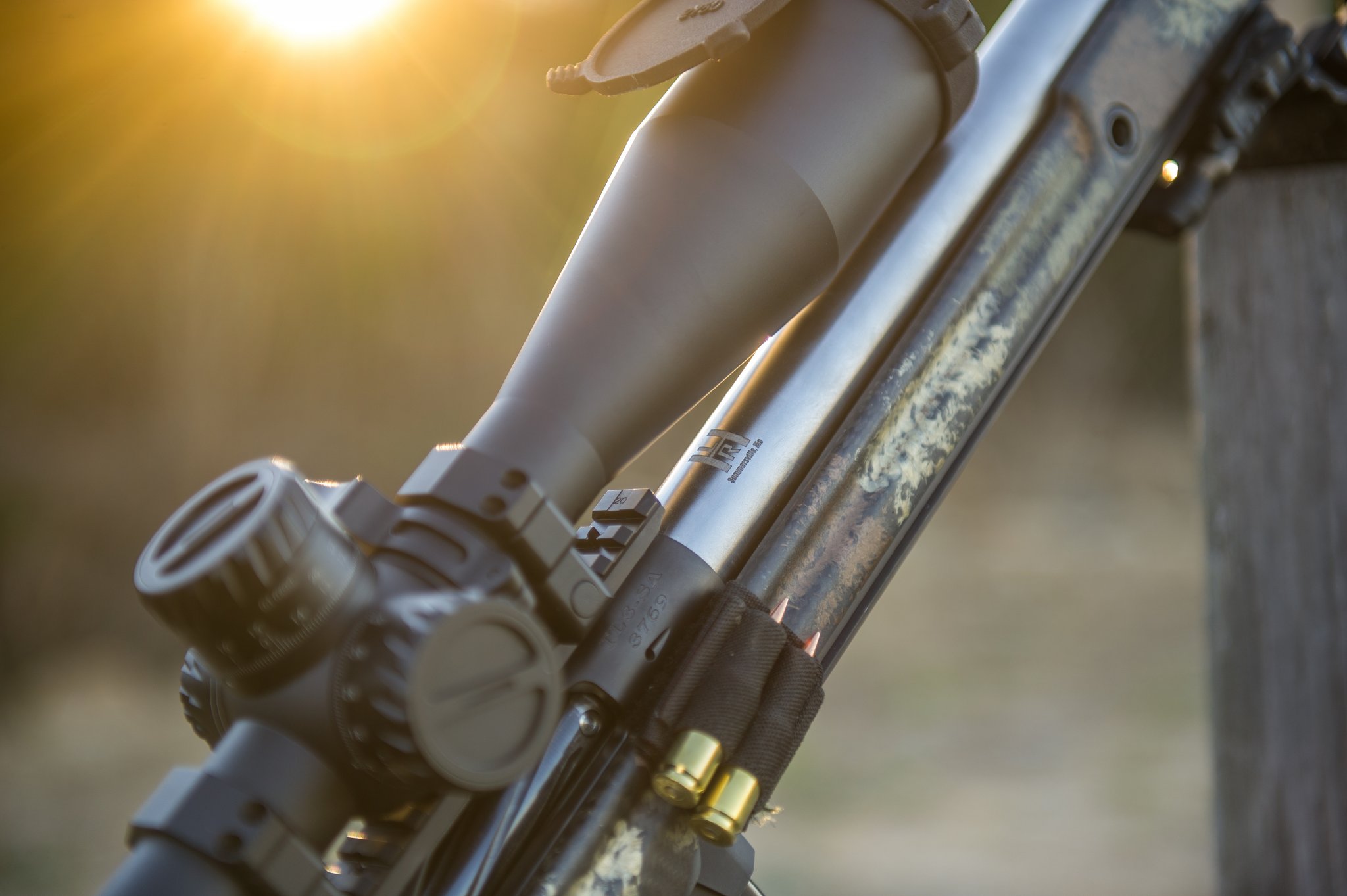

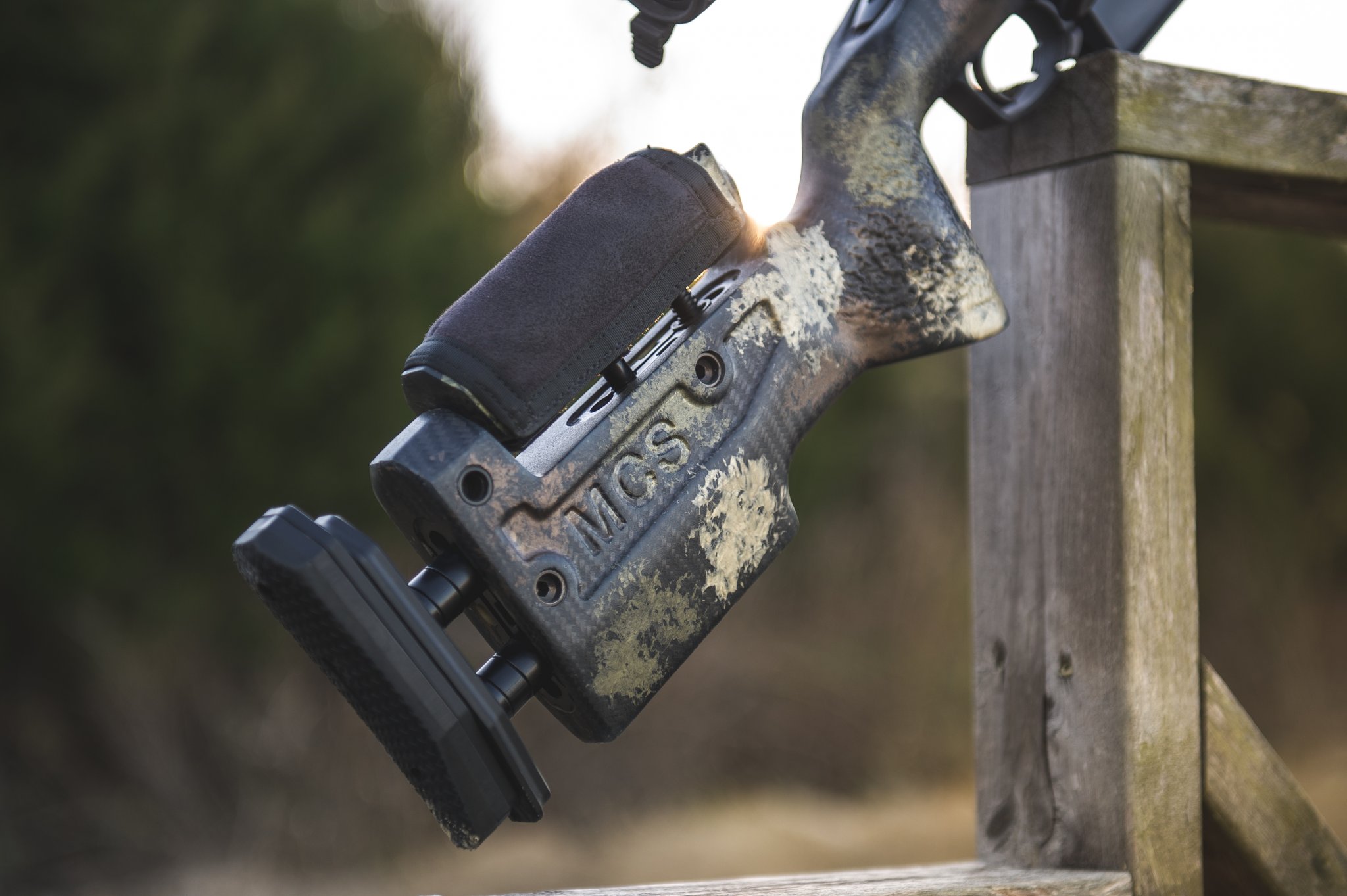

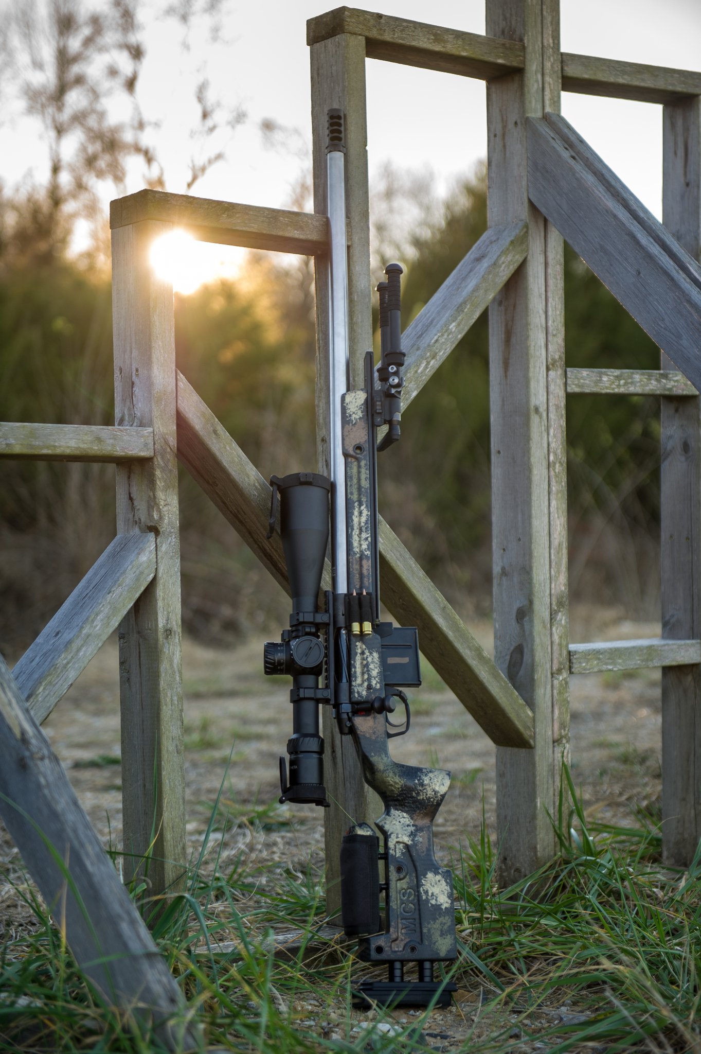

My TL3 has been through an ungodly amount of changes, but really happy with where its at now.
6 Dasher from Hunts Long Range sitting in a Manners TCS
ooh...the A419 bolt knob replacement kit...you should write atutorial on how to do that mod. I am hesitantly tinkering about that move (remove the stock one the proper way)
