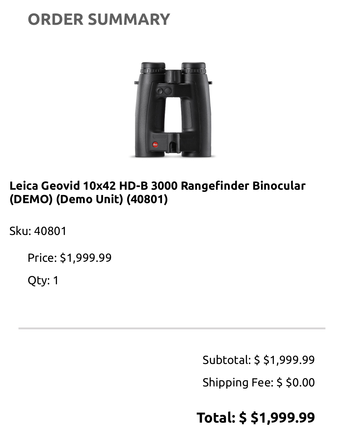

If you can wait till there’s a demo sale
I had Zeiss before that were awesome too.

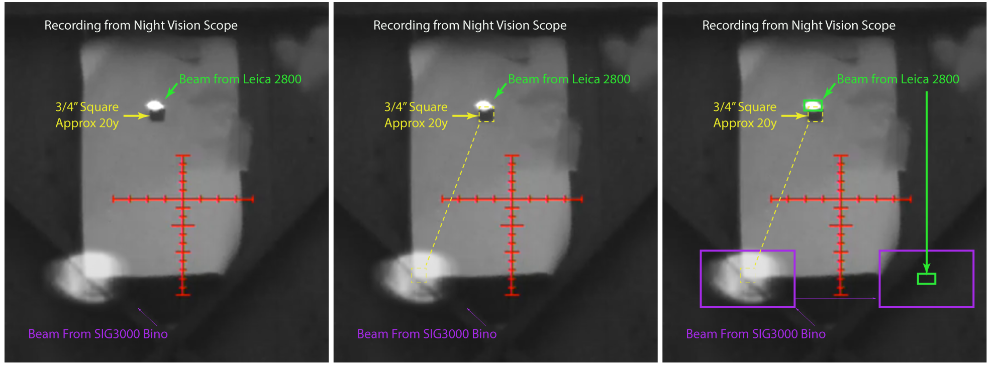

BTW - as your thinking also about a PLRF, you might want to see a tips and tricks thread I did for our UKD Team match. It is a Sticky in the Advanced Marksmanship Forum: https://www.snipershide.com/shootin...-for-ukd-team-field-match-or-hunting.6980614/
The tip on using a PLRF is the 4th or 5th link down.
You'll see that not all beams are what people think they are; how to map what you have. A far return is just that; you want the correct return, especially in a hunting situation, lazing through loops in vegetation or skylined targets. We set up a few in the match to test teams' awareness of the shortcomings and knowledge of how to work around them; it defeats a lot of the teams. In fairness, we only set a few targets like that or people would not have as much fun.
Below is an image from that thread.

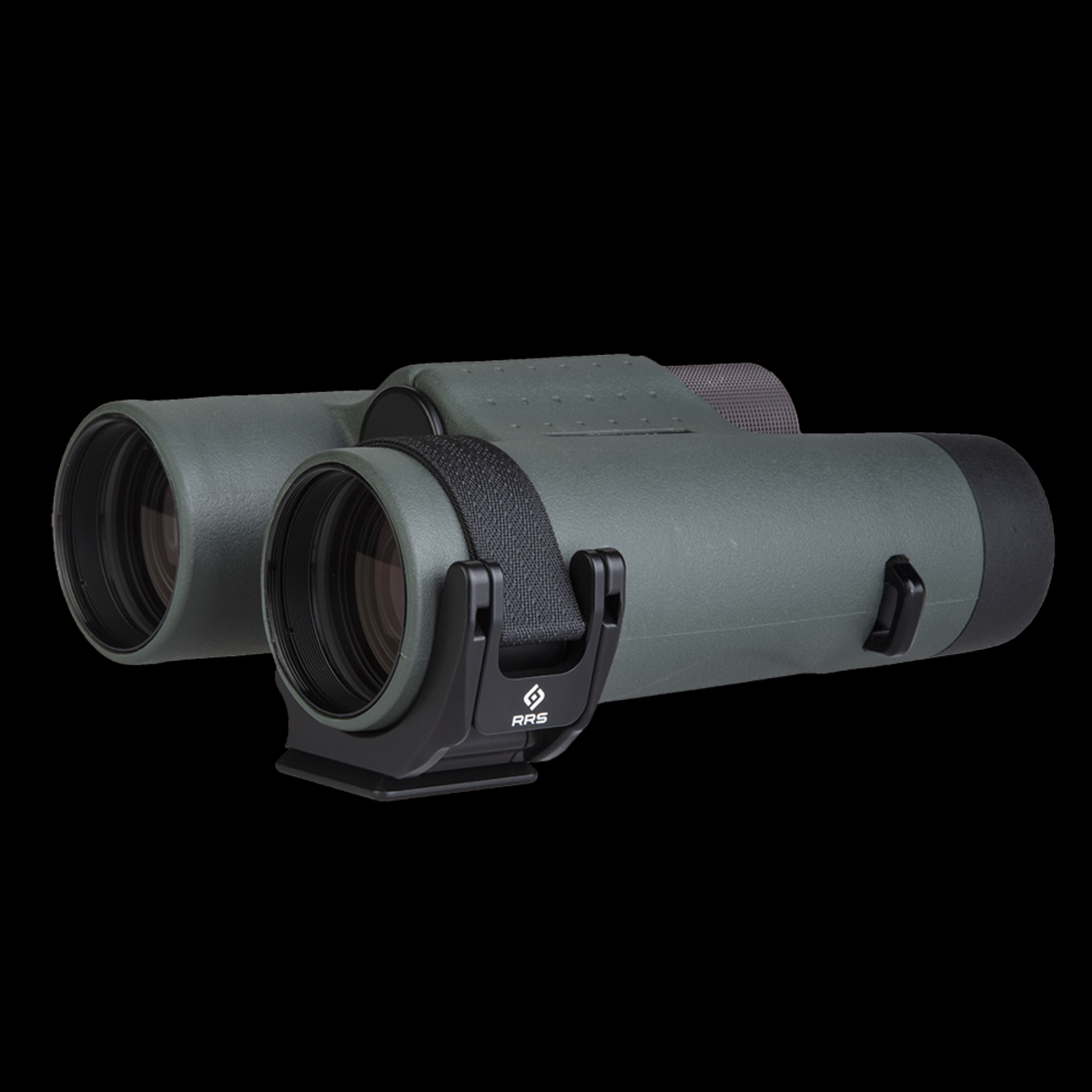

@gr8fuldoug - Just ordered the Kowa Genesis 10.5x44 from you. Tagging you for the mount solution below. I know you sell a lot of these Kowa's so you probably get asked often.
I doubt anything can compete with the Genesis glass at this price.
Must have had more then 1 open box. Still showing open box in stock.
The only down side to the 10.5 Genesis is it doesn't have the 1/4" x 20 thread for an outdoors-man type mount.
Problem solved thanks to RRS & I know it fits because they actually use this Kowa 10.5 x 44 in there advert for the mount.
