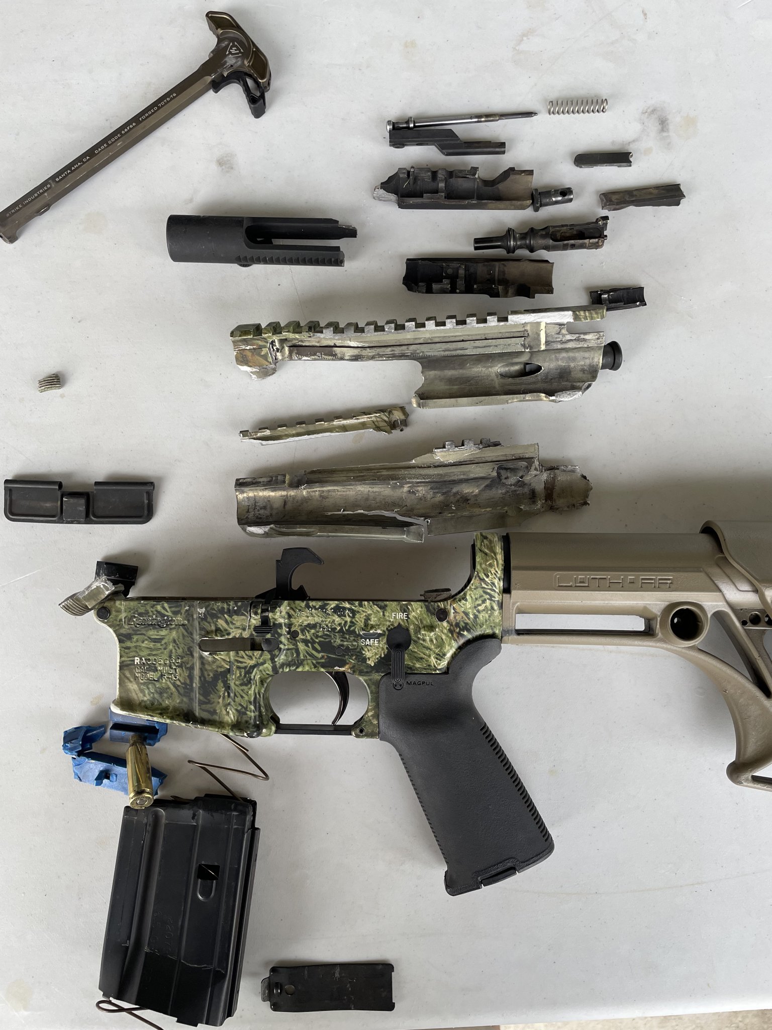

He was shooting from a bench with bipod and squeezing a rear bag with left hand so only sustained a 2" long cut on his arm and small cuts on his face if he would have been shooting with left hand forward he would have had far more serious injuries. When he brought the parts over yesterday he was still shook up pretty obviously.

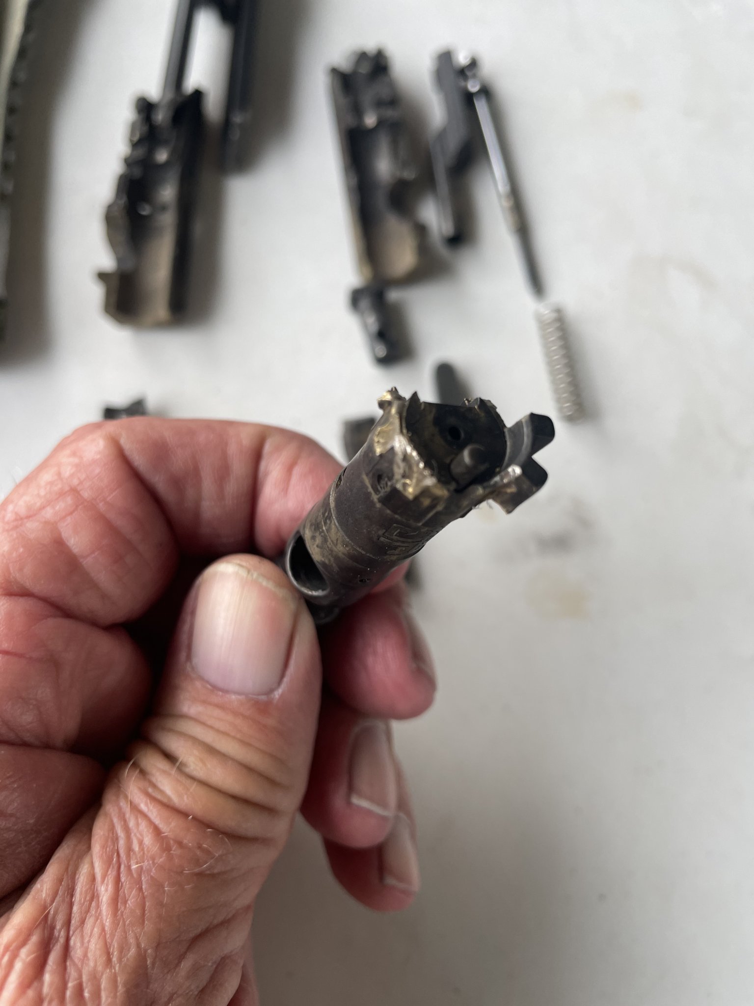

I'm wondering about my understanding of the pressure vectors when the trigger is pulled. Ok, so the primer fires up a lot of pistol powder, there is a huge pressure spike. Since the case is mostly long and thin, most of the pressure is sideways, not back against the bolt face. Is that statement true?
I can imagine that the pressure sheared off the bolt lugs because they are visible in the picture. And now the bolt is moving toward the shooter. Why would the bolt carrier be torn in half? I do not doubt that it is - that is clear in the pictures. With the bolt torn away, the space to hold the expanding gas cloud is much larger so the pressure should drop really fast. Considering the pressures and velocities, except for its mass, there is nothing preventing the bolt carrier from going straight back toward the shooter. Why is the bolt carrier torn apart?
