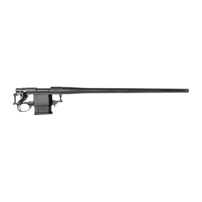

I have a Howa in 308 that needs to be rebarreled. I want to go with 22 arc or 6 arc. How difficult is it to change the bolt face? I know I could go with the 22 or 6 creed, but I already have 3 creedmoors and looking for something with less powder charge for plinking.
Howa makes Mini Action with the Grendel bolt already. If you keep it Grendel, you can spit a 100-110gr faster than a 6mm and match the ballistics downrange anyway. Also gives you 124 factory loaded ammunition options out there.
The Howa Minis are almost like a rimfire in size/weight, very fun and easy to carry around.
I'm not sure it's doable. At least not in a fashion that makes sense. Anything is doable if you throw loads of money at it.
The best option would probably be to buy a mini action and put whatever barrel you want on it.
I’d leave your current 1500 action as a 308 based cartridge and get a Mini in either ARC or Grendel and put it in the Stock/Chassis of choice.
I have two Mini’s and a 22-250 Short Action, and seem to grab the Mini for knockabout and plinking over the SA. All three are very accurate for a less expensive rifle.
All three have sporter barrels, not heavy barrels.
