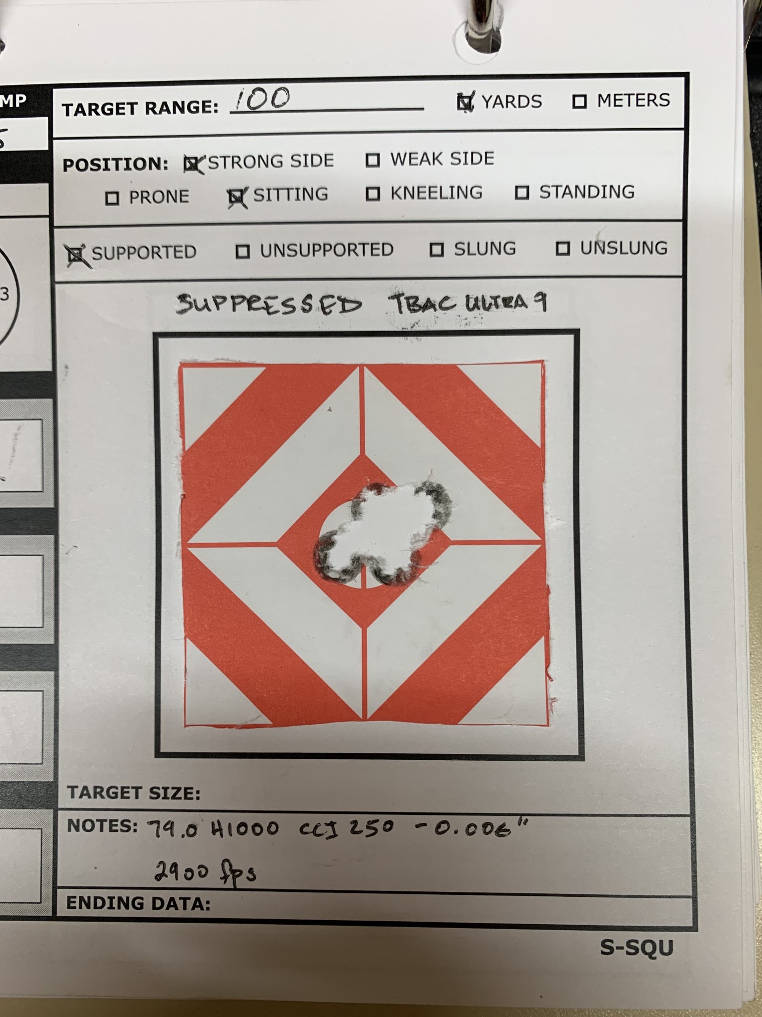

I’ve been using the Berger CBTO method of .010,.050,.090 and .130 off the lands to get a rough estimate of where to start looking for where my sweet spot for seating depth on some new bullets. Today I went to the range and I shoot five of each of the above mentioned. The loads that were .050 and .090 off the lands look like a shotgun pattern at about 3 inches at 100 yards. I’ll include some pictures of the .010 and .130 off the lands from one extreme to the other LOL. Which group do I start working with in your opinion and why? The .010 group started off horrible and the last 3 are in one ragged hole. The .130 jump loads are pretty good for a hunting rifle but man they look funny loaded so far in the brass.

Those are 5 shot groups .050 and .090 were so bad i didn't even post those. I want to say that the bigger group of .900" with the last 3 at .260" would be what I should work with but I am not a expert at this.
