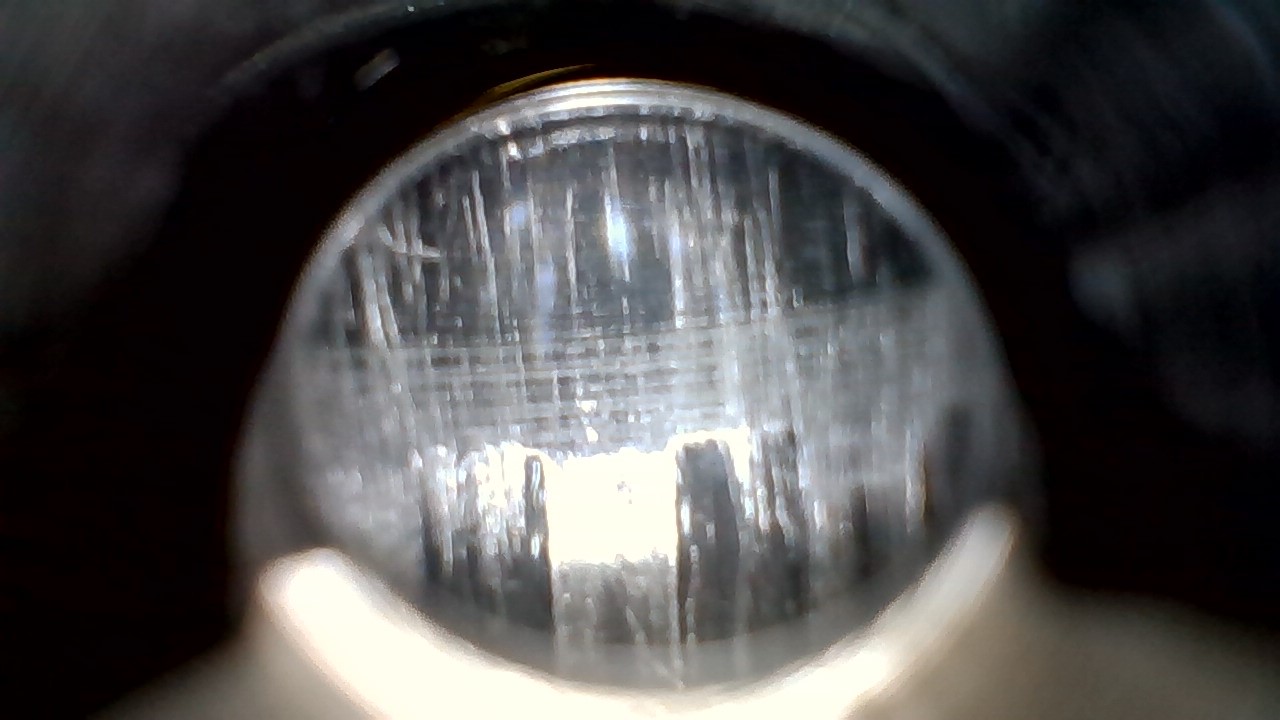

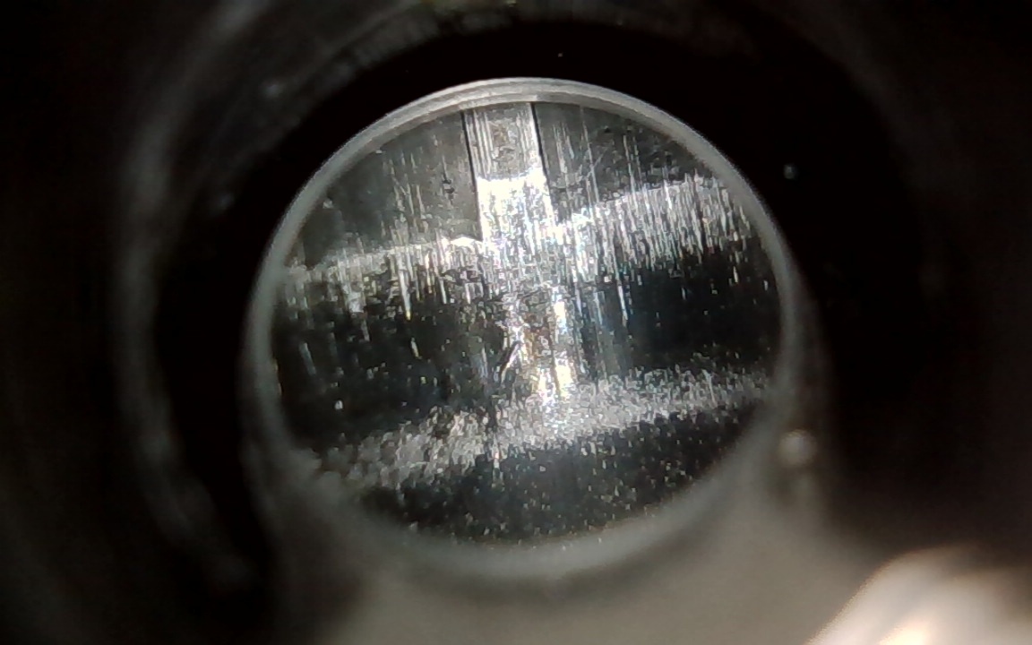

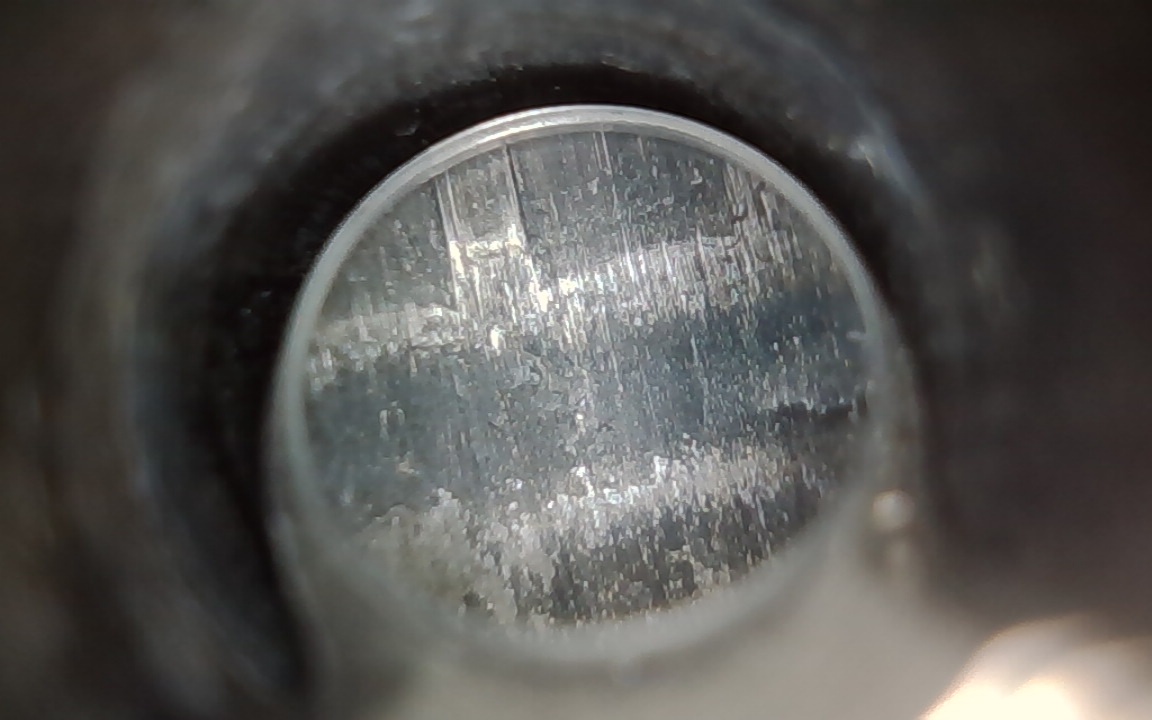

Getting ready for a local match. Barrel had 400 rounds of Lapua Center X through it.
Photo 1: jag, patch, and 4 drops of BoreTech C4
Photo 2: pre clean chamber
Photo 3: patch after 15 min soak and 3 full rotation of the patch inside the chamber
Photo 4: cleaned chamber after 1 dry patch
Very simple and quick carbon ring clean up.
My factory Bergara B14r chamber is black, like burnished metal and the silver metal is probably where the opening of the case scrapes the chamber. Regarding the black ring between the rifling and the silver ring, I don't think that this is a carbon ring since the light from the bore scope reflects (compare photo 2 and 4).
I'd be interested in your thoughts and opinions.
YMMV and happy shooting

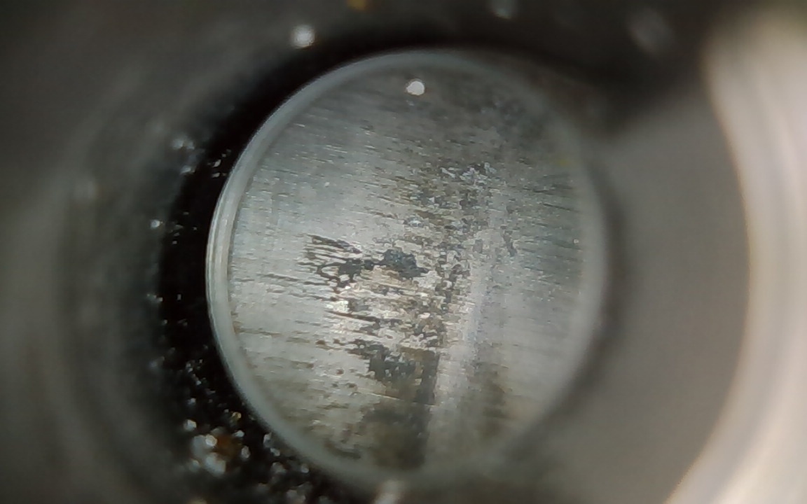

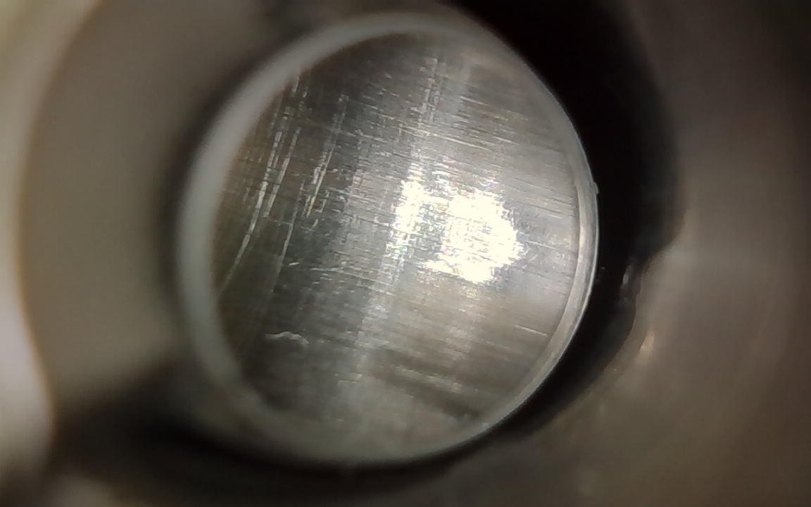

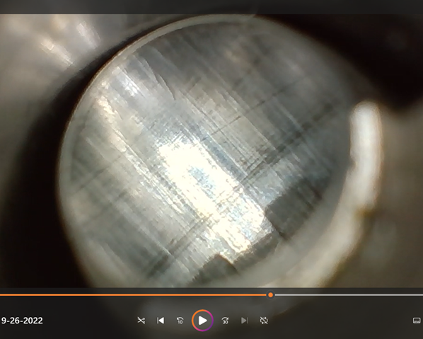

If you have some extended time shooting that before trying C4, maybe you need to use an all-Brass brush to clean that off? Here are b4 and after on my Sav-64 that I 'cleaned normally' with H#9 for several years before I got on the C4 wagon. The b4 is a bit blurry but looks like your chamber. You may have got most of the Carbon, but there's a lot still there. I'd suggest that you try leaving the very-wet-patch in the chamber overnite, then if that doesn't clean it, go for the brush. Just a few seconds rotating in the chamber may do the trick.

The overnight soak and quick plastic bristle scrub didn't loosen any more carbon on the wet patch or subsequent dry patches. The chamber had the same black burnished and reflective surface as my previous post. The first photo is at the same location as my previous post after the overnight soak, the second photo is the csame reflective black color at the mid point of my chamber.
No cold bore shifts during the match today, shot probably a .25" bughole group during 50 yard zero. The rifle shot really well, my positional shooting was kuch to be desired.

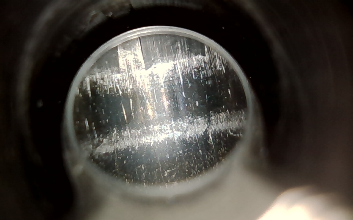

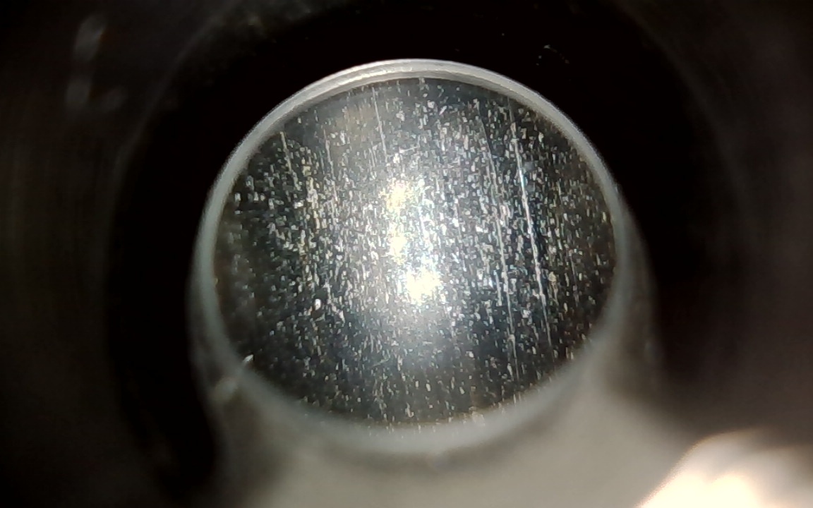

Cz457 Lothar Walther barrel with ~250 rounds.
Carbon ring photo 1.
Photo 2 = 10 min wet patch, 2-3 turns of the wet patch in the chamber and a dry patch and it's clean as new.
Love the Bore Tech C4 and kind of smells lemony fresh too.
Ymmv, happy shooting

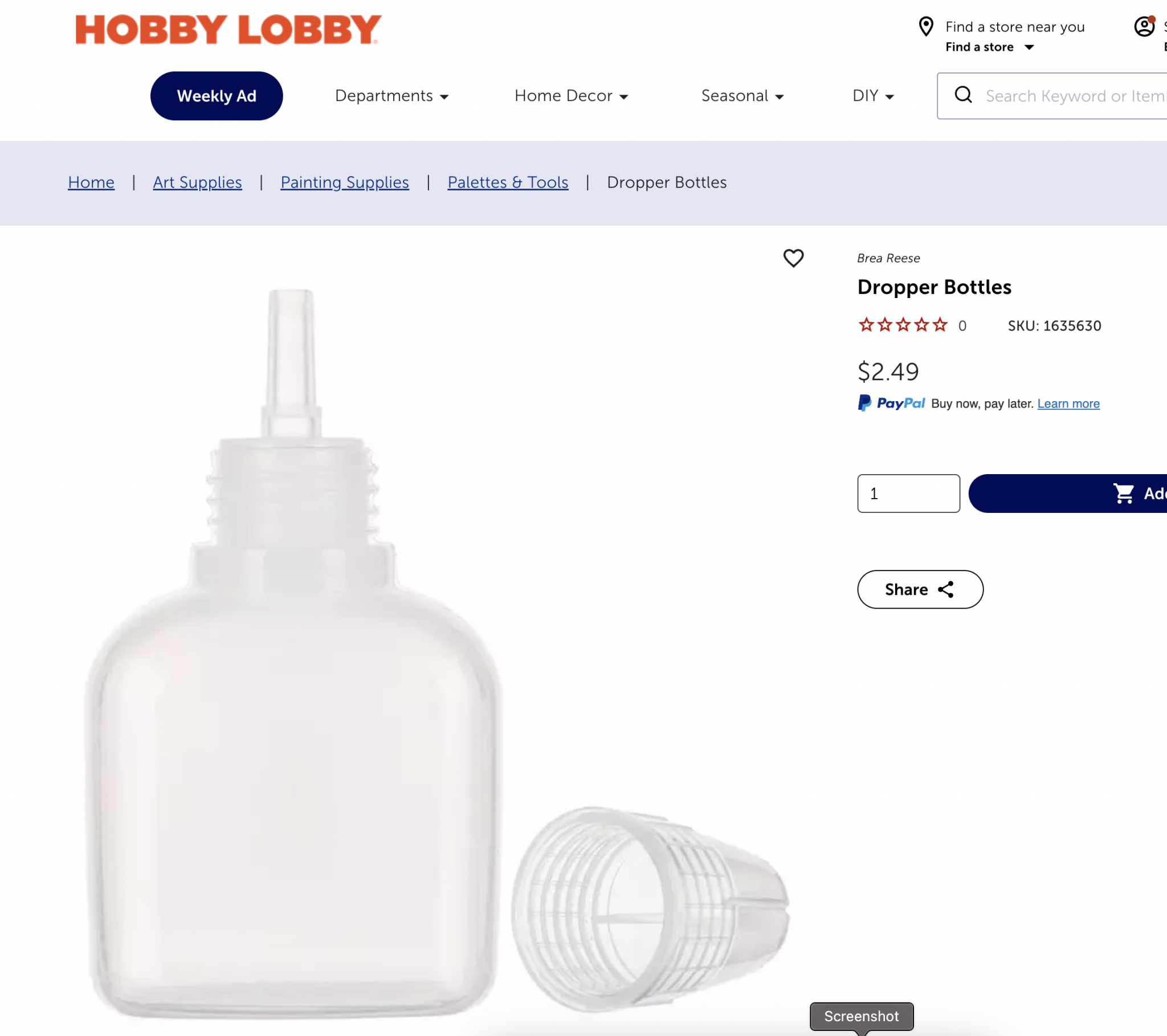

I use these dropper bottles. A 3 pack available at Hobby Lobby. They don't leak and I have used them with Boretech RFB, C4 and Hoppe's #9. The nozzle comes out so you can fill them from the Boretech bulk bottles, insert the nozzle, put the cap on, and it's ready for use.
