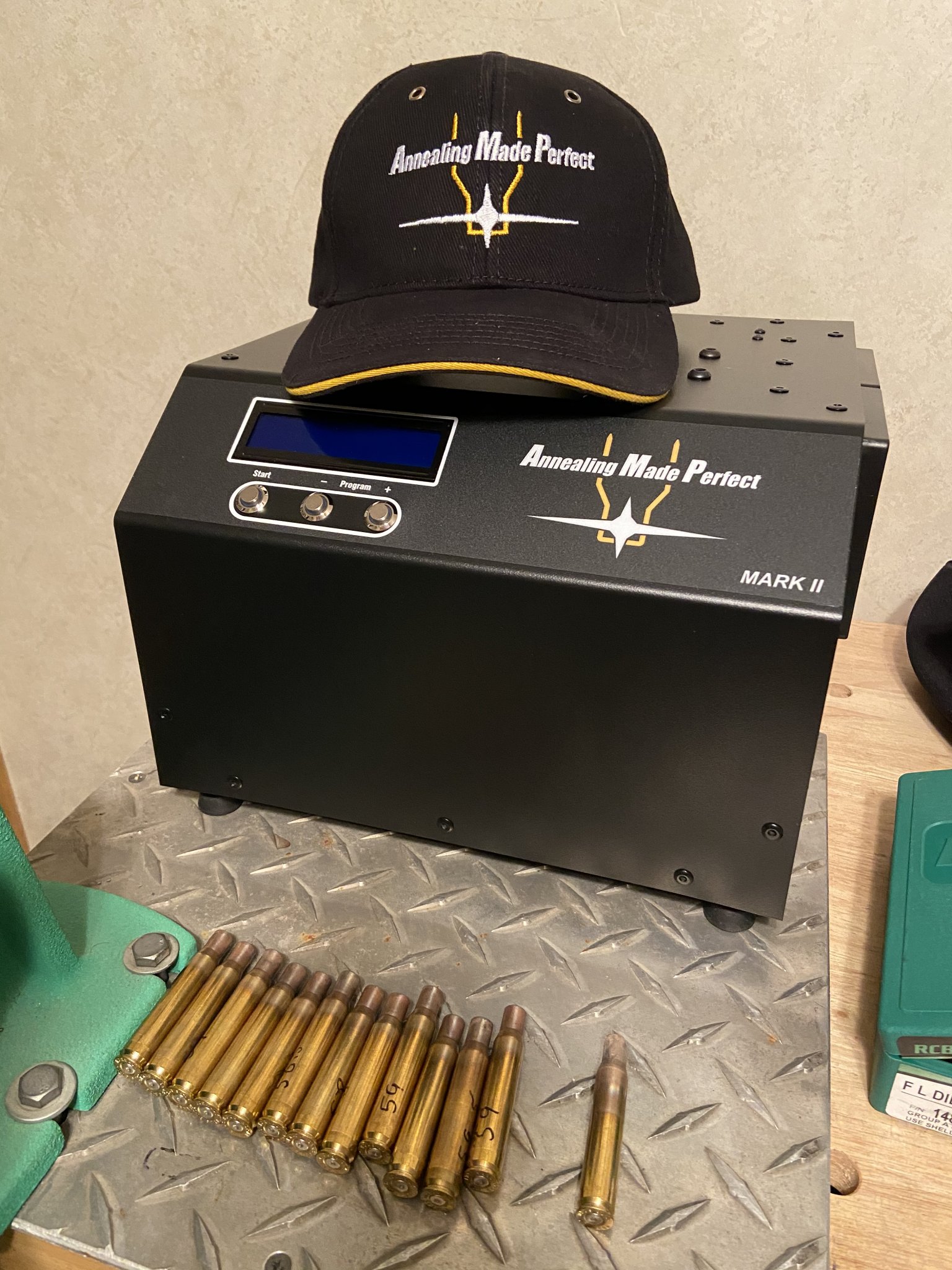

Having spent hundreds on Lapua Brass I've decided to go a little further down the rabbit hole on my reloading process. Take a look at the Annealing Made Perfect product. A little pricey, but I wont destroy my investment in the Lapua Brass.
https://www.ampannealing.com/index/
Reactions: 232593 and BCX
