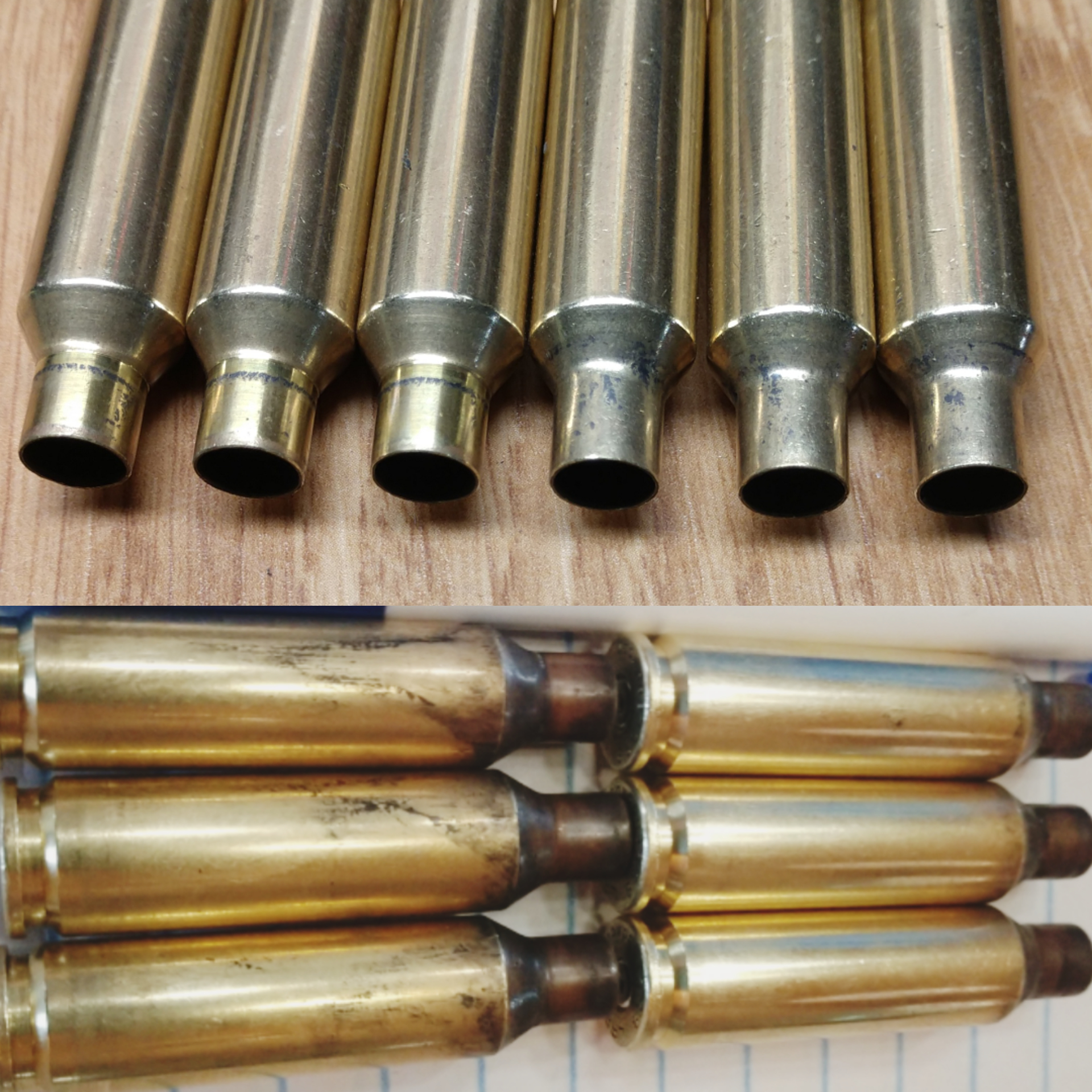

Lastly, I post up a photo of the Brass used in the above video.
Of the top 6 pieces, the left 3 were Full Prep and right 3 No Prep.
It's clear that the Full Prep are showing favorable signs of efficient sealing compared to the Non. (Based on Carbon Ring)
I included the Bottom 6 cases to show that it's not always a clear cut indicator though. (For new reloaders)
The left 3 are the first case fired from cold bore of a 5 round string.
Three strings fired, each from cold bore, each from the next morning or consecutive day.
Why so much Carbon on that cold bore shot? Poor Prep or development??
No, that Brass is a solid performer and has ran in the 6 1/2 SD's all throughout its 38 firings.
The poor sealing is due to some information I withheld.
It was fired at 20 degrees below zero, the rifle had been stored overnight at those temps along with the ammo.
The load had been developed during the Summer at 76 degrees.
All combined was the cause of a poor seal/burn that left the outer case resembling a neglected chimney.
