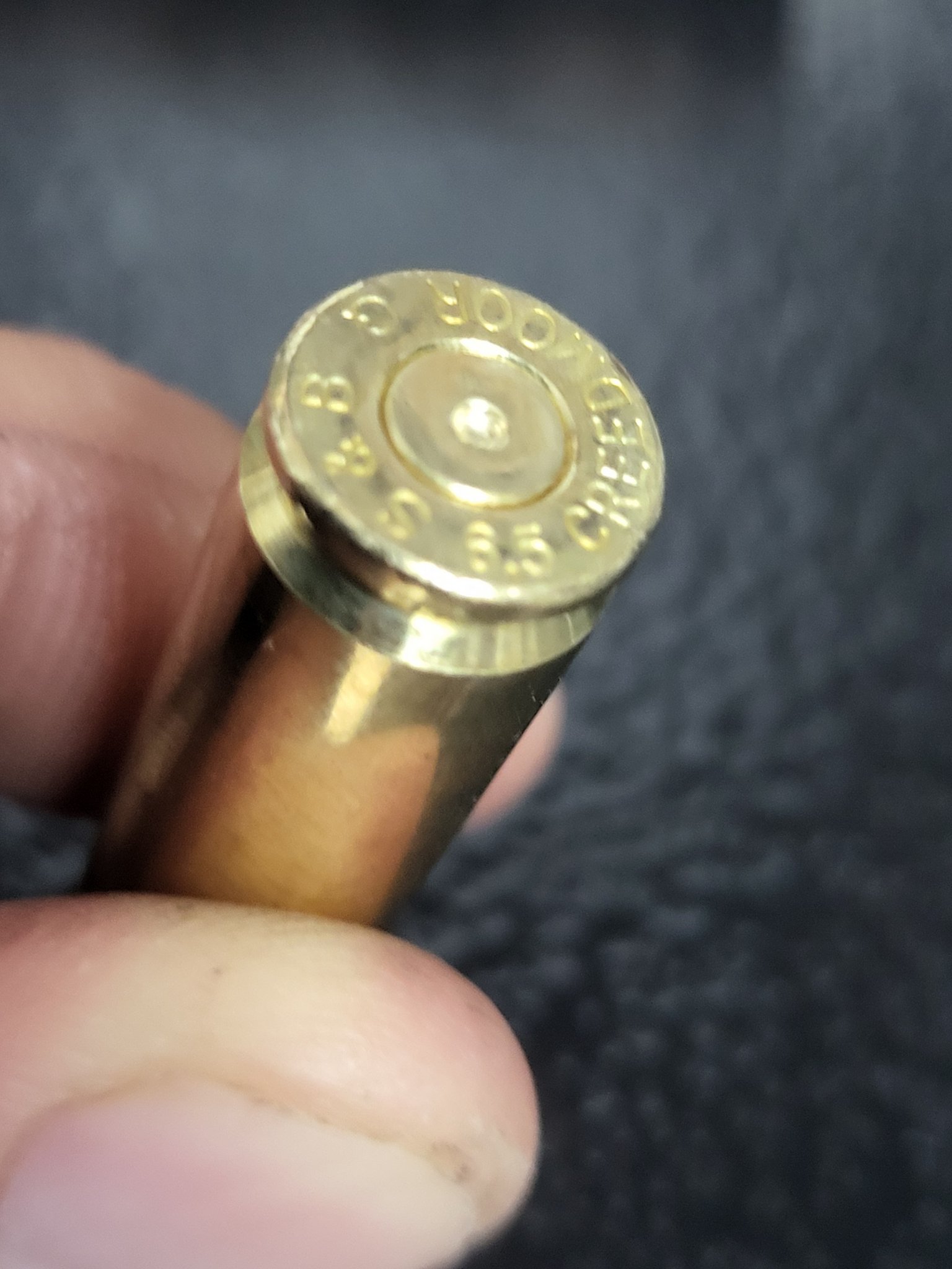

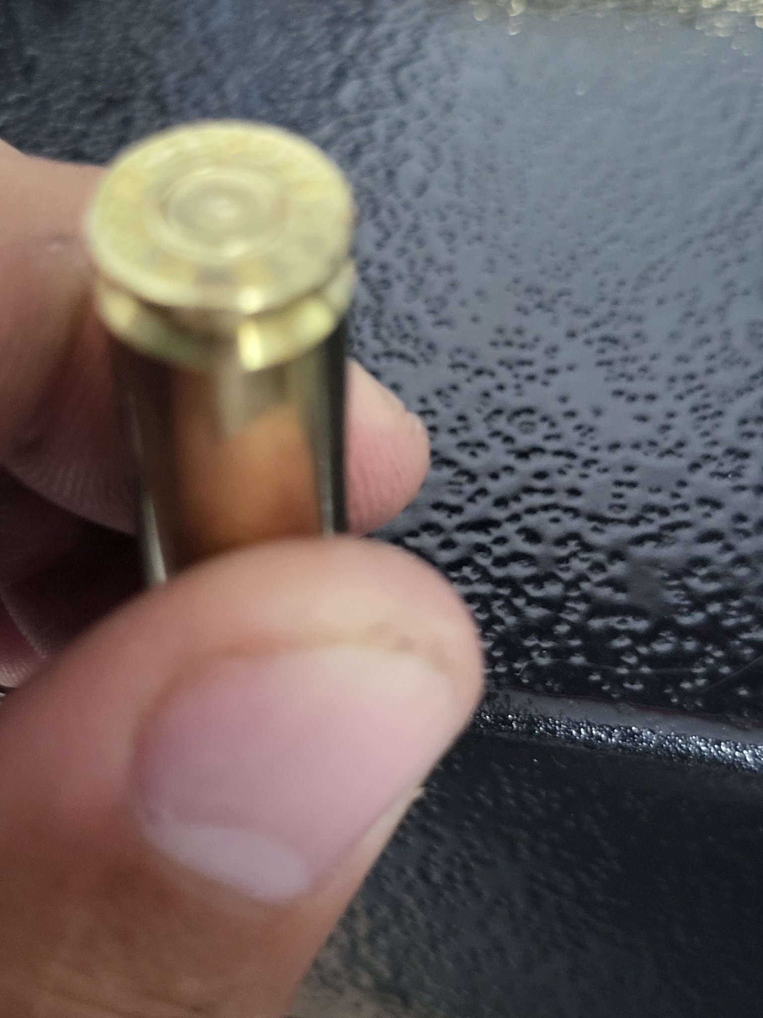

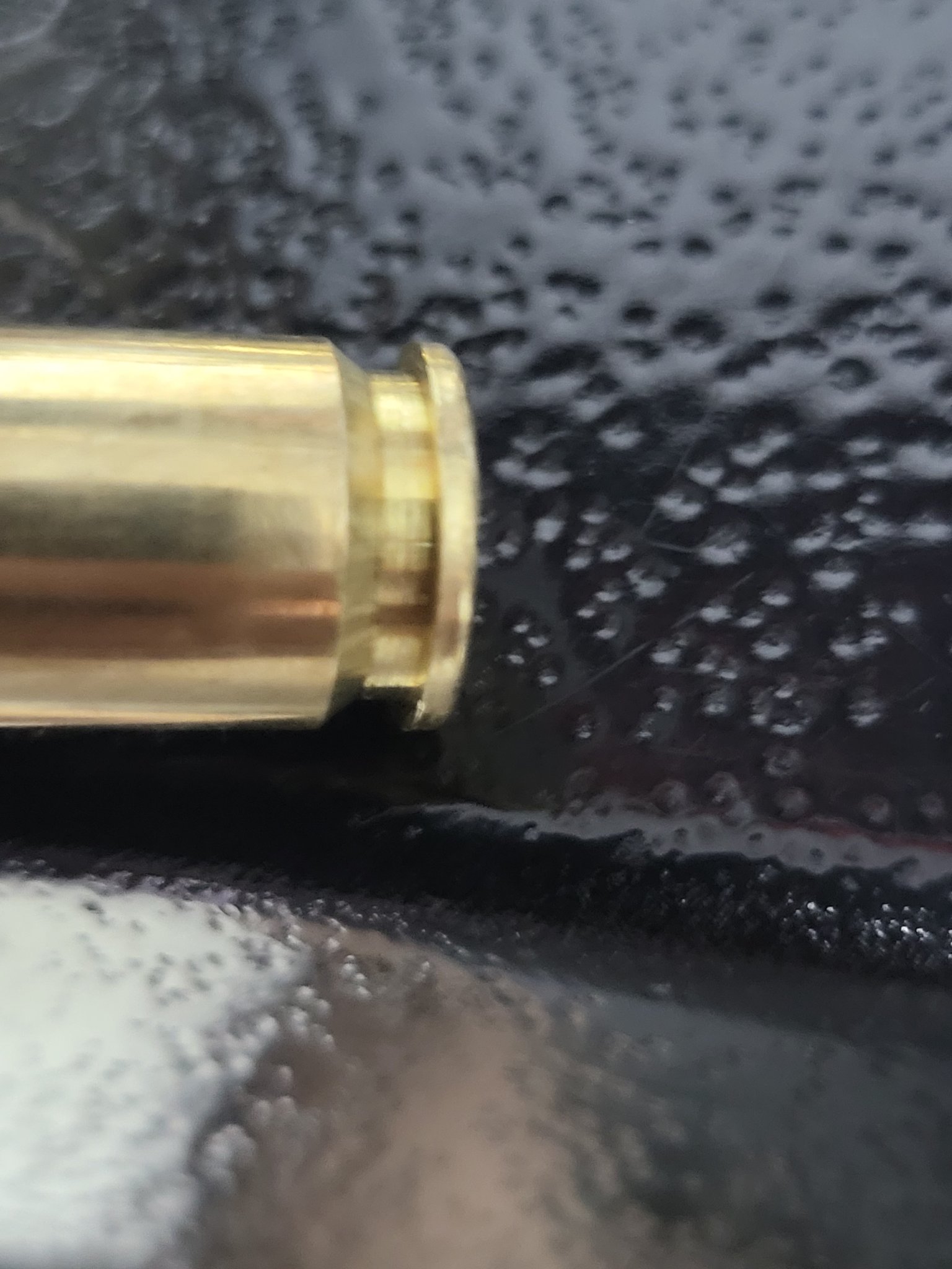

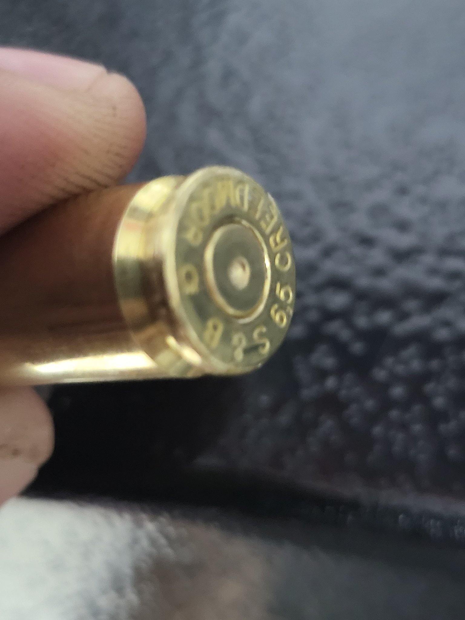

Brass remains in chamber, bolt locks back. Am I over gassed?
Jason3270
Apr 26, 2022
70
68
Usa

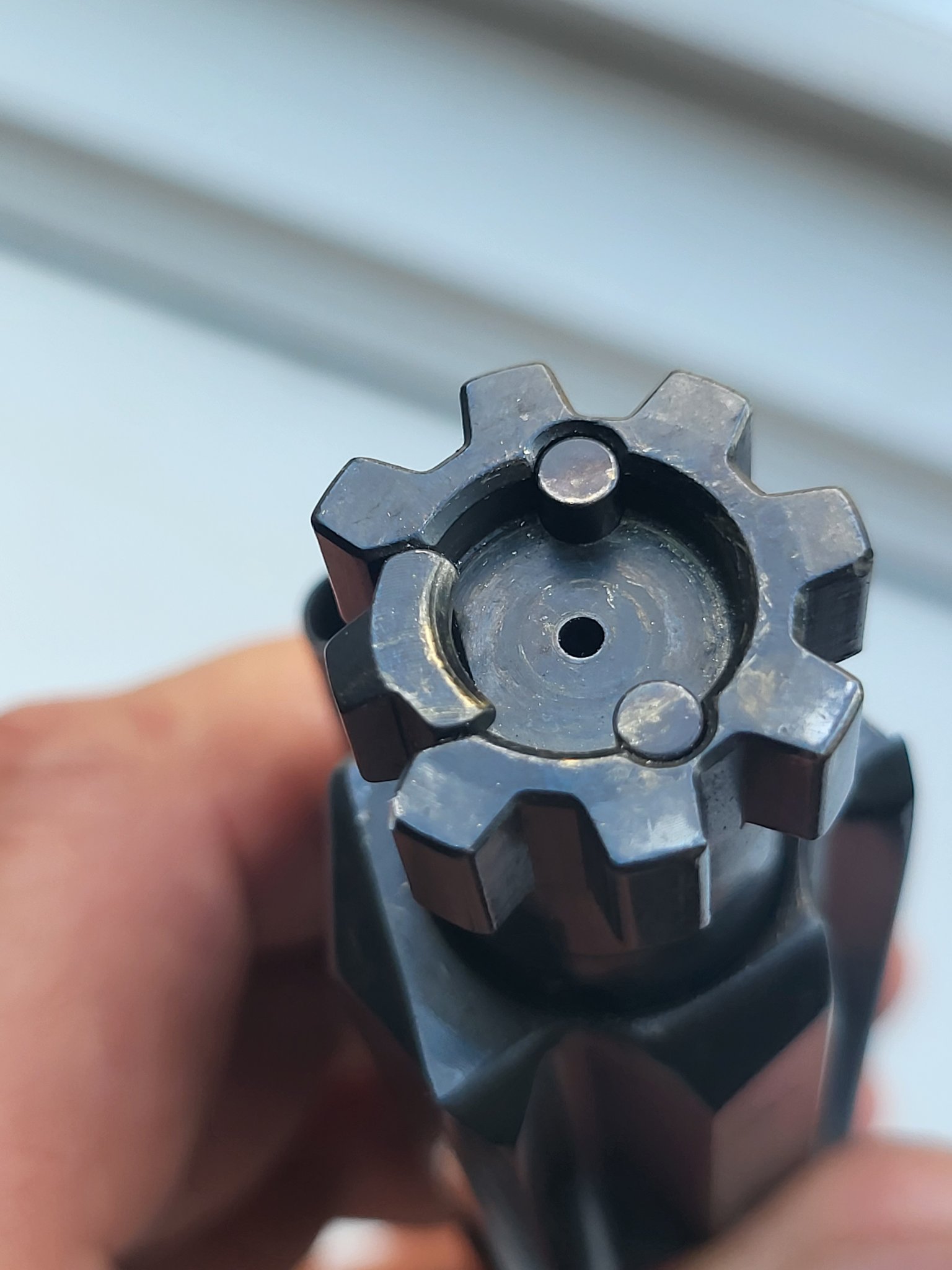

6.5cm AR10, Aero upper/lower/lpk. Toolcraft 6.5cm double ejector bcg. Odin Works AGB. Tubbs flat wire buffer spring, MP PRS Gen 3. Wilson combat 22" stainless fluted

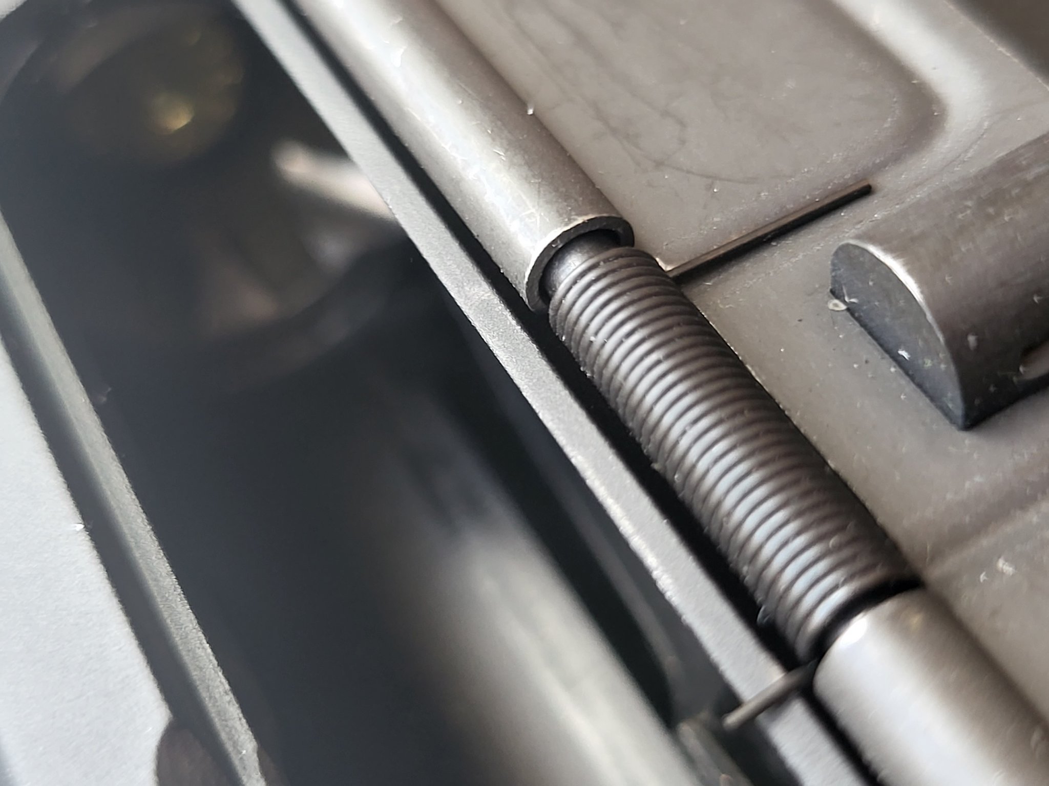

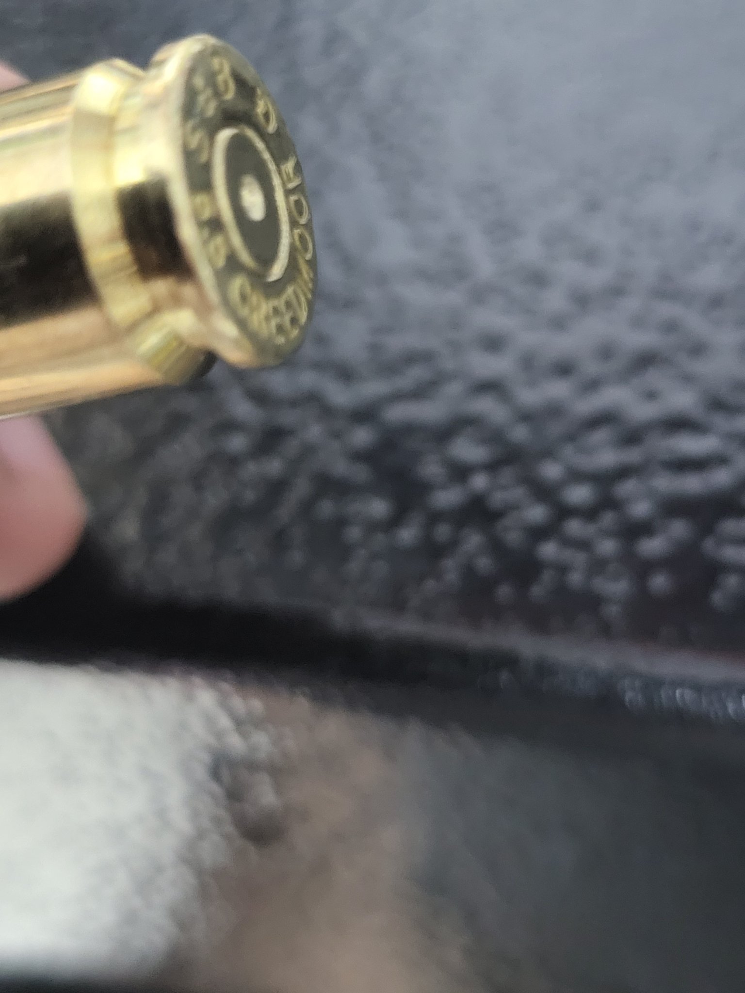

I'm not sure what they are supposed to look like but the look and feel fine to me.

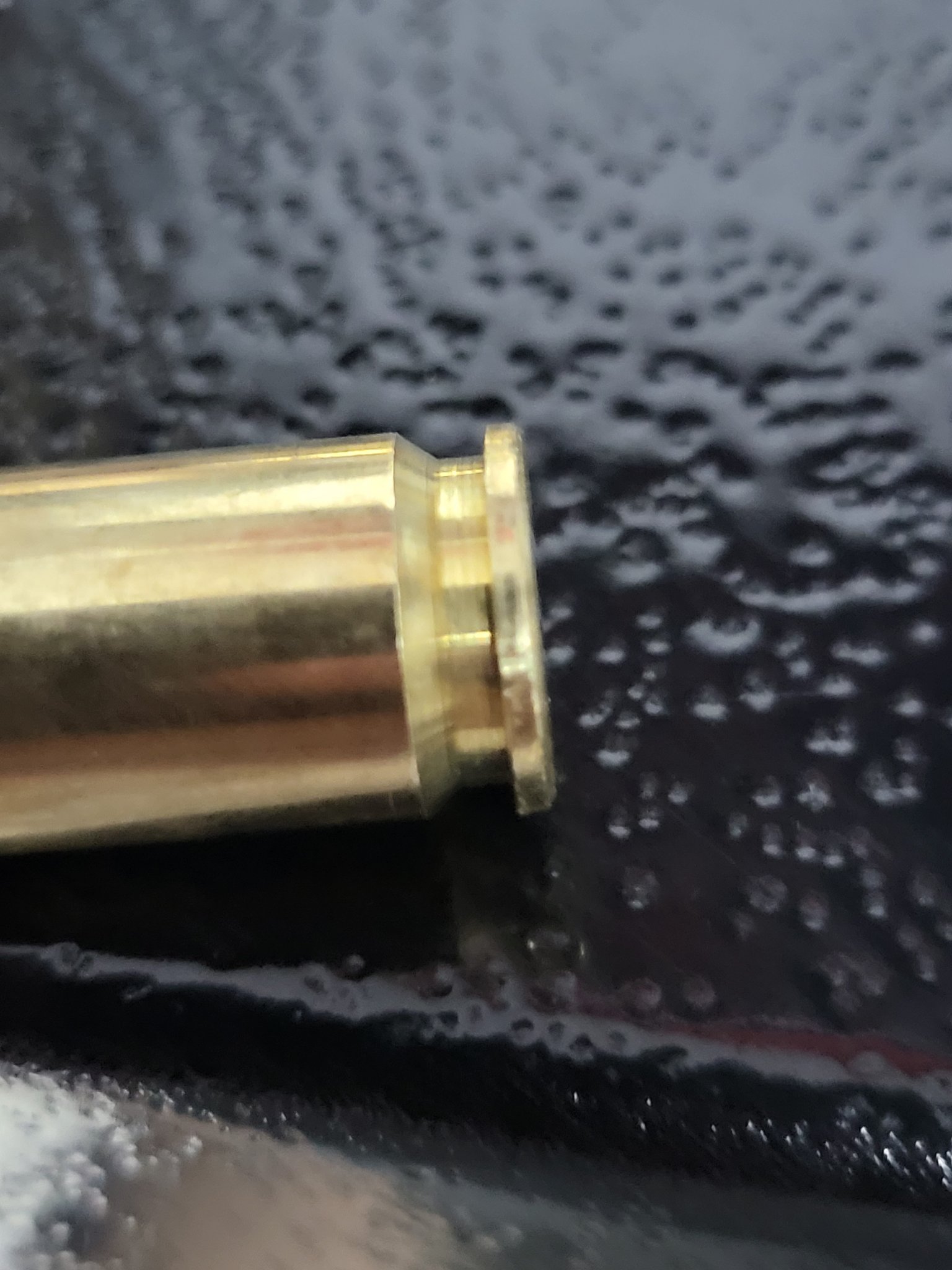

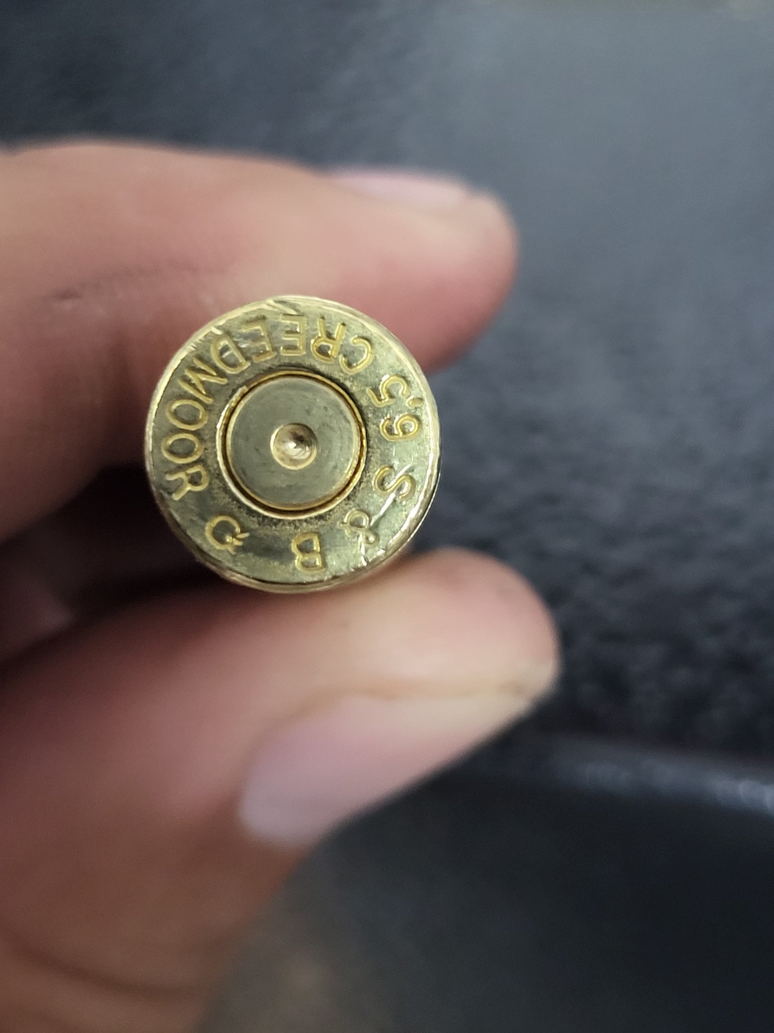

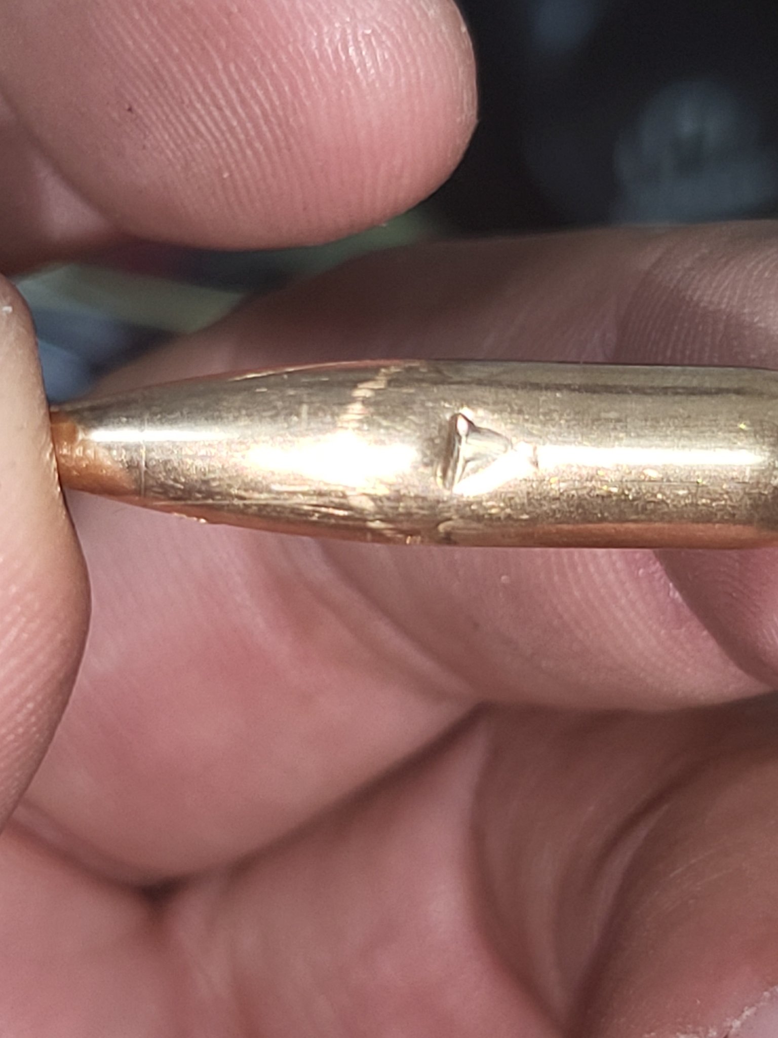

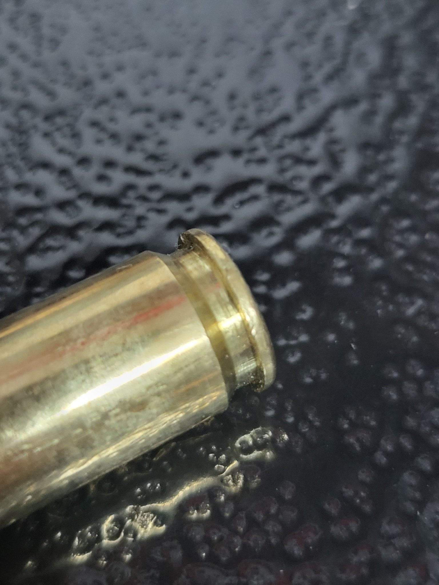

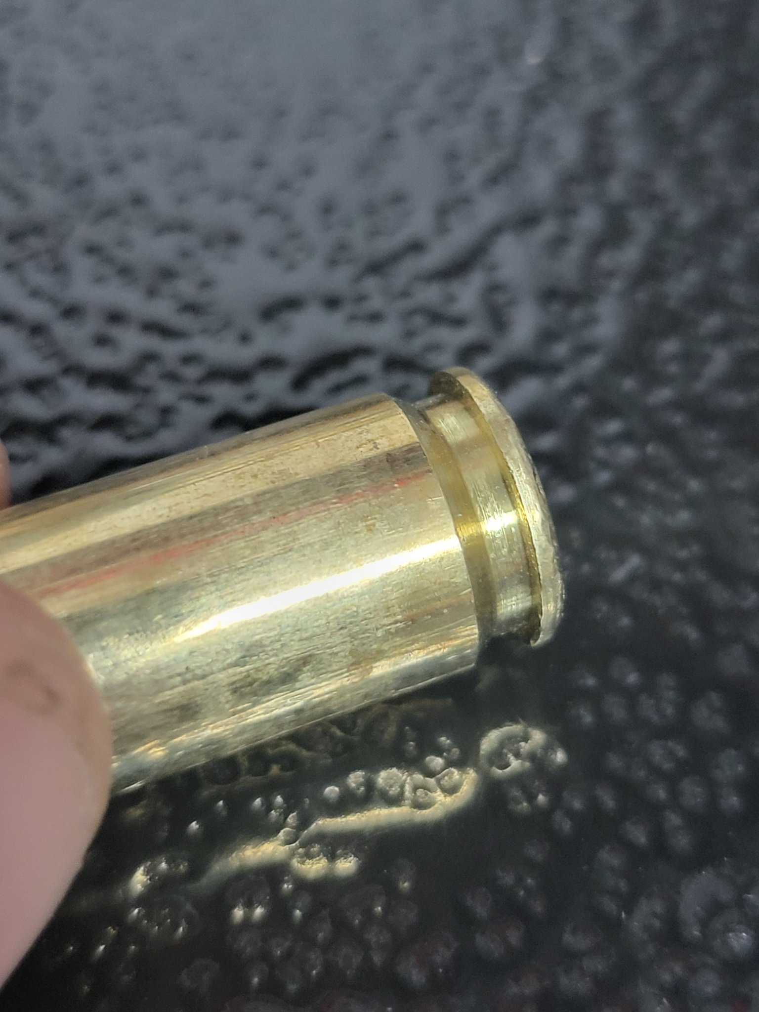

The fly out when manually cycled, although the fired round in the chamber is really difficult to extract manually. I need two hands with the butt stock on my chest to get it out

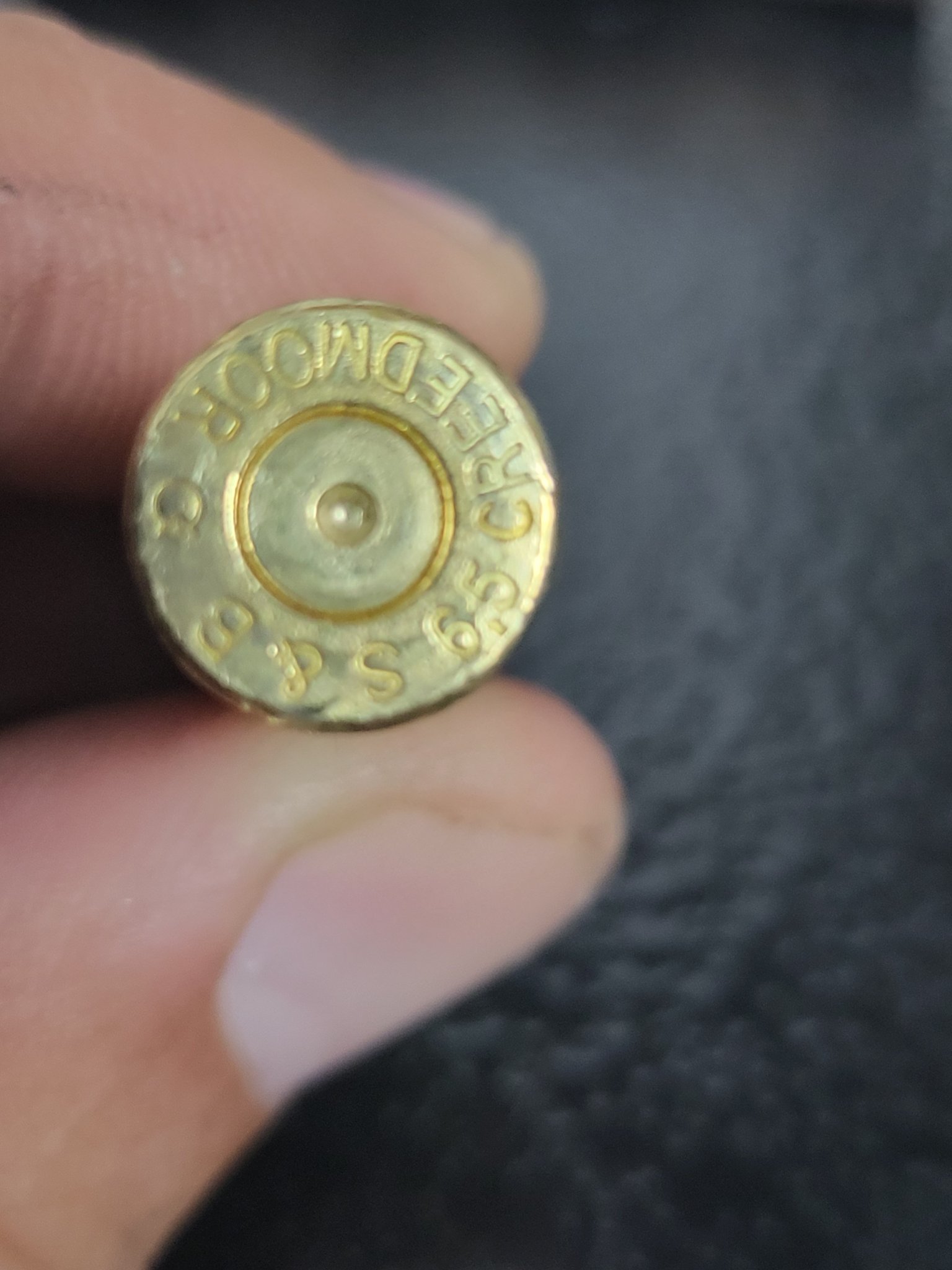

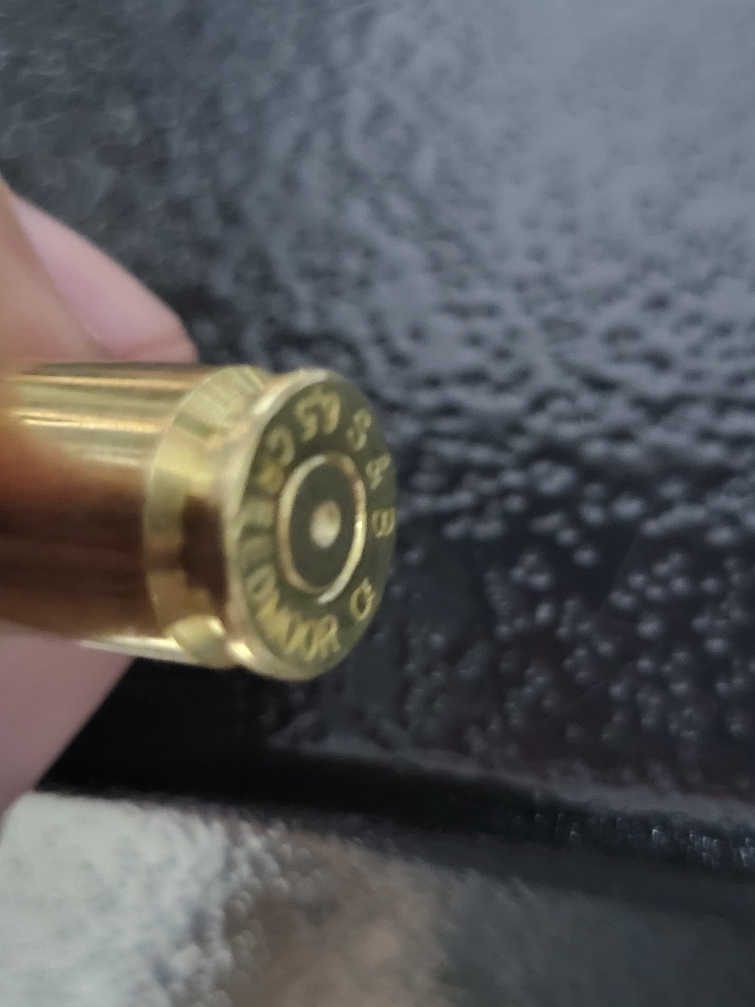

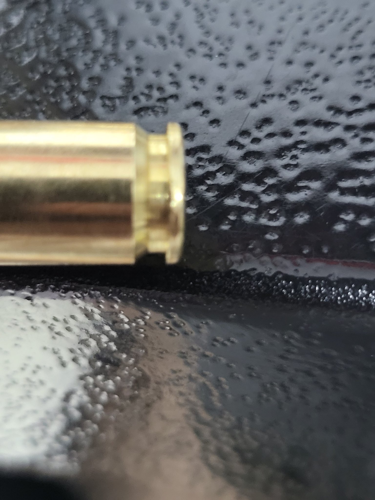

Pics are showing blurry on most for me. But in the first of the brass ones it appears the extractor is slipping off the rim of the case. How hard is it to get that fired case of after it doesn’t eject? Maybe a burr/tight barrel chamber holding the brass. How much pressure does it take to move the extractor on the bolt? Is it very easy to move with your finger?
It's really difficult to extract the fired round that's left in the chamber. I can move the extractor with a finger but it isn't moving easy, it's pretty tight

The brass shouldn't require force to eject after firing. You can try turning your gas block off completely and see if manual extraction is still hard. Might be a chamber issue if so.
Reactions: BCP
95% likelihood of being overgassed. Reduce gas via your AGB. If you have the detent version of the Odin AGB, start by reducing gas from the setting you have it on now by 4 or 5 clicks. You want to close gas until the point where on more click fails to lock the bolt back in an empty mag. Do this one round at a time. Once you get lock back, load a full magazine. If it won't cycle from a full magazine, open 1 click.
Edit - on my phone but the primer looks a tiny bit flat in some of the pics. Pics loading slightly blurry though.

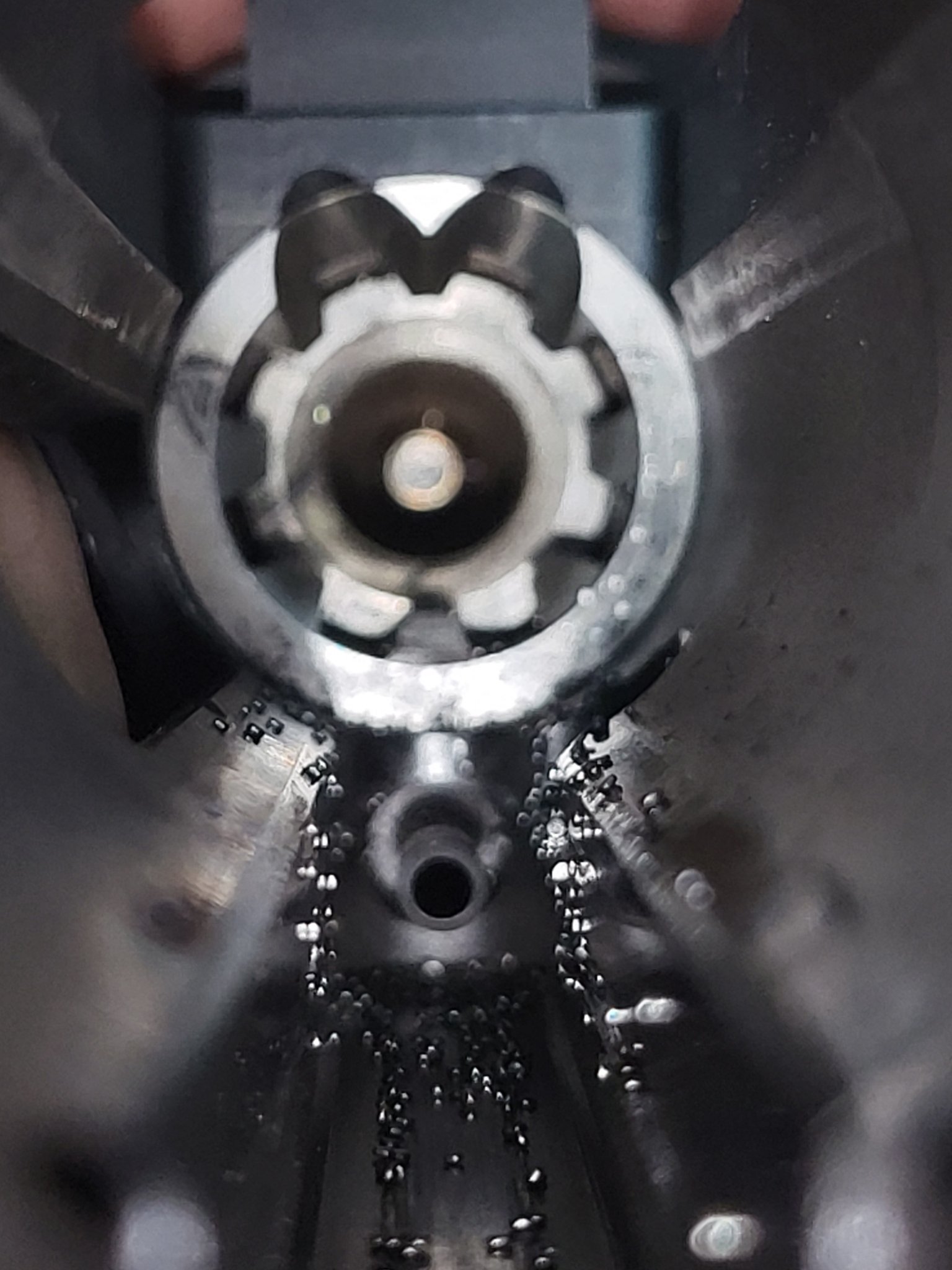

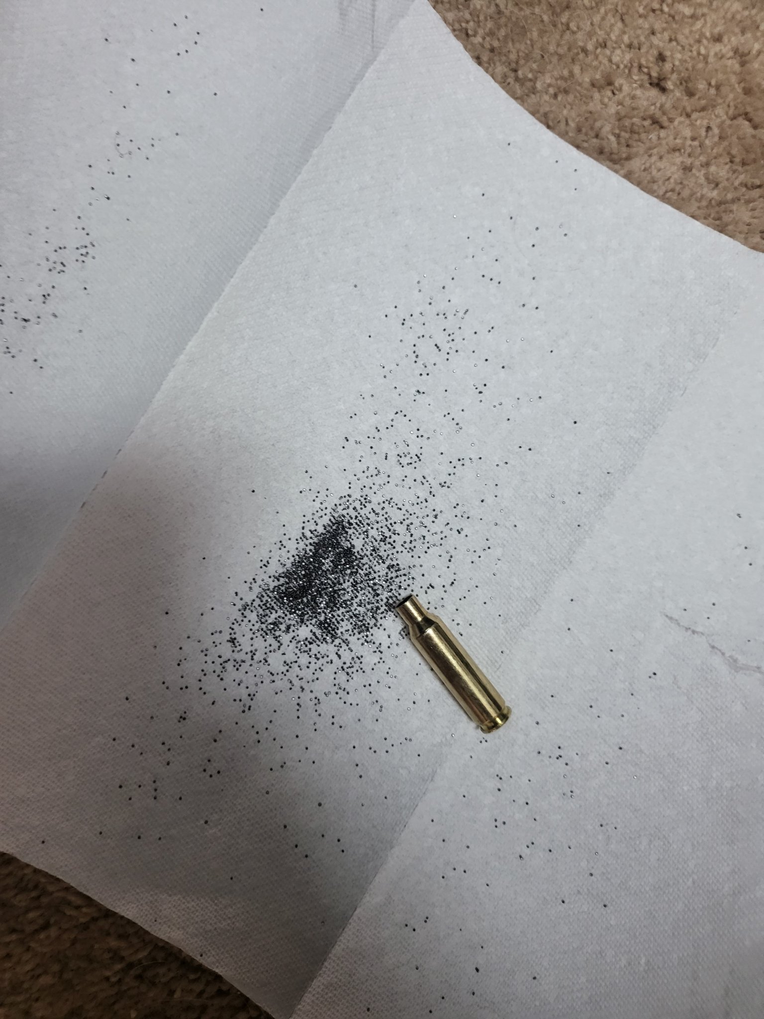

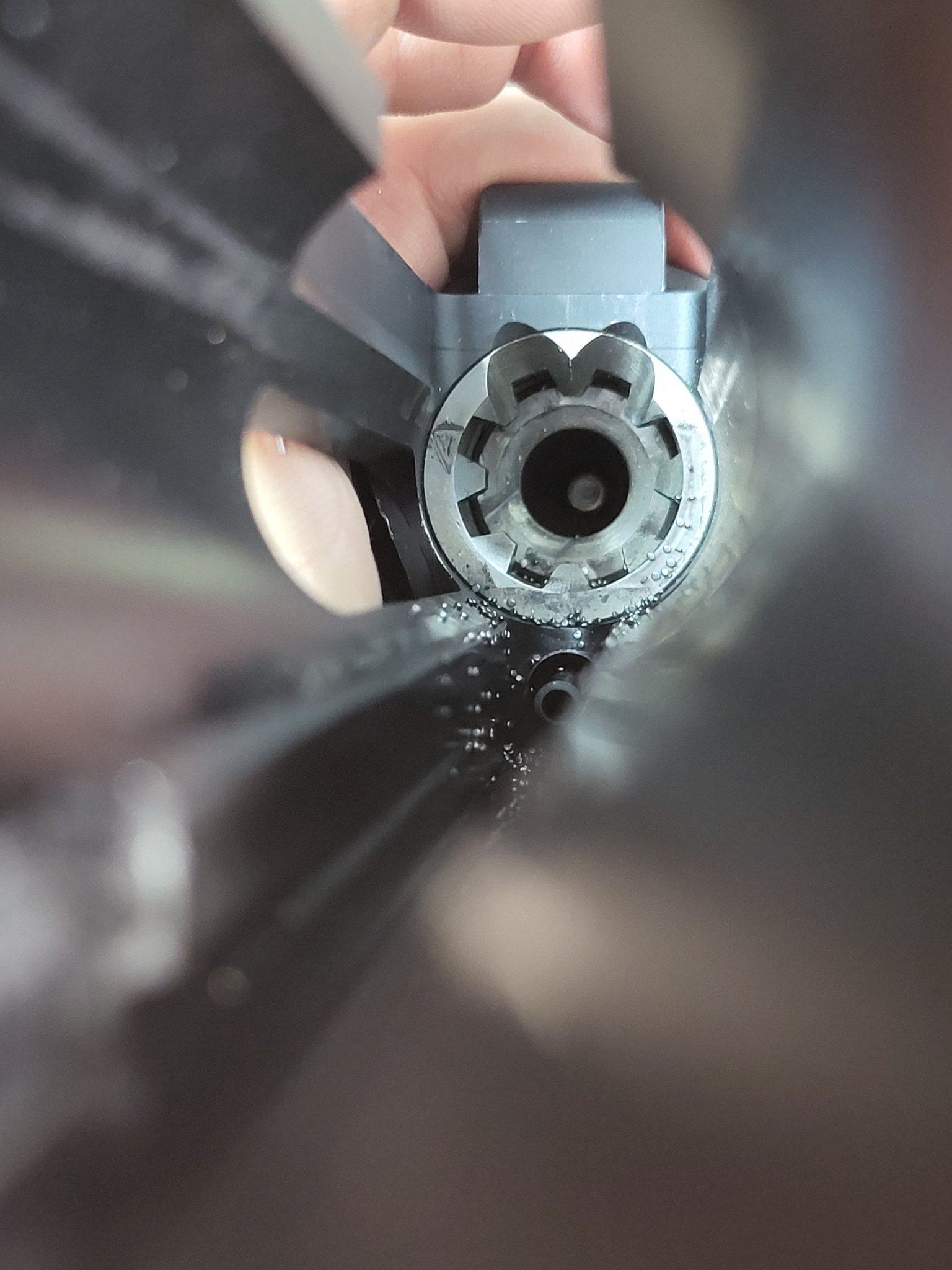

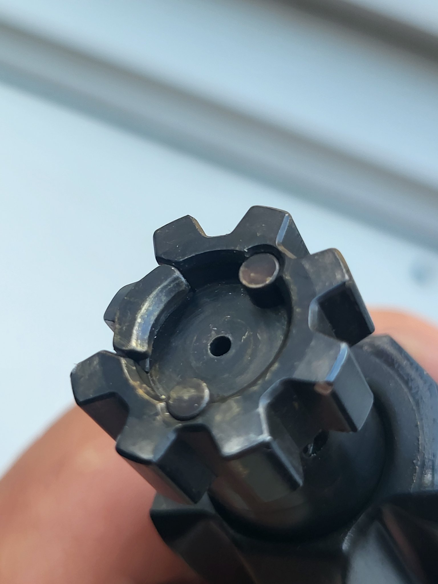

Follow up:
So I dropped a round in the barrel and couldn't manually eject it. Kept at it and eventually the bcg pulled the brass apart from the round, which remained lodged in the barrel... gun powder everywhere. At that point I called Wilson Combat to discuss solutions and they had a couple interesting things to say:
1) The round staying lodged in the barrel upon manual ejection is common and normal, if not outright predictable. They said the barrel has very tight tolerances, and this came as no surprise.
2) They headspace barrels only to their BCG, and buying their BCG (.308) will likely resolve the issue. Any other BCG will be a crap shoot.
So it appears I'm neither under or over gassed, not anything else at the moment other than mismatched.
Anyone want to buy a barely used toolcraft 6.5 CM BCG?
Did you mean the bullet stayed in the barrel?
If so that’s a really short throat for a gas gun. I’d say it might be typical with a tight chamber/short throated bolt gun and hand loads but a gas gun shooting factory ammo shouldn’t be in the lands at mag length.
Bullet remained lodged in the barrel, brass pulled off it with the BCG, gunpowder flew everywhere.

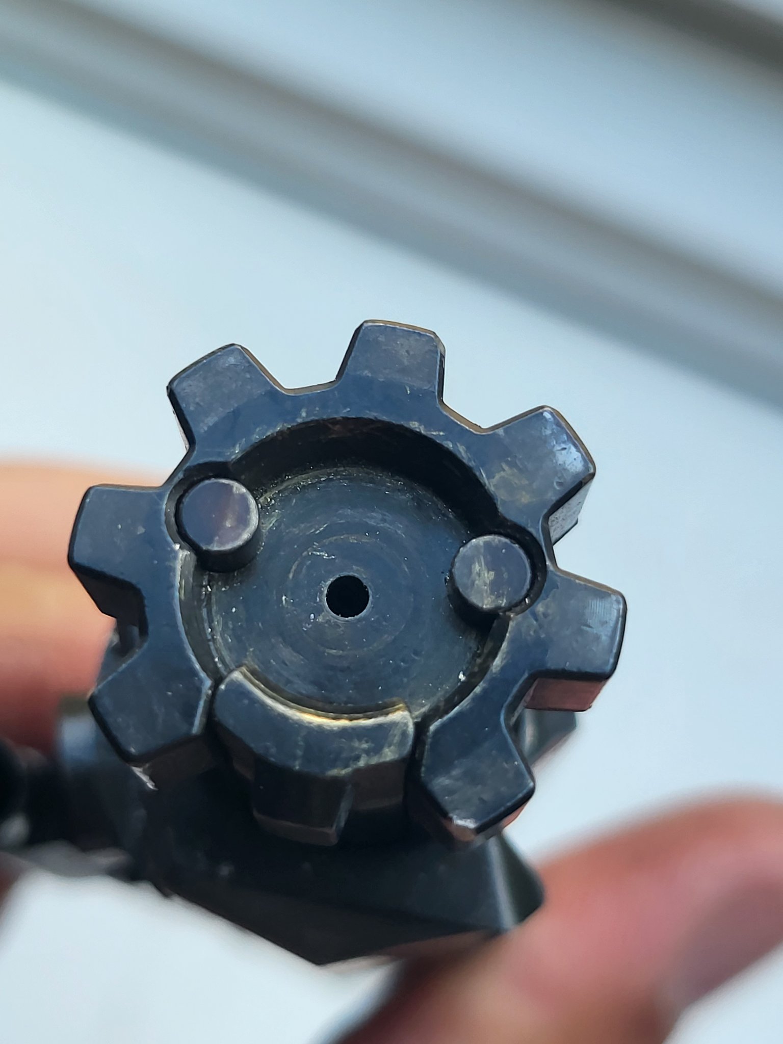

Not sure if it's mentioned, but disassemble the bolt completely when checking HS.
Remove the bolt from the carrier, remove the ejectors and the extractor. You can try it with the extractor in afterwards if you want.
If you aren't comfortable removing the barrel to do this then put a piece of tubing on the tail of the bolt to extend it out where it's reachable. The bolt should close easily on the "GO" gage but not the "NoGo" Do not force anything!
