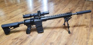

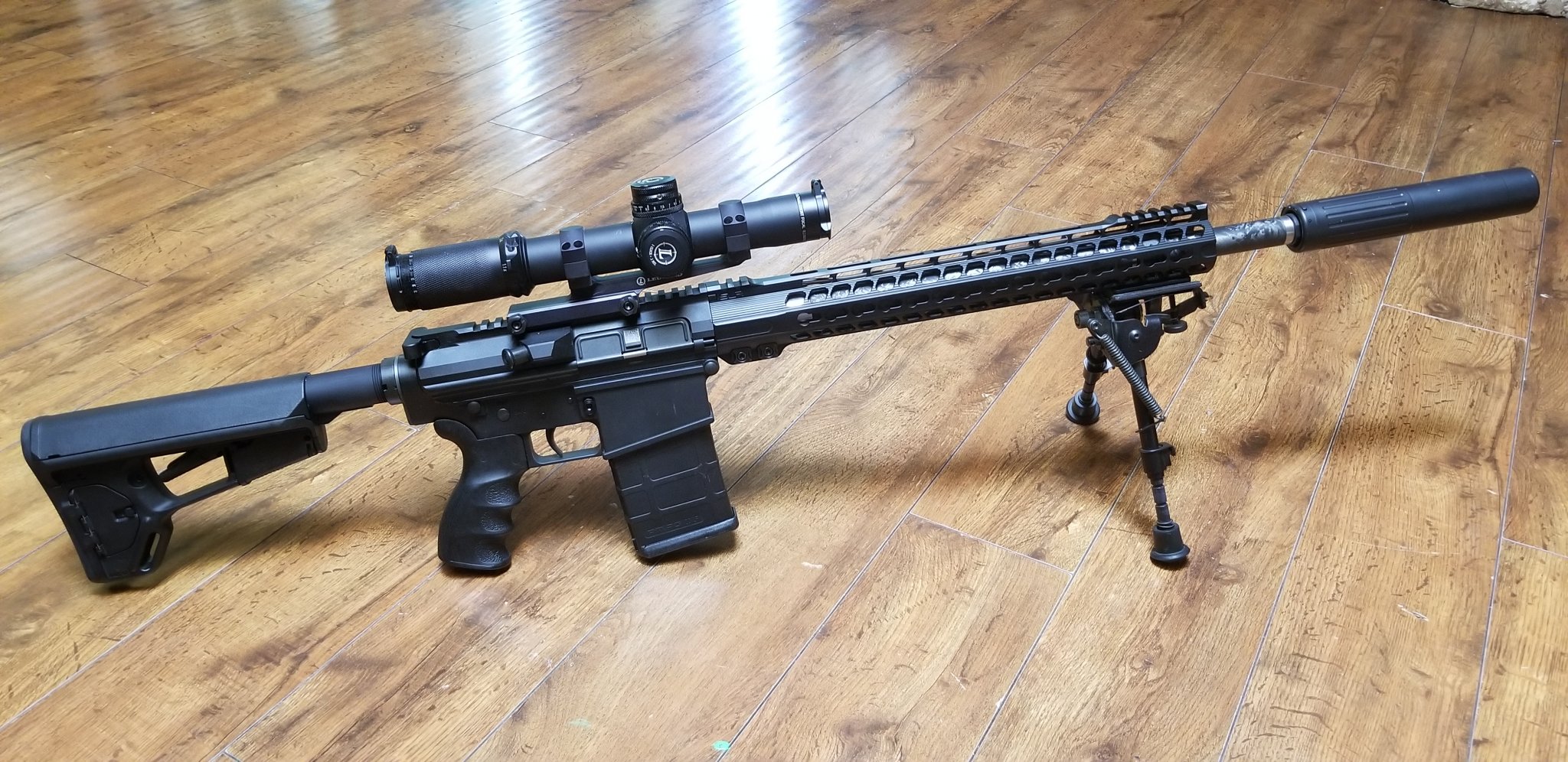

Brass remains in chamber, bolt locks back. Am I over gassed?
I am not judging any particular brand. I prefer things that work without proprietary constraints.
Possibly the chamber is so tight that it needs a (looser bolt) ?
And on the other hand tool craft bcg being Daniel Defense (complient) ?
Proprietary non interchangeable parts on an ar suck, like being held hostage.
I like the term mil spec, it implies parts will match / swap to a reasonable degree.
My best understanding is that mil spec doesn't exist on the AR10 platform. I'm just trying to do my best here, working through my mistakes. I simply want a working gun at this point, so whatever the simplest, most reasonably priced option is, will be the one I go with.

6.5cm AR10, Aero upper/lower/lpk. Toolcraft 6.5cm double ejector bcg. Odin Works AGB. Tubbs flat wire buffer spring, MP PRS Gen 3. Wilson combat 22" stainless fluted
