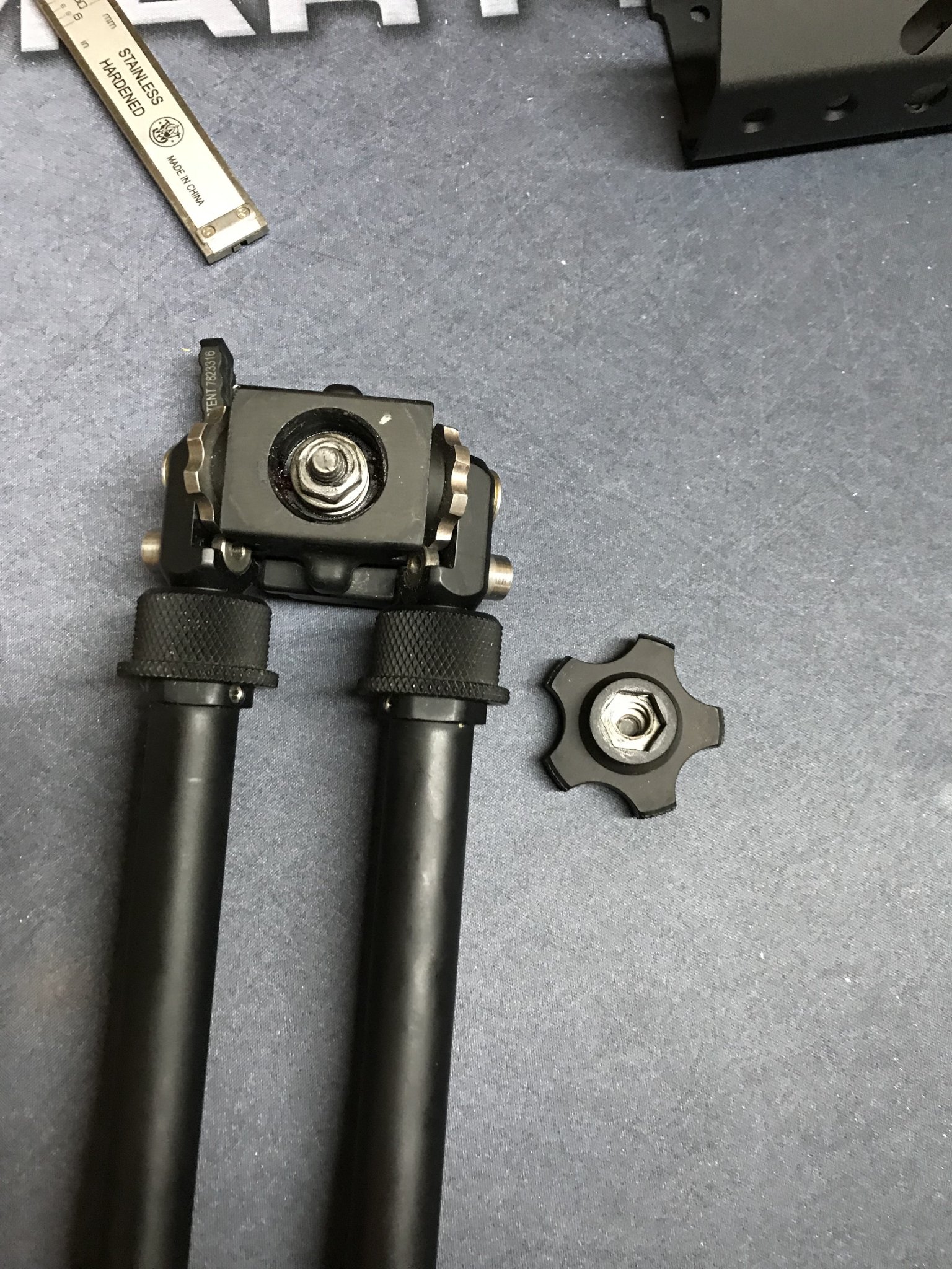

Bought an atlas from a hide member and it was locked down tight, went to loosen it and couldn't, had to use pliers to loosen it and it broke right in my hands. Anyone else had this issue? Which really sucks because after handling this one and my friend deersniper's I was ready to convert entirely to atlas. And don't flame me with "don't use pliers," thats bullshit I was loosening it, what was I going to OVER loosen it.
Could be a bad casting with porosity in it. They probably will want to see it.
Stay calm, what exactly broke? The knob broke off?
Call B&T and see what they say. My first thought would be is it a real Atlas?
Thats what I was thinking, but the seller seems legit. It has the correct markings, the rubber stops like the PSR should, and has the raised knurling on the legs. Seems good to go. Anything else I should look at?
When it broke I almost laughed because I was like WTF are you kidding me?
I would call and send in to Atlas before you make it worse. It looks like a simple fix, but without actually looking the bipod over I don't want to contribute to making it worse.
the threaded portion that broke is made of steel. I'm confident B&T will easy to work with, judging by the responses in the forum. This is likely some sort of user error, I went to loosen it and it snapped without loosening.

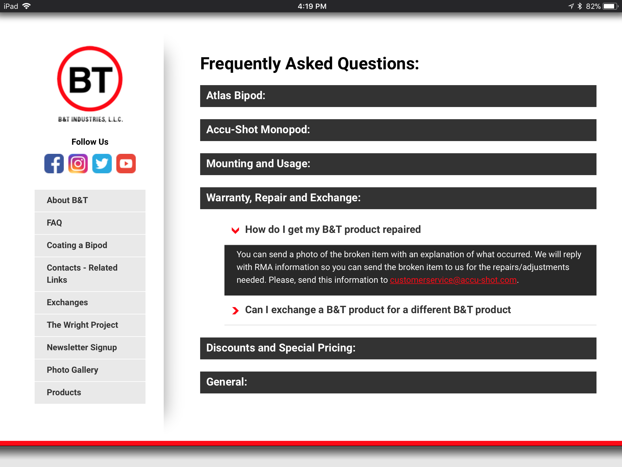

We have a lifetime warranty. No matter if bought new or used, no matter how it broke or gets broken. ALL we want is honesty in how it broke. We'll repair this bipod. Using pliers to loosen the knob can and will break the 10/32 threaded shaft of the lock nut, but it'll take that much force to break that shaft.
I'd like to see a picture of the other side of the knob and the plastic cap in particular.
EDITED TO ADDRESS "And don't flame me with "don't use pliers," thats bullshit I was loosening it, what was I going to OVER loosen it." You were not "OVER loosen" it, the Knob nut was up against the 10/32 LEFT HANDED THREADED nut which was snapped off.
And as a FYI, when we are contacted about an Atlas being too tight, we recommend that they get installed on a rifle and moved through thier arcs of movement to get the feel for pan/cant as they are pre-loaded with tension and often feel "tight" in the hand.
Regardless send it in and we'll do our work and get it back ASAP.
