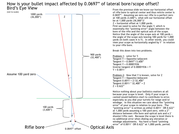

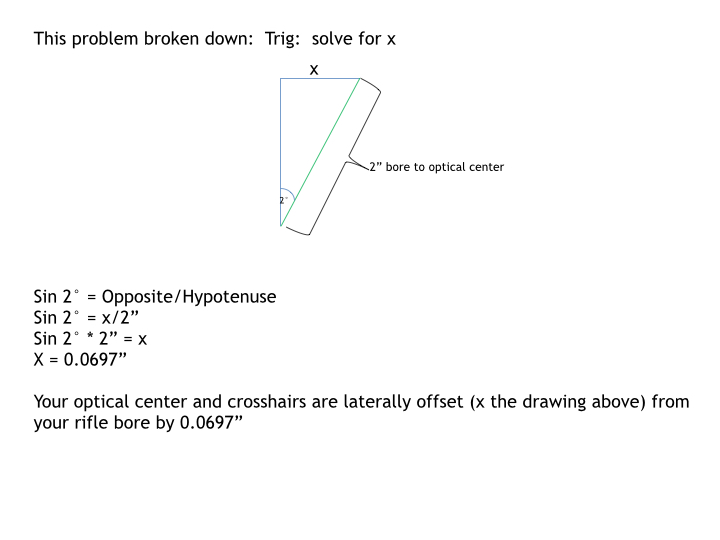

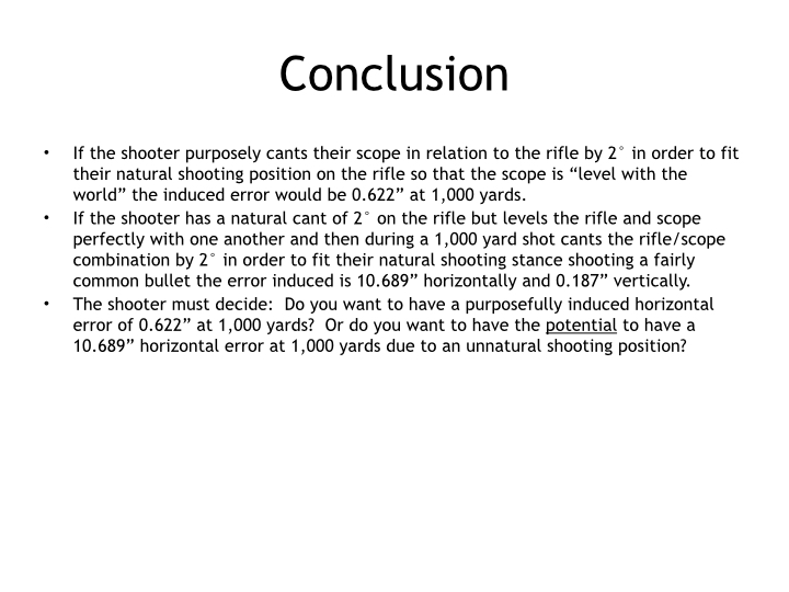

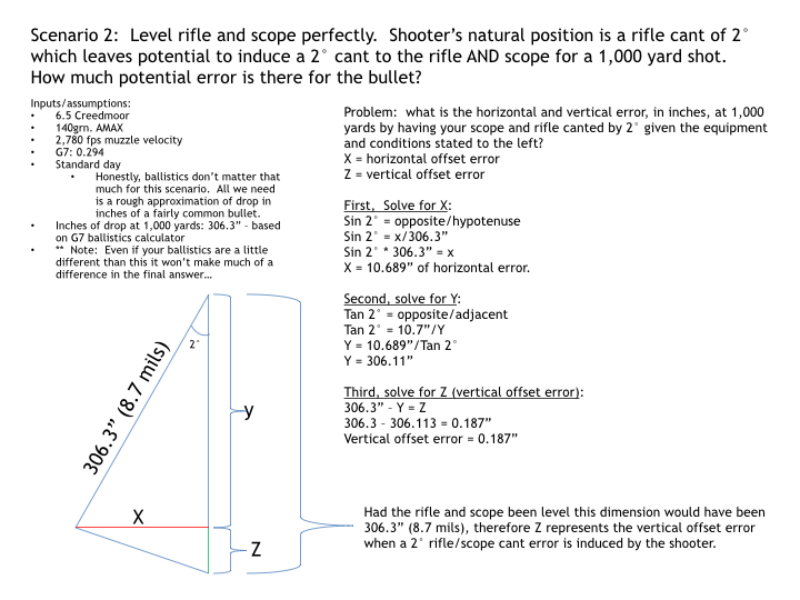

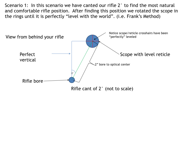

    It is by far, literally 10x better to purposefully cant the vs running it straight and accidentally doing it
    PS,
    To put a fine point on it, my personal cant is less than 1 degree, it's pretty close to .8 degrees and the example uses a very real 2-degree cant.
    The 5 degrees of cant most examples uses are by far overdoing it making it appear worse than it actually is. That is not to say 2 degrees is ok, it's not, but that 2 degrees is pretty darn noticeable
