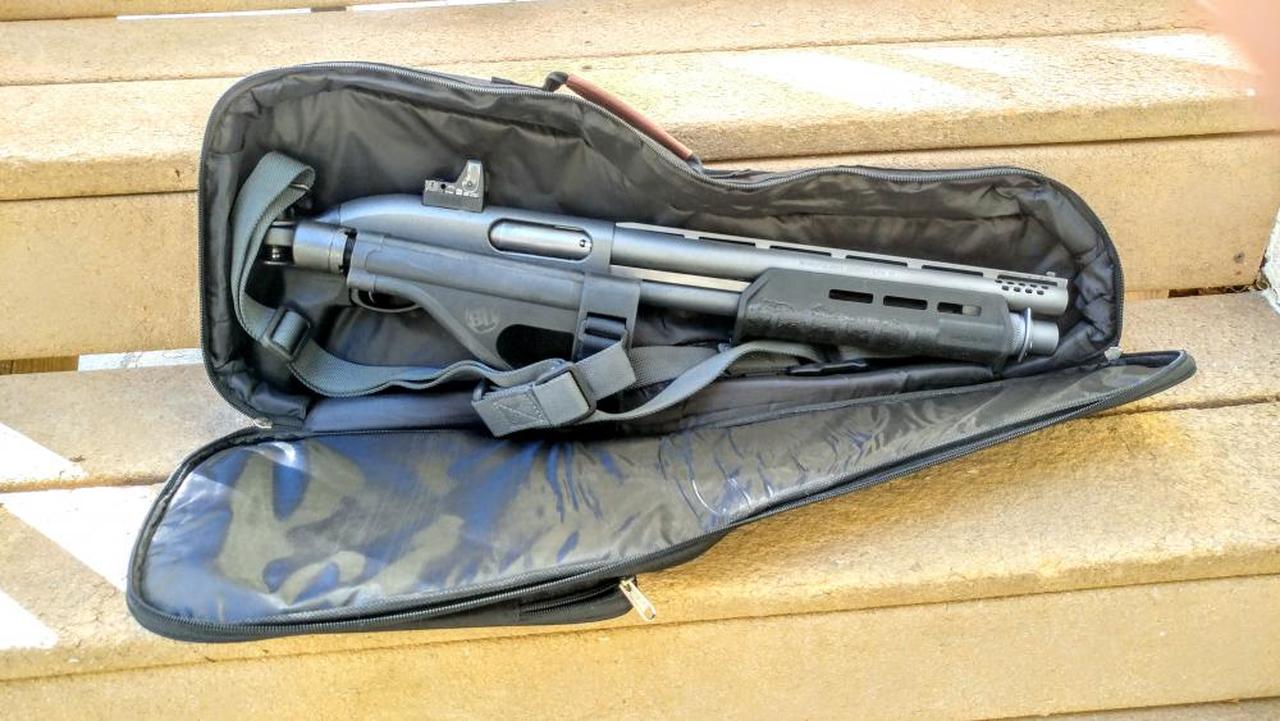

Yeah shouldnt make a difference. Shortys are fun, I picked up a 870 Express for under $300 from Walmart. Replaced all the springs with Police magnum parts, replaced the extractor, and a few other parts. When my stamp came back, I had the long vent rib cut to 12.5 inches, had it all cerakoted, and magpul furniture. Its a little hammer.

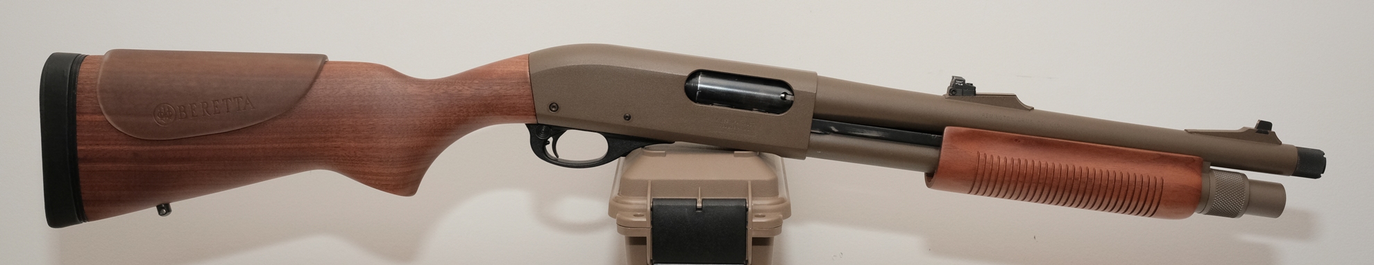

I used a 14" Rem. police barrel for an SBS and it was thick enough to where I had it bored for Rem-chokes (that barrel had rifle sights and was choked down to modified when new). Lets you play around with it some different ways. It's hilarious with extra-full turkey chokes and #8 shot.
Keep an eye on ebay for walnut stocks. This latest set I got is a set of take-off police stocks sold on ebay by Vang Comps.
