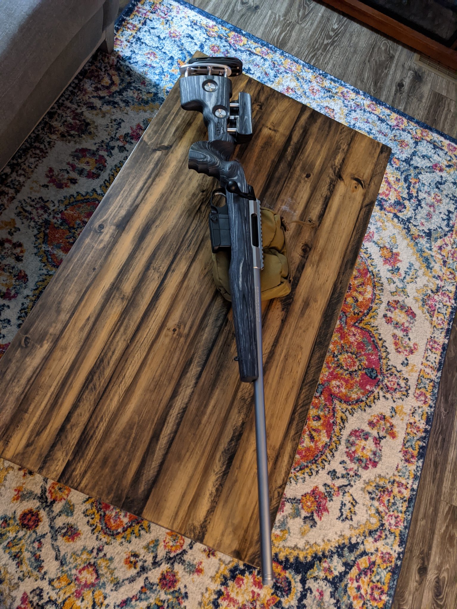

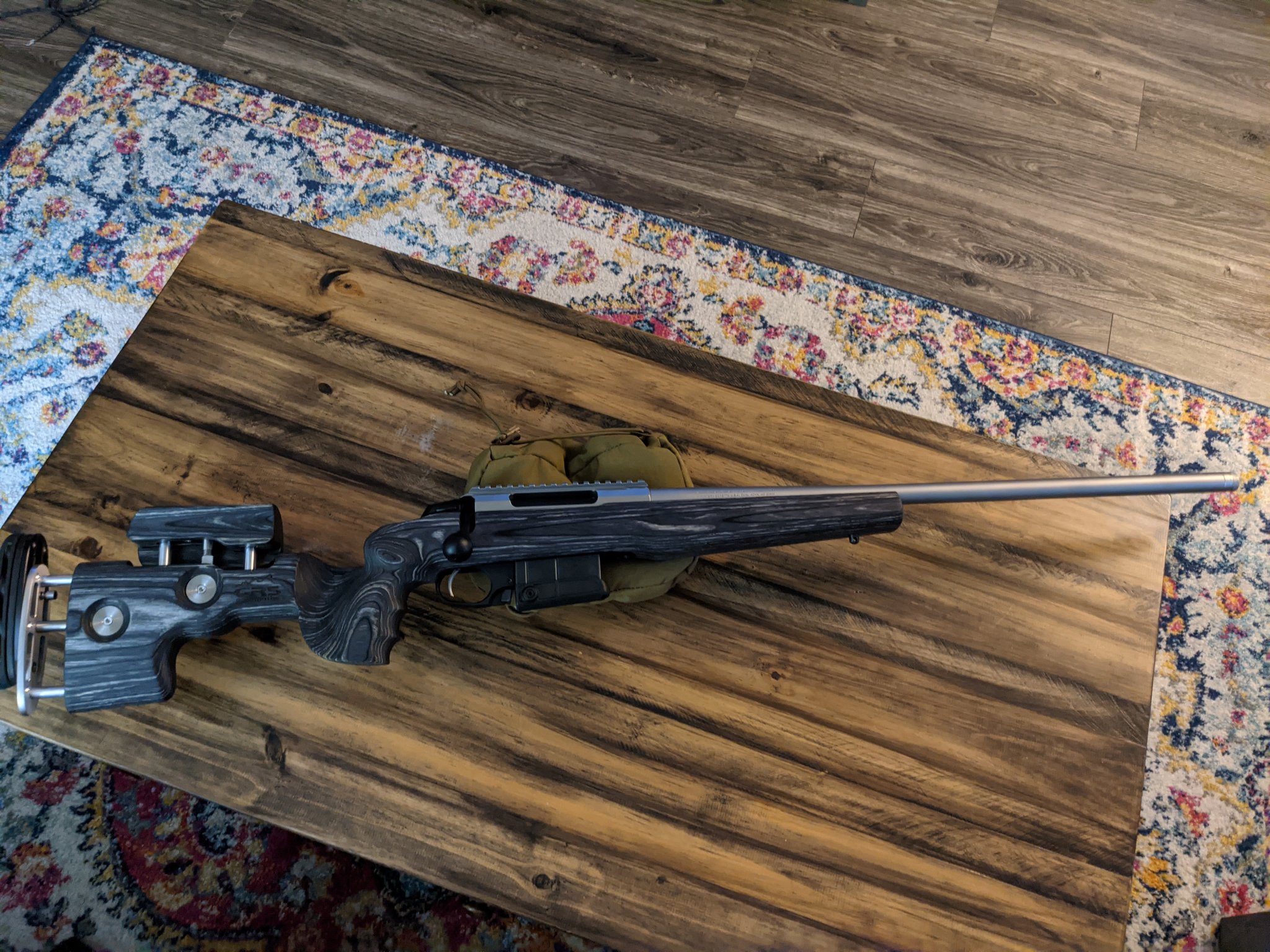

Here is my most recent Tikka project. A stainless T3X CTR (.223) in a GRS stock. I went with the longer barrel in 1-8 twist as my goal is to fire the highest BC bullets at the highest velocity. Hope this helps.
Edit: Like said above, Tikka doesn't really need an aftermarket trigger. They are very good from the factory, and a $10 spring can help to lower the pull weight if you want. There are a few aftermarket triggers if you wanted to go that route.
Would you be willing to tell me what all pieces that you have there? That looks like something I would like to build up here in Canada. Of course depending being able to purchase the parts as some US companies will not sell or ship to Canada unfortunately!
Yeah, absolutely! There's honestly not a lot of pieces involved.
- Stainless Steel Tikka T3X CTR (.223 Rem, 24" length barrel, and 1-8 twist)
- GRS Sporter stock, inleted for the Tikka CTR. My color is "Black", but they changed their colors around so the closest color now is "Nordic Wolf"
- GRS height adjustable buttpad (allows the buttpad to adjust up or down)
That's actually everything, right there. GRS recommends bedding all their stocks so I'm going to drop off the rifle on Monday for bedding.

I acquired a MDT XRS and 4 mags for 223 so that mone is spent. Just need a barreled action. Custom are pricey for me and a local shop has a R700 SPS 223 Varmint for $600. I'm fine with 60gr or less. Plan on having it cut back and threaded 5/8×24 to suppress. Is there another option for the gun at a better price anywhere?
I bought a 700 adl tactical in 223 with a 24" threaded 1:8 twist barrel for a little over half that new. Unfortunately it is hard to find a Remington right now since Remington got sold at the bankruptcy sale and is waiting on their new FFL so they haven't made guns for the last several months.
I wouldn't recommend a slow twist barrel if you want to go short. Dig around and see if you can find one with the twist rate you really want because they're out there and if you buy a $600 gun to save $500 over a custom you really don't want to spend the $500 next year on the barrel you wished you bought the first time.
