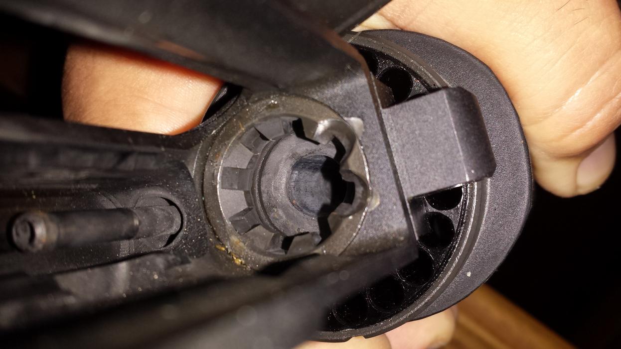

Could we see the pics of the failure? The bulge? A crack in the chamber? Not real clear on what your problem is. I have seen some very old PMC brass that was way under sized in diameter in the solid area of the head. Shot fine and reloaded many times with out incident. But after firing it looked like the back end of a belted case.
Well this is strange, first time I clicked on you link, I got case heads. Went back to looked after my reply and it then showed side view with splits lengthwise. An over size, as in too big around, chamber would cause this. Too long of a chamber would stretch the brass long ways unless the case had a too thin spot in the side wall which started a tear following the weak spot. Have you looked inside the chamber to see if there is any defect visible? These cases should have produced a noticable amount of smoke when fired.
If you are confused with what has happened, I did not do a good job of explaining. Please let me try again. The bulge I mentioned is in the brass. You can see it good in the round that did not split. I have included a pic of the chamber but I am having a hard time getting a good pic. In the pic of the chamber, you can see the darker line adjacent to the ejection port. It is hard to see the crack but I assure you there is one there. Ill have to see if I can get a better pic.
I am interested in the messed up chamber/head space issue however, I have a lot of brass that is not deformed like this that is once fired by myself. I guess there could have been a head space issue from the rock river factory however I would have thought it would have shown up immediately. I have factory brass that measures good OAL and will slide in the head space gauge and exhibit good readings. I can only conclude that this happened due to a poor factory load. Is this normal for factory loads? I would have never thought to check my brass for this and maybe I should have. I wish I had known because I would have called Rock River and seen what they could have done about it. I am afraid it may be a little late for that now.
To be honest, I was really amazed that I found this in the factory brass I saved. I figured this happened with the reloaded round I fired but it is clear that it happened prior to reloading and is the result of separate incident involving factory rounds, of which went un-noticed.
All three pieces of brass pictured above measure 1.757"

All due respect, this rifle is not being used. I'm not messin' around on the internet. I'm politely asking if anyone has had issues like this and could share their experiences. I understand the severity of what happened which makes me all the more interested to ask as few questions.
Following the failure of the reload, I immediately took it to a gunsmith. It was determined that it needed a barrel which is obvious from the picture. No idea what caused it to happen. Had I known about the S&B brass when I took it to him, it may have shed more light on the situation. Because I didn't know about previous failures at that time, we assumed poor brass.
Sent from my SAMSUNG-SGH-I337 using Tapatalk
That looks like there is a case stuck in the chamber with the head broke off .That might be what the crack is .Sure looks dirty in there .
There is no case in the chamber. I have the last fired case in my possession. It's dirty because I shot ~150 rounds through it the week before firing the reload. I didn't see much sense in cleaning the gun that will require as new barrel. I set the upper in the corner after taking it to the gunsmith and let it be.

I did not find the previous post offensive. Greg, you and I both saw a serious safety hazard which required professional inspection, not just a quick question on the internet. I am glad that the OP went to a gunsmith and confirmed what a few other posters suspected, faulty barrel. I am also VERY glad no one was hurt. With enough time in the field, we all will see a malfunction with injuries sooner or later. It really is only a matter of time.
To the OP, good luck with a new barrel and let us know how the thing shoots when all is said and done.
After seeing the pic if the chamber, you can clearly see an abnormality. If it were a brass issue, the abnormality would not be defined like that as the orientation of the brass into the chamber would be different upon each loading.
