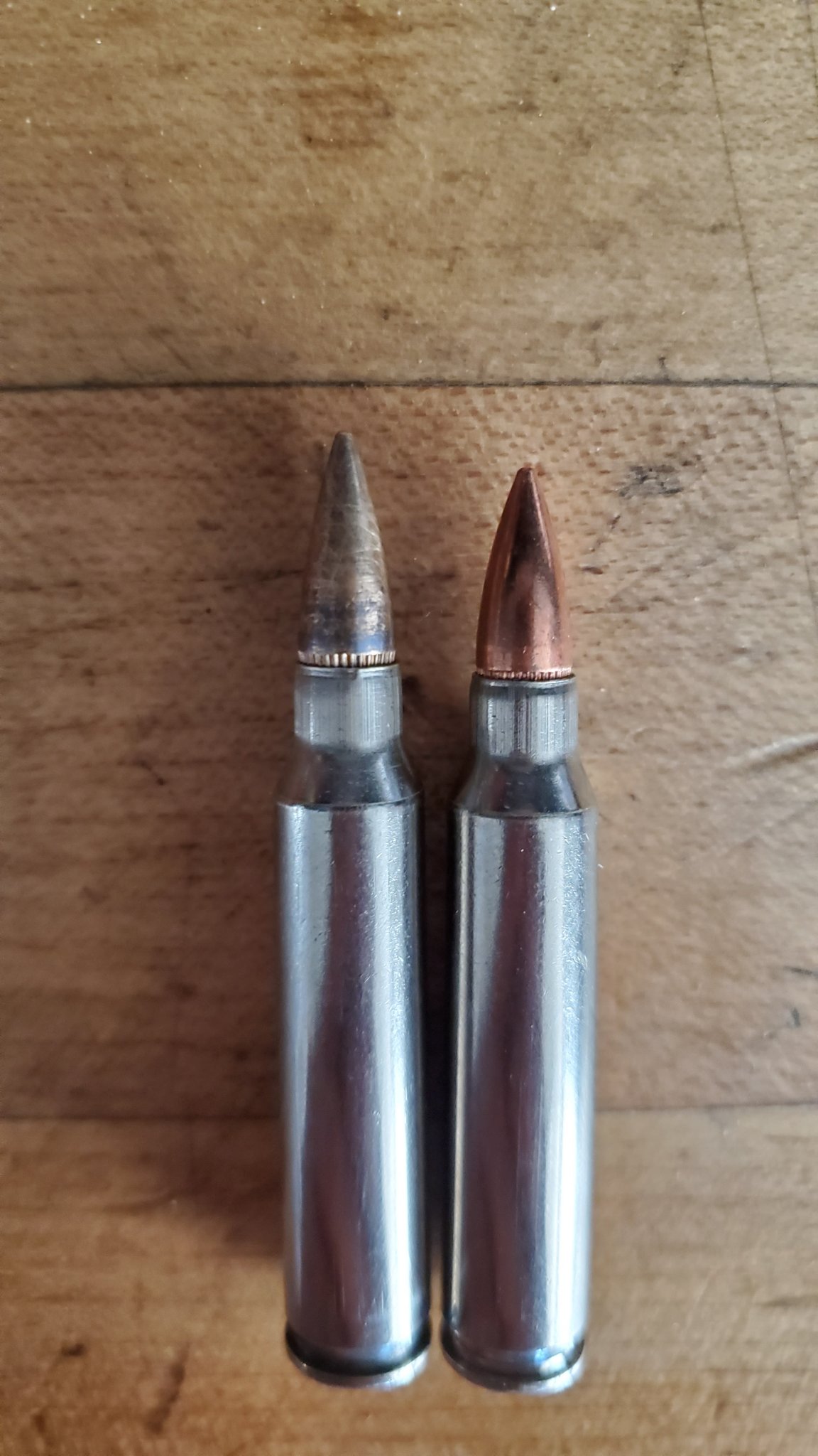

Sounds like you got a mixed lot of 55gr bullets that were rejects from a military ammo run. My bulk process is this:
Trim case to 1.75", seat 55 gr bullet to where a c-hair of the cannelure ring is visible, crimp. If you do that, the OAL almost always is 2.21-2.25".
Its plinking ammo.
I once had several hundred 62 gr fmjbt's that were the same manufacturer part number, but clearly two different runs.
Your Honor, I present Exhibit A:
Reactions: Nimothy
Its plinking ammo.
Your Honor, I present Exhibit A:View attachment 7221728
This is exactly how I do it too

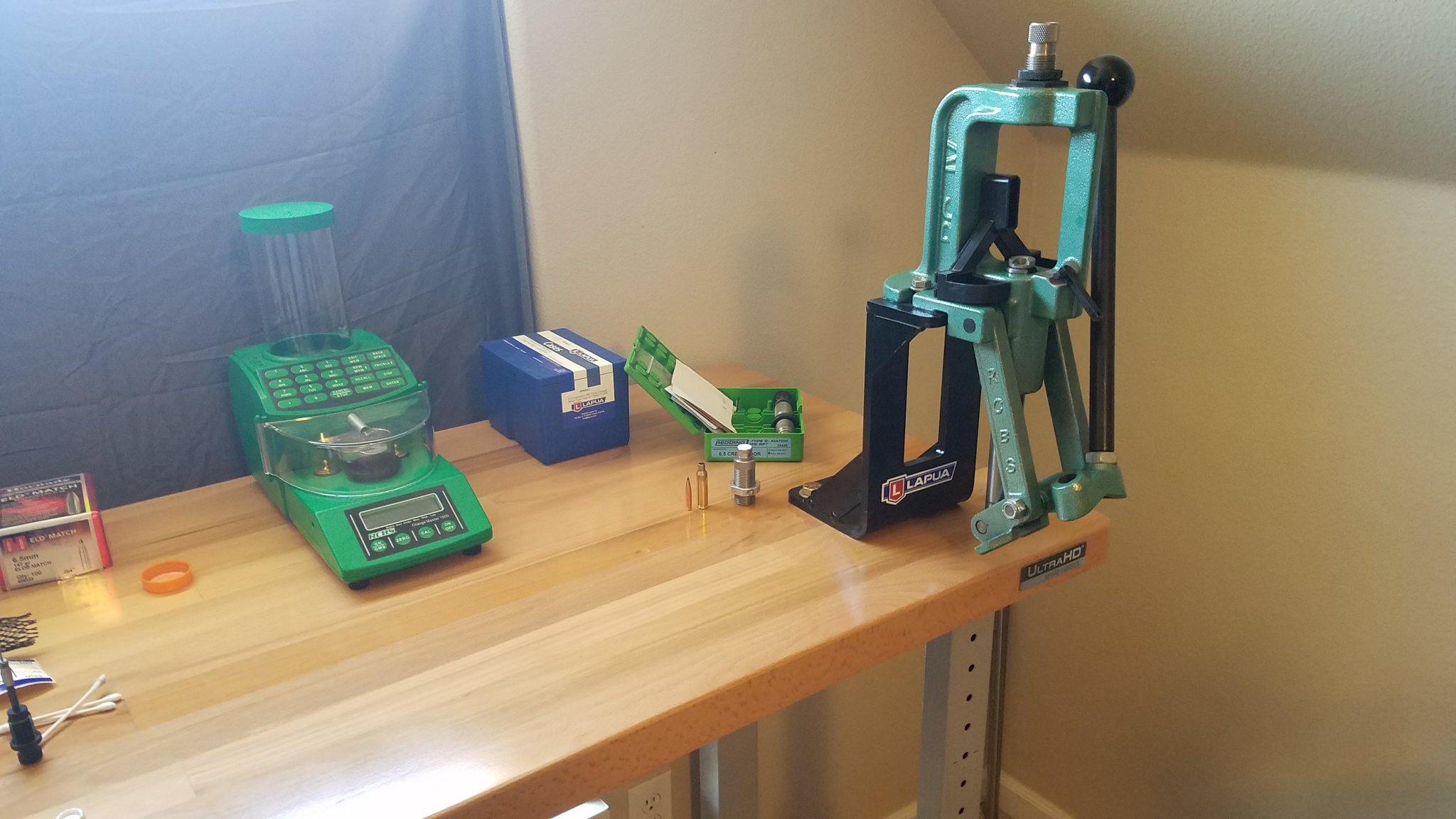

Do yourself a favor Snuby and get a press riser mount, there is company that makes one for just about any press and it gets it up off the bench and aids in distributing the load you putting on your bench when resizing.
I ended up building this one from 516 grade 70 plate steel that was laying around but you get the idea.
Kind of overkill but built like a brick shithouse ?
Reactions: Snuby642
I moved the press to a location that didn't interfere. The dillon has a riser base.
