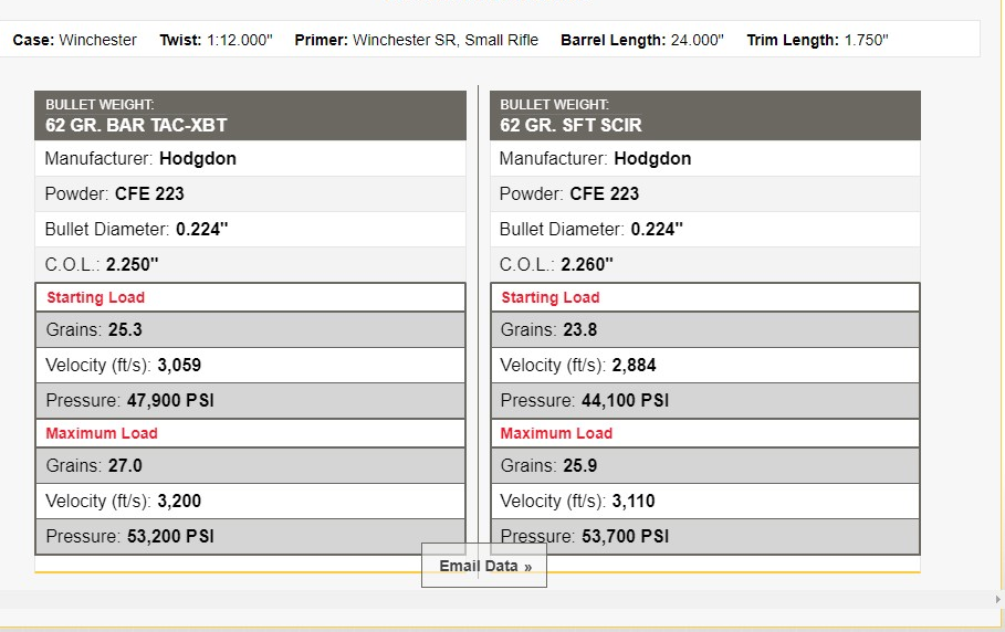

Just received an order of the Hornady 62gr BTHP from Midsouth. I've looked but couldn't find any load data for CFE223 for that particular bullet. I did do a basic search on the Hodgdon powder calculator and found this:
I have no idea what the 62gr SFT SCIR bullet is. Between these two bullets is a large variance in powder charge. I currently load the Hornady 68gr BTHP at 25.4gr of CFE223. Should I start loading the new 62gr bullet at 24.5gr and work my way up?
Hornady has Supplement load data , for they 62 Gr FMJ I’ve used that for 62 Gr BTHP
