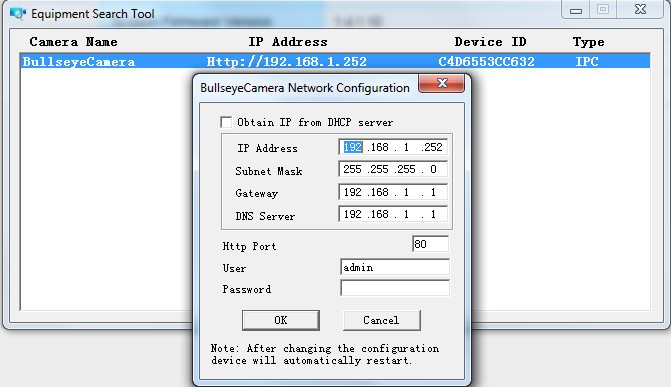

Not sure if correct location to post this, but read a post from a memeber named "thewolf" a few years ago about setting up his own target camera system by cloning the Bullseye Target System. I'm hoping to find info from anyone currently owning this edition type of the Bullseye Ammo Can 300yd sight in Target Camera System , that could possibly share the GL-AR150 router configuration settings with the system on board camera FOSCAM Model FC1405PC. Hard reset of GL-AR150 mini-router caused the erasing of all Bullseye target system configuration for router/camera settings.

Hmm, if you can get into the camera you can see what IP addresses that are used. The system I had was with two routers to transmitt over longer range.
Camera settings:
IP adress:192.168.1.252
Subnet mask:255.255.255.0
DNS:192.168.1.1
Default Gateway:192.168.1.1
Port:80
Username:bullseye
Password:**********
Camera name:BullseyeCamera
For the network:
DNS:192.168.1.1
Port:80
Hope this info can get you started. Also if the camera is Foscam there is a software you can use to get the info from the camera.
The program is called Equipment search Tools.

I know it’s been a while since you posted. But do you still have the camera? If so would you be willing to back up the camera settings to file?
I’m trying to help my neighbor with his bullseye camera, but the fosscam appears to have been factory reset. I’ve tried adding all the parameters you listed and have not had any luck.
I can ping the camera and log in using the browser to view the video feed. But when I try to launch the bullseyecam.exe it can’t find the camera (but I can see using wireshark it reaches out to 192.168.1.252).
It’s a head scratcher.
Thanks in advance!
