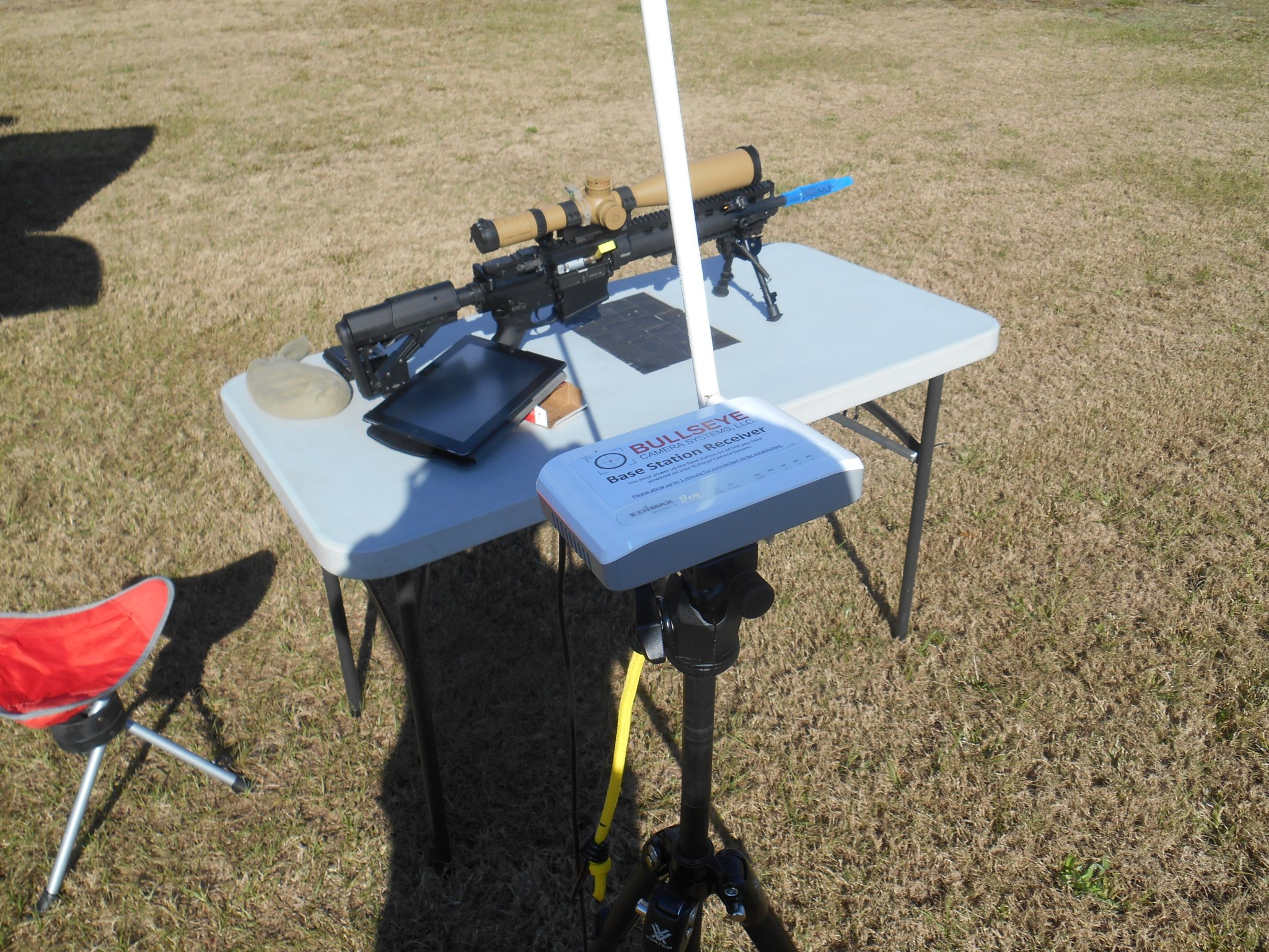

I purchased a brand new Bullseye Ammo Can camera system a SHOT SHOW directly from the guys that invented it years ago. I never used it until a few years when I tried. It did not work so I contacted Bullseye to find that a company called SME had purchased Bullseye. I wrote several letters and talked to them on the telephone. I explained in the letters the situation and again on the telephone. The unit was brand new and I had purchased the 2 year extended warranty too. They flat refused to help me. I even sent the unit to them and they sent it back! They said they no longer supported that unit. I found that they even took down the site that supported the older units. That site cost them nothing so the motive must be to force people to buy new units becasue the old ones could not get support. Cheezie for sure.
They offered me a 1/2 price coupon to buy a new unit from them and I asked "why in the world would I buy anything from you when you will not honor your warranty? Who knows when you will decide to no longer honor the warranty on the next SME product?" They offer no answer to that question.

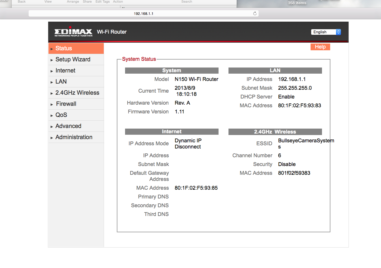

I think we have chased down the issue today. The CNet M/N: WNOR5300 Router for the receive side (Base Unit at the computer) is bad. It was sent to me new too. There are not any new router units out there that I can find. Does anyone have a router transmit unit for sale? I think we can get it going if I got a replacement Router. Maybe.
Otherwise I recommend walking a wide circle around any products SME offers. It is "Buyer Beware" for sure. Please advise if you have a transmit or base station Router for the AMMO Can camera system. Thanks.
I started with the original Bullseye ammo can then (when it was shown a router on the ground didn't broadcast but 100-200 yards at best) purchased their "1000 yard Edition" which came with a short tripod; same situation with range limited to ~300 yards with low resolution FosCam. Spent several years self-developing antenna systems, extended routers and Yagi antenna etc to get it to work at 800 yards. It was an awful system from inception. Save yourself the heart ache and get a LongShot Camera system 2 mile edition.

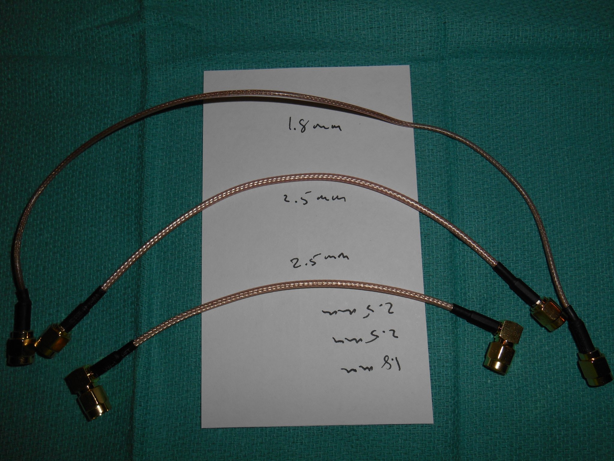

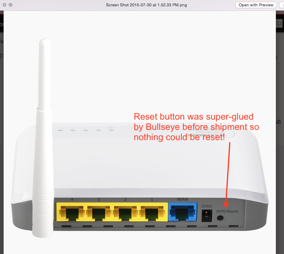

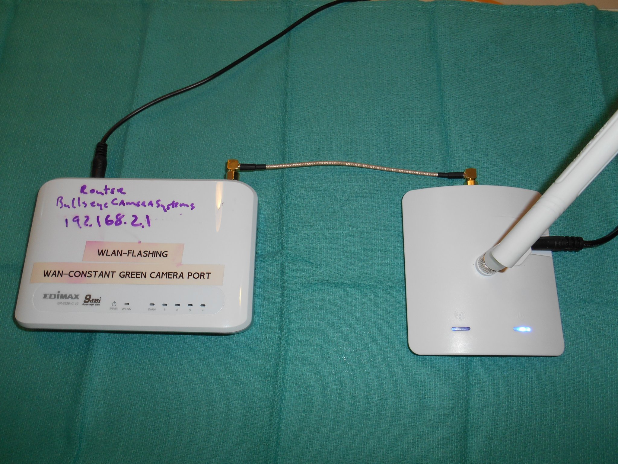

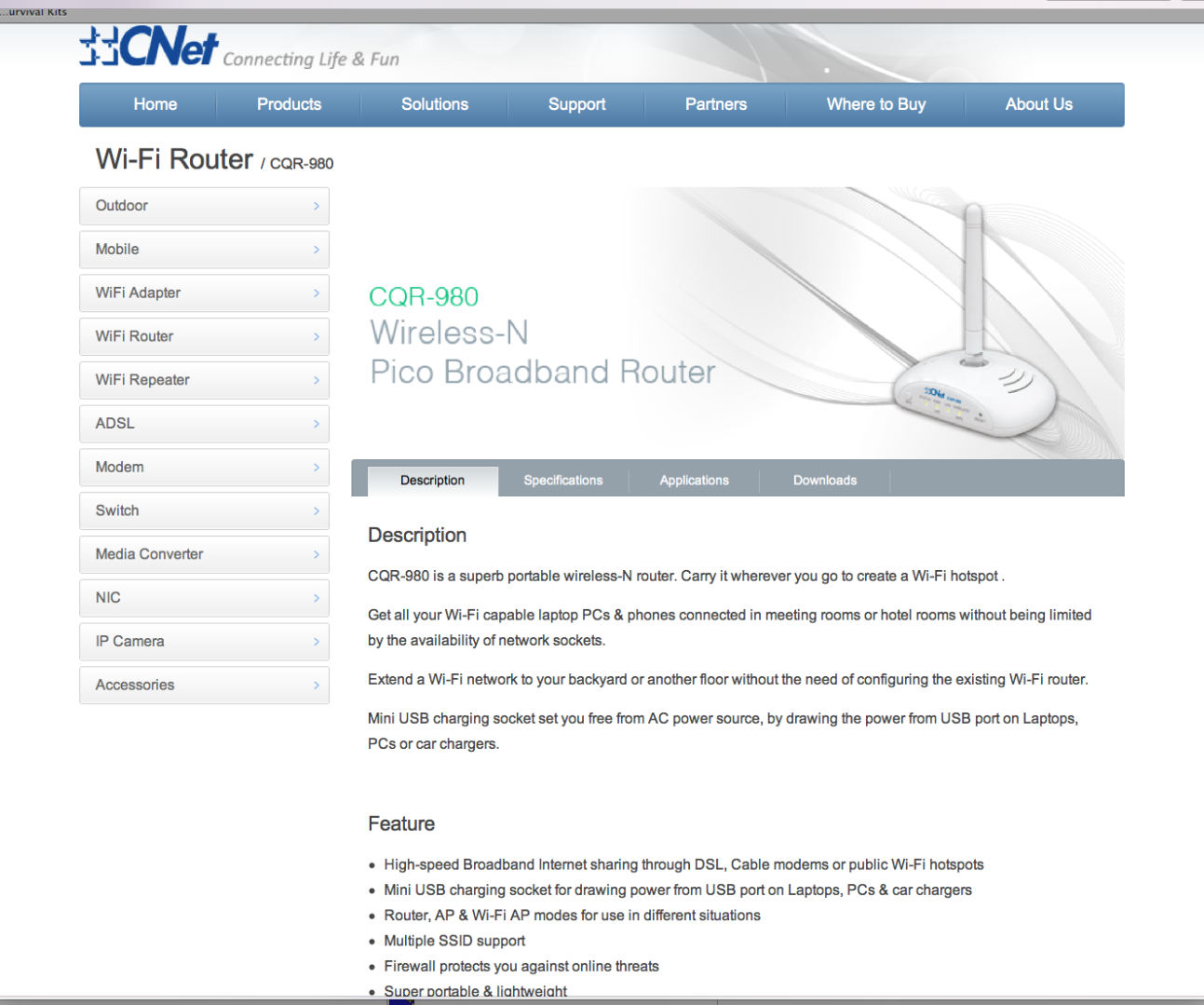

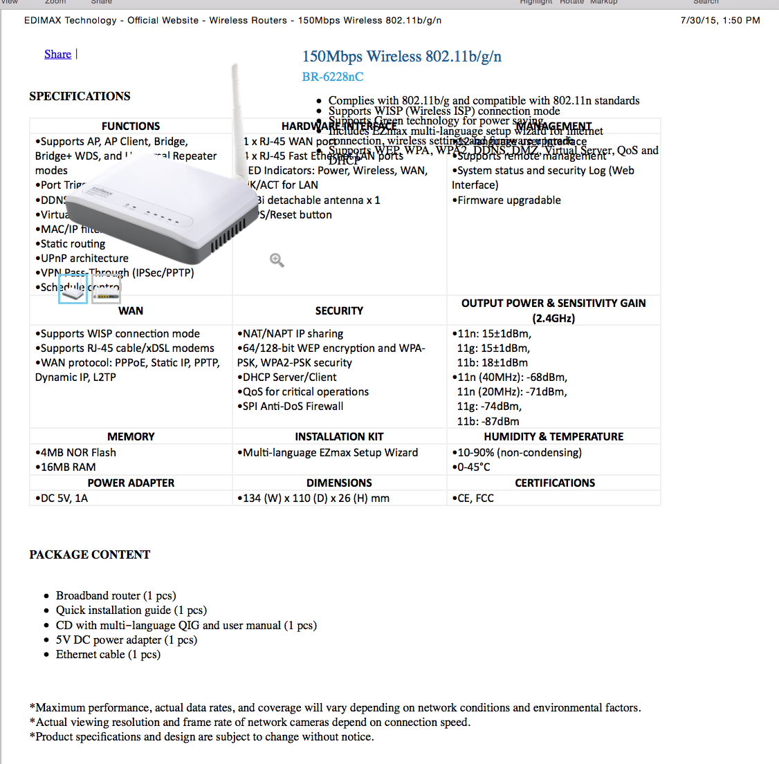

Bullseye used several different types of routers as they recognized the shortcomings of each one. Some info that might help you find a router that will work. Also replace connecting cables with high quality pig tails. Good luck.

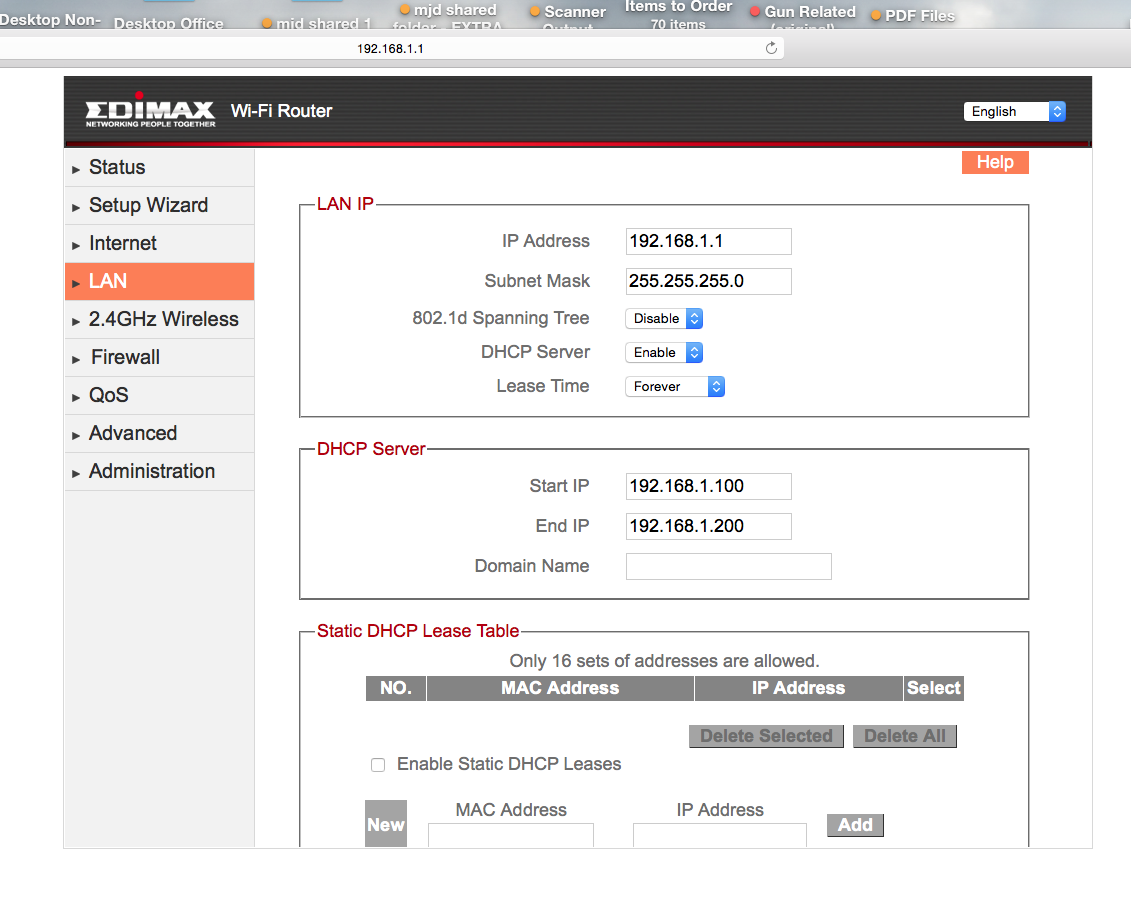

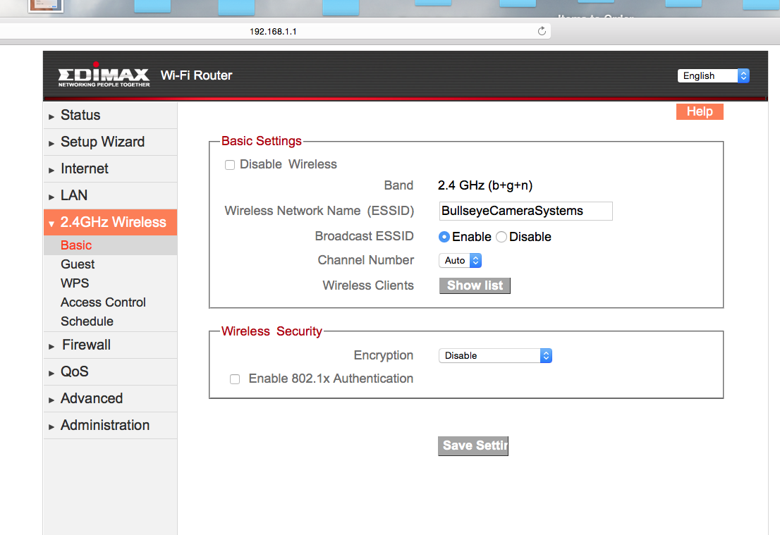

Excellent information. Thank you. I will take it all in today and see what I can do. I now understand much more about the electronics than I did after getting help from my neighbor. He does not know a lot about the system but he knows code and electronics. We went into the IP address of the router and looked at it and concluded it is a bad "chip" on the board from all indications. It was sent new to me that way. It appears that the only solution is to get two new routers that can talk to each other or find an old one that will. We down loaded the Bullseye hard code as a back up in case I can find a generic router that matches the original one and we can then program it.
It is clear you know what you are doing and did a good job of solving your issues. My investment is nearly $1,600 in the two old Bullseye systems and it is hard to give that up. Again excellent work and thanks for the information. Be safe.
