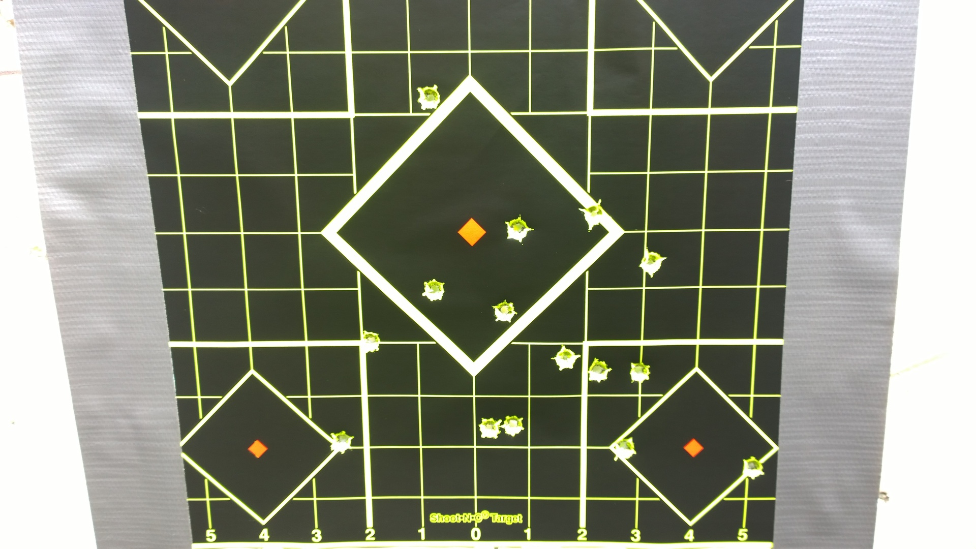

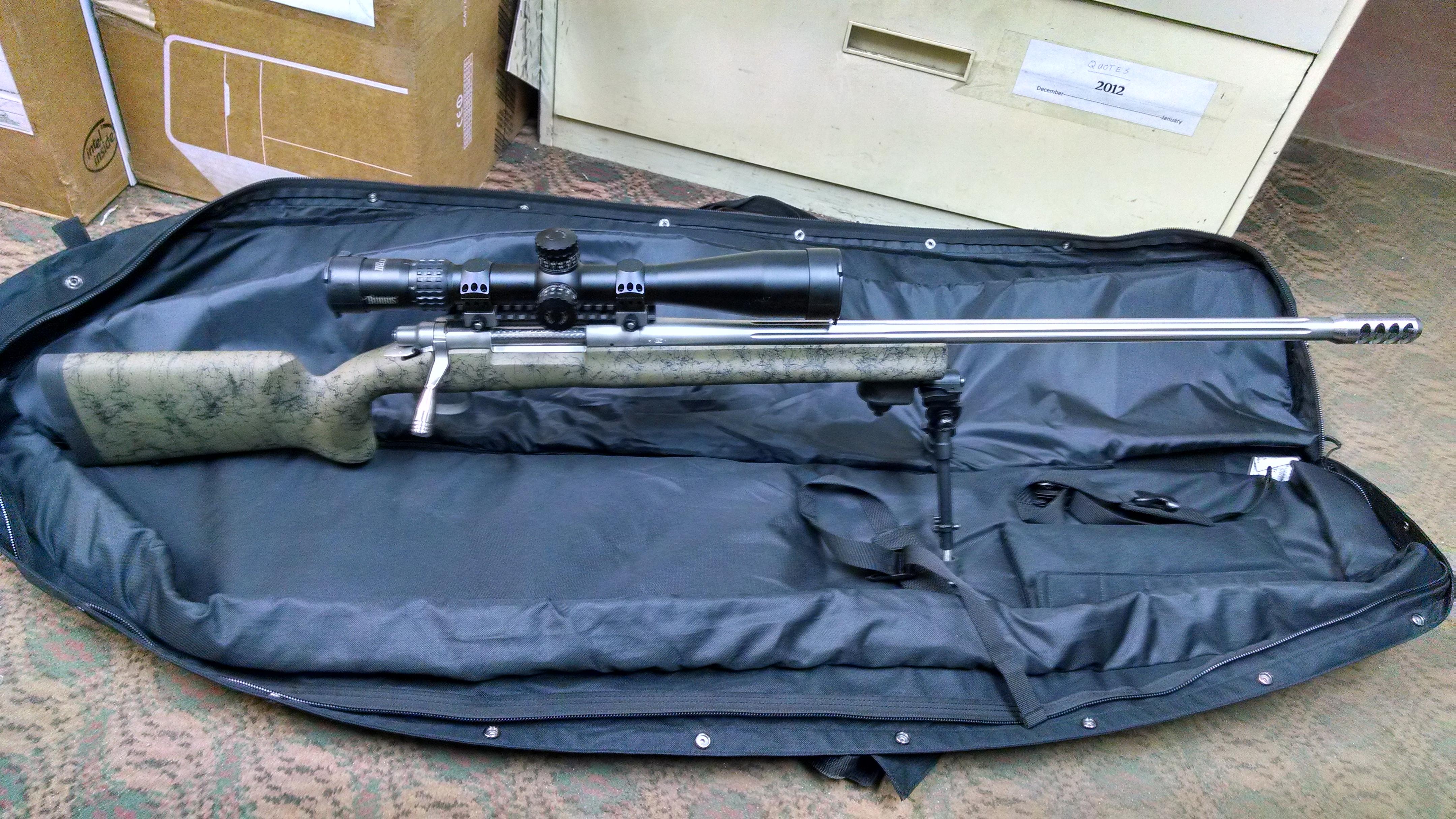

IMG_20140627_195259903_HDR.jpg2014-06-27 19.51.48.jpgok guys. had a long range session yesterday with my new baby. I was going through a break in with her as well as the scope. the clicks from behind the gun vs just out of the box does make a difference. from the box they felt a little mushy, when its locked down to something. I would call it soft but tracks perfectly. a friend of mine had his pst with him on a 308 and we compared in 11:00 sun with a little mirage floating. he wanted to trade and pay me 300. ;) so far I am very satisfied with it. it does seem to be a litte touchy on 25x. but not enough to talk crap about. we were shooting out to 500 and I kept it between 15-20x. heres the big question, if I had to buy it again after using it in the real world........ yes.

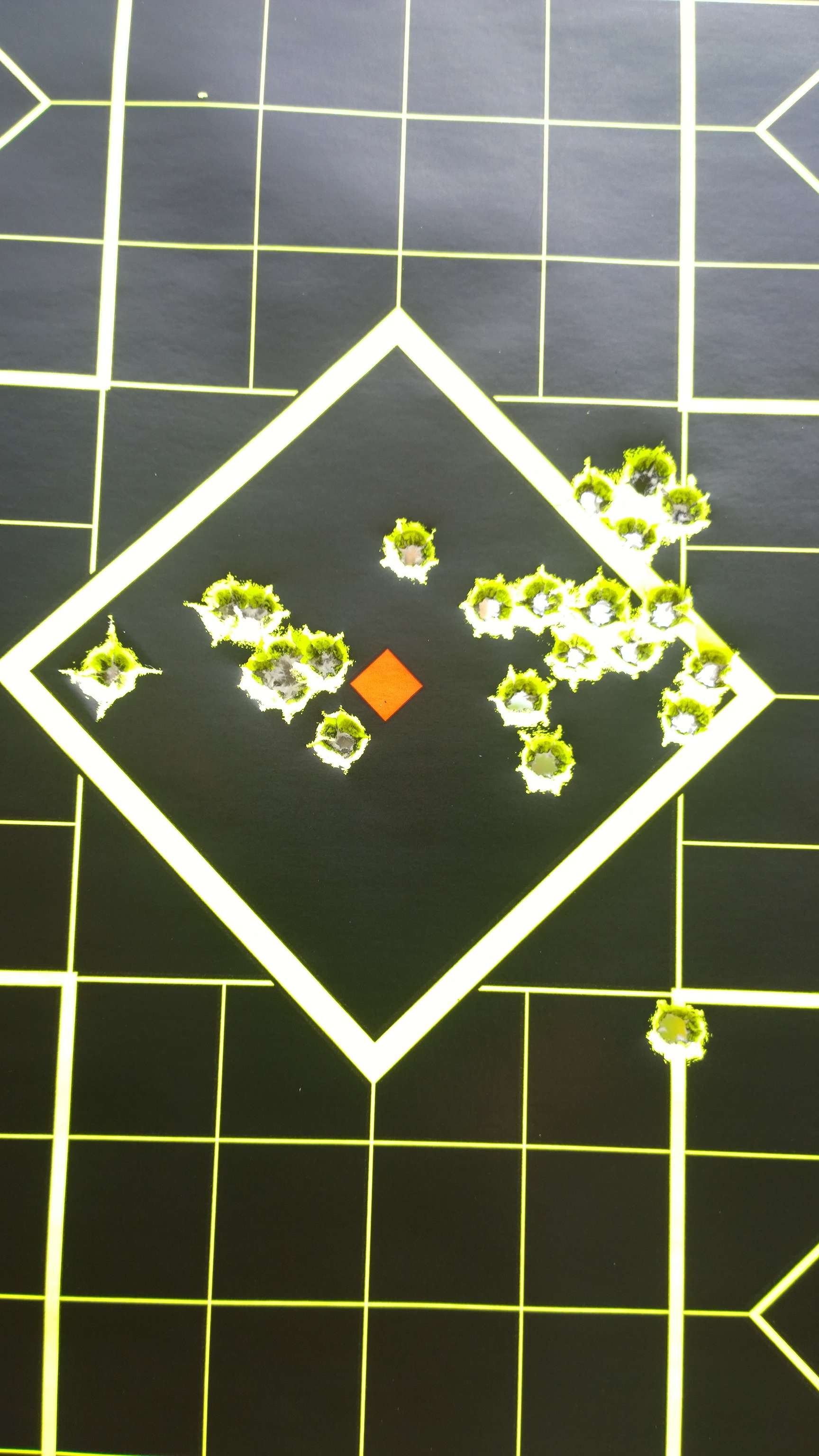

at 600 yards target, from 15 hits, 13 were within 6" square with 2 flyers that took it to 8"

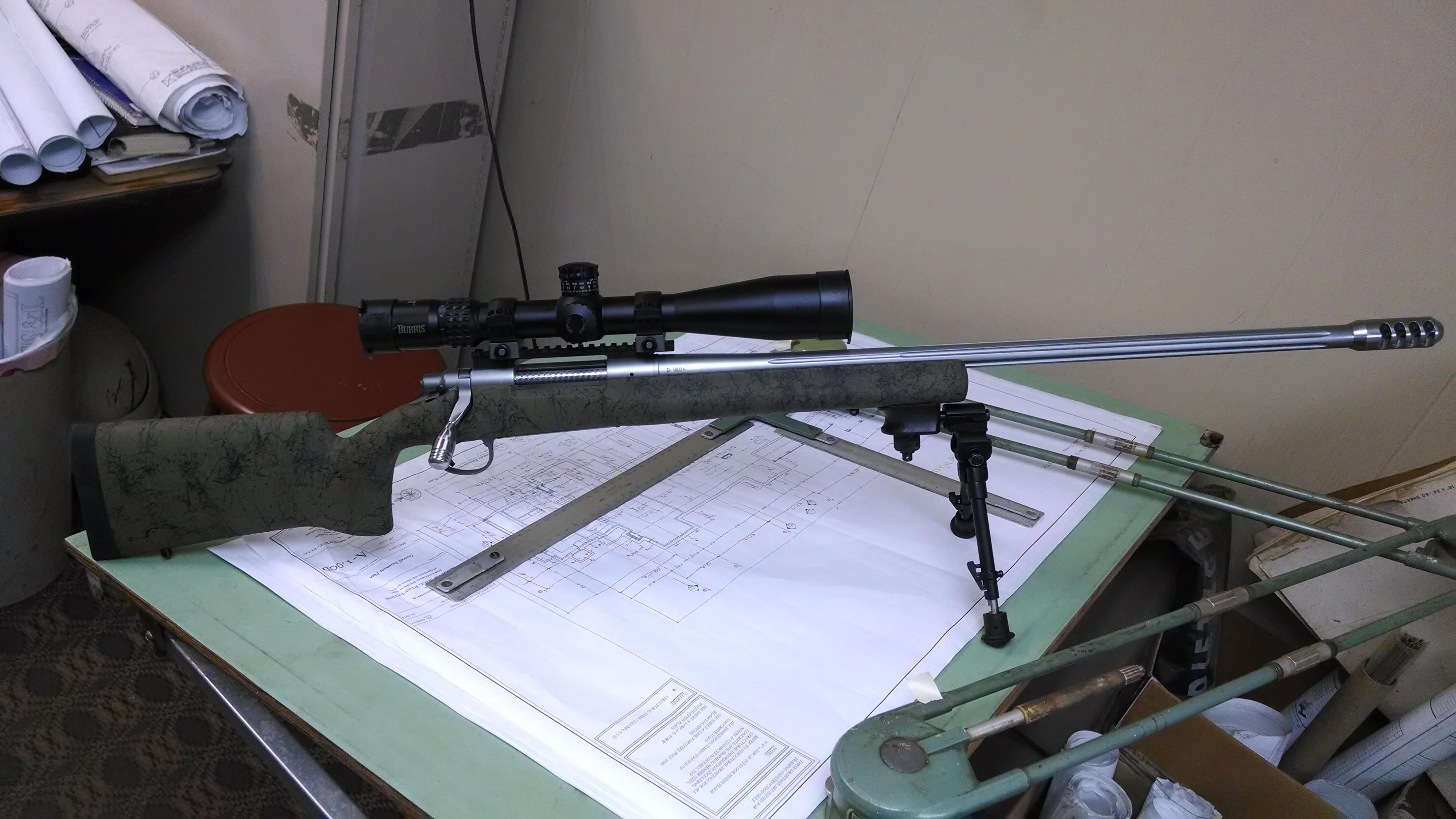

View attachment 41729View attachment 41730ok guys. had a long range session yesterday with my new baby. I was going through a break in with her as well as the scope. the clicks from behind the gun vs just out of the box does make a difference. from the box they felt a little mushy, when its locked down to something. I would call it soft but tracks perfectly. a friend of mine had his pst with him on a 308 and we compared in 11:00 sun with a little mirage floating. he wanted to trade and pay me 300. ;) so far I am very satisfied with it. it does seem to be a litte touchy on 25x. but not enough to talk crap about. we were shooting out to 500 and I kept it between 15-20x. heres the big question, if I had to buy it again after using it in the real world........ yes.
Can you tell me what rings you're running? Very nice rig by the way!
nightforce ultra-light med height. 6 bolt. thanks. I need to do some load development. I went to a local shop who had retumbo and when I got there I found out that Tim McWhorter had been there the day before and bought all 18lbs they had. :mad: I did manage to get a box of 210berg hunting bullets as a consolation prize. and admin, im sorry for the planet linc below.

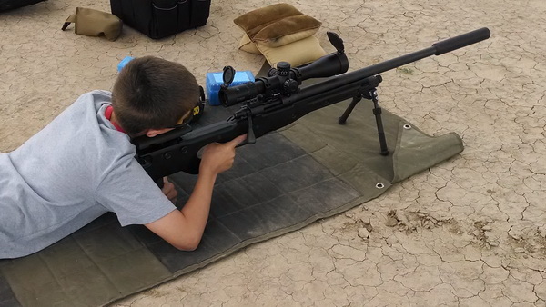

fdkay, here is a photo for you. I have the 4-20 on my .260. The rifle is a Remington 700 in an AICS with a 21" barrel and a TBAC suppressor. The shooter in the photo is my 12 year old, so he makes the rifle look a bit bigger. The scope is also mounted in a Warne One Piece for the AR platform...as I could not wait to shoot it and did not have the rings I wanted to use yet.
