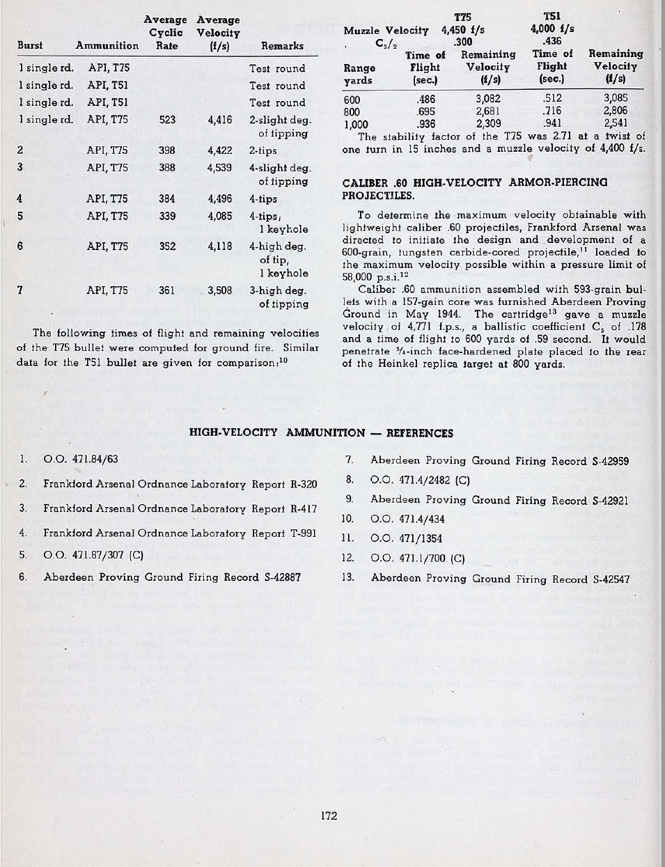

Has anyone heard of the 50 HV? (12.7x120mm) based on 20mm HS 404 case? Tested and manufactured in the 1940's by Frankford arsenal?
I don't want to search through thousands of old pdf documents... but I will try to get verifiable data.
Here is another image on the subject of muzzle velocity.
