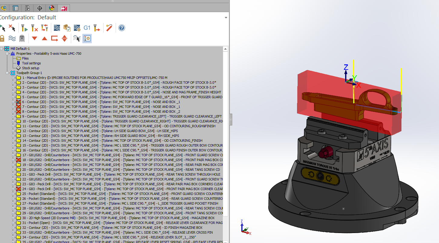

Gunsmithing By request, 5 axis Winchester M70 Blueprint video.
Outstandingly informational video! I totally understand the wants/reasons for the Winchester action, but what's the cost difference between the work done on it vs a custom action? And will the Winchester preform as well?
Hey Chad are you going to start producing DBMs for these? I've said it before and I'll say it again, when my SPR needs rebarreled it's going to LRI for the full treatment.
Werkinz on it. :)
This particular one is for a clover tang P64 with the 3.125" length port.

Always cool to see!
The code shot is great! Shows the kind of investment that a 'simple' looking job like this really entails. And that is before the special fixtures and jigs are made to 'hold' the work!
Anyone who says CNC is just putting a part in and pushing a button is delusional. This stuff is work!
Great videos!
