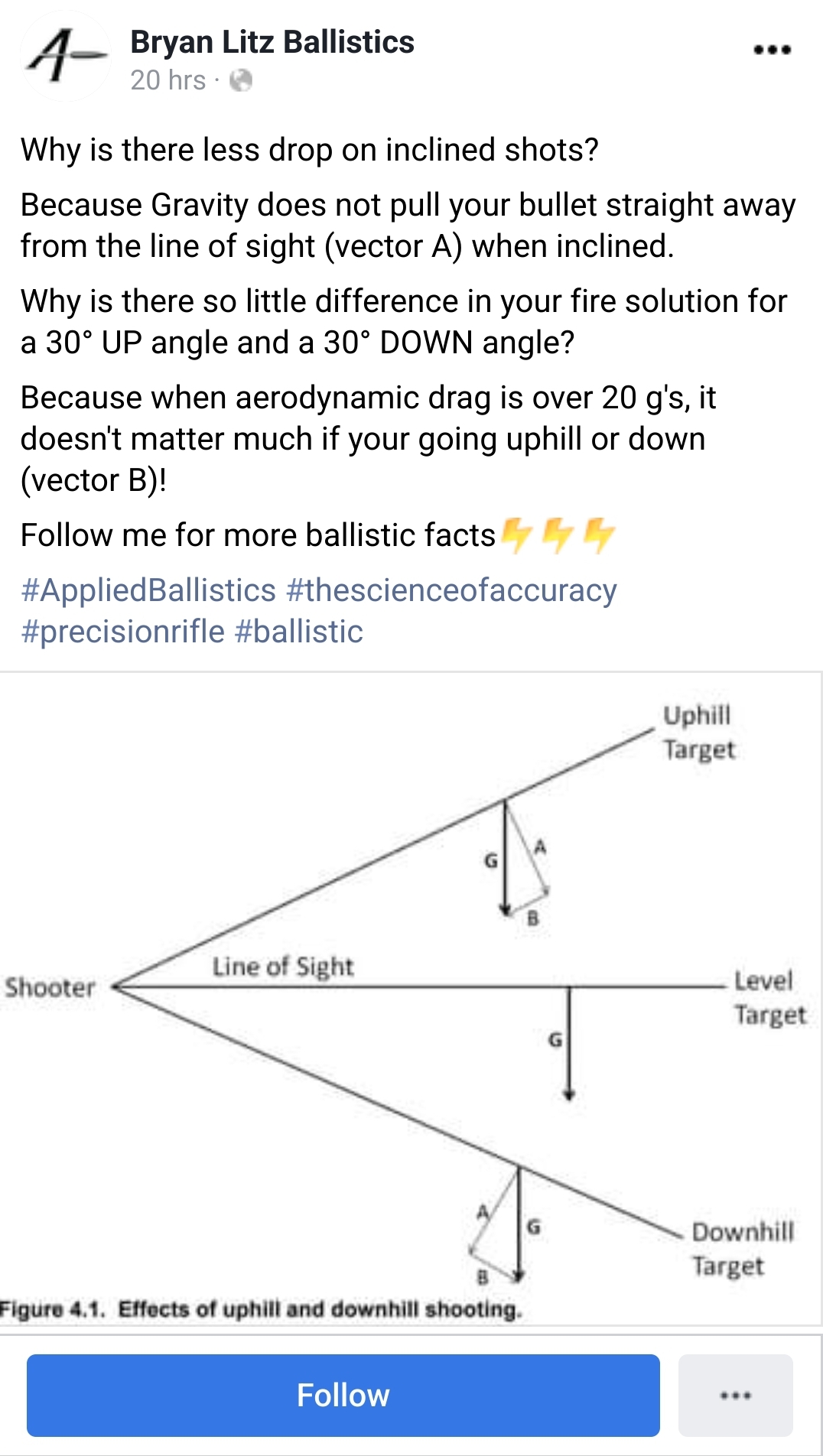

    Shooting at an angle doesn't actually change the distance to the target. It alters the effect of gravity on your bullet (in effect it lessens the pull of gravity on the bullet). One of the ways to deal with this is to shoot dope for an "effective" distance.
    Litz just talked about this and posted on it in the facebooks/ab blog, internet's, etc..
    Worth a read in the book version as well.
    Based on 700yd (2100ft) long and 200ft height (up or down dont matter) - got ~6degree angle tops.
    Equates to .996 of actual value for LOS distance. 700yd LOS = 697yd actual
    So id say just shoot it like a flat range, if you have the 200ft height at say 2-300yd then you may want to worry about it a tad more.
