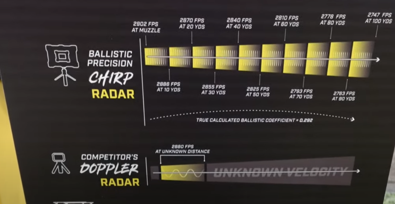

Interesting architecture, no idea how reliable this thing will be or how it's performance will be yet, but the marketecture certainly curious...

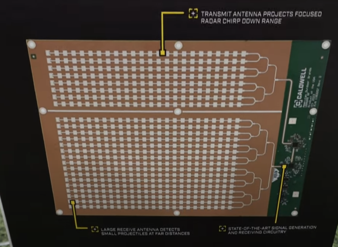

Huge antenna array. They describe it as using a series of chirps with different signatures so when it gets a reflection it knows when that particular chirp was sent, so they can calculate how the distance, velocity at that distance etc. They differentiate this from Doppler.
Meaningful? Who knows. We'll see.

In theory it should work great for chronograph work, it can easily handle different size bullets at different speeds made of different materials and over a much broader range of distance.

CHIRP techniques are a form of pulse compression within a long transmit pulse. They use a linear FM modulation technique for the CHIRP and measure the frequency shift of the return signal to better resolve multiple targets in the same spatial domain. This technique in concert with a larger array is pretty cool to find in a consumer application. The antenna array is nothing special just an equal amplitude array. You can tell by the feeder network on the RHS of the PCB. They could have improved performance by using a different antenna array architecture but this is definitely beyond what I have seen in other chronographs using simpler Doppler techniques.

I really wanted the benefits of the radar derived BC, I realize it was only out to 100 yards, but it gives a a good data point to start with.

If you know the velocity of the round at say 10 ft, shouldn't the velocities from there out follow a pretty standard curve? The CHIRP sounds cool and all, but is it really telling you anything valuable?
