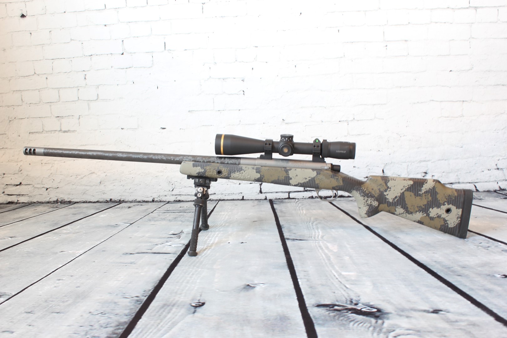

    Not my rifle, Blue Mountain Precision built it. I was looking at the same stock or the EH8+ for an ultra lite high country rifle.
    Reactions: Skunkworx
    I came across that Blue Mountain rifle the other day. I guess it doesn't look too bad. Heres where im at. The EH4 is 29in in length, and weighs 26oz. The MCS-T is 31.5in long and weighs 28oz with the carbon fiber option. So for 2oz im getting a longer stock. I have to believe that the stock being longer would make it more stable to shoot off a bipod or offhand...as your support point is closer to the muzzle. Is it worth a 2oz weight penalty for that slight benefit?
