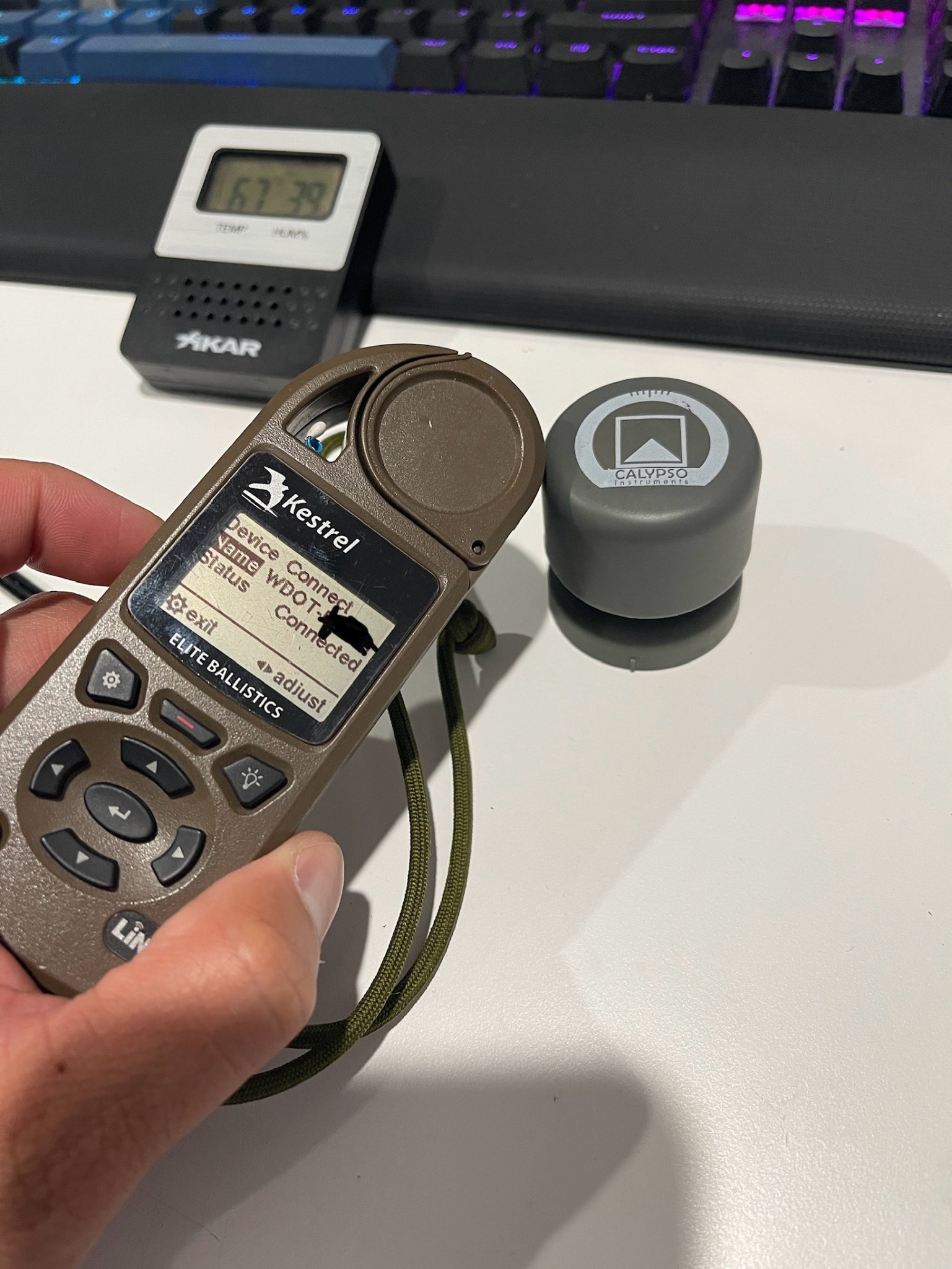

    Mine came in today.
    It connects to the kestrel, but it doesn't do anything from when I got it out of the box. (I have it charging right now to see if anything changes once it's topped off.) It would connect, but the wind information would not update.
    On the app, real time information is noticeably (but not insanely) faster than the non-AB version. When I first connected to my phone, there were some options for a LRF, the update status, and something else, but I don't see it anymore.
    I'll leave it to charge and play around with this version for a little. I returned the non-AB version because instructions aren't up to date the the current app version, and the device is just set it and go.

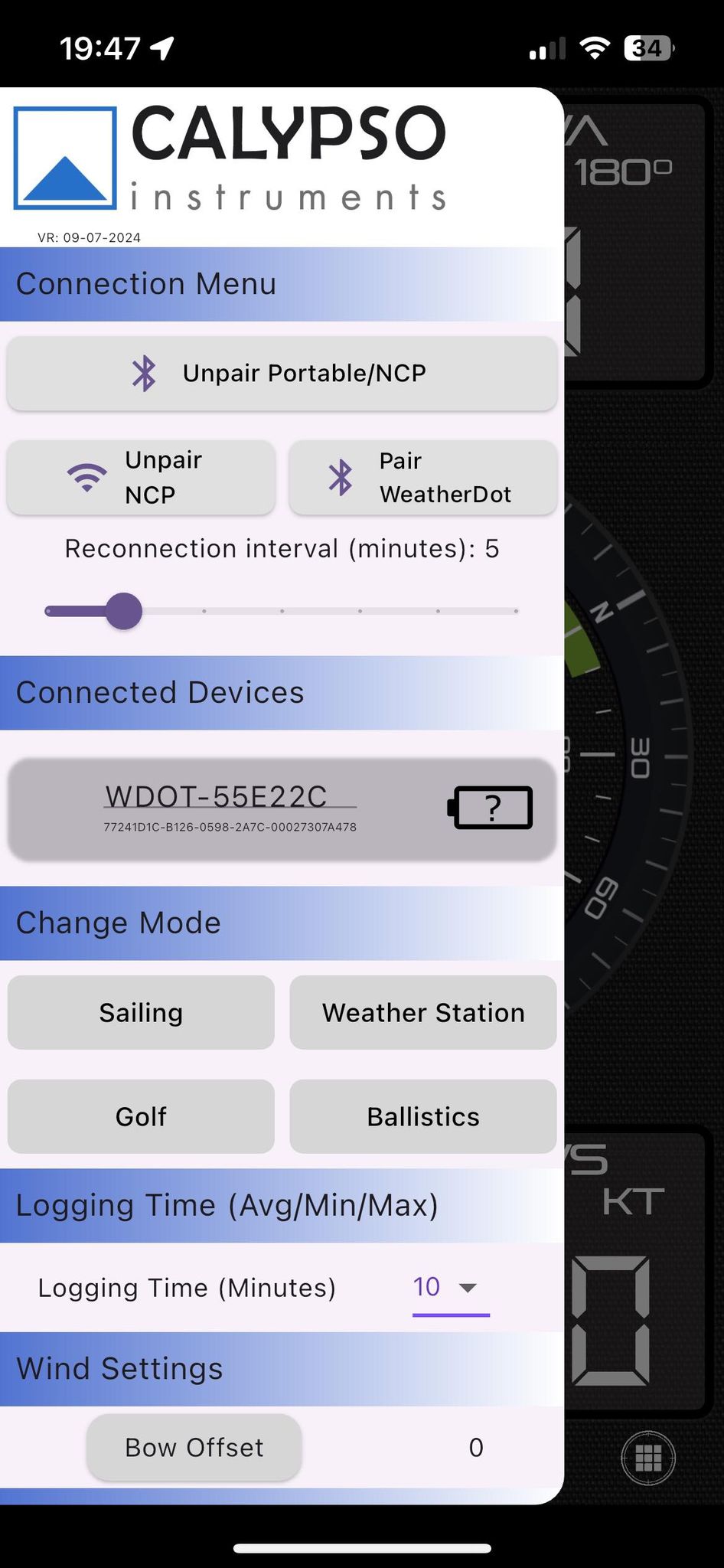

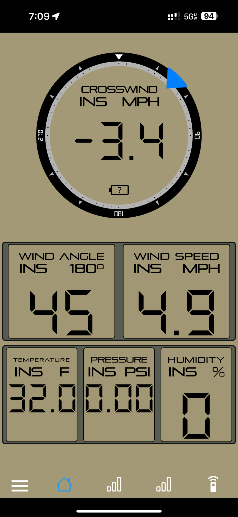

    With the new app, I was able to get the readings. I was able to connect to Kestrel and Garmin through AB, but I couldn't get the readings either. I wonder if AB enables all devices to work right out of the box, or if the developers on the other side (Garmin/Kestrel) need to update their firmware on their device as well?

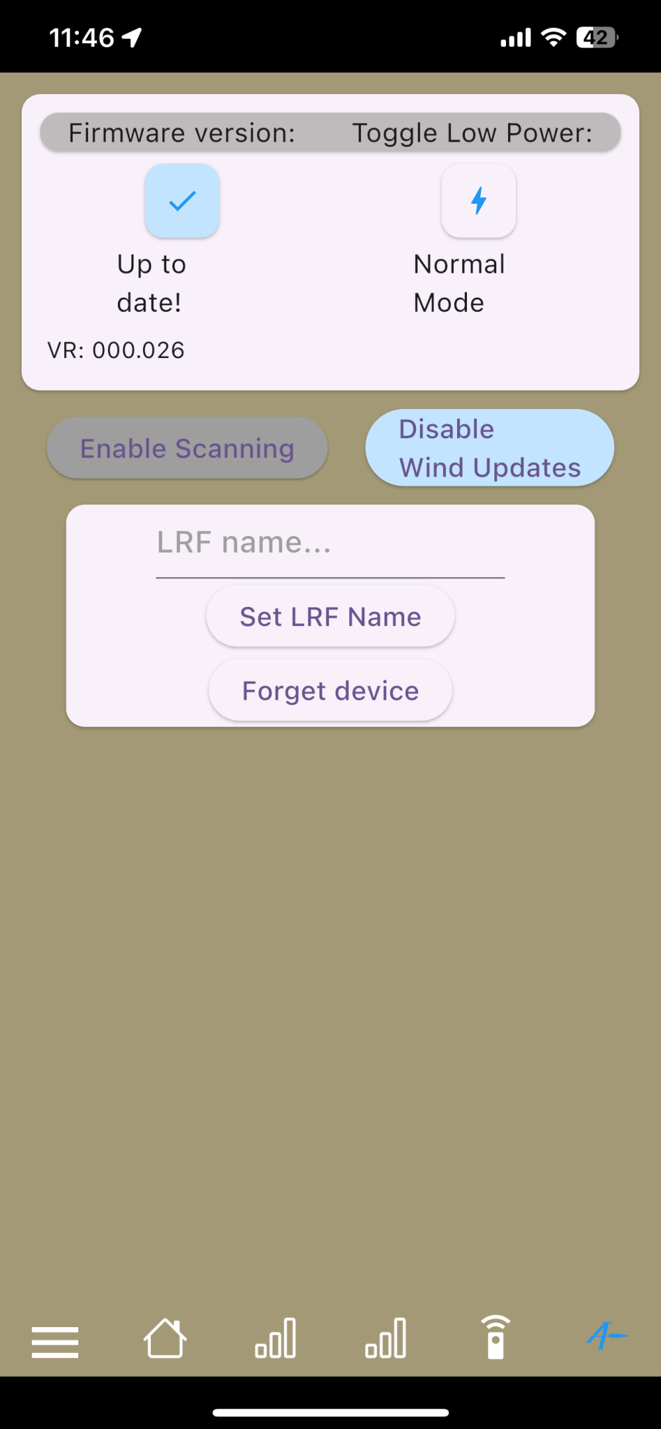

    There is a firmware update from July 4th but no mention of AB.
    The iOS one does.
    So far didnt see any new firmware from the app. It shows device is up to date.

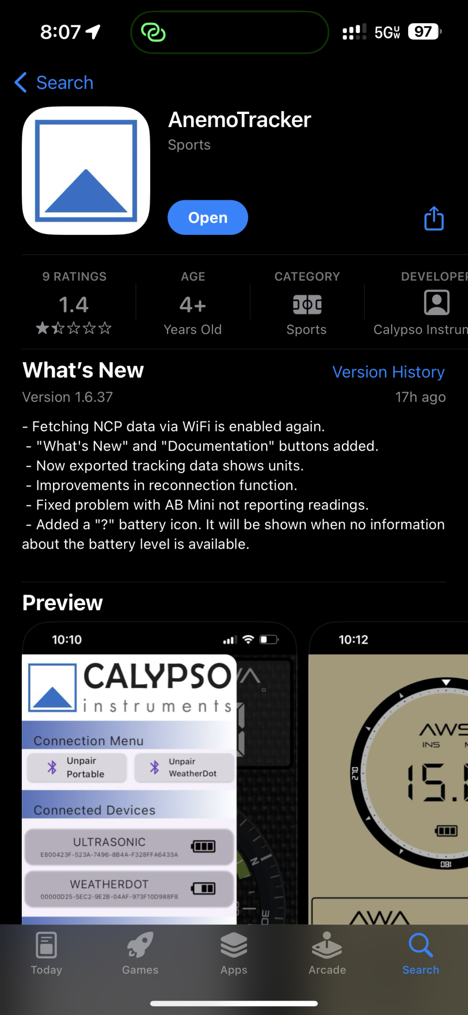

    Considering how they have the Anemotracker updated to include a pretty good manual on July 2 that details what the metrics mean and even their calculations for the metrics, I think they took input in regards to people not understanding the values. That was the major issue I had.
    In terms of the app, it definitely needs a good developer or it's going to encounter the same issues as Labradar. Small things like values being cut off and a better visual indicator of being connected becomes an annoyance.

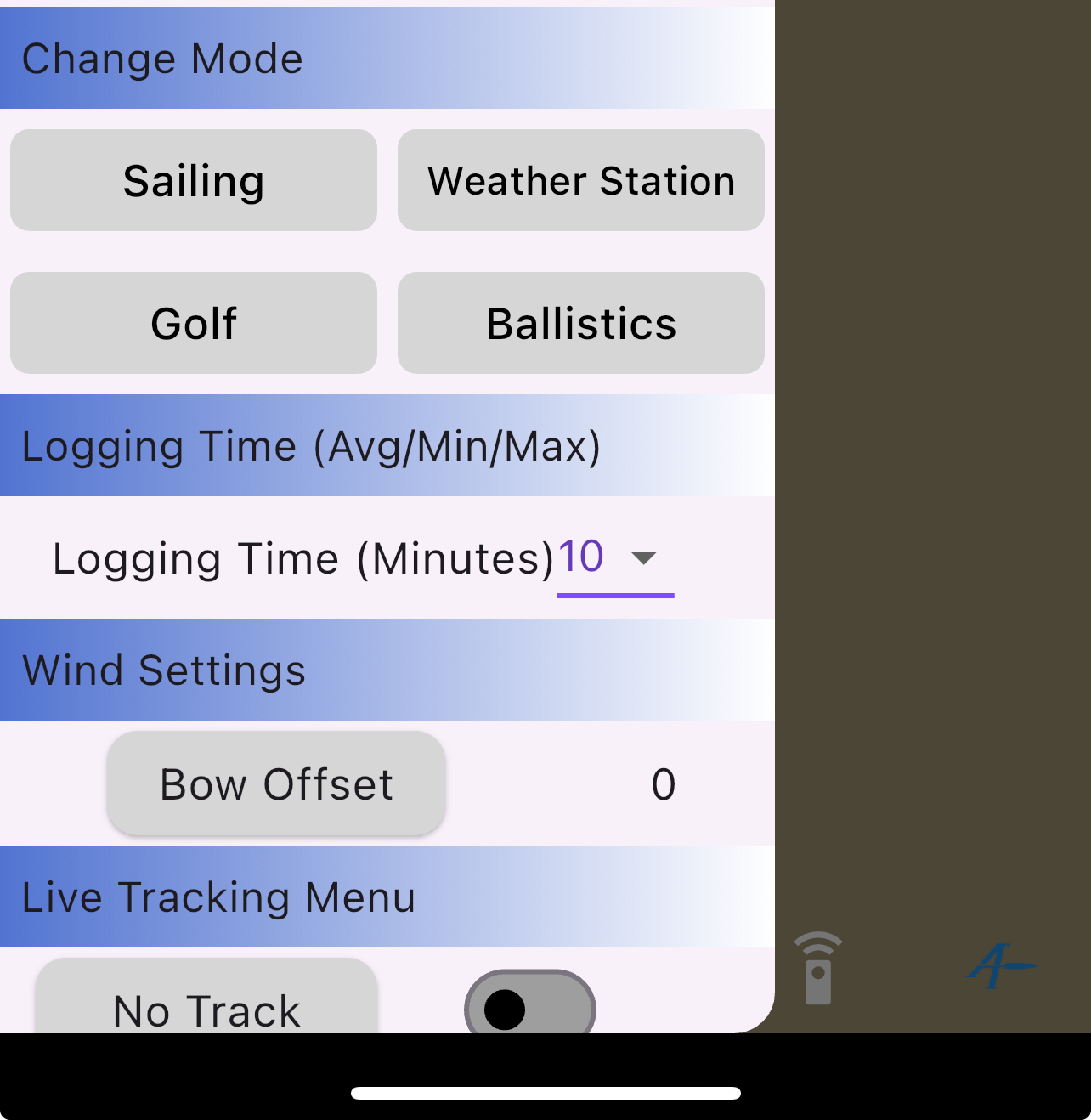

    It looks like you can get to the AB menu by going to the side menu and reselecting "Ballistics"
    Still trying to figure out why this is not updating a kestrel. I can't connect to a kilo 8K and I don't intend on testing with other phone apps, since we already know it works.
    I have emailed applied ballistics, Calypso (phone with no response), and Kestrel to see if this requires a firmware update to see live data. I am curious who they contacted to test this product at this point... So I can harass them for guides (with money of couse)
    edit:
    Changing options in the AB menu and connecting to the Kestrel resets the options.
    Options:
    Wind Updates = Turns on (highlighted blue) real time wind reading
    Scanning = No idea
    Set LRF = No idea
    Yeah, I'm going to need some guidance on this. As of right now, if I can only use the real time data from my phone, I'd rather get the cheaper, AB-less model. Looks like we're beta testing the release.
    Update: Having updated the iOS app again late last night, my wind meter is now sending wind info to the iPhone.
    Was sent a message saying that Garmin items that connect are the Tactix7, GPSMap67 and Montana 7xx. I don’t have any of those.
    Items I’ve tried to link:
    * Kestrel5700X didn’t find it.
    * SIG Kilo10K binos didn’t find it.
    * Garmin701 did find it, but couldn’t get any info from it? The 701 would be good, being wrist mounted.

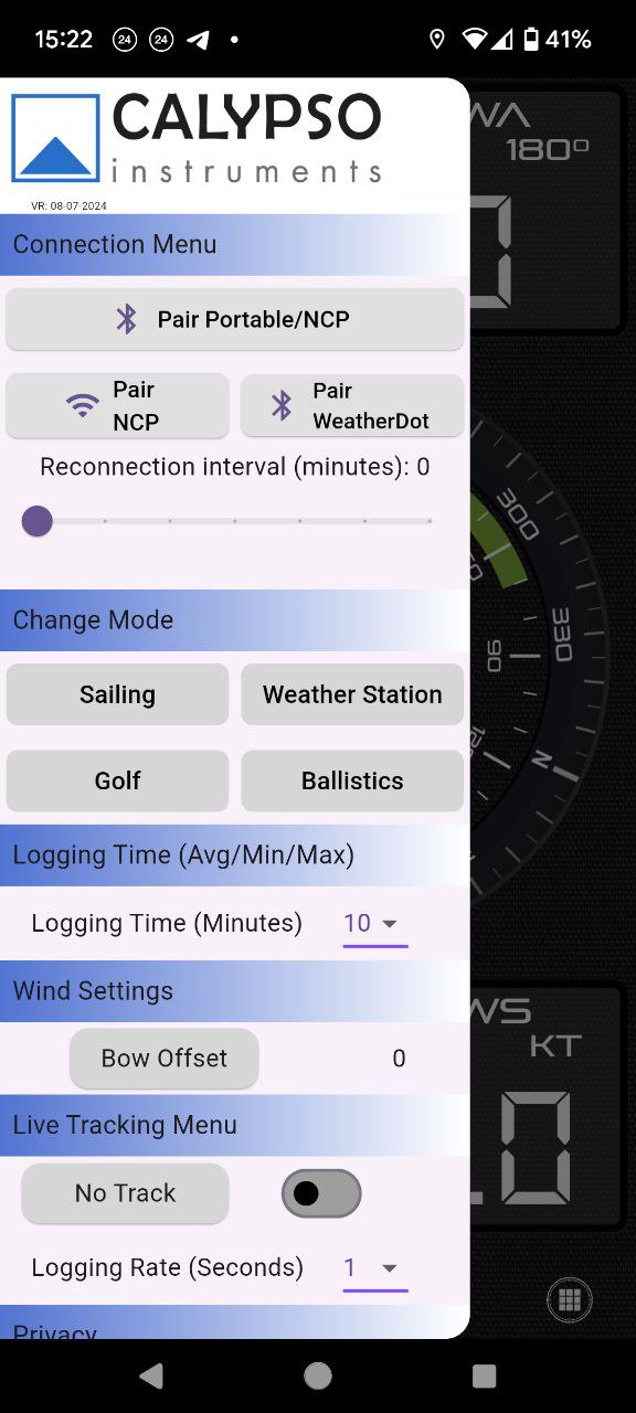

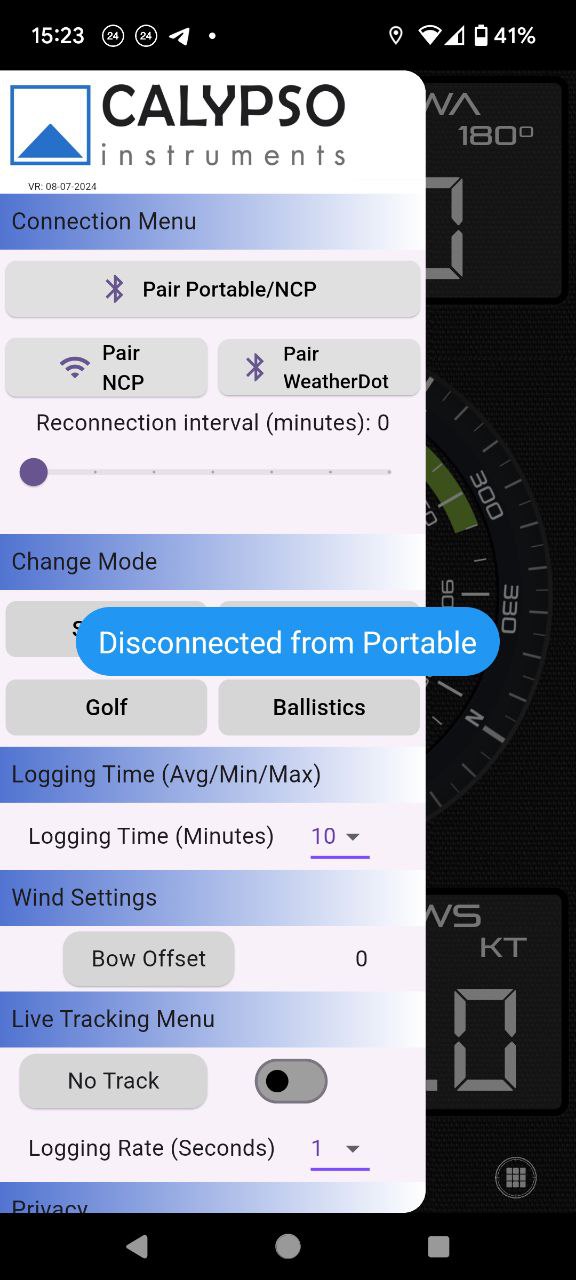

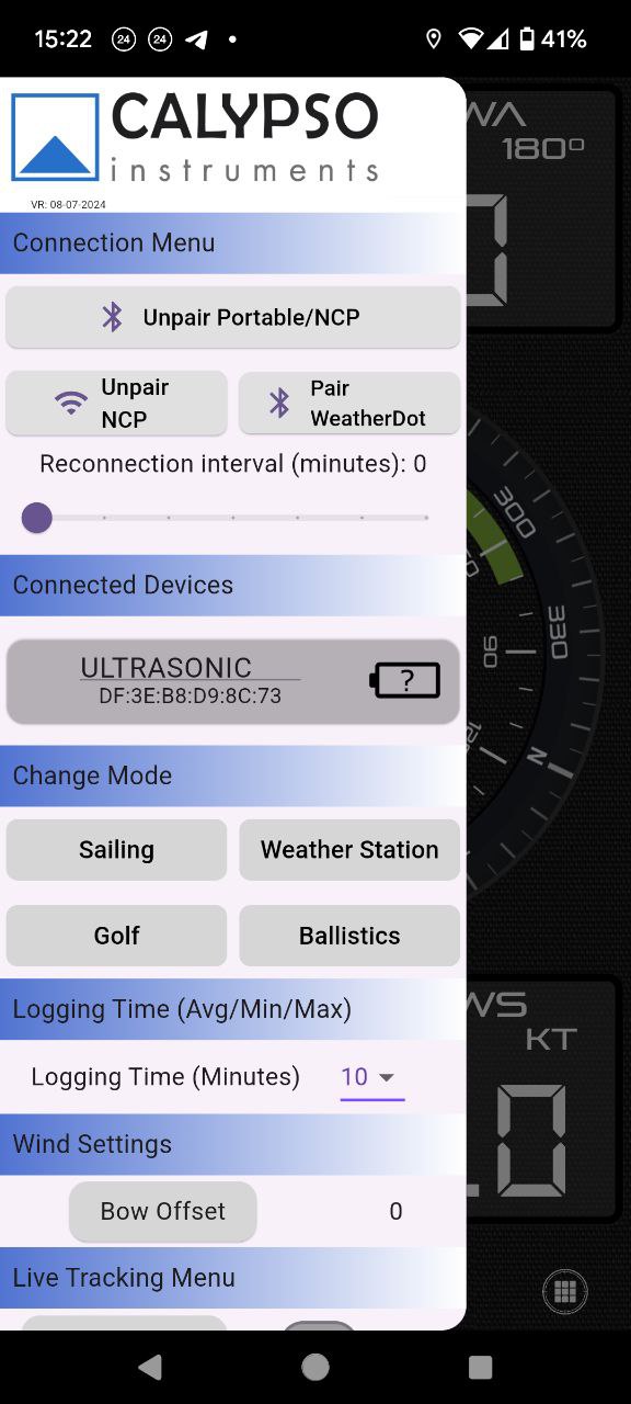

    I have the non AB labeled calypso, and have the anno meter app on my phone as well as garmin watch. I bought a cheap one that was said to interface. Bluetooth range on my phone is pretty good but the watch needs be pretty close, like no further than 15-20'. I cannot get anything to sink with my kestrel elite. AB app keeps saying there is a new update coming soon, backup your data. I'm sure this will be the software that integrates with calypso.
    I'm also trying to connect the device to my phone. I've already tried both android and apple stumps. But it's all in vain. The AnemoTracker program tries to connect, but then disconnects without showing the battery level. The configurator hangs in the “connection” mode. The Strelok program seems to connect and then immediately disconnect, without indicating the speed. The program from Hornady shows wild speed and arbitrary direction, while it is not dynamic, but static.
    I also have a version with a solar panel, it works well with Strelok.
    By the way, I bought it on tradeinn.com, the device came without a charger. I had to buy it separately. I already think the problem is in the charger.
    Maybe someone has some information?

    FWIW the Anemotracker app itself is pretty good on reconnecting to the "last device" used, no idea if that function is covered in their dev manual. Looking forward to seeing your repeater setup.
