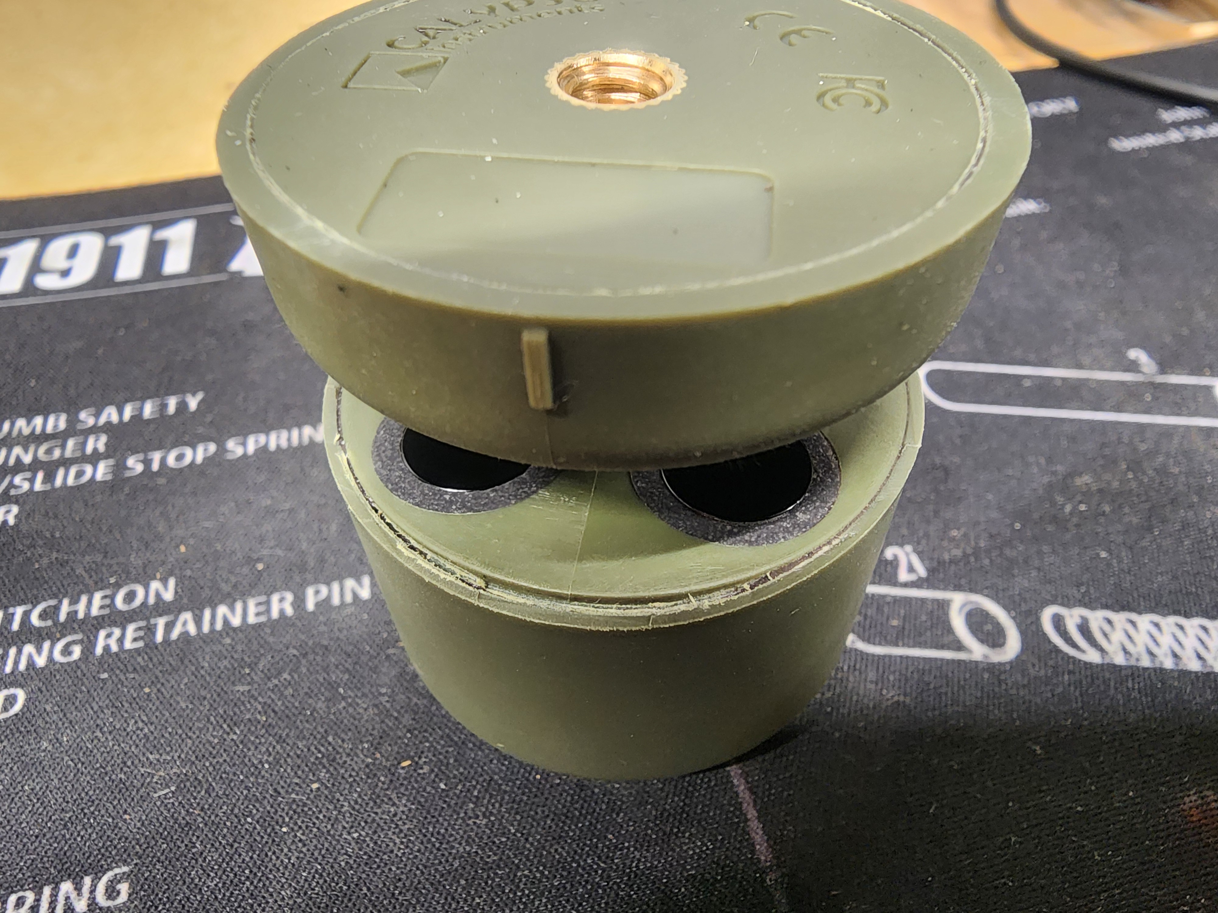

I just received my calypso today. It appears as if maybe the filler material expanded and caused the housing the expand outward. Is this cause for concern? Anyone else have this on theirs?
If I had to guess, the software/hardware(?) is epoxy encapsulated for proprietary reasons. Yours just expanded some. But I’d keep asking and get out and test it ASAP.
