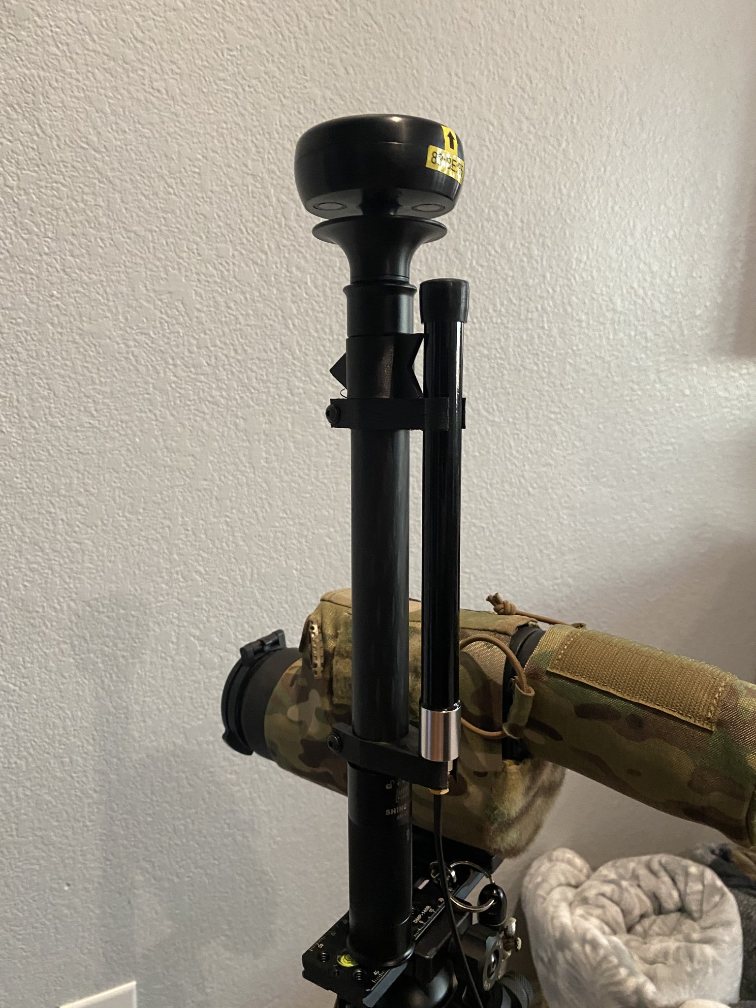

Hacked their BLE IC and tapped a 2.4GHz antenna to it. ~100’+ of range for multiple devices now
