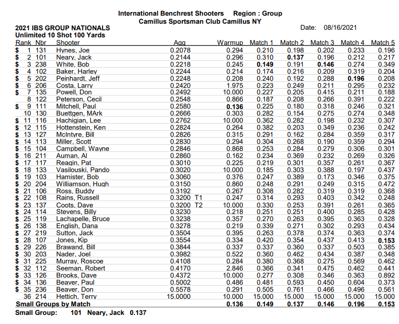

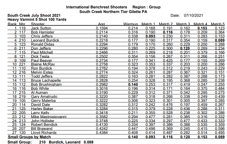

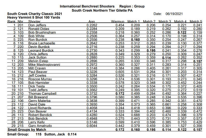

Hi,
.3" or better all day??
Just giving you a hard time but.....
You and that rifle need to go clean up the IBS matches, lol
Sincerely,
Theis

Right now I'm holding in hand a trophy for 4th in the 1997 NJ State Sniper Championships, a paper match fired at 300yd. I fired that match with a Win 70 Featherweight 30-06 that I had obtained the previous day and sighted in with 168gr FGMM, which was also used for the match. So there are thin barrels out they which can shoot really well, but they are probably scarcer than hen's teeth
