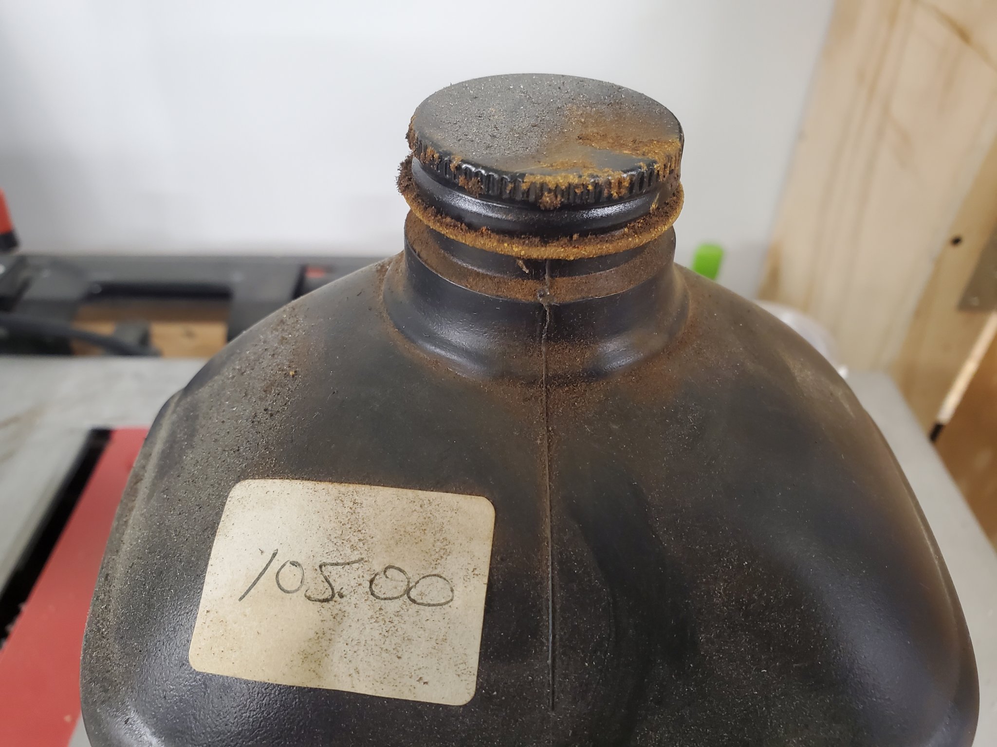

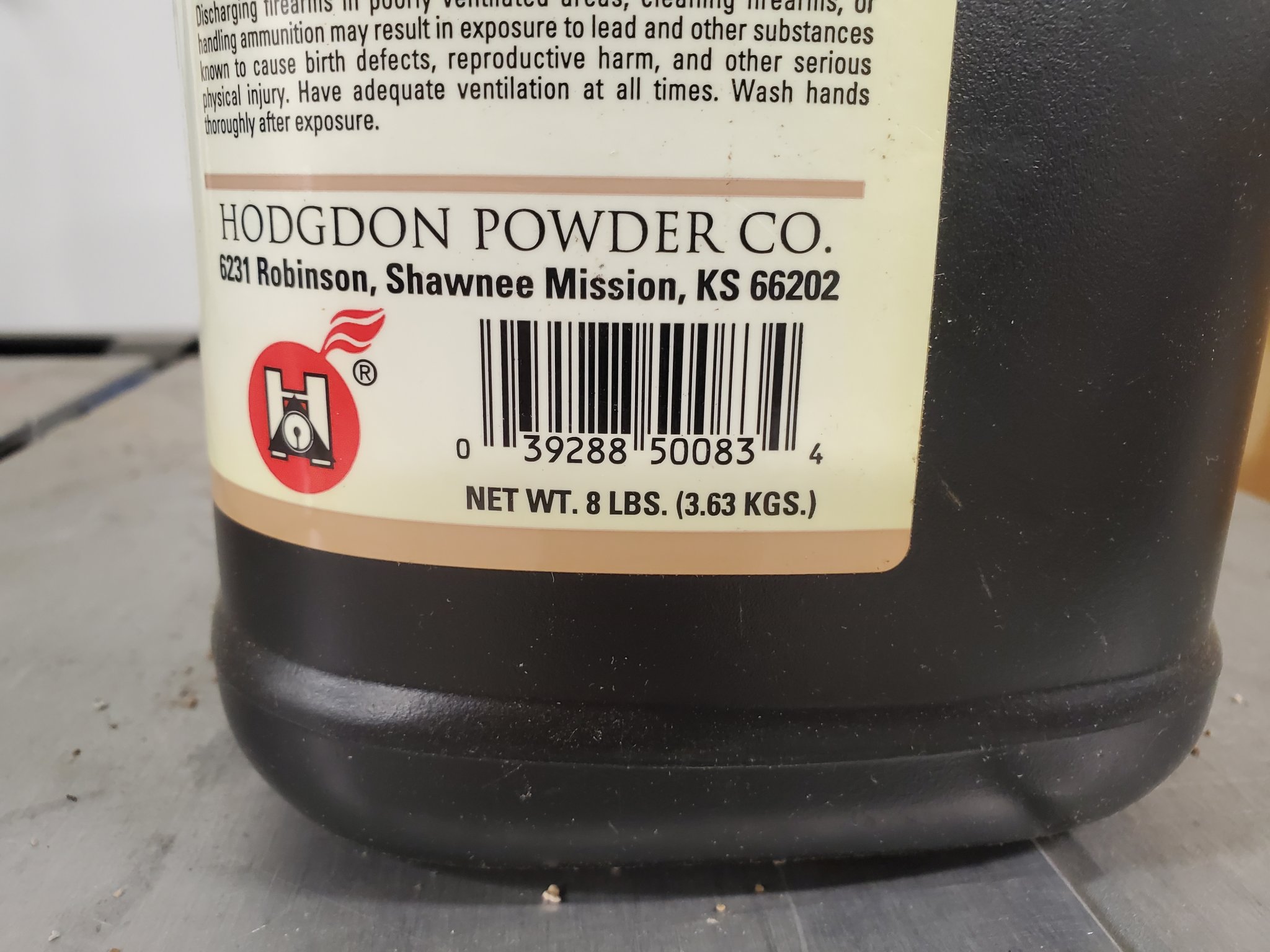

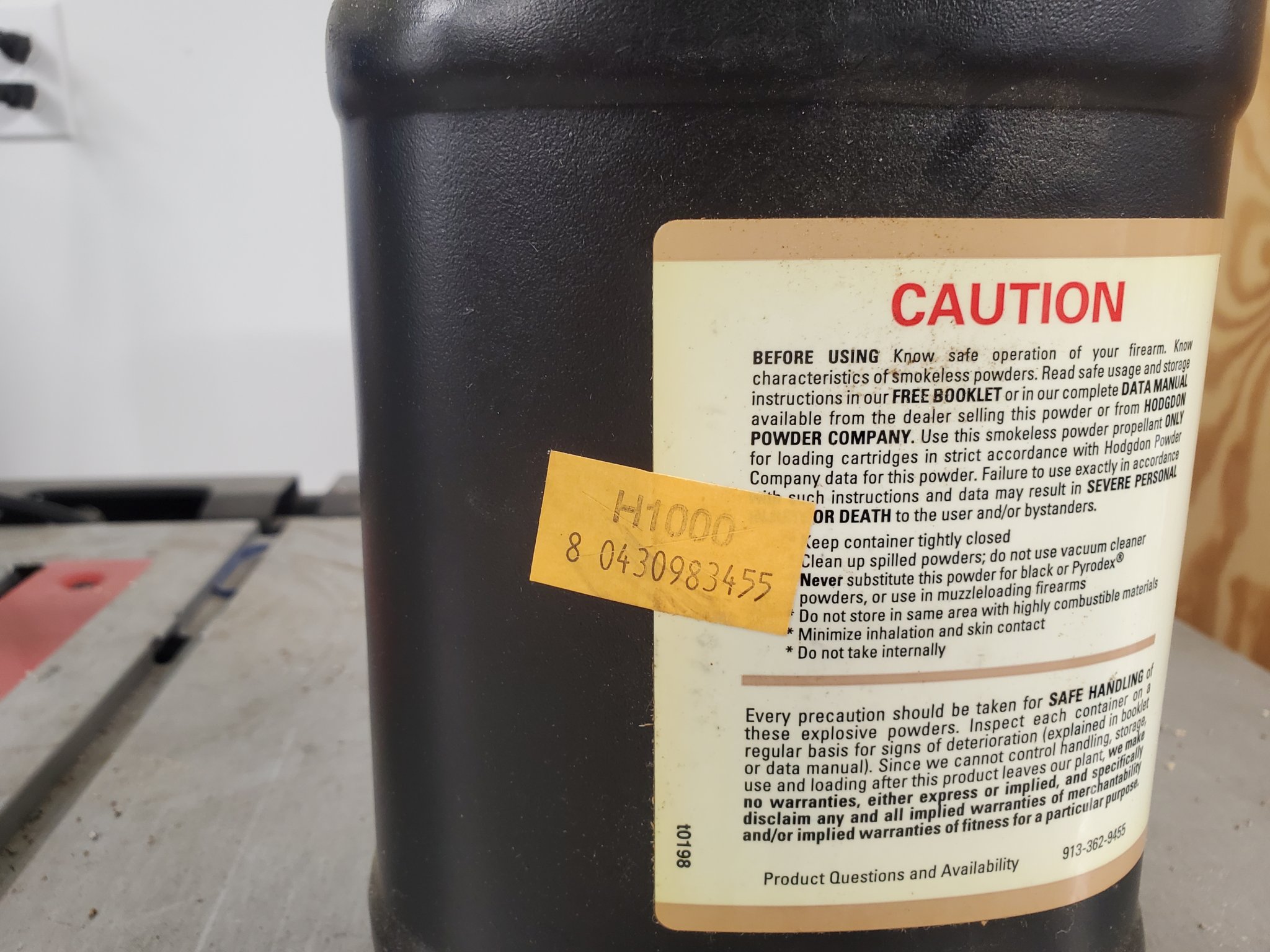

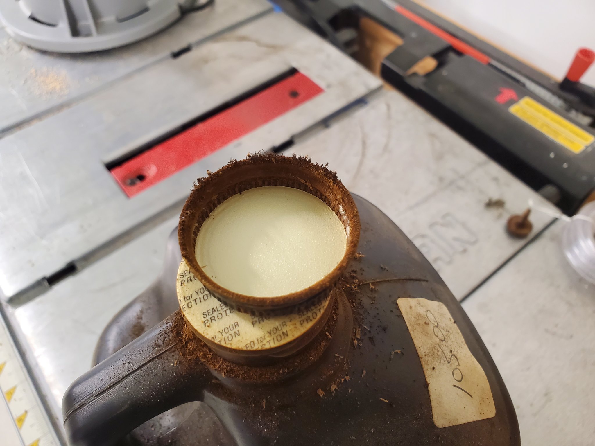

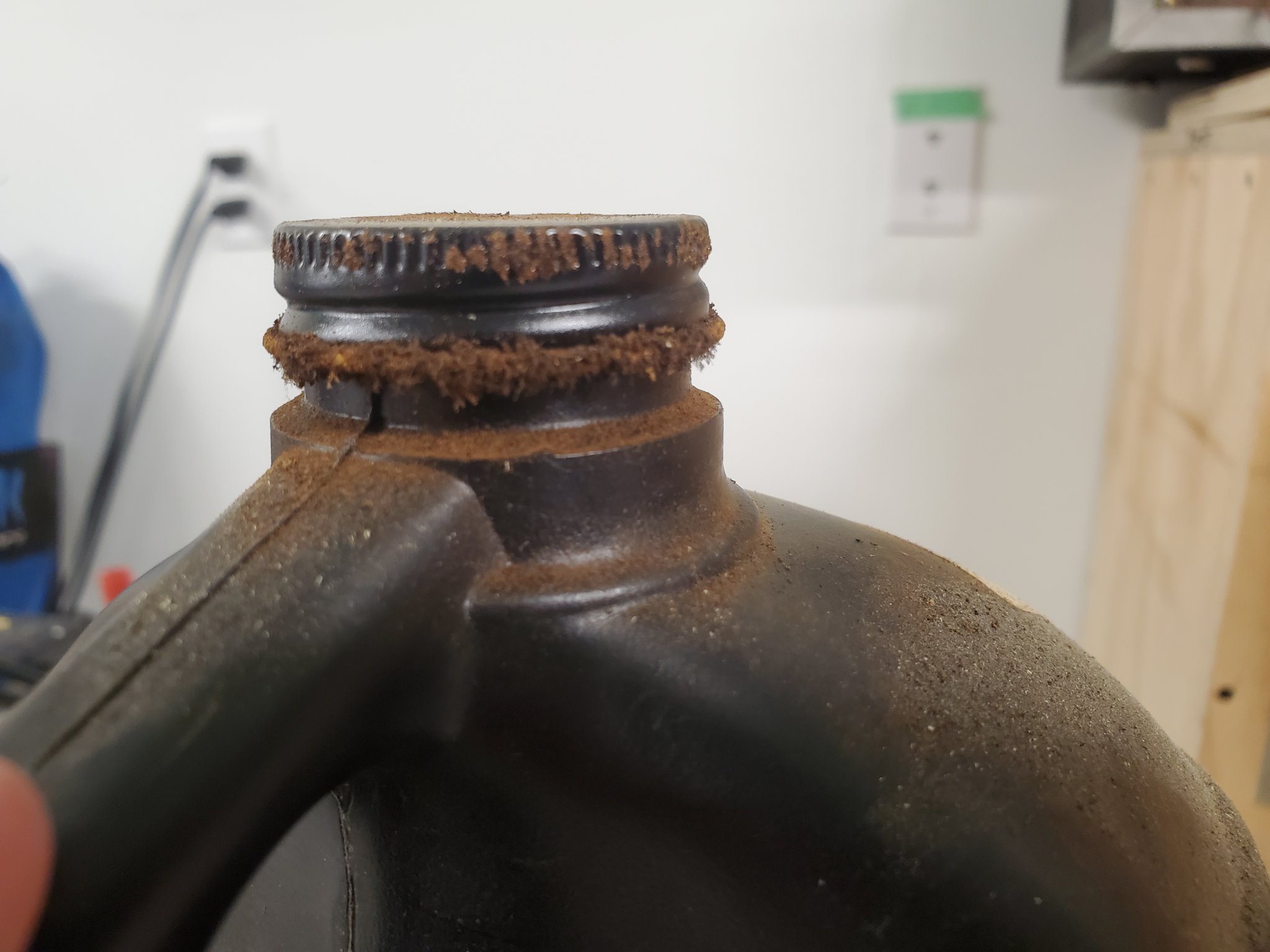

Hi guys,
8 pounds of vintage H1000. Metal cap. Note the reddish "rust" around the cap. Good? Or, not good? Smells like acetone, does not smell sour.

Pour out a handful of that powder onto a plate or something and post a picture of that. Keep an eye out for any clumping or color/texture differences.
I asked Hodgdon. They sent the attached doc (original was in Microsoft Word format).
It says that bad powder will contain reddish clumps and smell sour (acidic) instead of smelling of acetone. They also said to pour some on a sheet of white paper and look for red dust. I have no red clumps or dust and it smells of acetone. I will make a few rounds, loaded down a little, and see what happens. I bought it in Denver in 1998.

Powder can get ruined by moisture, but if kept cool and dry it will last several lifetimes. LOL "vintage H1000". I think that was commercially introduced in the 1980s. For me "vintage powder" Is my grandfather and dad, and it starts before I was born. I still load out of paper and tin kegs of old powder like Herco, Unique (dirty), Green Dot, and Dupont #4, that have been stored cool and dry for 70+ years. Some of it is a bit slower than the published specs from 1965/1971 (the books I have that list them), but it works just fine. Some of it you can still buy, but it's been reformulated.
There is absolutely NO danger in shooting old powder as it will NOT become MORE potent. Worst case it's kaput and causes a squib, but that is the worst thing that can happen. When you are working up a load with it do not begin at the start charge, but rather in the middle between the min and max load.

Regarding 10 rounds of "vintage" H1000 powder at charge 76.7, the old stuff shot the same as the new stuff. At 1k the POI was pretty close to 76.9, 77.0, and 77.1. As I went up from 76.9 to 77.2 I had clicks and showed a tiny bit of ejector dimple - more powder, more click. I'm going to go back to 76.5, 6, and 7 and see how they group on paper at 500.
