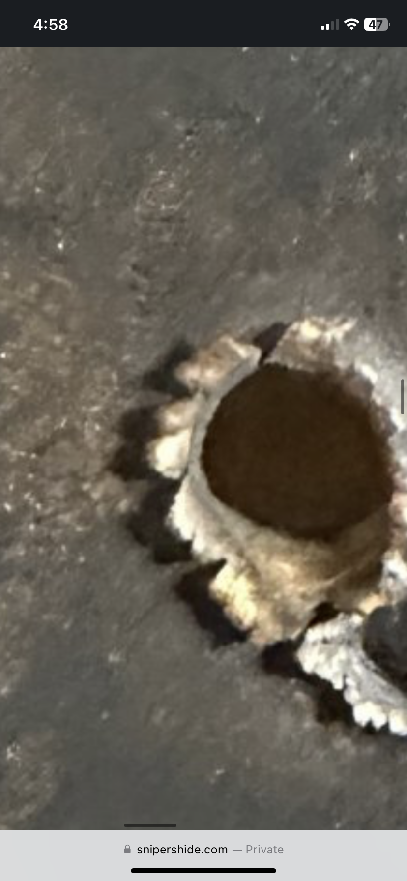

My brother was sighting in his 30-30 at 100 yds and then tried from 50 yds since that is closer to the distance he hunts from.
All the shots shown are the same caliber from the same 50yd distance. Shot one and three were stopped. Shots two and four went straight threw the 1/4" hardened steel. The still is from a metal manufacturer from in town but not specifically designed to be ar500 rated steel. We have been shooting this same target for 5+ years hitting it with everything in our arsenal without any problems until now.
Possibly you’re shooting black-tip without knowing it. Happened to me a couple of times. Hand-loads?
Also, 1/4” is pretty thin, even for AR500.
If you look at the sheared out surfaces you will note that the surface is bright with minimal rear tearing. This is classical for adiabatic shear which occurs in hard plate when the strain rate (velocity) exceeds a certain limit value. The phenomenon is peculiar in behavior, very digital in determining V50 values and much heavier rounds with greater cross sectional energy will be stopped without much damage to the plate. It has overlap with the plate thickness ratio being 1:1 with the caliber but is not classical plugging of the plate.

In layman's terms, the bullet bitch slapped the plate.
.30-30 will go through mild 1/4 no problem.
I don’t think you got anything close to Ar500!!!

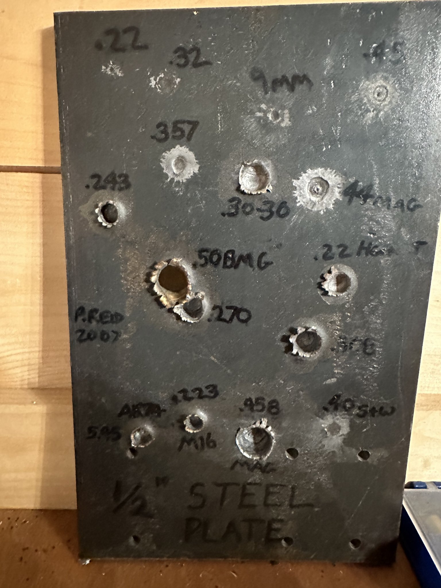

Here is a Piece I made for teaching hunter safety a few years ago. Shot from 25 feet. Showed
The kids in no uncertain terms that guns are not toys!
That is 1/2 inch mild steel. Note the .30-30 went well past 1/4”.
Sirhr
I have confirmed the ammo used was Remington Core-Lokt 30-30 win 170grain
and my dad who purchased the plate says it is 504 hardened steel
Ah... 504 is a non-hardened stainless.
Doubt at all that it was 'hardened' after being sold.
Certainly 1/4" isn't going to stop even a medium-pressure .30.
Sirhr

I just checked the website of the company he bought it from and he says heat treated plate so maybe my dad was confused.
Again we have been shooting this same plate for 4-5 years with nothing like this ever happening with these same guns before. I have hit it with green tipped 5.56 and hit it with my 6.5cm. My brother has hit it with his 30-30, 3.06, and 300 blk. I even found casing from someone shooting .458 socom out there. Nothings ever punched a hole until now.
