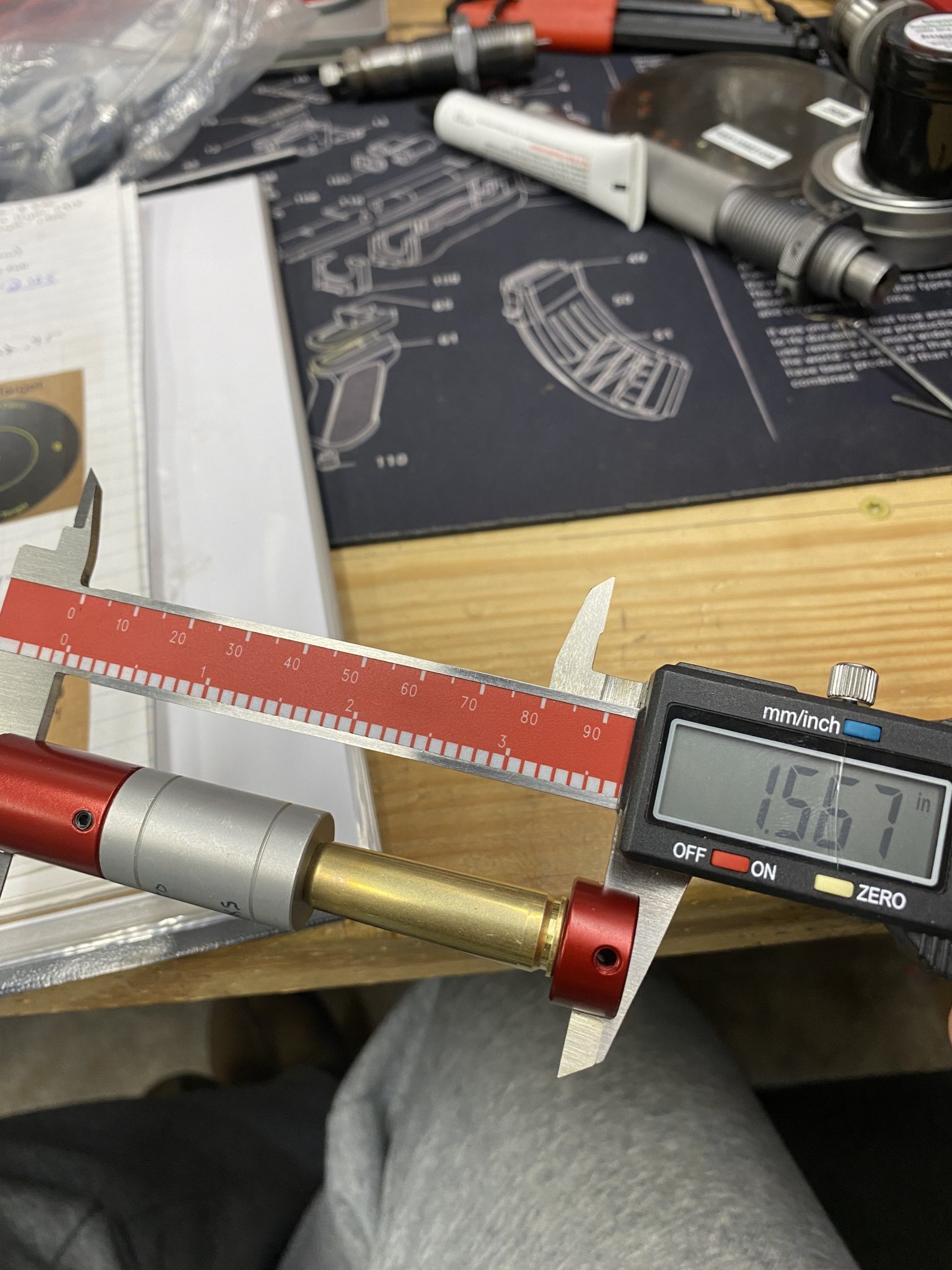

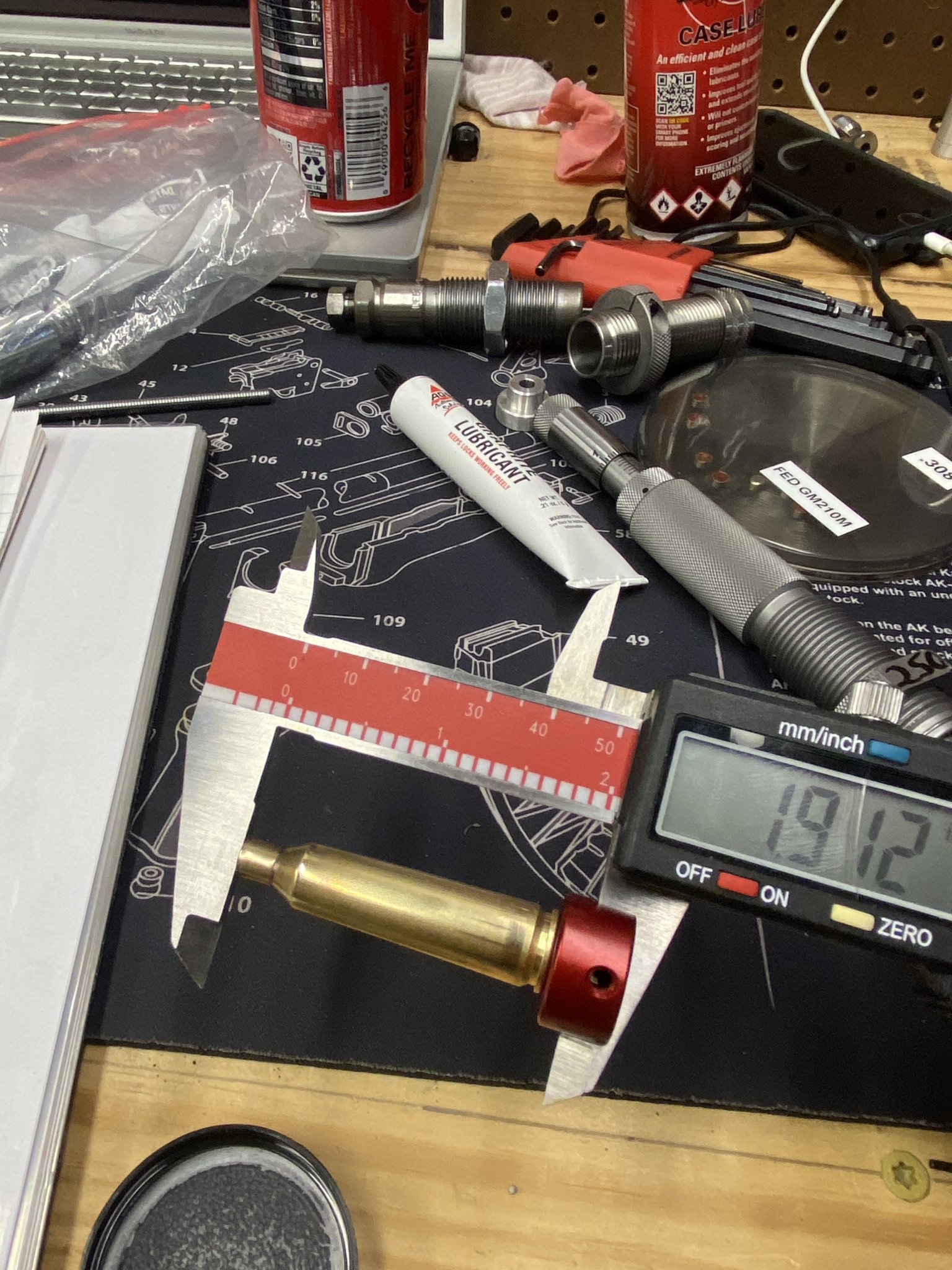

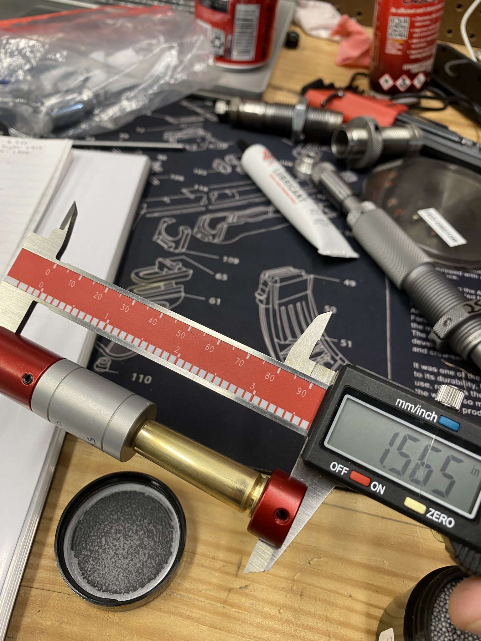

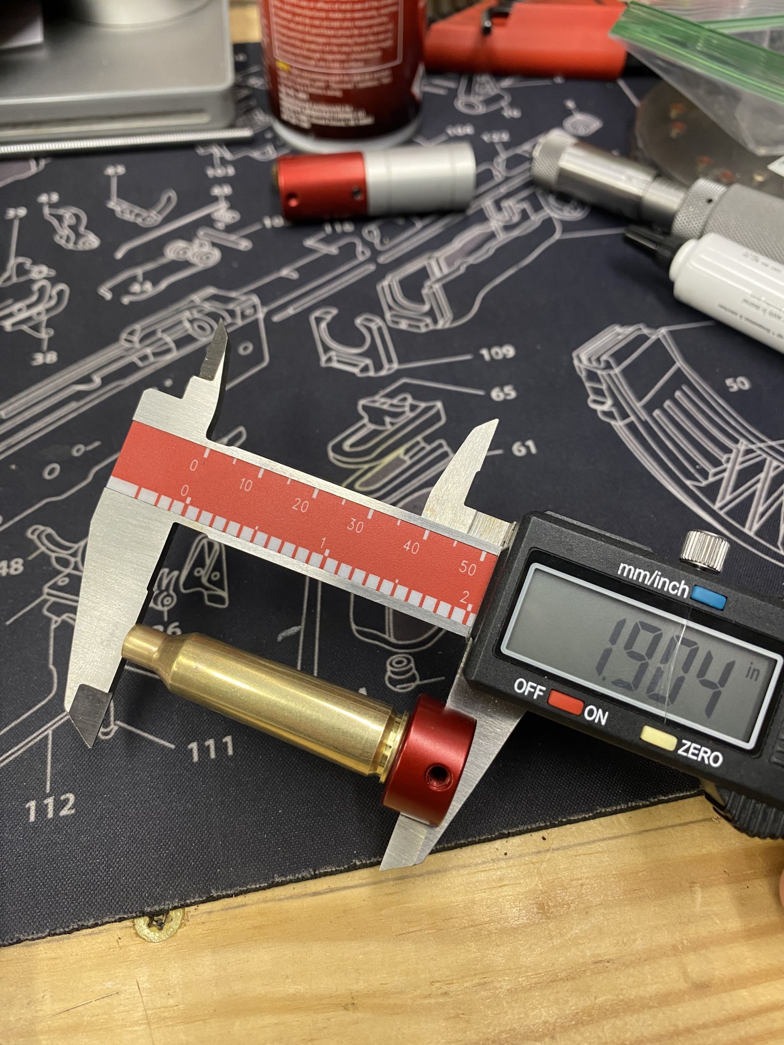

Wish I knew why but it certainly is. Here’s before sizing. Headspace: 1.657 and case length: 1.904
After sizing. Headspace: 1.565 and case length: 1.912:

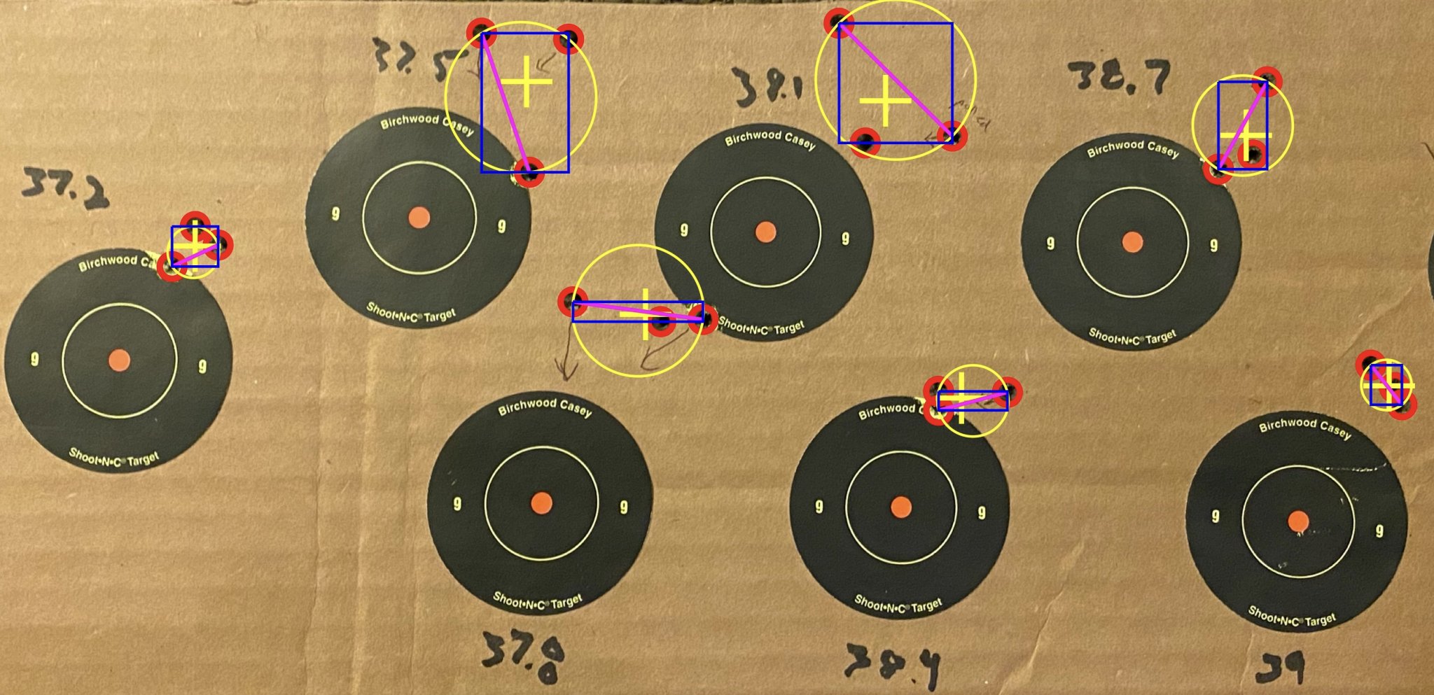

I may have missed it, did @Sogan find the best group shift node from his testing and now working on the speed stats?
Or are we assuming the OCW is about SD/ES or "flat spots"?
I haven't heard what the group centers were doing and I am wondering if the focus of the OCW test is misunderstood?

Re-shot it round robin style. Waited 5 mins between shots in 35 degree weather. Roughly the same SD/ES for each group (SD:15ish. ES:30ish).
38.7 and 39 have pretty similar POI. So I may load some more up between there to continue testing.

37.4-39 is my call. I would load 38.7 and see how it shoots.
Are you saying loads 37.4 and 39 or between those charges?
I'm suggesting the test came out ambiguous.
In theory, the purpose of this type of test is to observe the shifts in the centroid of the group pattern and that is done regardless of the group size or the velocity stats. However...
If the gun isn't grouping well at all, then there isn't much to see. If we try to plot the X-Y location of those yellow crosses that represent the group centers, we are looking at an OCW test. Large variations in group size do not make this an easy task. And... Velocities from low sample tests are not going to give you meaningful SD/ES stats.
Looking at 37.8 and 38.7 grains. You fucked something up.
Yes I did. 38.4-39 was what my finger were supposed to type. Load 38.7 and try that.
