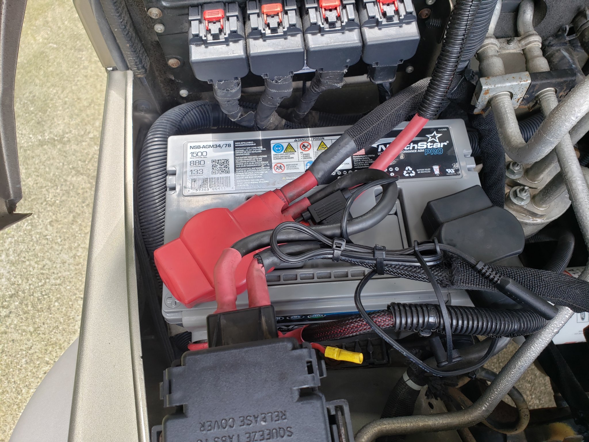

Deka or Odyssey are the batteries to go with.

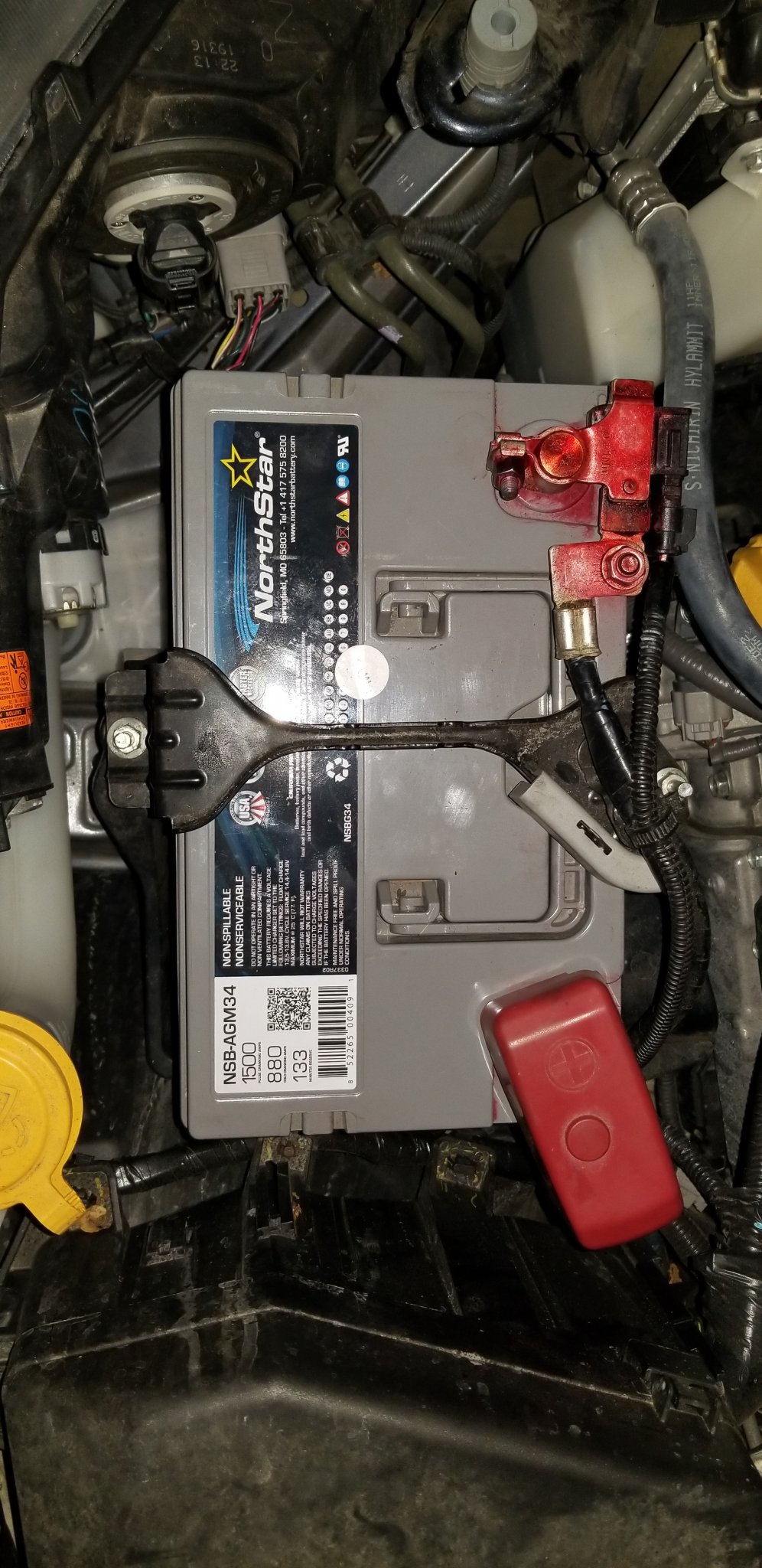

Dekia/Northstar
Good batteries are not cheap.
A top of the line Group 34 or 78 is going to cost you around $250.
My jobber rate is about $190
I proactively change them out at the 7 year mark and retire them to farm duty while being stuck on a battery tender as well.
I get about 5 more years out of them around the farm.
Not much more you can ask from a well maintained battery.
