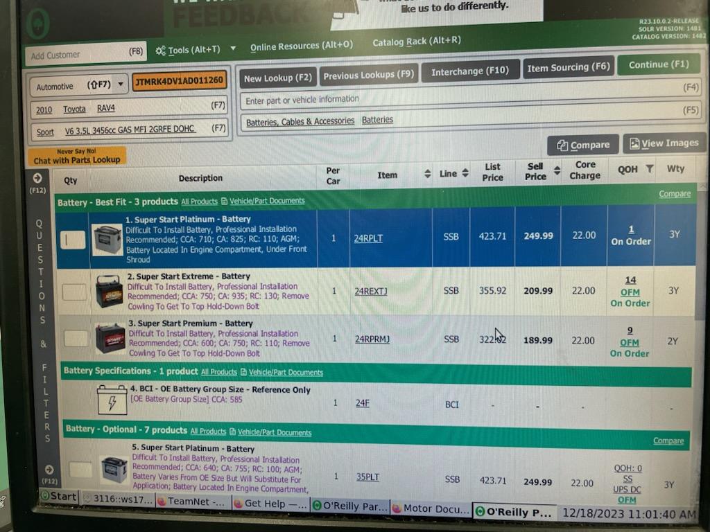

Wife's rav4 needed a new battery. Over 3 years from one of the chain auto parts stores. Didn't need AGM since it's a 2010. O'Reilly had these prices for a 24f.
