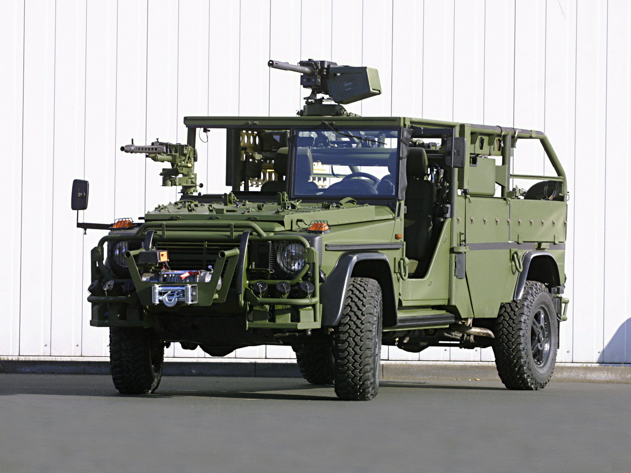

I like it. When you replace the engine, swap a G65 engine into itIts an 05. It now has 329,000 miles on it, and I beat the everlasting dick fuck out of it. Dick. Fuck. Alaska, MT, OR, Moab. Didn't give a shit and all all of that and came back for more.
It is about done with its pansie grocery getter life. I'm going to replace the engine since it has started smoking finally (dick fuck out of it), and probably cut the whole top off, remove the doors, put in a roll cage and a turret ring and a bulletproof windscreen and make it my desert rat type truck. Like this one:
