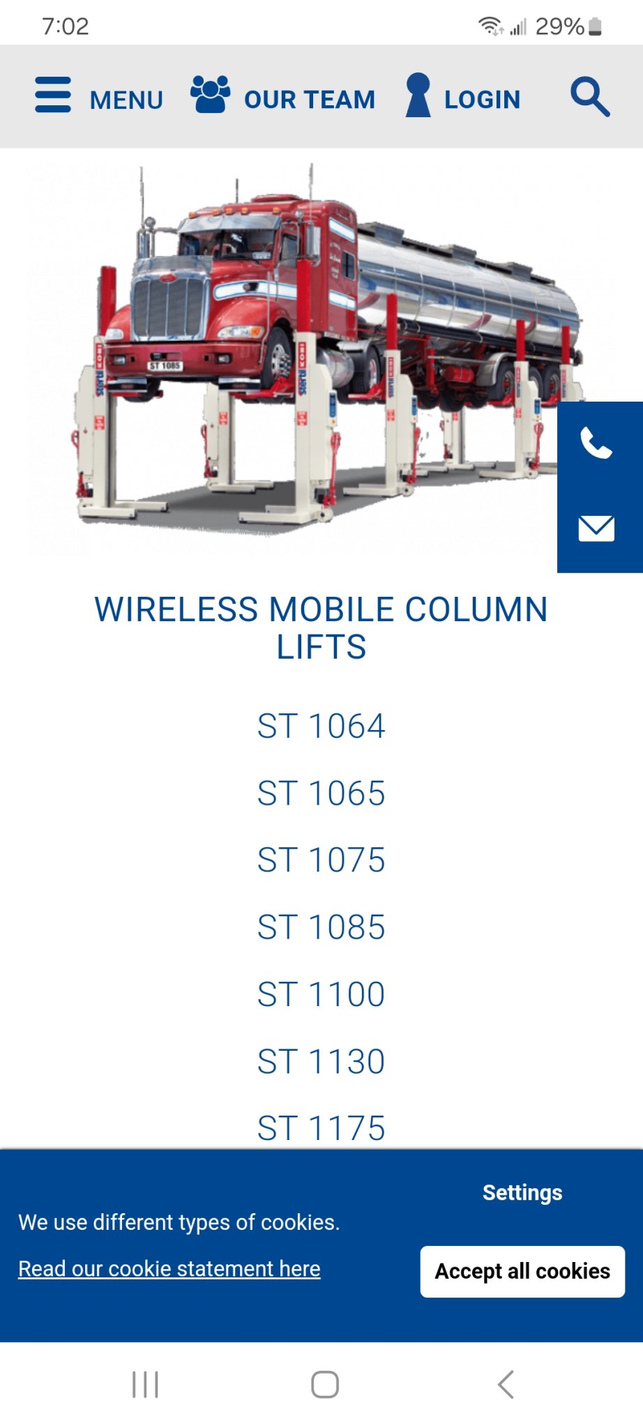

These are amazing for working on class 8 trucks. It's a shame most shops are too cheap to buy them. They are a big investment but they make it so much quicker and easier to shit like clutch and transmission jobs.
Reactions: gatorbait308
