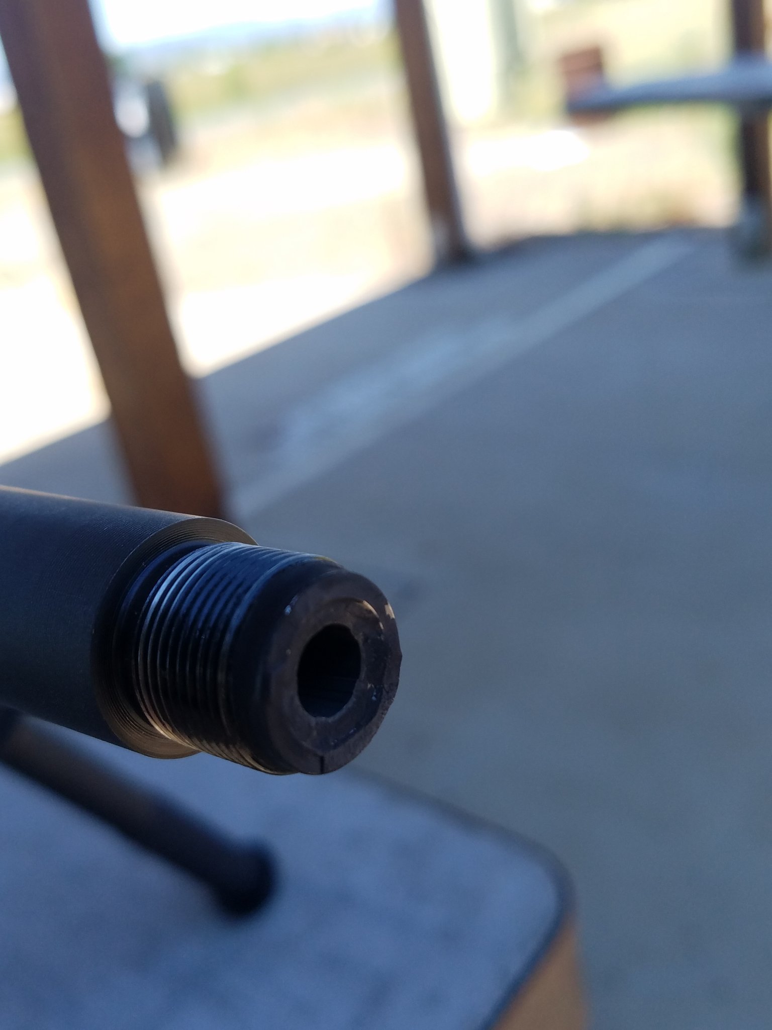

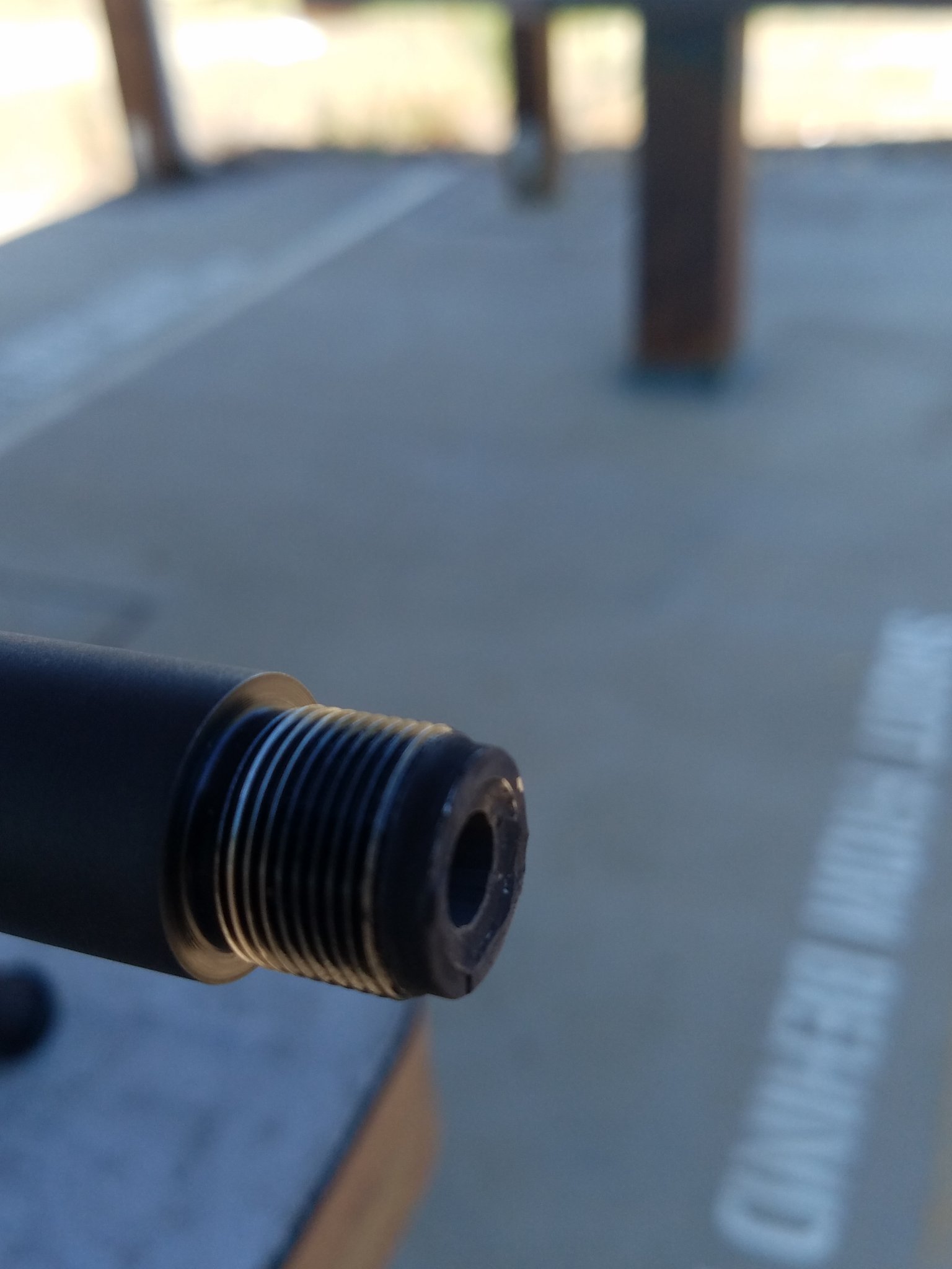

So the stock barrel on my rpr is getting up there on round count, and my accuracy is starting to open up. I used to be able to consistently shootin. 5-.75. Now I'm mostly shooting an inch to inch and a quarter @ 100 yards. I figured it was the barrel wearing so I tried seating my reloads longer and haven't really gotten accuracy to improve.
I then took my muzzle brake off and discovered pretty bad carbon build up. I had never cleaned the muzzle crown before (my first precision gun), so now I'm wondering if this carbon buildup could be the culprit of lose of accuracy.
Should I attempt to clean./scrape off the carbon buildup or. Will I do more harm than good? Here is a couple pics of the crown

That looks shitty. I would clean it if it were mine. I always take my breaks off and clean crown and break when I clean my rifles.
As mentioned above the CLR works wonders.
It’s amazing how much carbon can be on the crown and still shoot well.
That said I had a bunch of carbon on my last 260 barrel and suddenly it shot like crap.
The cause was a chunk of carbon broke off like a piece of pizza missing.
Carbon buildup on the crown and in the brake most definitely negatively effects accuracy. Clean that baby.
Also, 1800 rounds is probably getting close to max depending on how fast you run em.
I haven’t had a single one of my 6.5’s make it to 2000 rounds.

Are there any missing chunks or is the carbon a consistent thickness?
Have you checked for a carbon ring in front of the chamber?
You may get a few more rounds, but that's generally how barrels go. They will toss a random flyer, which you attribute to wind, mistake, etc. Then they flat out don't shoot.

Yes there are missing chunks and not consistent on the carbon at all....
And that's how my barrel is shooting, it will stack 3 rounds on top of each other then the other 2 rounds are like 2 inches off lol.

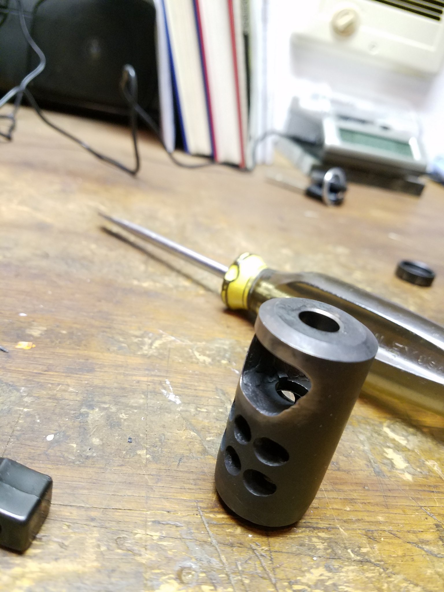

If you have that much carbon on the crown, you may also have enough build-up in the brake to cause "bullet strike". I remove my brake and inspect the it carefully to stay on top the carbon in the ports and then clean the crown every time I clean the rifle of powder fouling after every outing. We've seen shooters have pitting issues on the crown from not removing their brakes as the build-up wants to pull moisture from the air.
This ^^^^

This happens on my rifle as well. I don’t like to speak in absolutes, but carbon buildup is inevitable.
I spin the brake off when I clean, and soak the bore and entire crown, let it sit some, and clean. Stainless is very resistant to corrosion, but still it’s best to get that crud off the crown regularly. You can scrape the crud out of the brake with a bronze or similar alloy scraper, I use the tool on my Leatherman MUT for it.
It’s certainly surprising how much carbon crud can build up on the crown with a brake on, and crown concentricity is critical to repeatable accuracy.

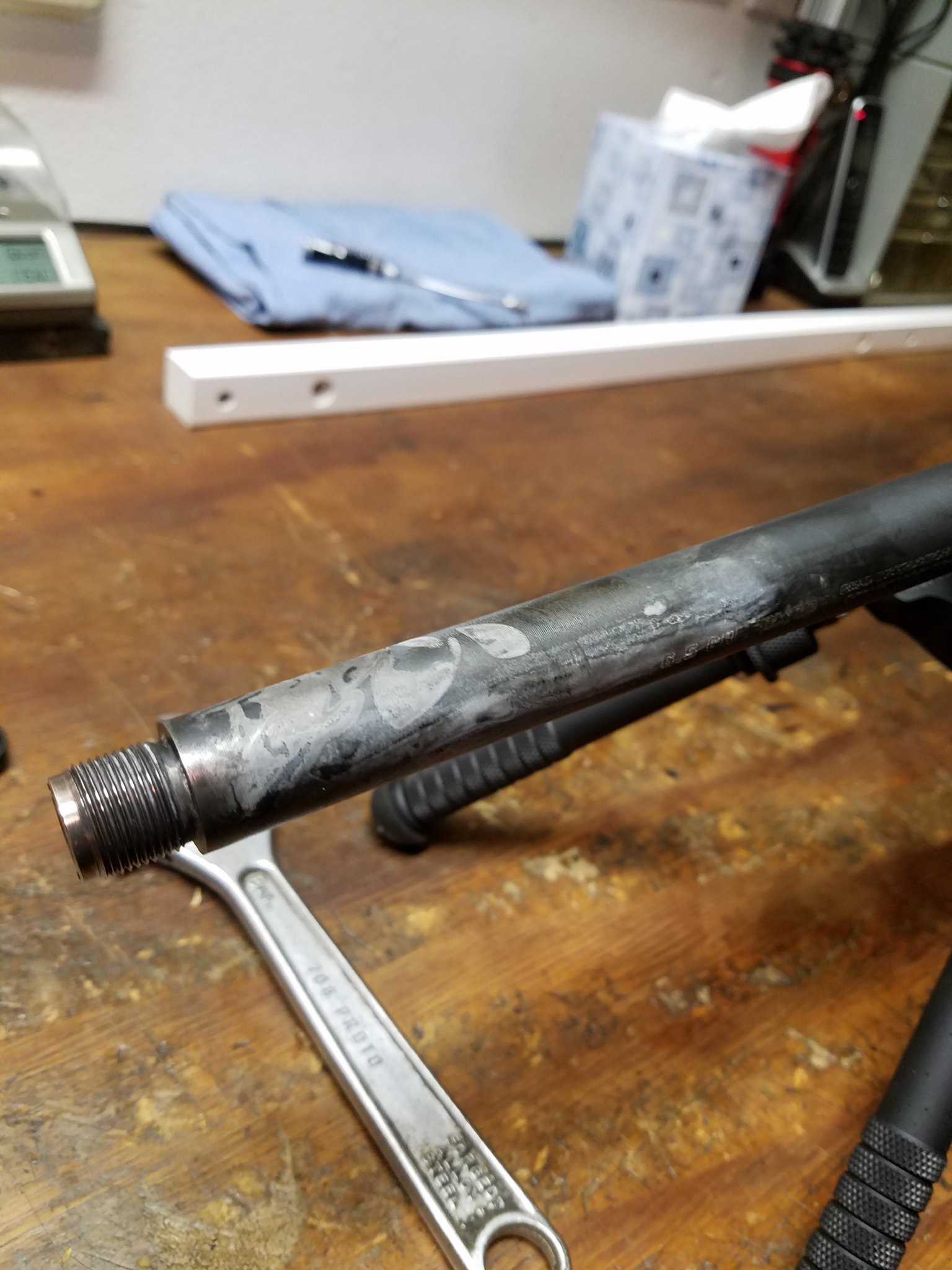

Well good news, the clr ate thru all the carbon buildup I had on crown and muzzle brake.
Pro-tip
Don't be a dumbass like me.
Realize clr is an acid not a gun solvent.
It will eat thru whatever it touches.

Ummm...when using CLR, a 50/50 mix (of water and CLR) is generally considered the max concentration you want to go. Even then, it will cause a minor discoloring if left too long in it. 15 mins max time is my rule of thumb.
Something I wish I would have known lol I used full concentration no dilute. Let is soak for like 45 min
I came back in the garage... And I'm pretty sure my exact words were.... "well........ Fuck..."
Ha! Mine too only thank goodness I was only soaking the muzzle brakes only I let it sit for a couple hours. Ate the black nitride finish right off it
Should still work just fine though, it’s only ugly.
