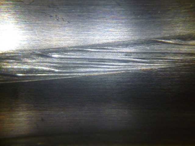

If you use an abrasive cleaner and a brush....guaranteed bore damage! The picture below is from a shooter using an abrasive cleaner and used it with a brush. 7mm barrel. Should measure .277" x .284" and it now measures .279" x .2845". Only 800 rounds fired on it chambered in 284win. At 100 rounds he started having accuracy issues. You use an abrasive with a brush....guaranteed bore damage.
I also don't recommend chucking up a old cleaning rod in a drill! Seen that procedure wreck plenty of barrels as well!
