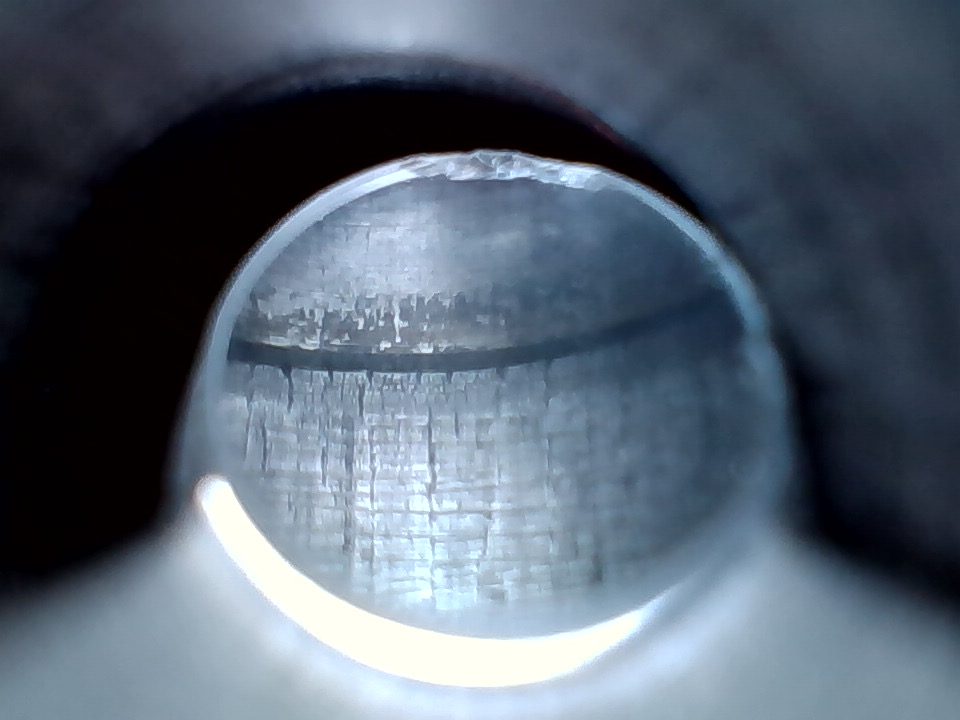

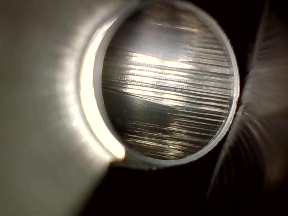

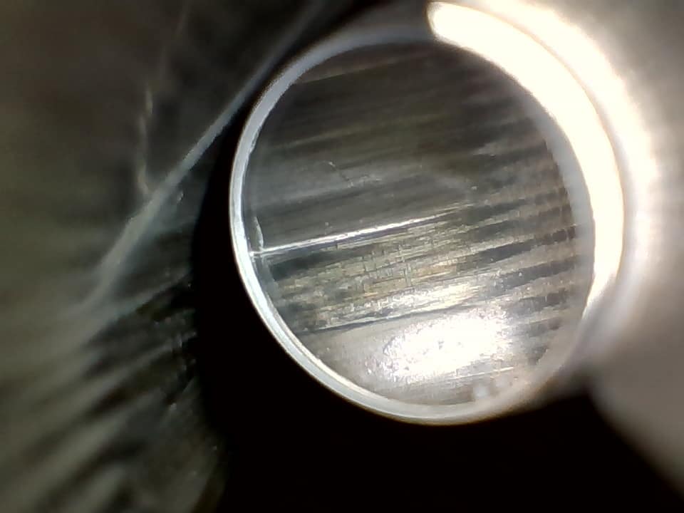

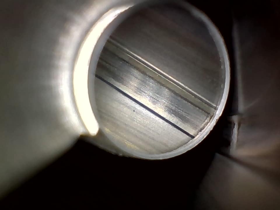

I don't like an abrasive cleaner. I'll only use Rem. 40x cleaner or JB Borecompound not the Borebrite.

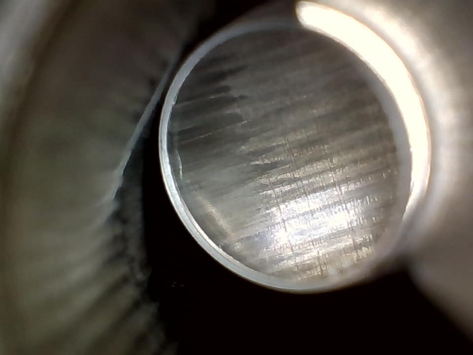

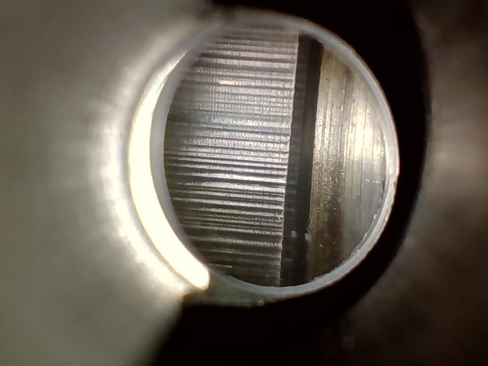

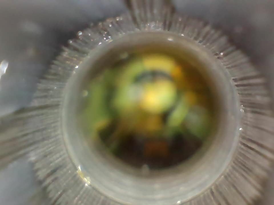

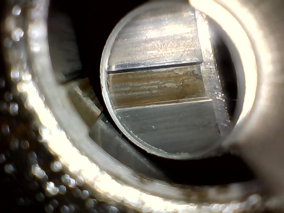

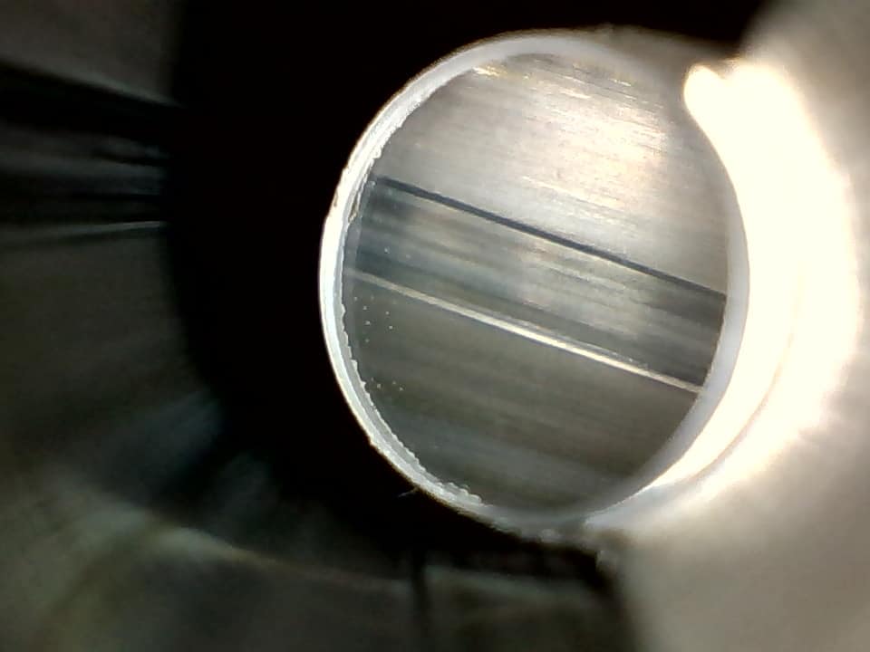

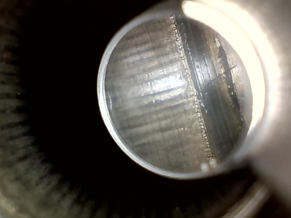

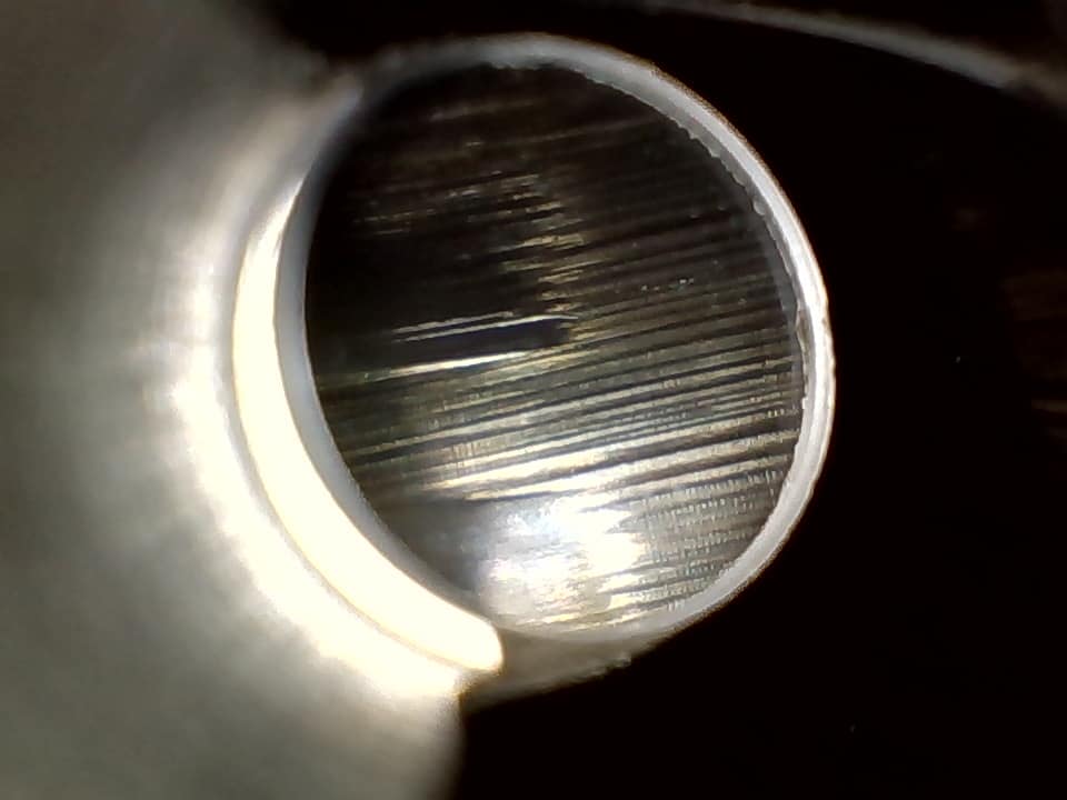

If you use an abrasive cleaner and a brush....guaranteed bore damage! The picture below is from a shooter using an abrasive cleaner and used it with a brush. 7mm barrel. Should measure .277" x .284" and it now measures .279" x .2845". Only 800 rounds fired on it chambered in 284win. At 100 rounds he started having accuracy issues. You use an abrasive with a brush....guaranteed bore damage.
I also don't recommend chucking up a old cleaning rod in a drill! Seen that procedure wreck plenty of barrels as well!
Later, Frank
Bartlein Barrels

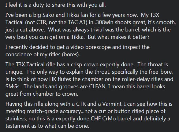

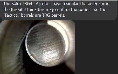

I found this on another forum.....Sako TRG42 and Tikka T3x Tact
Maybe it's a thing... I've never seen anything like it before.
It looks like someone took a can of bore paste and threw sand in it then went to town with a super coarse stainless brush.
This is his quote
I have a HK P7M8 they have fluted chambers in them and the brass comes out with these funny looking stripes all the way around it.
I've seen the HK fluted chambers and understand how they work and effect brass.
If you look at the first picture you'll see that these grooves don't even make contact with the brass.
They start at the leade and go forward and get into the lands and grooves then stop.
I've just never seen it before and was wanting one of the barrel makers to explain if this was something
that's done to improve function or a total cleaning fubar.....
This is his quote
Yep that's what can happen!
Using a brush in conjunction with an abrasive cleaner....is the cause of things like this.
Later, Frank
Bartlein Barrels
Reactions: JGR1953

He's says the guns come from the factory like this.
I've looked and can't find anything from Tikka or Sako stating they machine barrels like this.
First he says his Tikka Tact and then his TRG42 has the same grooves cut.
Not saying it's not possible...maybe something was done wrong at the factory but....we can throw Murphy's law into this and say anything is possible but.....
I've never seen a Sako type barrel ever look like that. I have two TRG42's in my office in 338 Lapua and they don't look anything like that. Also have a late 60's early 70's Sako barrel in 243win and it doesn't look like that at home. Again all the Sako/Tikka barrels that I've ever looked down...never seen that.
Later, Frank
Reactions: JGR1953
I'd like to see some pictures of those Tikka barrels a little further up the bore. If it is only in the throat area of the chamber....then my guess would be a chambering issue happened.
Here are more pics of the Tikka T3x Tact .308
And these are all the pics of the Sako TRG42
So on the first pic's further up the bore....you don't have any of those grooves/chatter lines like you see in the throat it looks like.
If that is the case....then it has nothing to do with how the barrel got rifled when it was made or damage from cleaning per say.
If it's just in the throat area....check the rest of the chamber. If the case neck/body area of the chamber has similar marks even if they appear lighter/fainter/not as abrupt....then I have to say something happened during the chambering of the barrel/machine work wise.
With out it in front of me to look at....my guess is some form of chatter from the tooling.
Later, Frank
Reactions: mudpig and JGR1953

Well started to do some testing....
One barrel has the bore coated (brand new barrel) as well as we have a couple of cut off pieces soaking in the stuff. Will see what happens on a long term test with that.
I poured some down two dirty used barrels. One is a 220 Swift in chrome moly steel and the other on is in 308w that we did all the work and install on for the local Sheriff's dept. rifles and that one is s.s. and approx. 6k rounds on it.
I had the used barrels tilted on a angle into the solven tank so the stuff could run down towards the muzzle but I didn't dry patch the bores. Just poured the CLR down them and nothing else.
The chrome moly barrel in 220 Swfit.....NOT GOOD! Just from sitting overnight where the liquid built up at the muzzles crown end....it pitted/etched the bore! Also any place the liquid sat wet.....(I didn't wipe anything off) it STRIPPED the blued finish off of the barrel!
The stainless 308 barrel I want to say there is a hint of pitting right at the crown edge but it might just be build up that needs to be patched out some more. Still playing with it.
I will say it did in aid in softening the carbon and makes it easier to get out but.....it did not remove it completely. Also it did nothing to the copper fouling in the bore in either barrel.
I also found out from Dave in the shop....he used it to clean a suppressor(s) with it and it will attack the cerakote finish....it started to change the finish on some nitrided parts as well. He said it did nothing in terms of pitting on some titanium metal.
So right now I have to say...you use it....be very careful with what you use it on and how long you use it etc...
Will keep playing with it but as of right now....I cannot recommend it for cleaning barrels. I still need to see more data/long term tests done with it.

I ususally only clean every 100 rounds unless I'm going to let the rifle sit a while. I use CLR as the very first step in my cleaning process just to scrub the throat and then run it down the barrel a few time to loosen everything up using a combination of the aggressive pellets and patches, I never use a drill! I follow with Patchout Wipeout, brushing, another round of Patchout wipe out and then dry patches. Check with borescope and repeat if carbon still exist. Only on one barrel using this regiment have I ever had to go back for a second round.
My point is I never leave CLR in my bore for more than 10 to 15 mins. and I don't neglect cleaning on a regular basis.
I think some of the issues outlined in this thread are caused by leaving CLR for extended periods of time like cleaning Ti suppressors.
Until I see my accuracy fall off or some other issue I will continue with my cleaning process and will include CLR as it does a fantastic job on carbon rings.
