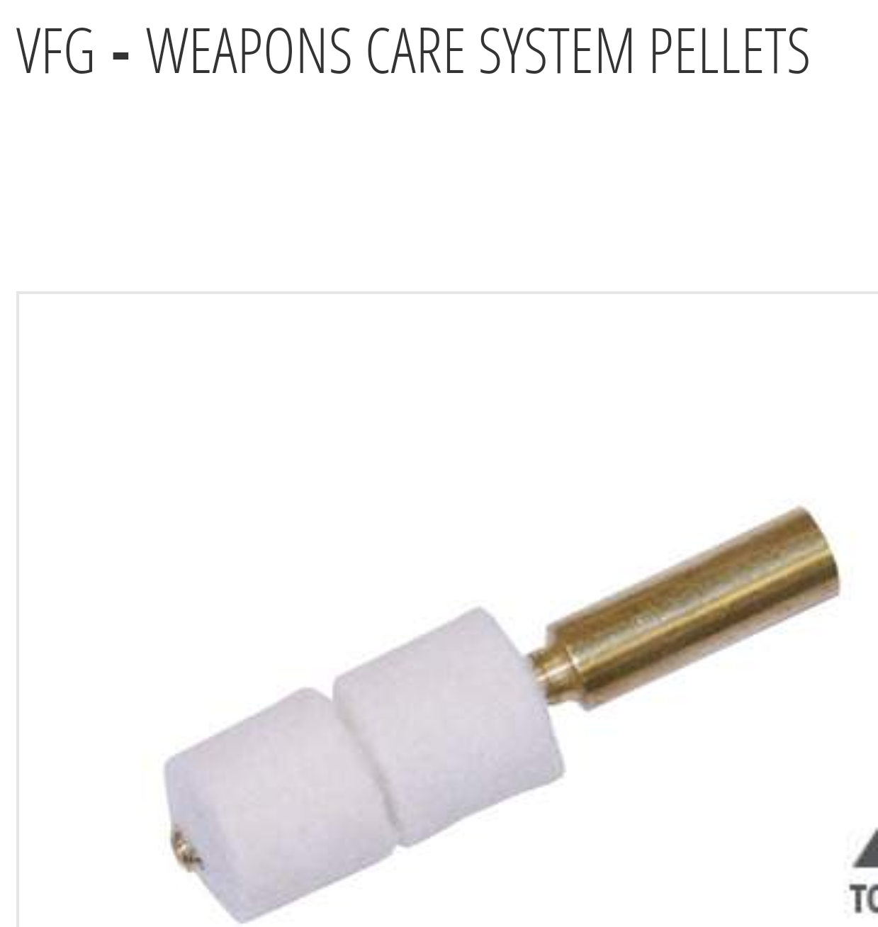

    https://www.brownells.com/gun-clean...ts/weapons-care-system-pellets-prod13839.aspx
    I found this system to be the fastest way to remove a carbon ring. That sure sounds like what you are experiencing.

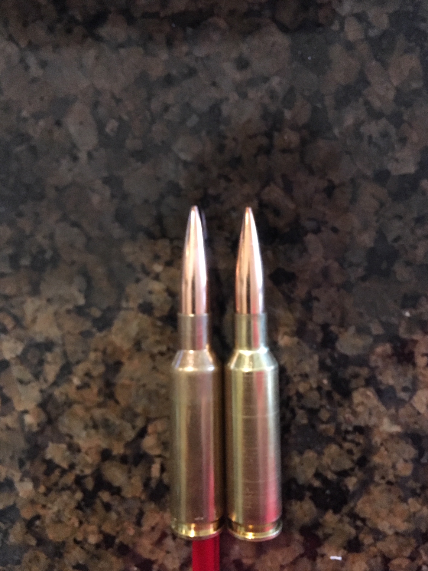

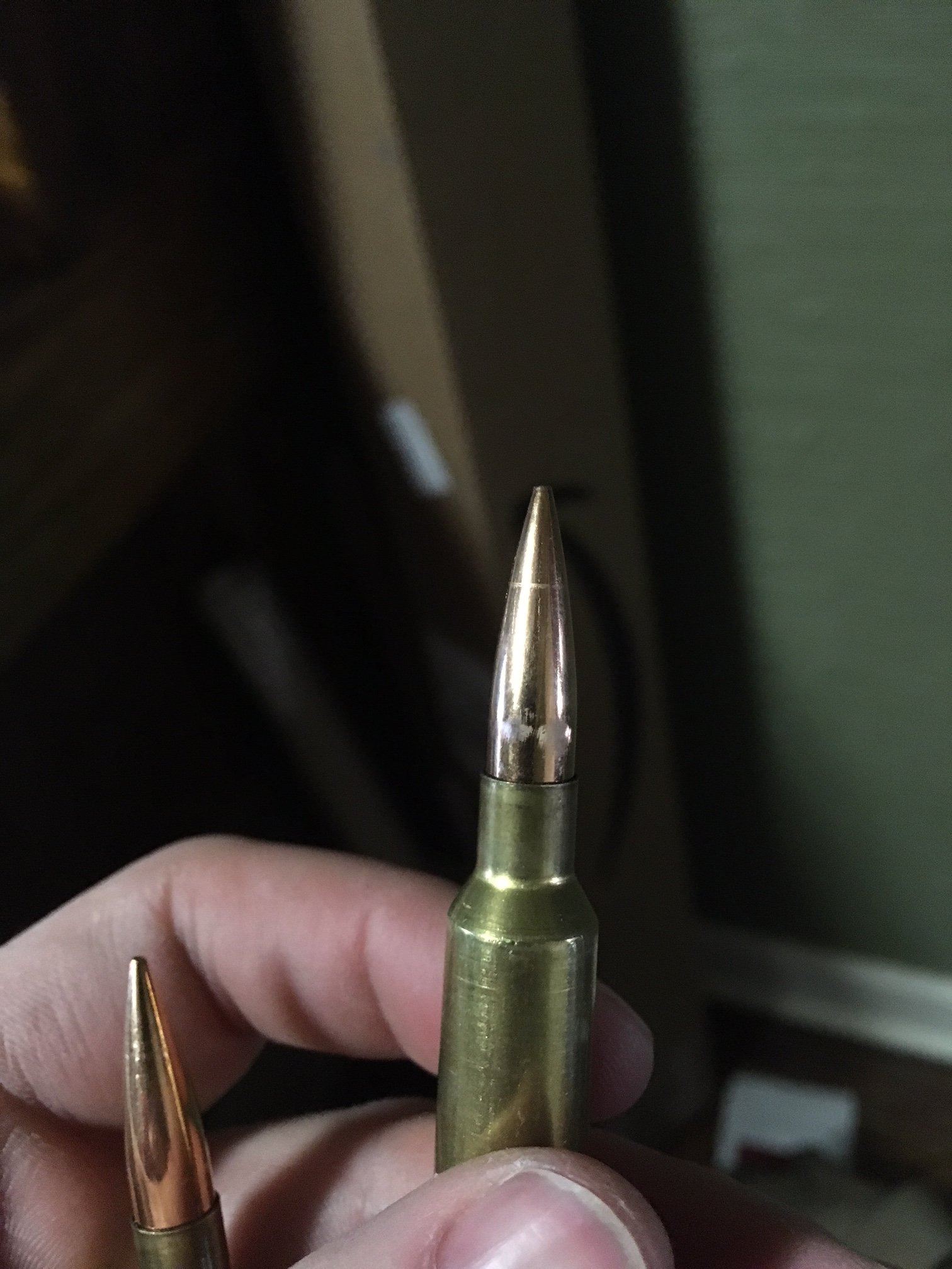

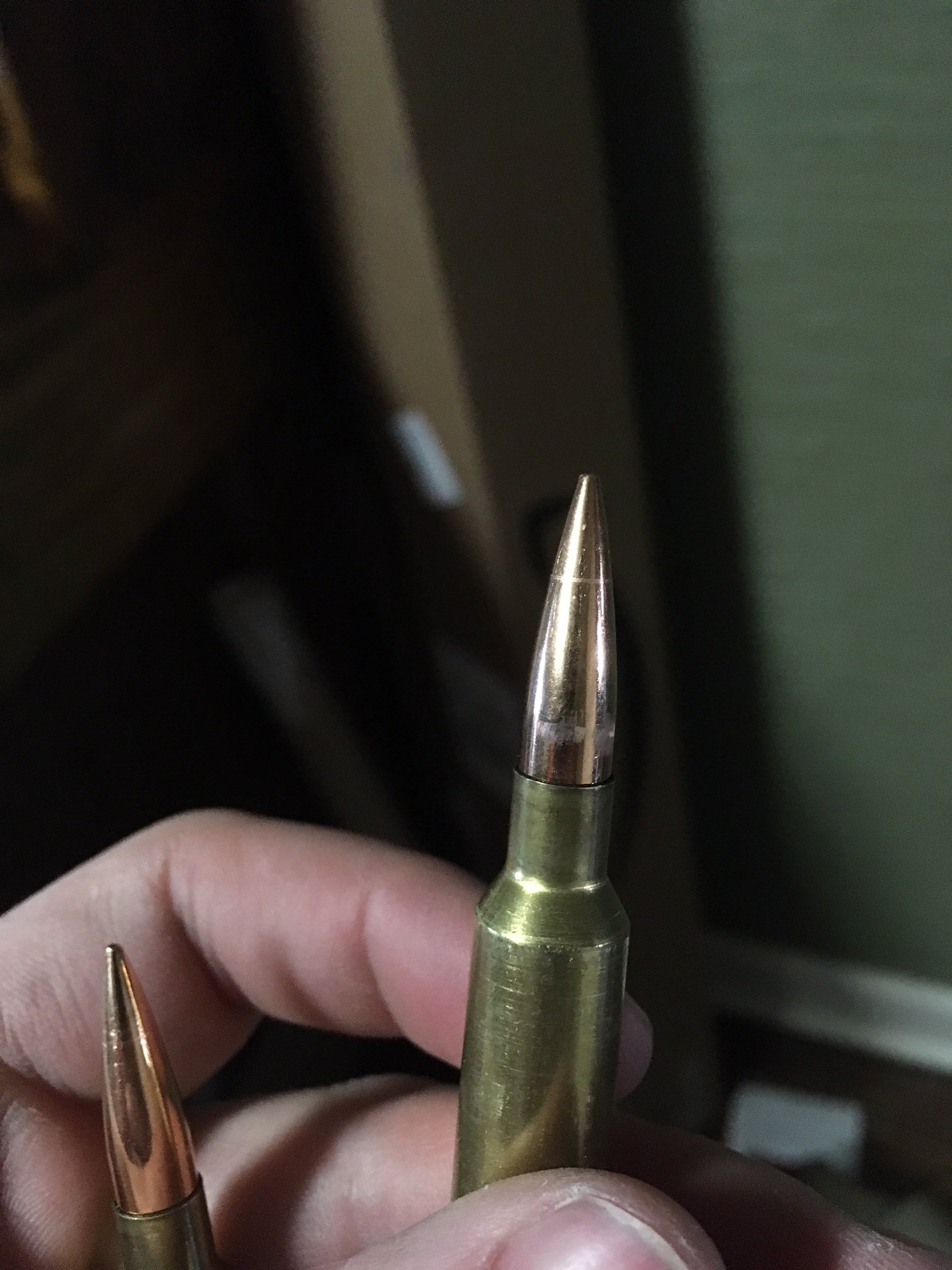

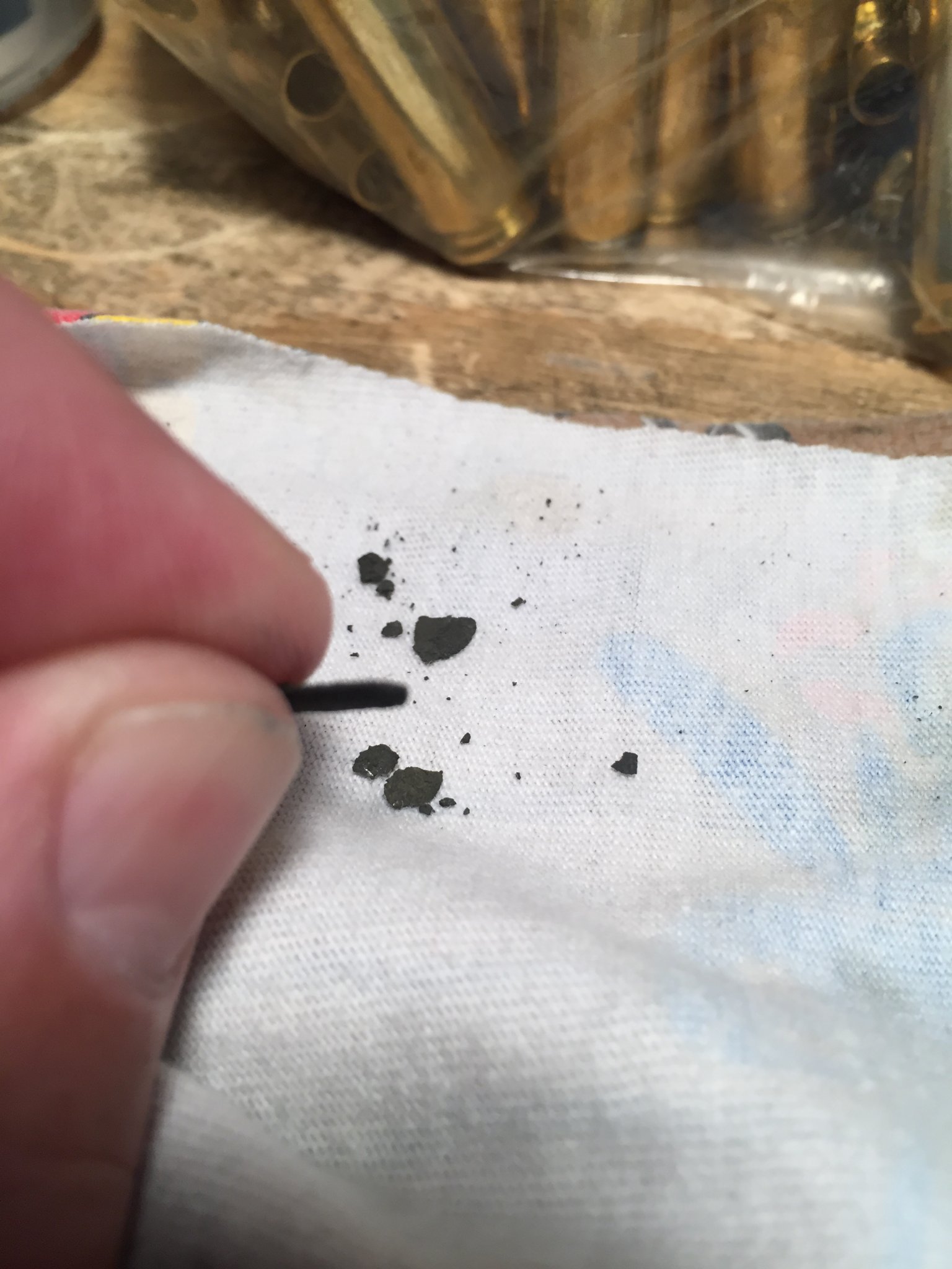

    About 20-30rds in ran into the carbon ring again. Finally got some pics to show. Going to get some CLR tomorrow and get rid of it once for and for all.

    are you measuring to the Ogive with a tool or just loading OAL so you can fit the mag? Did you recently change lots of bullets? That looks to me like you are deep into the lands. If not, You're throat is caked.
    If you're not loaded too long and it came back in 30 rounds, stop the horse shit and go get some JB bore paste, a nylon 6.5mm brush and a nylon 6mm brush, black hard type. Use the 6mm wrapped in a patch, coat it with JB and make 7 or 8 passes throat to crown (no exit) New patch, with more JB and short stroke the fuck out of it. Patch must have a tight fit in the bore and ensure the brush isn't unscrewing. You will feel the difference between an area that is carbon free and one that has deposits. Work the rough area until it feels like the smooth parts down the bore. Then, 20-30 passes with the 6.5mm brush and flush with Hoppes, etc. Once flushed, repeat the 6mm with JB patch. If it feels fine, flush out, wipe and you're done. If not, repeat until its smooth . Don't worry about the black on the patch, it's normal.
    Yes, you can over do this and make the barrel a little harder to clean but right now you have a tomato stake, so you have nothing to lose. The 6.5x284s get this every 250-300 rounds. Flitz works too.

    The only way to be 100% certain is with a bore scope but since you dont have that we cant say. But I wouldnt have expected one patch to come out dirty and the next to not have any soot at all what so ever on it...
    You said you let it sit with CLR soaking it for 20 minuets, did you spin the brass brush in the throat by chance? While I think the CLR would work I would fully expect to have to do some manual scrubbing/mechanical action to it and not just chemical to get rid of that hard carbon deposit.

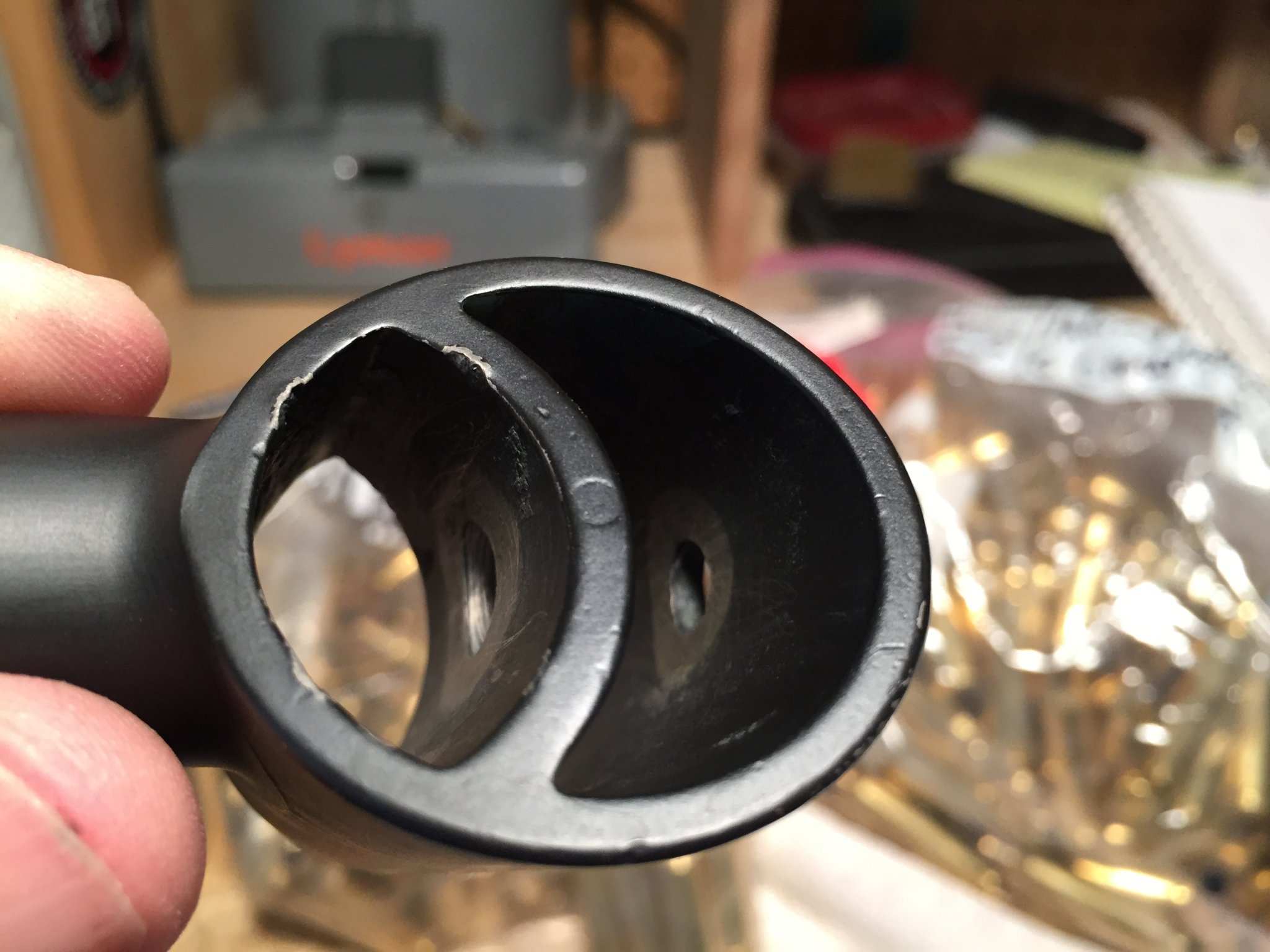

    Will I wish I had took a before picture of this brake but I honestly did not think the slip 2000 would work....long story short...this brake had about an 1/8” of carbon build up I put it in the slip 2000 for about 12 hours took it out and most of the carbon was gone what was left I touched with a screw driver and it fell off....this was last weekend and the slip 2000 is probably 3+ years old.

    The slip 2000 carbon killer is what I run on my VFG pellets. That is great stuff! spife is correct. Without a borescope, you're going to have to scrub until your patch runs clean.
    with the slip(if it were me)id plug the muzzle fill the barrel and let it sit for 24 hours then scrub it...a buddy of mine had a carbon ring and it was causing bad pressure spikes...after trying to clean it out he ended up having the barrel set back.

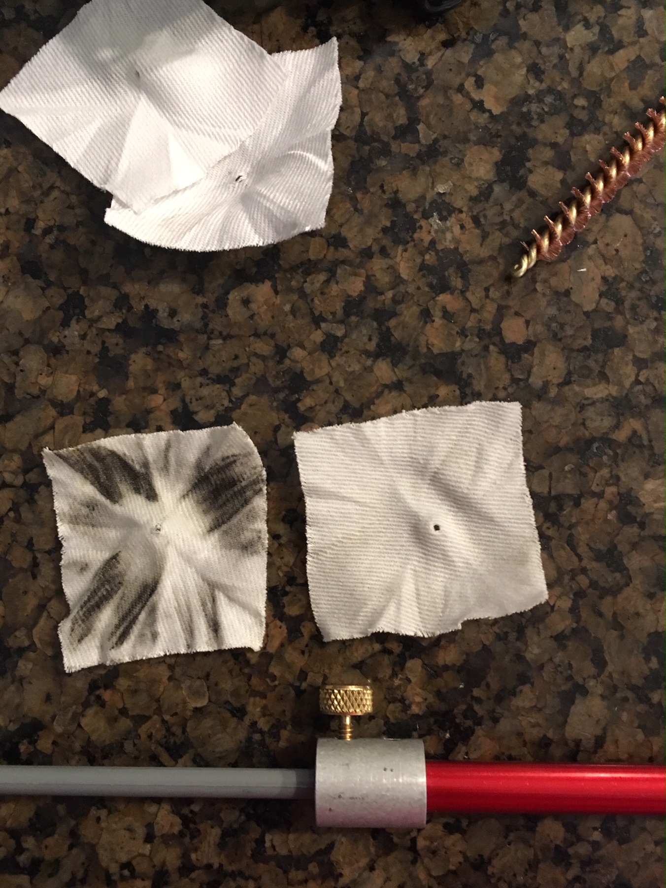

    That patch on the left was one of the first run. The one on the right was like 10-12 later. I went back and did it again for another 20 minutes with soaked .27 cal patches and the brush. Then dried it. Patches were absolutely spotless. So about an hour of cleaning. Shot 30-40rds no issue. Just measured the lands. Still 3.104. Going to load up some more varget tonight and see how it goes tomorrow.

    @5RWill after scrubbing like that with CLR, I see no way possible you could have any carbon left in the throat. I bet it's shiny bright metal in there. ... but you really should invest in a lyman digital bore scope. Cheap and easy way to see what's going on in there.
