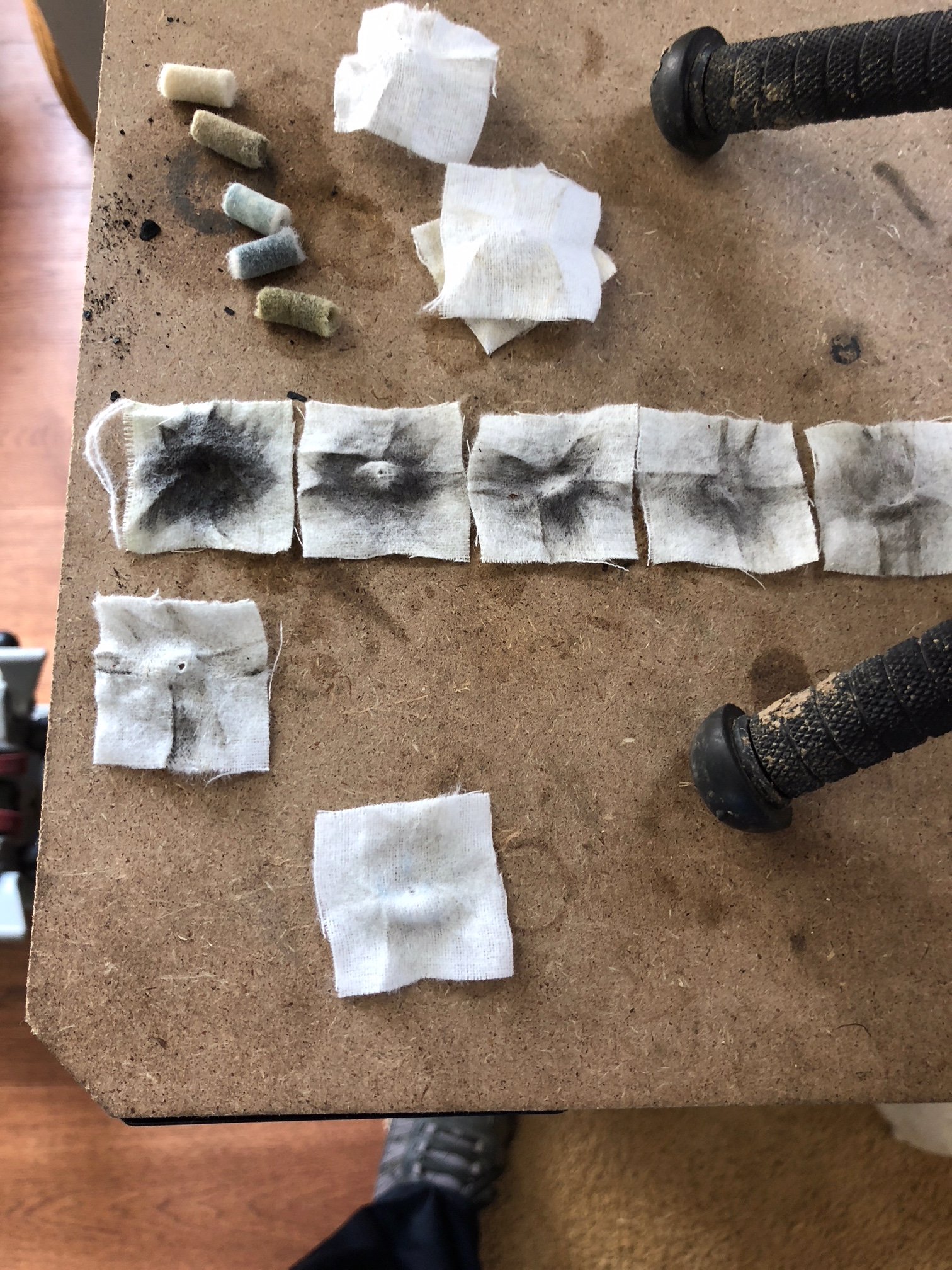

I guess it was still there i had no means of checking it. It must've been pretty bad, truthfully was probably 500rds suppressed with maybe a run of hoppes through it at one point. I a friend of mine have it since i had to go back to Jackson, he's here, and i don't have all my rods and stuff here. The match is this weekend, he cleaned it with the pellets and then took it to David's to use the bore scope to check.
Here's the pics he sent me. This was the first patch i guess after scrubbing.

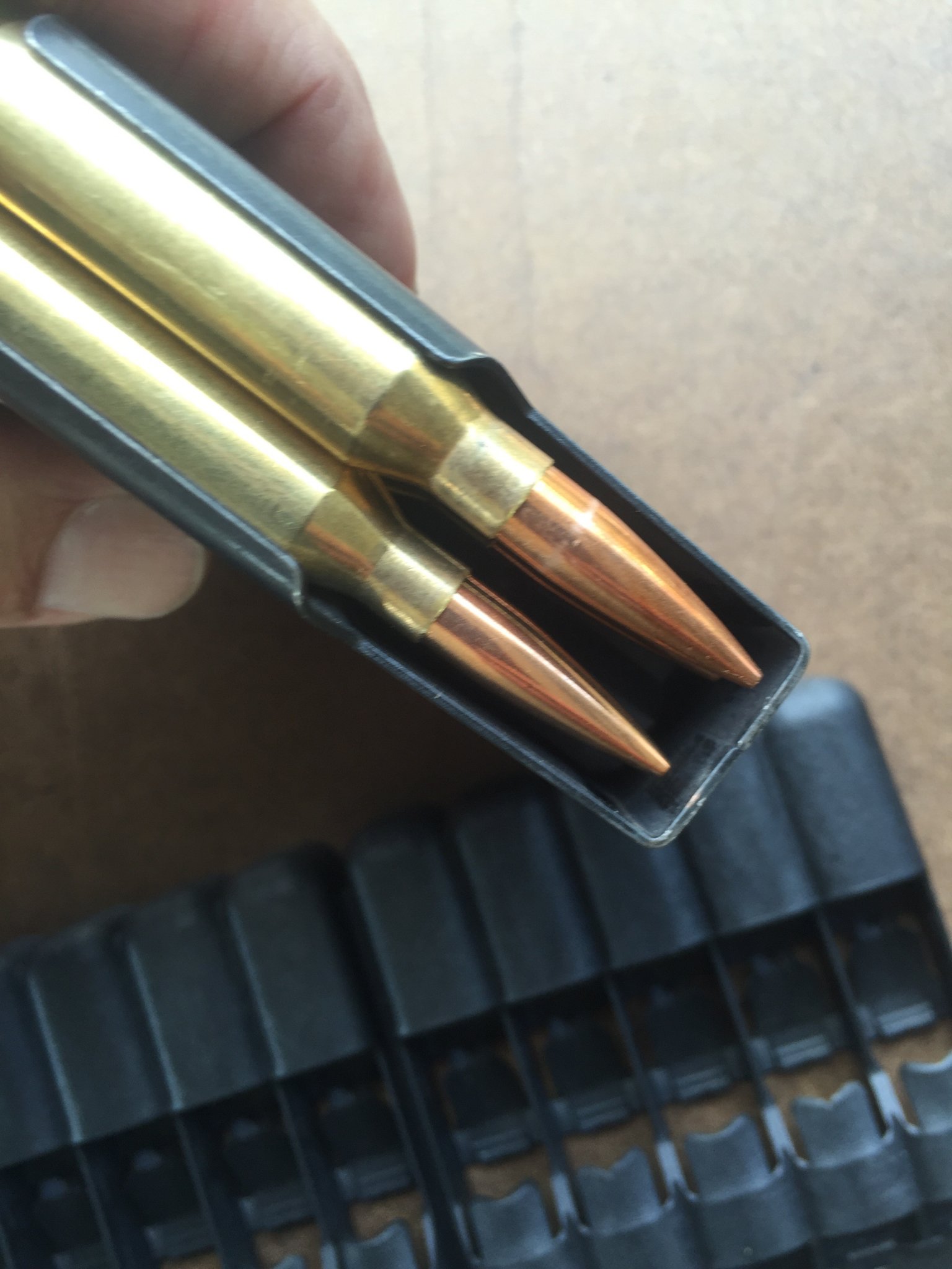

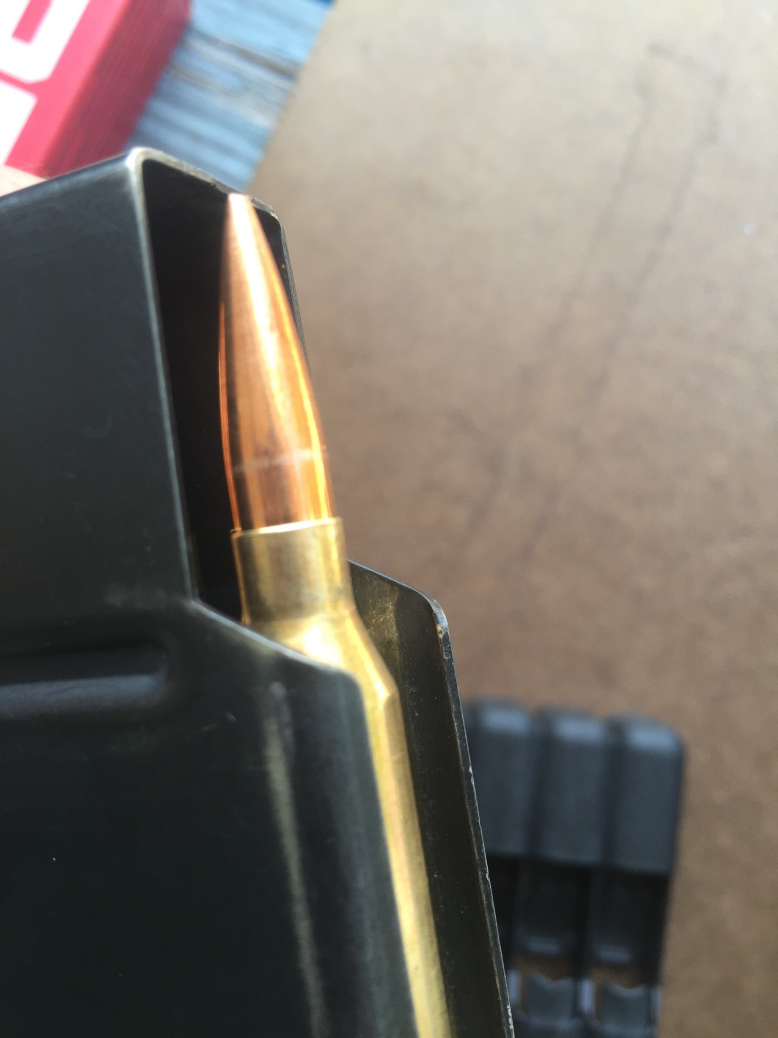

I mic both my bullets and my base to ogive as I prep and load. Maybe the lands moved closer to the chamber...:cool:
Just so that you are aware, I spent quite a bit of time working to remove the carbon that actually existed, using a combination of many of the magic solutions suggested. Surprise, surprise, none of them worked as easily for me as perhaps expected. The carbon is now gone, I no longer have the indicator ring showing on a loaded round, and the pressure signs are gone.
Same batch of loaded rounds used.
Were you able to chamber the rd? Sometimes just having a couple bullets seated deeper in the case will blow what you have out. It's leaving a ring on your bullet for sure, if you were to borescope it, would it look like a ring, or just the start of build up.
I have a hawkeye scope, I've never actually seen a ring in the throat.
Yes, that round in the picture and others like it were fully chambered and then removed. Maybe what occurred isn't called a ring, but I surely creates a ring shaped mark on the bullet where it is constricting the bullet. So perhaps it's a matter of semantics, but this was most certainly a "ring" of carbon in the throat. The picture is of pretty good resolution, so it's easy to see that this is not markings from the lands (unless, as above, I'm experiencing the previously unknown advancing of the lands).:cool:
You're right, definitely in the freebore area behind the rifling, the lands would contact the bullet on the slope of it's nose. Could be in the transition area I spoke of and carried forward. As you said in a post, it was not easy to clean and I bet not, lol
