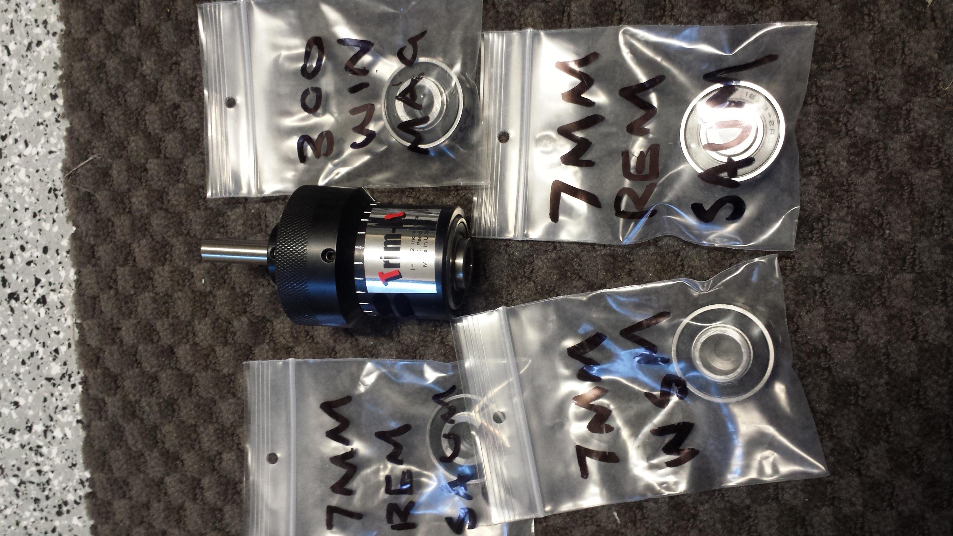

Tried turning some Norma 7 saum brass. I'm not new to turning brass but I've never necked down using bushing dies before. The cuts seem to be uneven on the shoulders. I can turn the entire neck but the shoulder ends up being cut deeper in some spots than others. Here's an example of one piece:
No expert here by any means. I didn't turn that far into my shoulders, but did see some unevenness on my brass. After shooting them the first time it all seems to even out when fire formed. Run-out was much better as were the group sizes during my second firing as well. FYI.

when i I turn my necks one side of the brass gets down to just the bottom of the neck, while the other starts cutting into and into the shoulder.. If I were to even it out it would be cutting way down into the shoulder....just curious if anyone else was seeing this.
im guessing it's because of the high runout from necking down... I get anywhere from .004"-.020" of TIR on my concentricity guage on the necks after necking down 7 saum brass with the .295" bushing...
