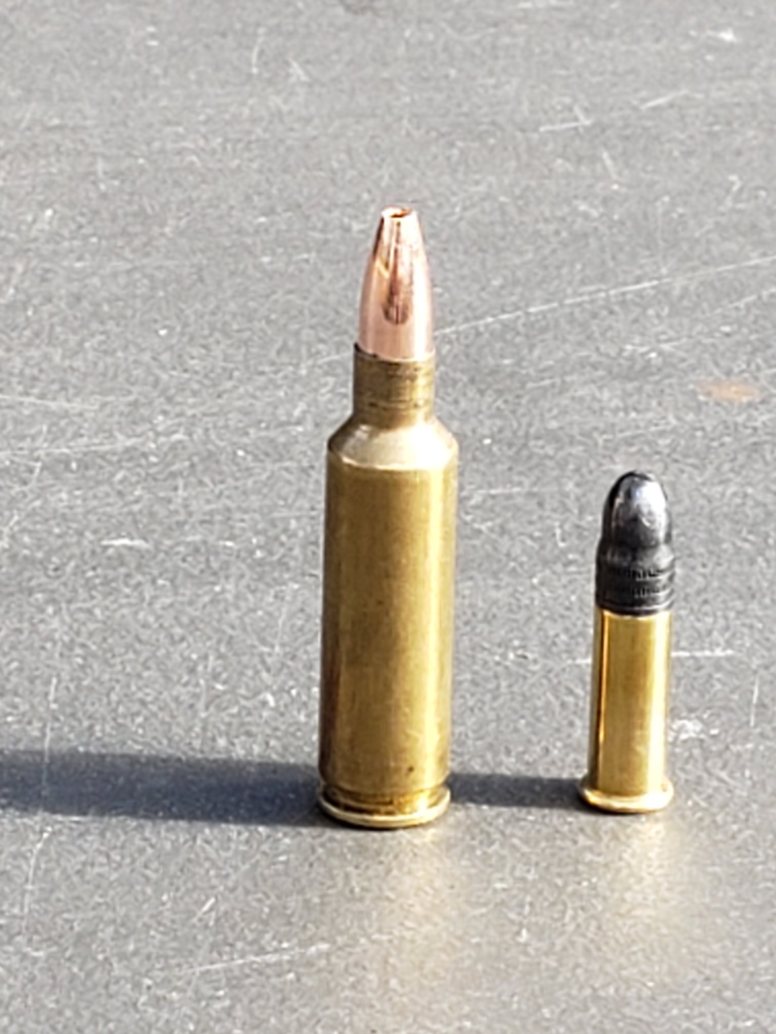

    .20 Vartarg
    As much as I love my 20VT AI it's too easy to hit steel inside 400Y, that is if the wind is normal, and when windy then there's some challenge.
    You know this and I keep mentioning it but;
    The barrel doesn't heat up so fast so you can fire a lot of rounds, within reason.
    The barrel life is long,
    The recoil, or muzzle upset, is slight.
    Not very loud either.
    Cheap components, I use 32gr Vmax, 19gr of 300 BLK at 3760 fps, and a lifetime supply of semi formed once fired 5.56 LC brass I bought from a guy surprisingly cheap.
    I have the reamer so I'm GTG for the next barrel 'if' I make it that far,
    Mine seriously reminds me of a 6mm PPC in precision capability.
    I sold off most of my other varmint cartridges because it's that good.
    In the photo is Nosler 32gr hollow point and reduced load going 2300 fps.

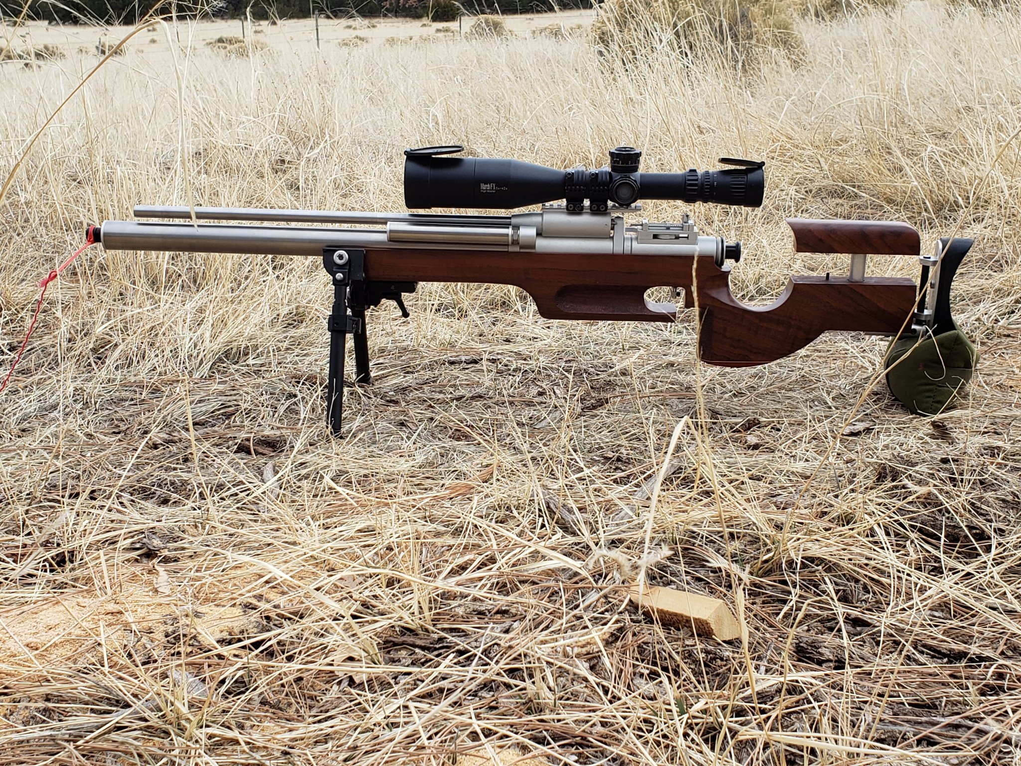

    Okay I'm weird but I use pcp air rifles mostly for mid range plinking. I swage slugs for the wood stocked Thomas HPX in the photo. A 160 dollar, 25lb, spool of lead wire makes 4400 42 slugs with a G1 BC of .142. Each slug is exactly like the one before or the one after and the SD is 2 or so.

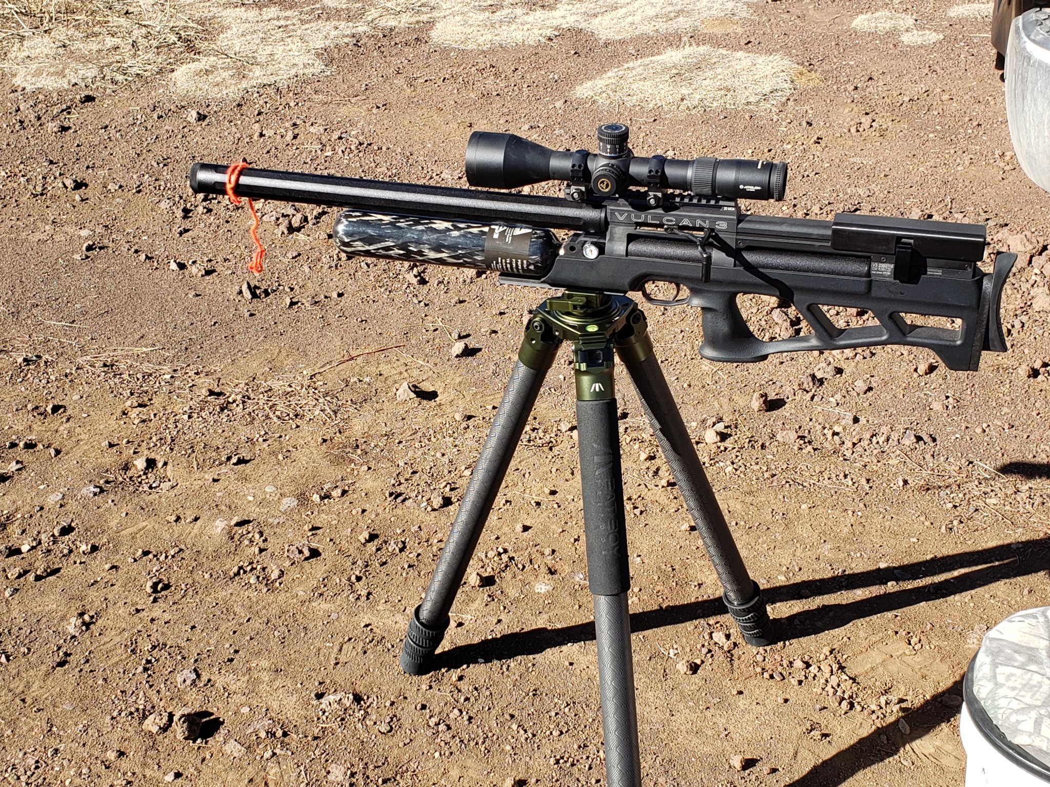

    I also have a Vulcan 3 25 caliber pcp that I use Altaros 60gr slugs in, which is basically a lead bullet, that has a G1 .245 BC. Just yesterday in fact hitting steel out to 300Y no problem in medium winds.

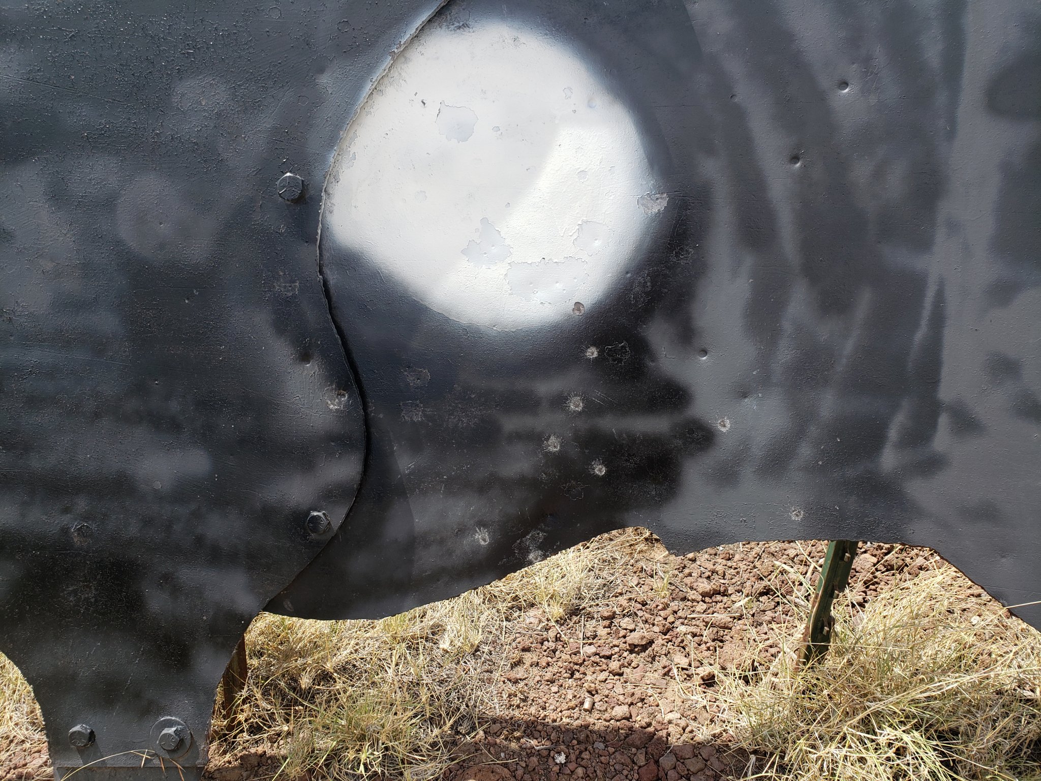

    The other photo is at 421Y with the V3 and holding off 3 mils for wind. I couldn't see where I was hitting, only hearing the smack of steel. Approx 9" of vertical.
    If you want challenge then these provide it.
    If you get the appropriate compressor the air is then almost free. I bought a decent one so GTG for the rest of my life.

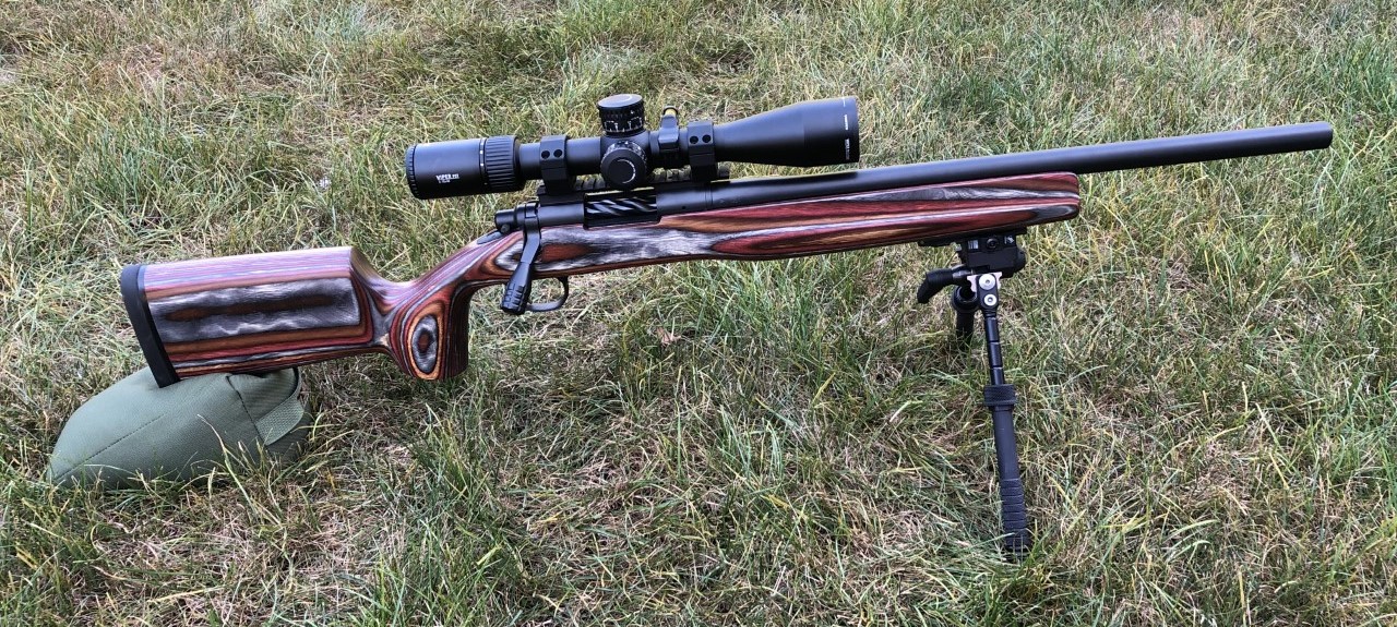

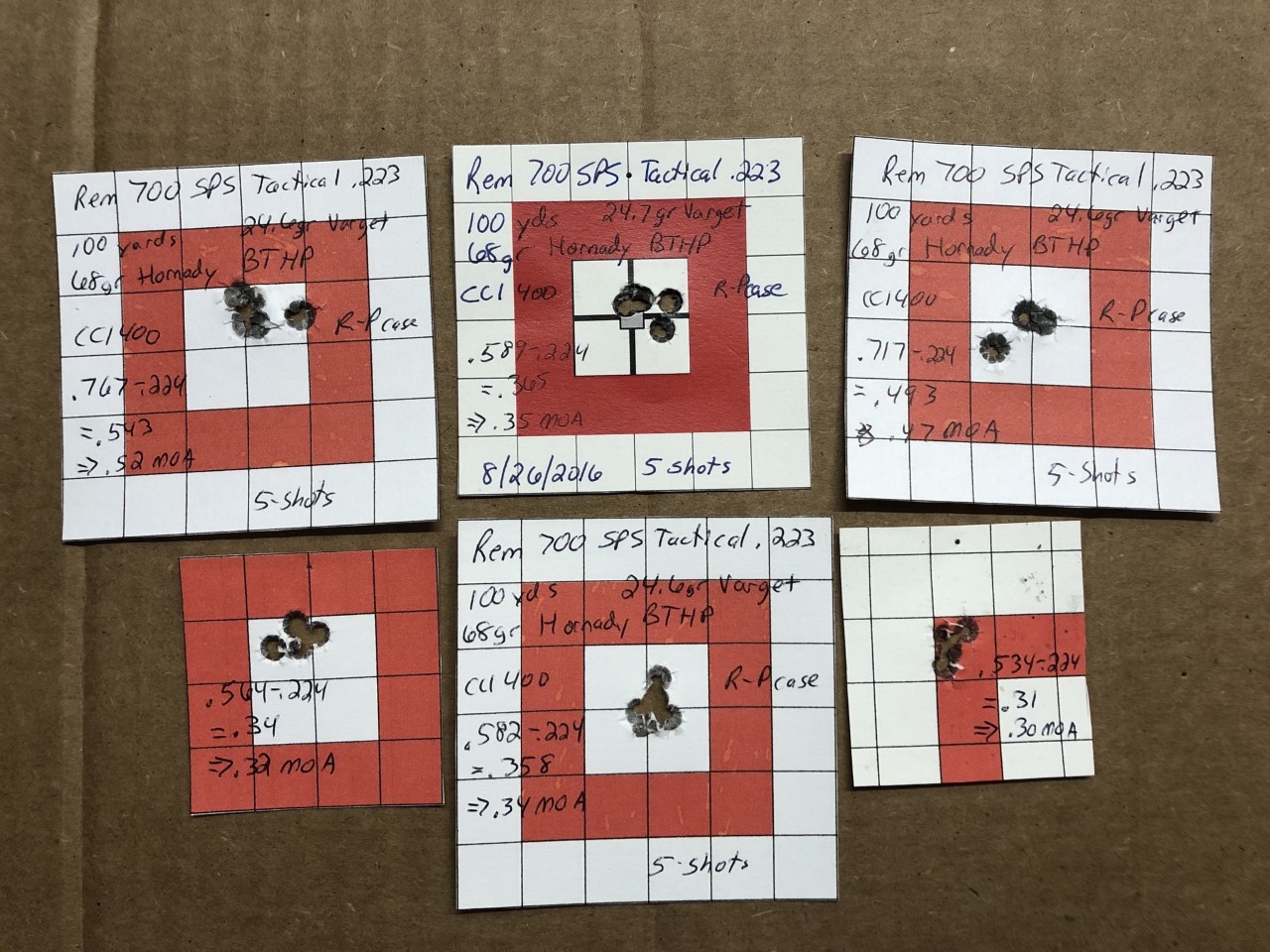

    I know you said no 223, but I'd recommend a 223 bolt gun. I've got a Tikka T3x Varmint in 223, easily the most fun rifle I have. It's accurate, easy to load for, and it's the cheapest centerfire rifle I have to shoot. I shoot mine out to 500 yards.
    22lr would also be an option.
