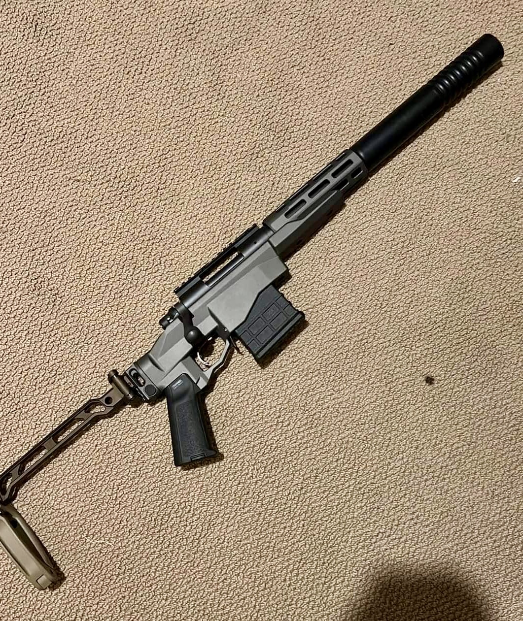

And i shoot the 190 or 250 grain t rex from them also and they work fantastic on deer. Working on building a 700 cp similar to this one. Simple rebarrel from xcaliber and you have a braced pistol

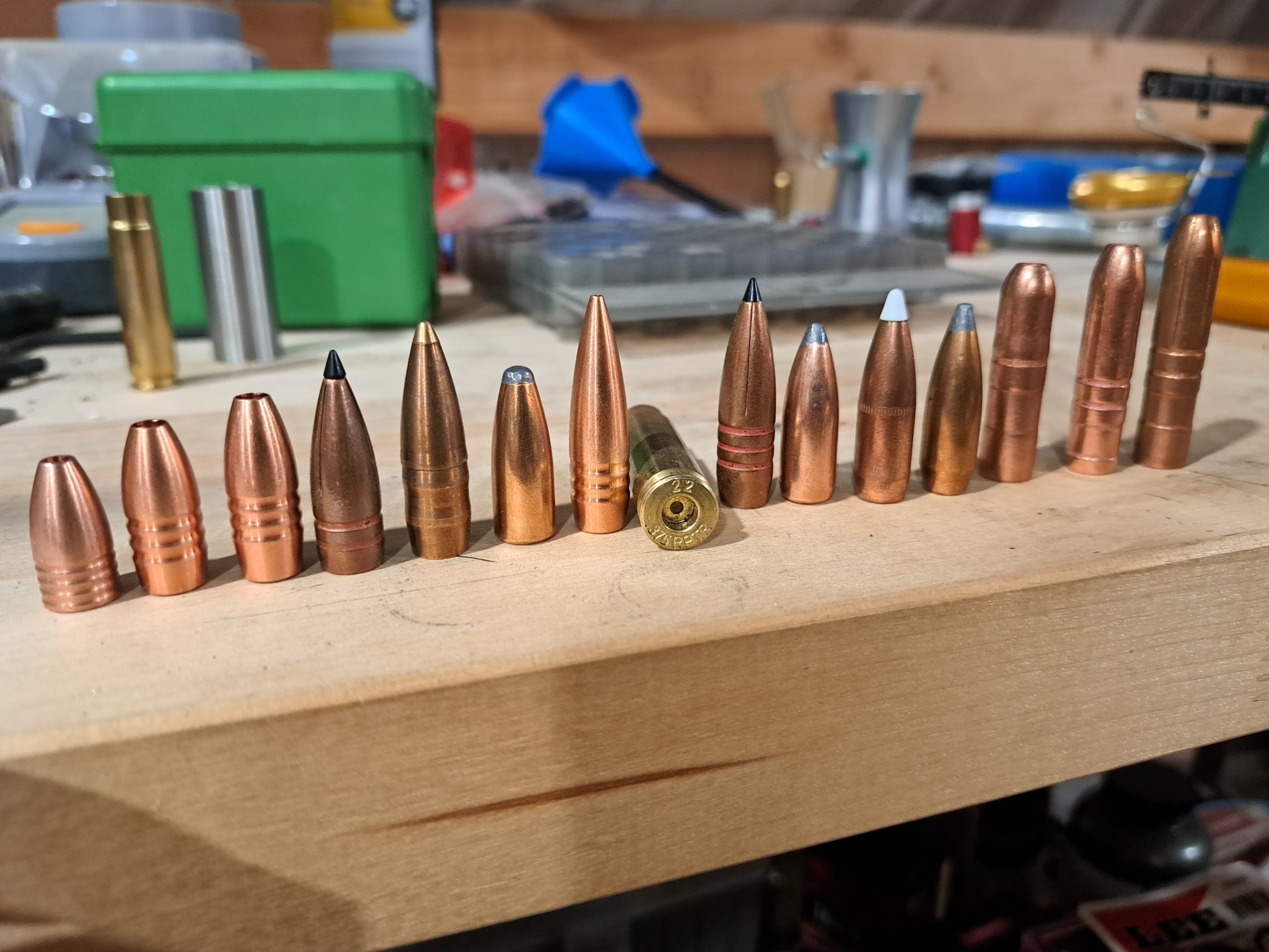

I'm playing around with copper subs 265-400gr in weight. My barrel is 18" 10 twist.
Supers can go to 300yds pretty easily, I think. Within 300yds, it hits like a big bore; beyond 300 to maybe 400, it hits more like a 308.
My calculator says my 270gr speer soft points are still going 1750fps and dropping 22 inches at 300yds.
Different bullets get a little faster and drop a little less as you get lighter. My 190gr copper makers are still going 1927fps and dropping 16 inches at 300yds.
Brass isn't too hard to make. I buy starline 358 win brass for $0.50 a piece. Cut the neck back, expand neck, final trim, then through a sizing die.
The neat thing about the raptor is that it works fairly well with common 375 bullets.
