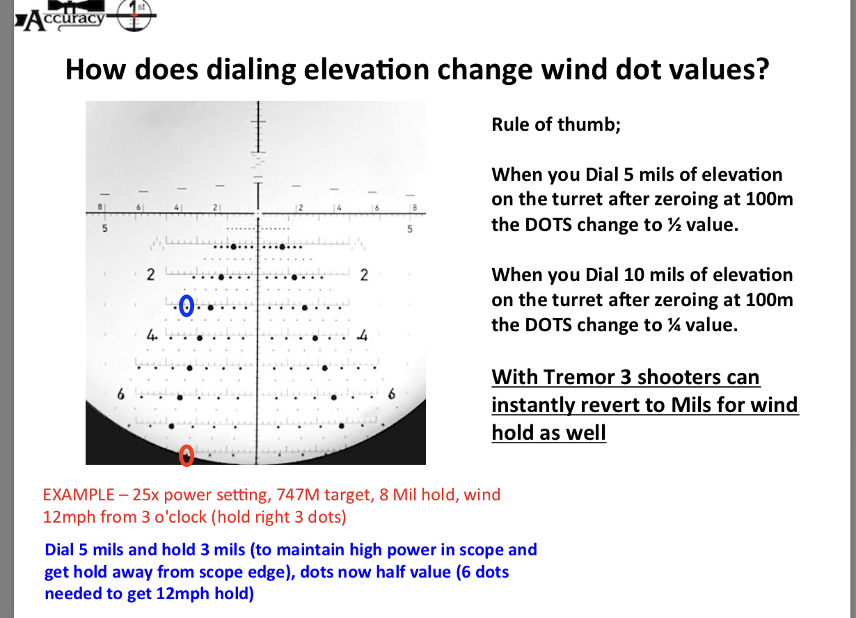

The main issue (or positive) of the Tremor is it means you never dial elevation, as soon as you dial anything the wind dots are no longer correct, which renders them useless.
Not the case. Each of my wind dots is 4mph with no elevation dialed, if I dial 5 mils elevation into my scope, I can then use the wind dots at 1/2 value, each dot becomes a 2mph dot. If I dial 10 mils elevation in, each dot is 1/4 value, and becomes a 1mph wind dot.
I switched to the T3 after using one in a class, I was sold on the ease of using the wind dots. I think in mph throughout the process now. I estimate the wind in mph, and I don't do any mental calculations for a mil windhold. I imagine the mph value of my wind dot floating in the reticle, so I now 'see' the wind dot value in mph superimposed on the reticle.
Is that a design feature or just happens to work for your particular load? I've not seen or heard that written anywhere.
It still limits you too a particular set of circumstances and means you need to do some mental arrhythmic to make it work.
I admit that the tremor reticle would be extremely useful folk who like to hold over, but for someone who likes to dial it's a lot of extra money if you aren't going to use it. Seems like something you need to try before you buy, as in your case it obviously works for you.
Design feature. Common knowledge with T3

Yes, if you want to dial for elevation and hold for wind, then the hold-over/xmas tree reticles are not ideal for you.
Three basic categories of reticle.
classical cross hair reticle = dial for elevation and wind
mil dot/hash reticle = dial for elevation and hold for wind
hold-over (xmas tree) reticle = hold for elevation and hold for wind
I use the T3 reticles because of the wind dots. Not only can I hold for wind, but no need to convert to mils to determine hold. Estimate(think) in MPH and hold in MPH. More speed gained when facing multiple unknown distance targets.
Press range finder "fire" button, read off the distance, refer to memorized DOPE card for elevation. Update mental estimate for wind in MPH. Hold for elevation and wind and shoot. I current practice wind calling out to 750yds on my land ... building a berm to enable 1,050.
