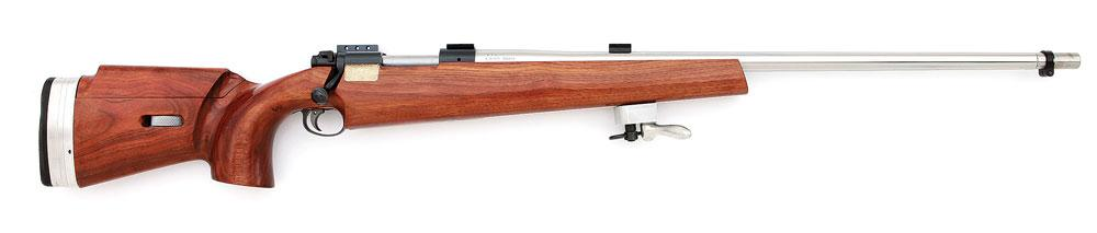

I recently purchased a Centra sight with the intention of using it as a back up iron sight for my M24 as I was unable to fond a "correct" rear sight. The sight will NOT work as the windage knob protrudes to the point the bolt will not allow cycling of the gun. I then tried it on a Rem 40X and on a Win 52C with the same problem. So far the only gun that woill allow this sight to work si a Martini MIII.
My question to those wiser that me is what guns does this sight work with??????

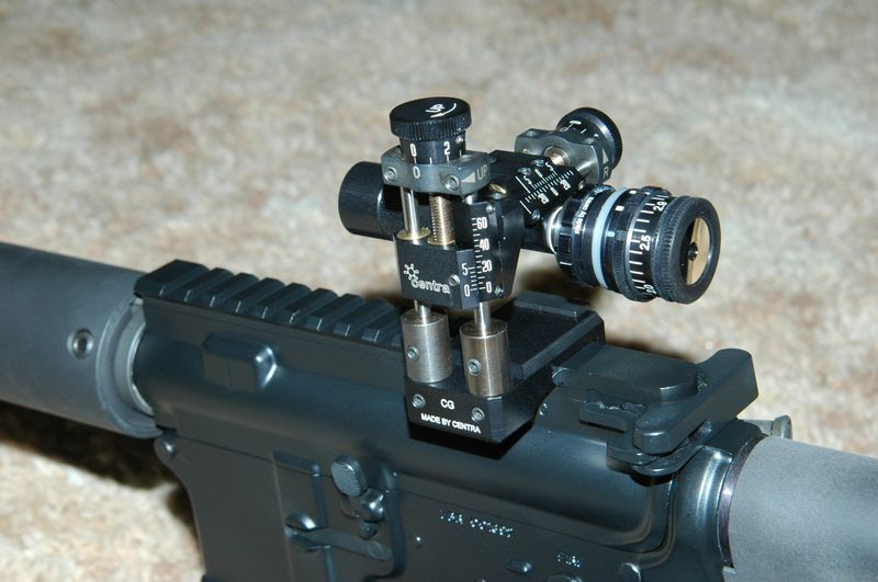

I’m seeing it marketed as service rifle sights so it’s for ar15s
It's made for NRA highpower/Long Range/Palma type of shooting. It is a precision sight and not really made for hard use, so probably not suited as a "backup" anything. Then again the Redfield sights that were part of the original M24 kit weren't intended for hard use either. If you bought the LR version of the Centra, I believe it is a little wider to allow for more windage travel which might be why you are hitting it with your bolt.

Reshape your bolt knob or put a different one on... somebody made an extension To push the handle out farther but I don't remember who it is
Are you sure the block is properly located?
Buy yourself a Redfield internatonal or Palma sight … It's more closely like what would normally be the backup sight for an m24.

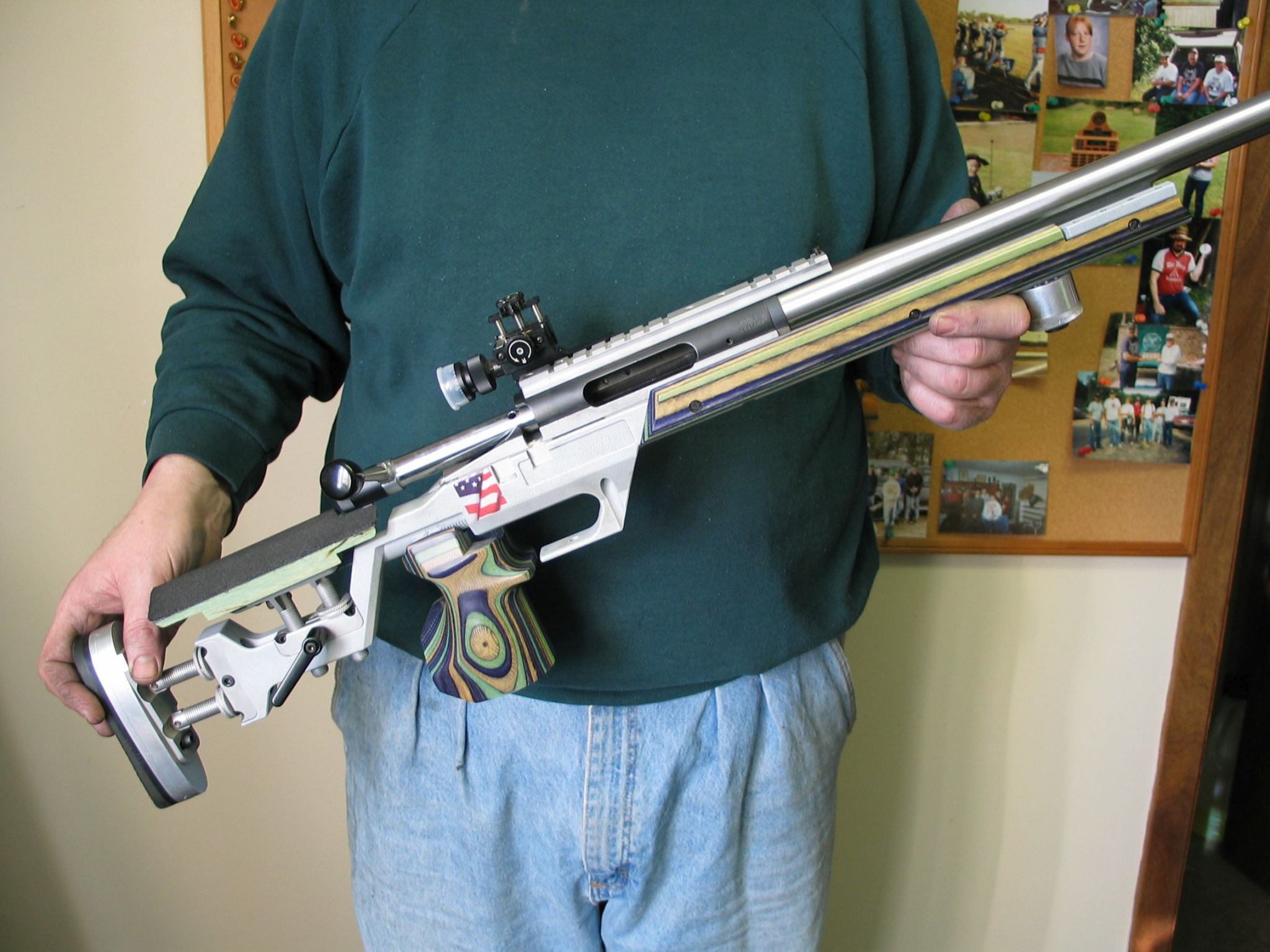

I am using a Centra LR on a Bleiker and several Panda rifles.
