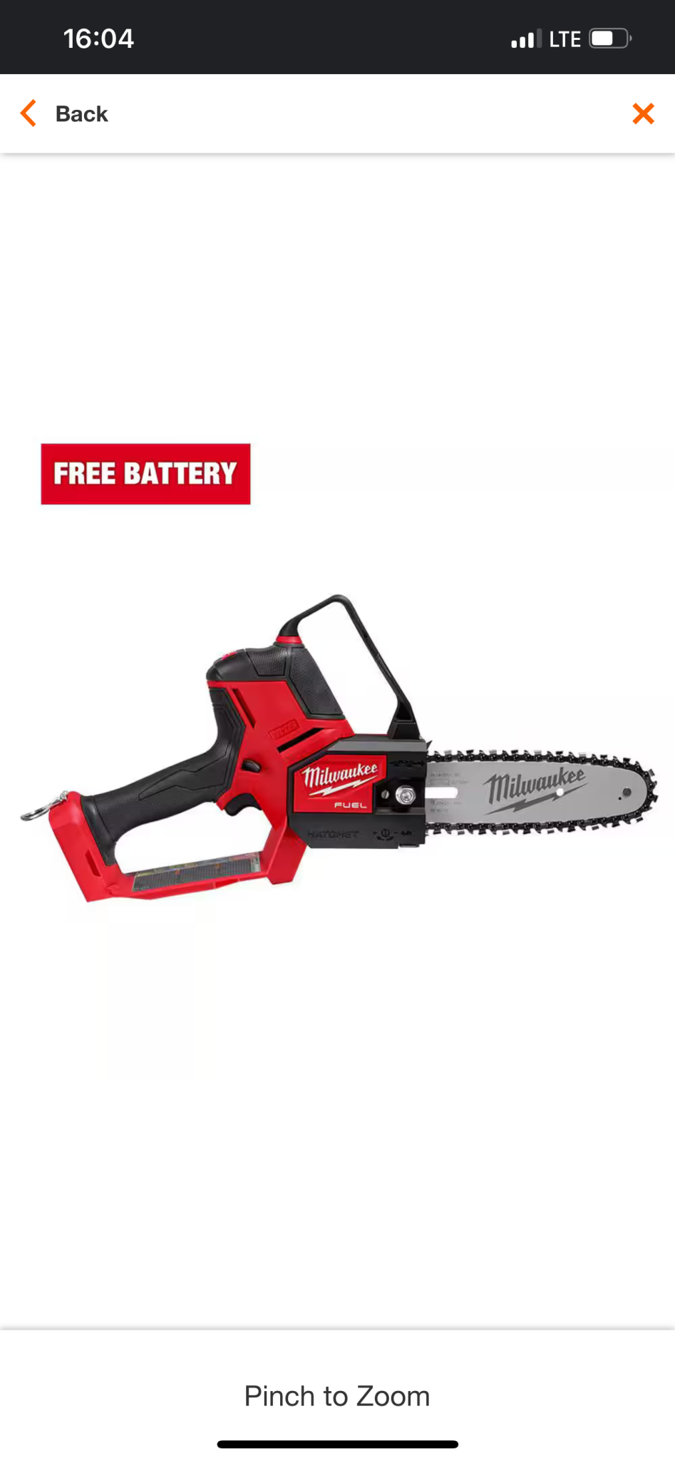

I have the 8” Milwaukee one. Never thought I’d use it as much as I do. For setting tree stands and what not it’s super handy.
I wanted mine to live in my truck 24/7 but it seeps oil out and leaves a oil slick wherever it sits for a while
You carry a chainsaw to your tree stand? I have a folding Silky that fits in my back pocket and saws through limbs like they were nothing. Never broken a sweat.

Most of my stands are relatively close to where I can drive. Edge of fields or by roads. All our private property
The saw has a spot on the back where you can carabiner it to your belt if you wanted to haul it a ways
Drain the oil out when done, could try building a fixture that keeps it angled so the bar oil won’t seep out.

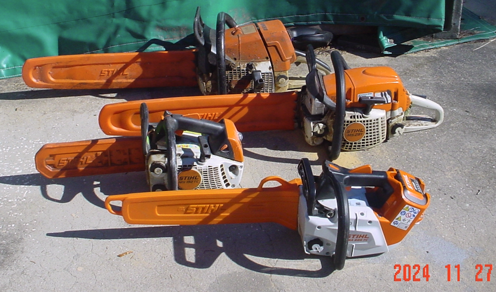

Top handle is the way to go for agility.

I have a Stihl 261 18" with yellow chain. Runs great. Took it from 4k feet up to 10k feet and only had issues because of too old of gas. It adjusted and did it's best but wouldn't keep running. My fault.
Recently helped a neighbor take down some dead standing trees. 5 or 6 at 8-10". Quick work. Was fun. Climbed one with spikes cause it was over a fence. 15- 20 ft stub left.
If I ever got a top handle it would be a 2511.
