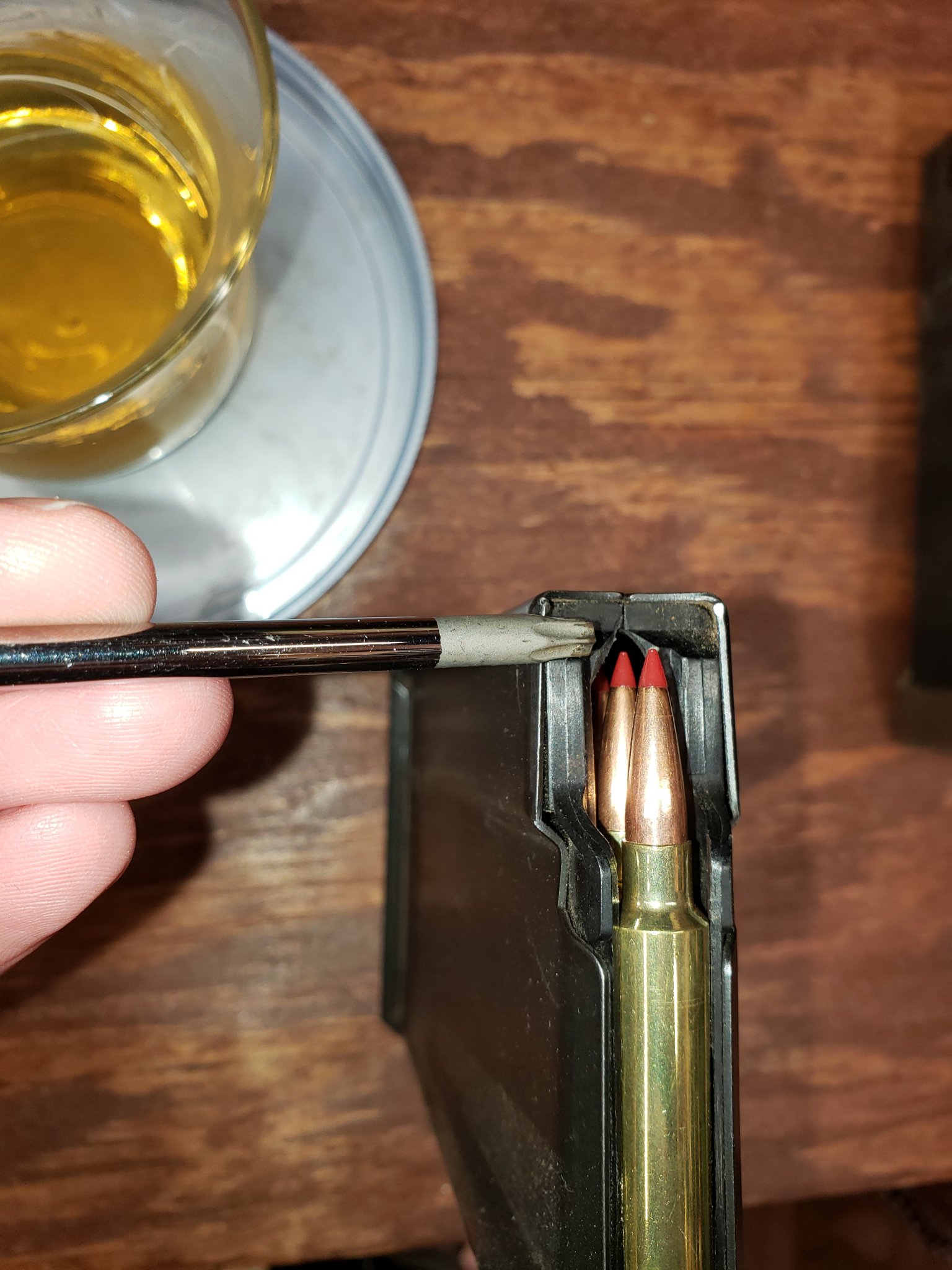

Are you fitting in accurate and mdt mags just fine or did you modify your mags. What I figured was a .100 freebore was about perfect.
Accurate mags is all I have ran besides the early crappy ai plastic mags. I do trim the lip for oal just on the front outside edge.

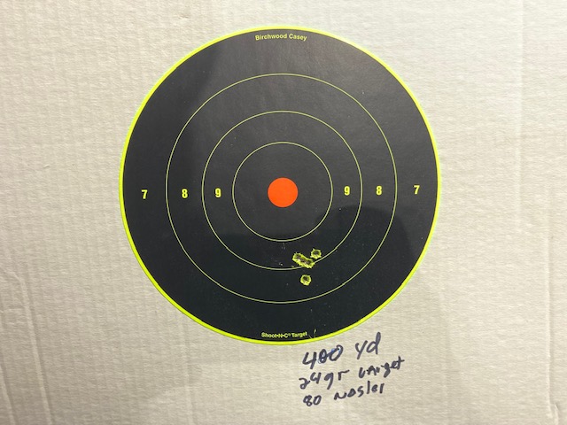

My experience has been with my long throated barrel with a 1:7 twist, is that the 77 and 80 gr. bullets love it. Here is a example of of an 5 shots at 400 yards with 80 gr. Nosler. 80 gr. just doesn't preform as well at a 1000 as the 90 gr bullet does and since that is the distance I shoot the most that is what I set up for.

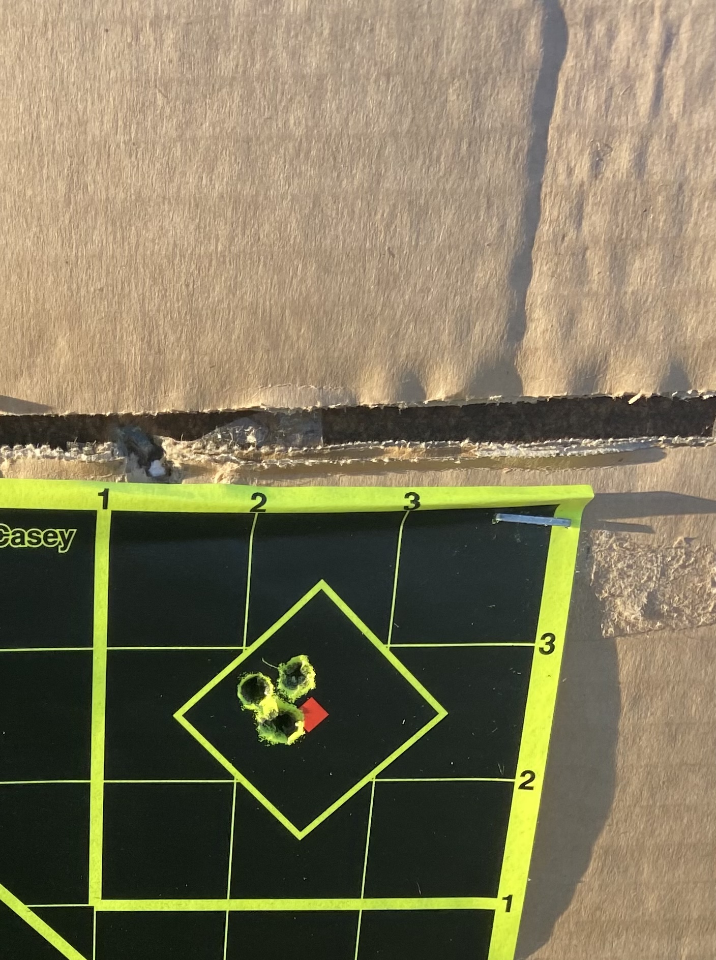

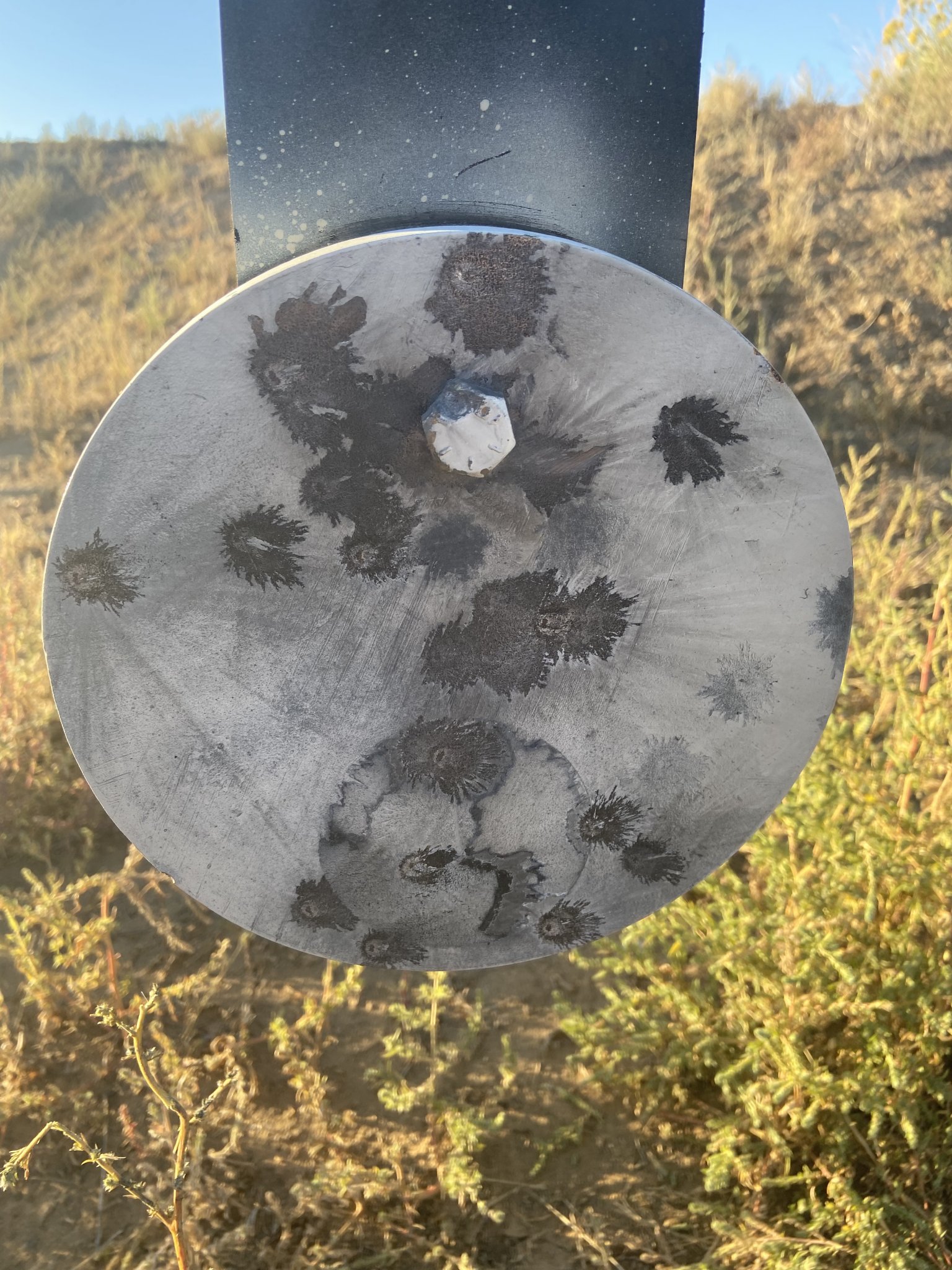

Update:
23.6 grains XBR 8208 with 88 ELD-M, Lapua fire formed brass is doing 2800 fps in my PROOF 24” pre-fit, (Ackley’d).
Went 29/30 on a 1.3 moa plate at 550 yards from prone and kneeling. Load was “slop” loaded on the progressive, Dillon powder throw. ES of 50 fps, SD 17.
Best group at 100 yards was with TBAC Dominus, 5 shots.
