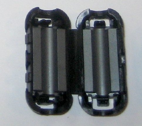

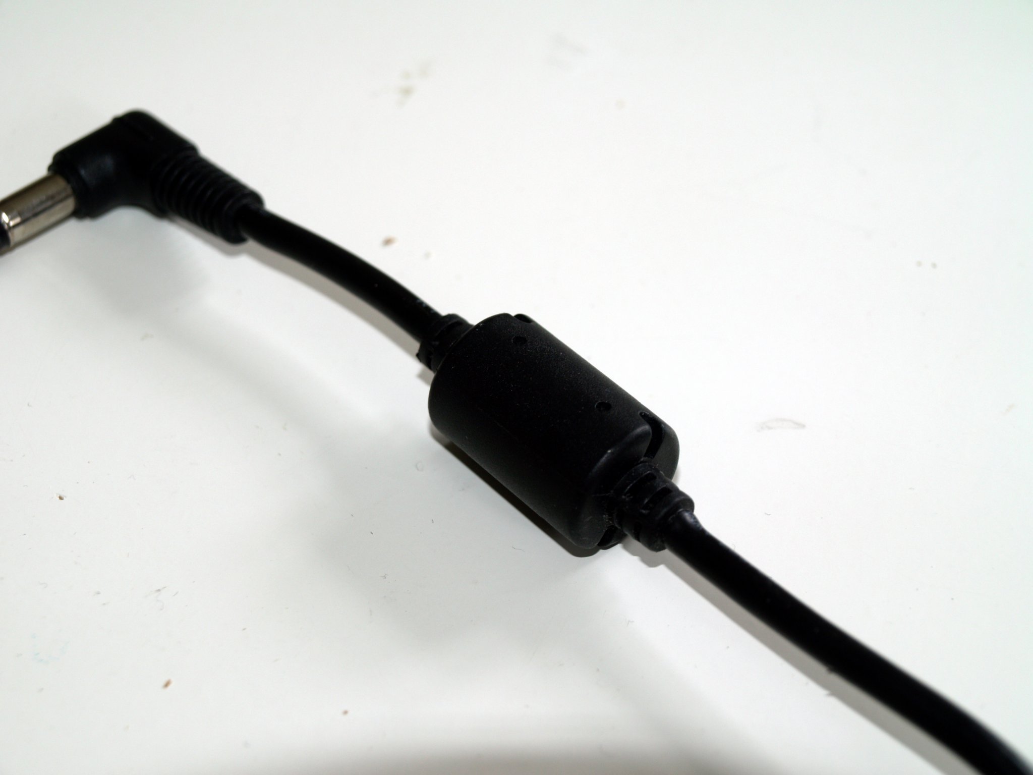

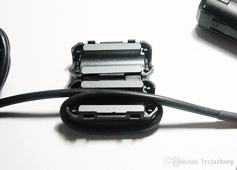

A ferrite choke should decrease high frequency noise before it enters an electronic device (such as a scale).
I picked up mine at Radio Shack before they all shut down. You can still find them on multiple websites. I’m not at home now and can’t take a picture of my 1500 power cable, but have included a few pictures found on the web.
