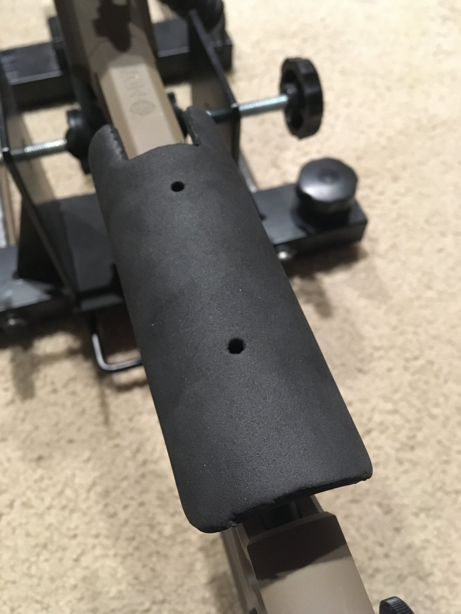

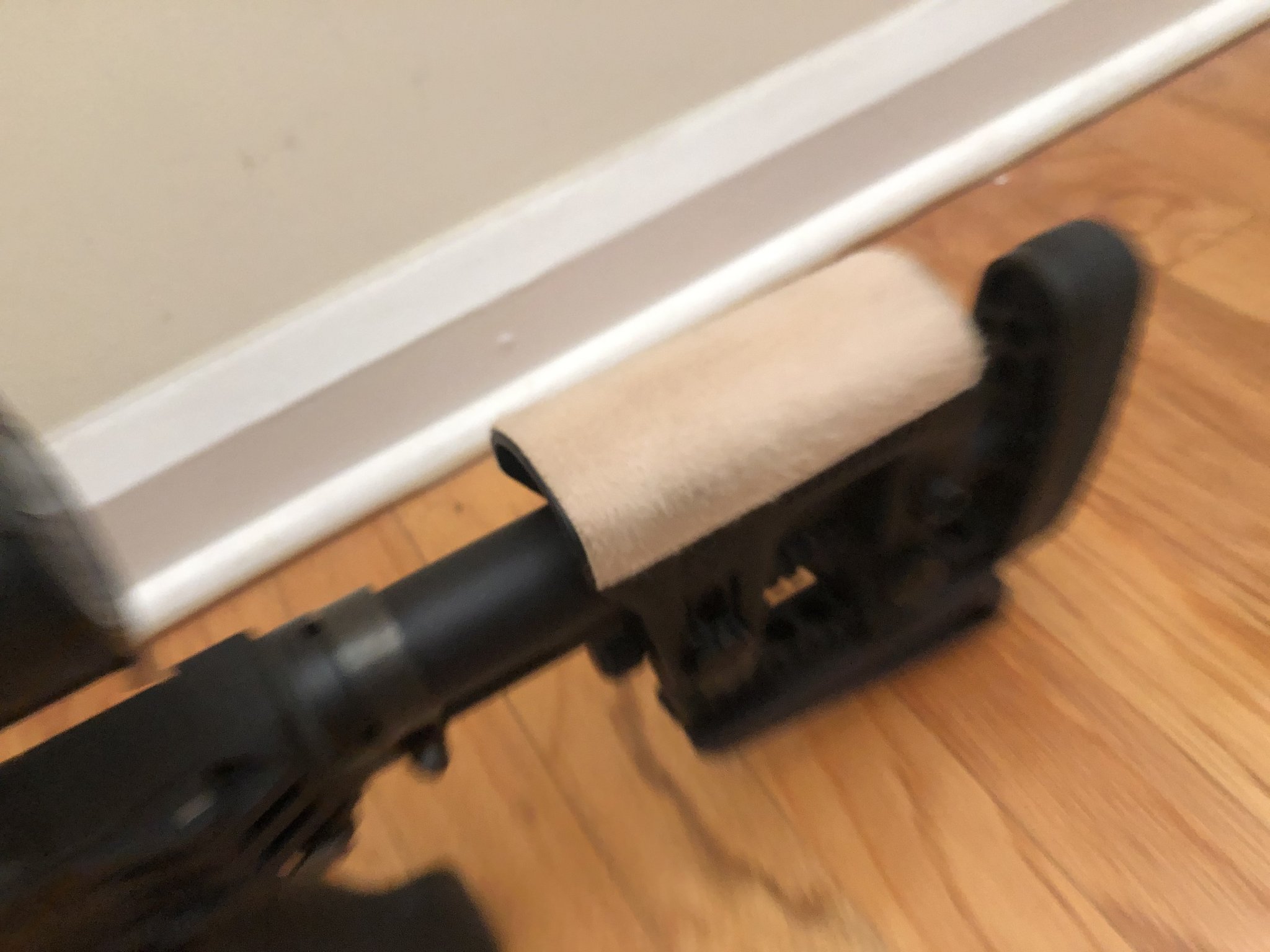

$0.99 sheet of self adhesive foam from Michaels and 5min with a razor.

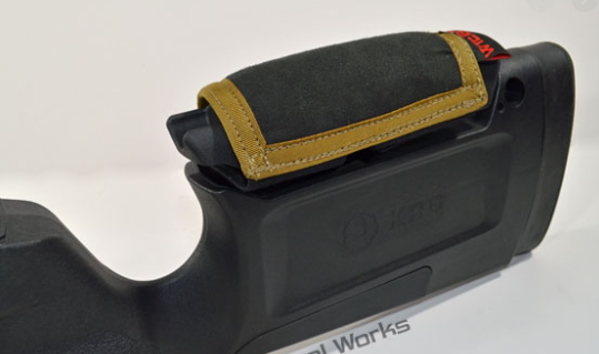

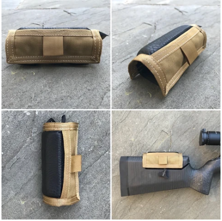

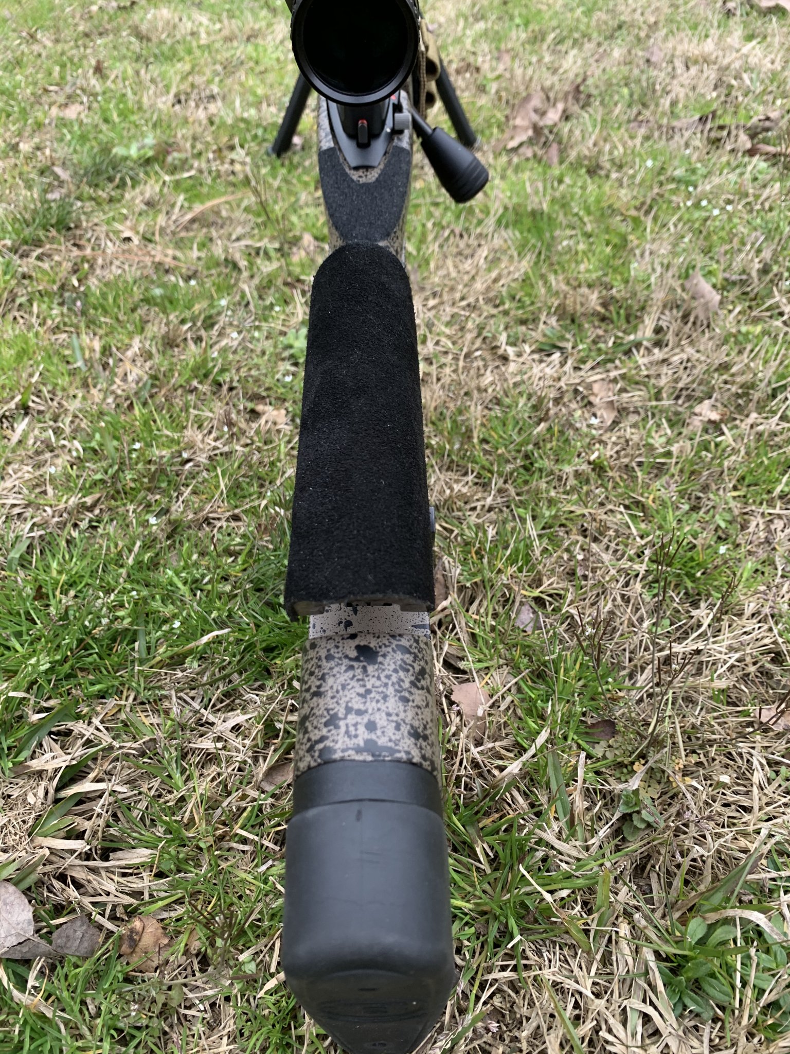

If you want more padding and a bit of Gucci factor, I've used these on my AIs and like them a lot. Only downside is they add a lot more thickness than a sheet of foam, so if you're limited on how low your cheekpiece goes, or you need it shifted far to one side, it might affect your head & eye position.
https://wiebad.com/mini-stock-pad/

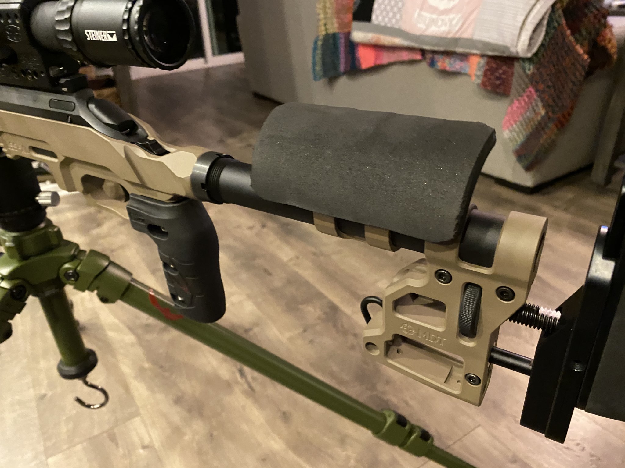

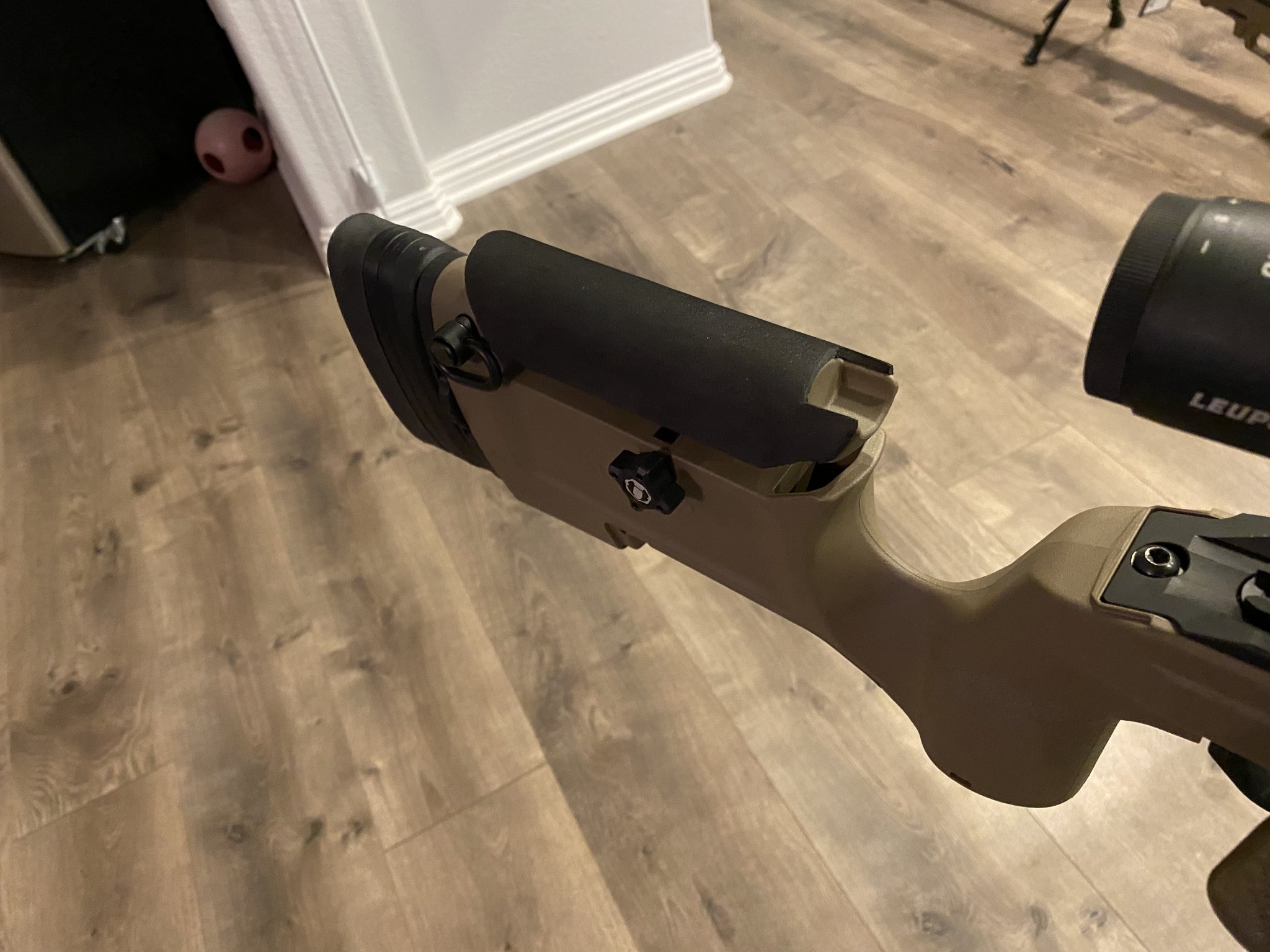

I don't know if others have had the same experience, but I suggest thinner foam instead of thick. The thicker it is the harder of a time I've had trying to get it to stay attached to curves like the top of a cheek piece.

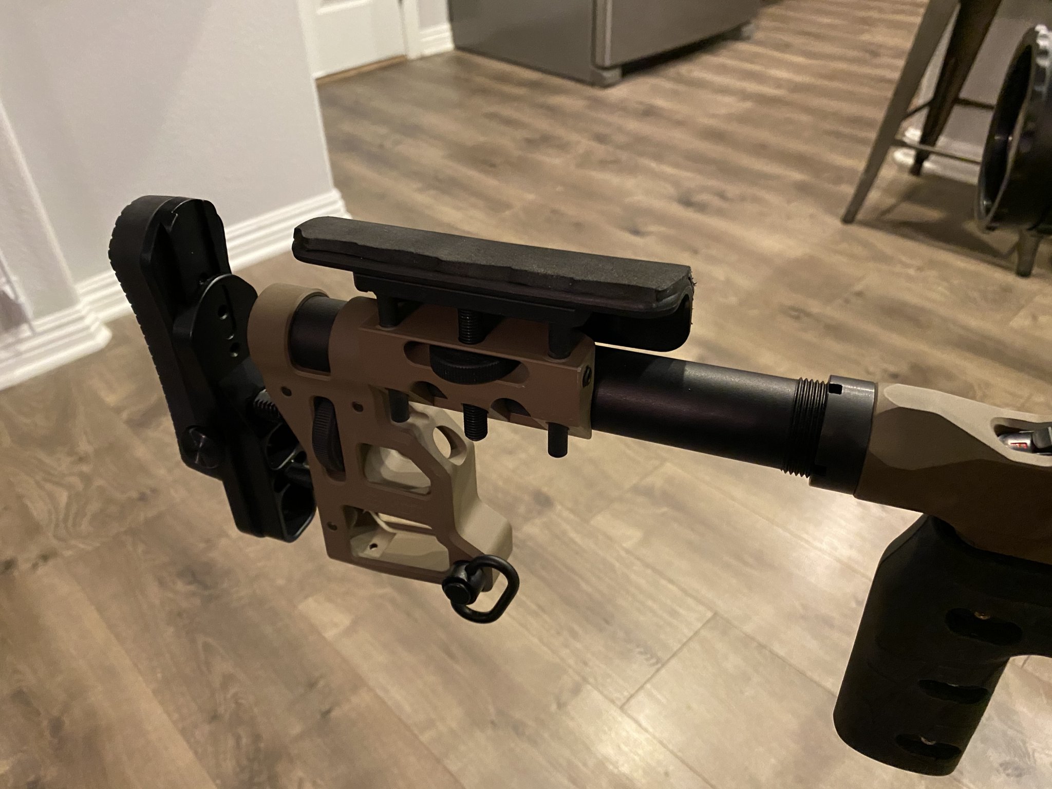

I have the Wiebad pad for my McM A5, and Hoptic USA saddle cheek covers for my JAE chassis', and I prefer the cheaper Hoptic USA ones to Wiebad. The Wiebad starts to get uncomfortable if you are sweating.
The DIY versions mentioned above are essentially the same thing as the Hoptic USA pieces I use, and cheaper. That's probably your best bang for your buck.

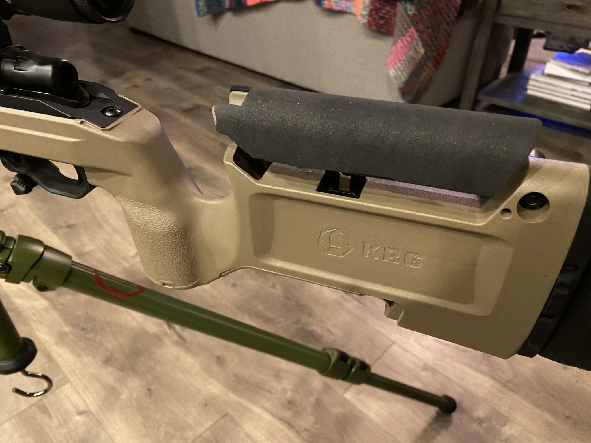

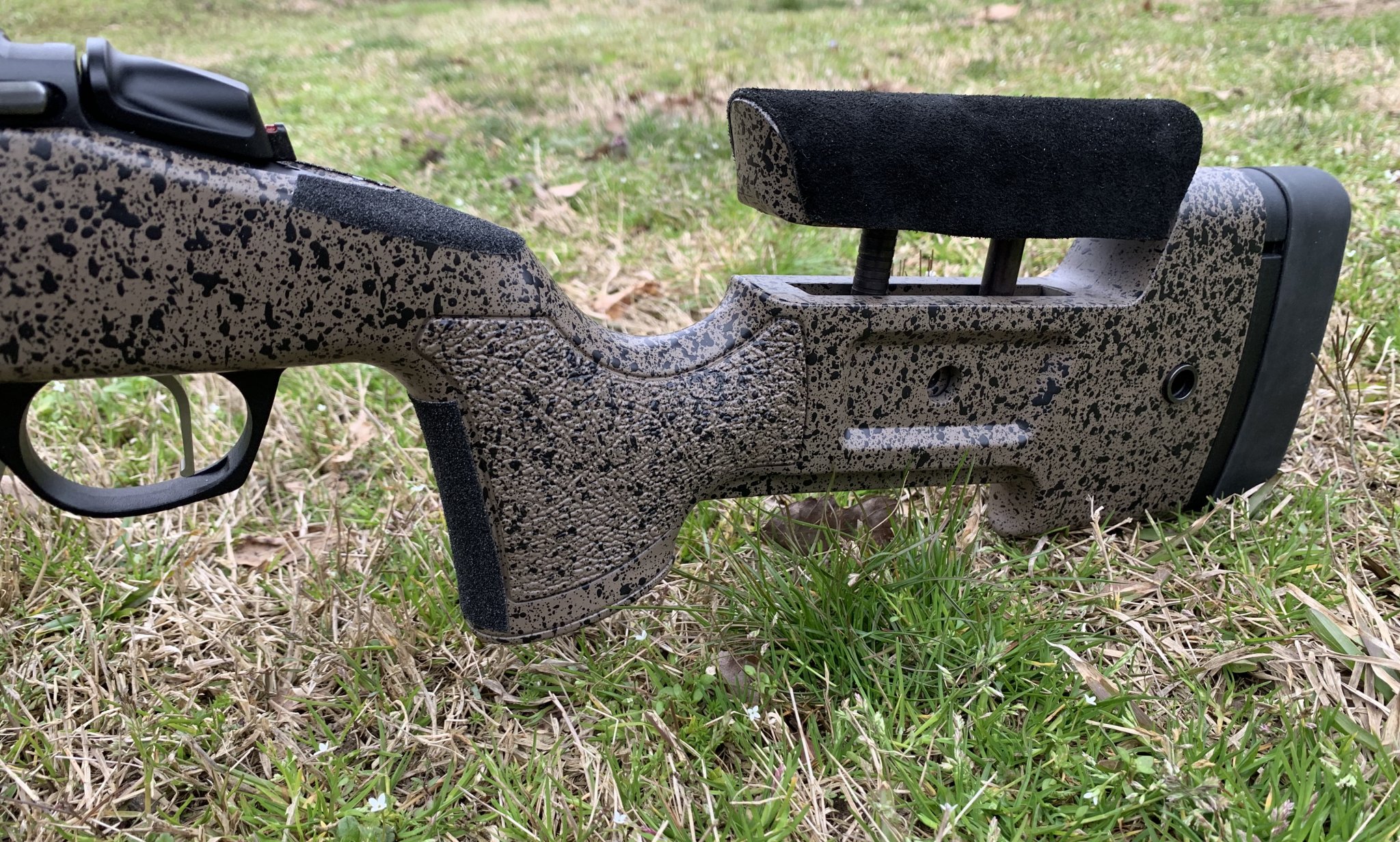

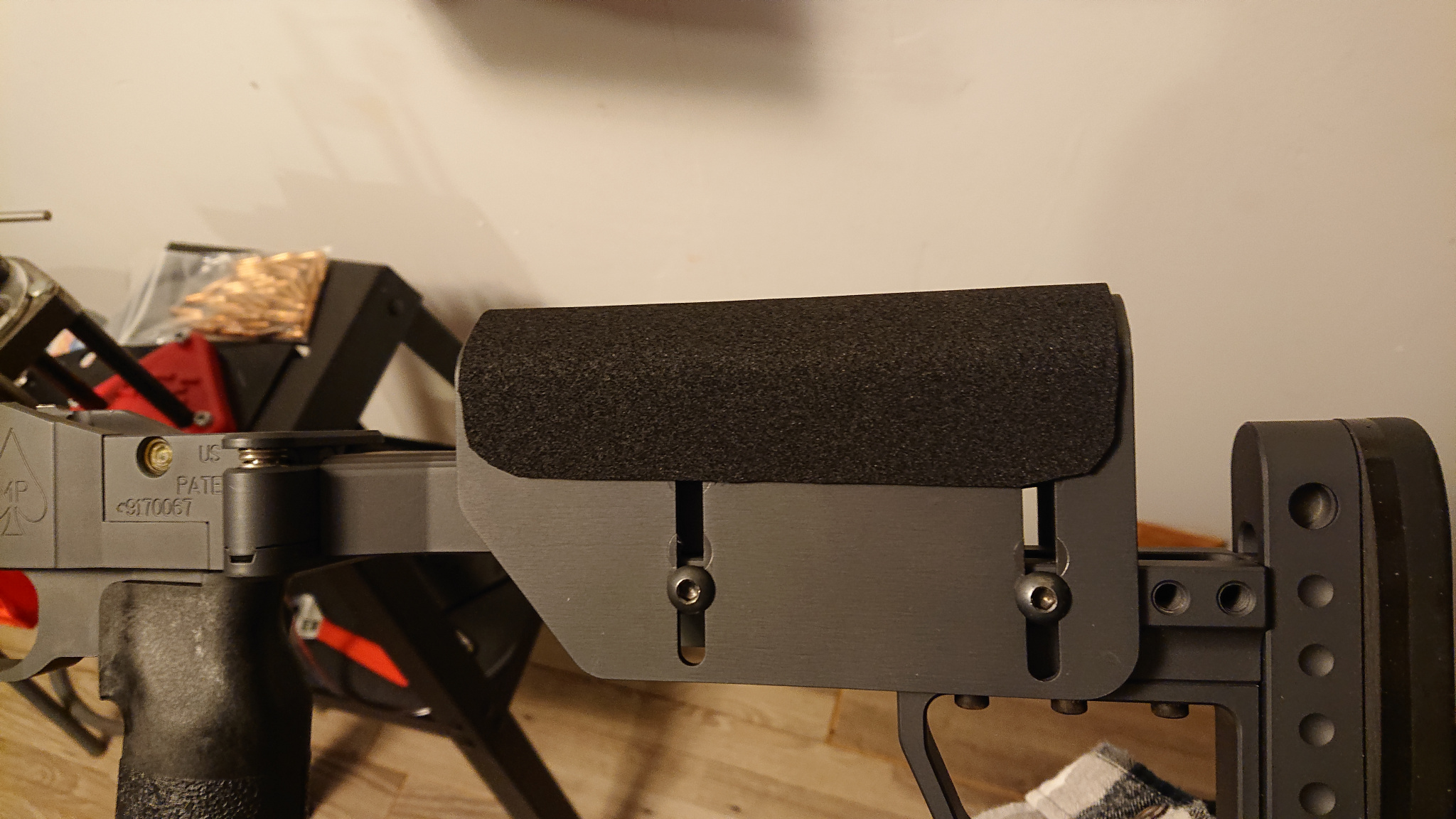

Another vote for the self stick neoprene foam pads off Amazon. This was $10 for a 6-pack, 1/8" thick. Clean off the surface well with IPA (or soap and water if it's painted) and it has stuck well for me.

Ok got the sticky foam today that canezach recomended. I cleaned my cheek piece with isopropyl alcohol as was recommended placed a pad and followed with a razor. So far everything is sticking like it should and is very comfortable. I have never been good in staying in the lines so my cutting was not the best but it’ll do. Thanks to everyone that helped me out with this.
